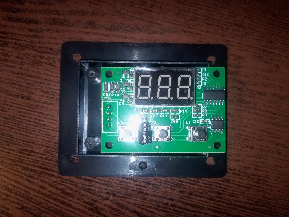

    Dear forumers.
    I have such a power regulator:
    Controlling the power regulator with the ESP32 - what to replace the buttons with? Controlling the power regulator with the ESP32 - what to replace the buttons with? .
    I would like to control this via ESP32.
    What to replace the buttons with?
    Transistor? optocoupler? SSR? Due to the switching speed, a standard mechanical relay is not an option.
    Best regards

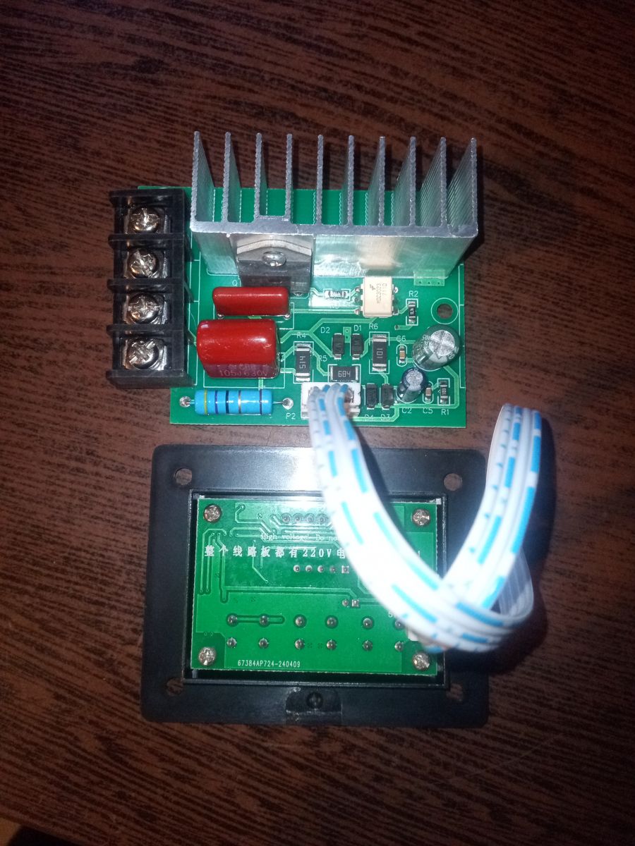

  • #7 21141182
    ArturAVS
    Moderator
    Posts: 26416
    Help: 2303
    Rate: 7832
    You already have the executive member (triac, optotriac and simple transformerless power supply). If there is to be an ESP32, what's the problem of doing all the handling on it? The original power supply will be too weak for the ESP though.

    #8 21141212
    karwo
    Posts: 1559
    Help: 152
    Rate: 367
    There are two options:
    1. build an interface between the ESP and the existing regulator - optocouplers would make sense (power separation), it would be a good idea to reverse engineer the existing regulator from the pushbutton side and see how it is done by the majfrids
    2. add an actuator to the ESP and omit the existing regulator - google ESP+phase regulator (depends on what you want to control).

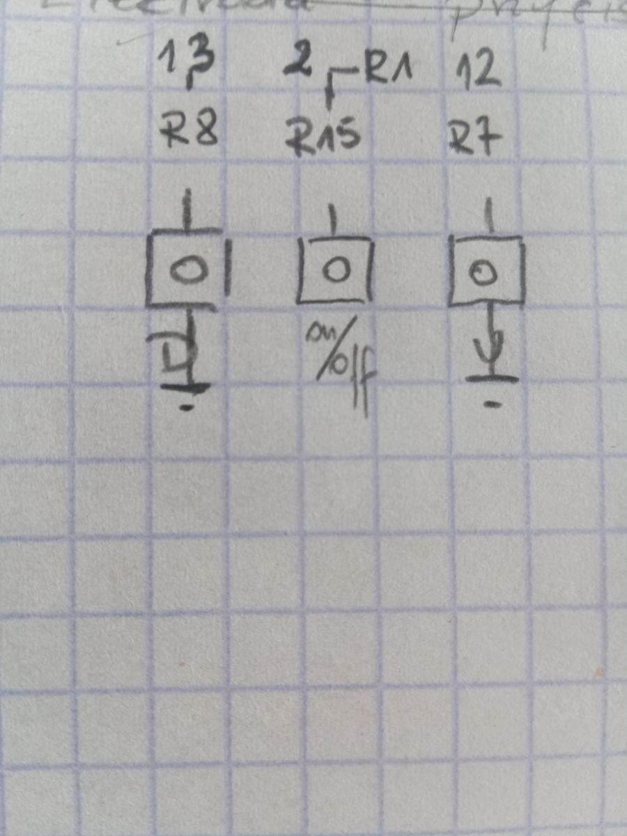

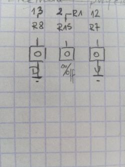

    #9 21141256
    iksrowaj
    Posts: 111
    >>21141212 .
    The buttons are wired sequentially:
    Down>R8>IO13 of this IC without inscription
    ON/OFF>R15>IO2
    UP>R7>IO12
    Based on other solutions of this type, I suspect this is something like a digital potentiometer.
    When connected to 230V there is +1.2V DC and GND on the buttons
    By design, this is intended to be an interface to the so-called "zero export". The ESP is supposed to poll the EE meter and, in the event of energy export to the grid, is supposed to regulate, say, the power of a heater or something similar.

    #10 21141329
    ArturAVS
    Moderator
    Posts: 26416
    Help: 2303
    Rate: 7832
    iksrowaj wrote:
    By design, this is to be an interface for so-called "zero export". The ESP is supposed to poll the EE meter and, in the event of energy export to the grid, is supposed to regulate, say, the power of a heater, or something similar.
    This is what I suspected.
    iksrowaj wrote:
    I suspect that it is something like a digital potentiometer.
    A digital potentiometer makes no sense in such an application, here it is either PWM or phase control (although the optotriac is out of sync with the mains and you can't see the zero crossing detector circuit) or even group control if it is only for heaters. Write the whole operation on an ESP and add phase/group control, on the tape you probably have signals, Vcc, GND, output and zero detection.
    In truth, it's better to redesign the whole thing from scratch.
  • #11 21141404
    karwo
    Posts: 1559
    Help: 152
    Rate: 367
    iksrowaj wrote:
    Based on other solutions of this type, I suspect it is something like a digital potentiometer.
    That is, the keyboard - 3 buttons are wired to the ADC input of the controller.
    ArturAVS wrote:
    Truthfully, better to redesign the whole thing.
    Again @ArthurAVS is right - better to do it from scratch on ESP, just would need to consider what type of phase/group control would be more beneficial to use.
