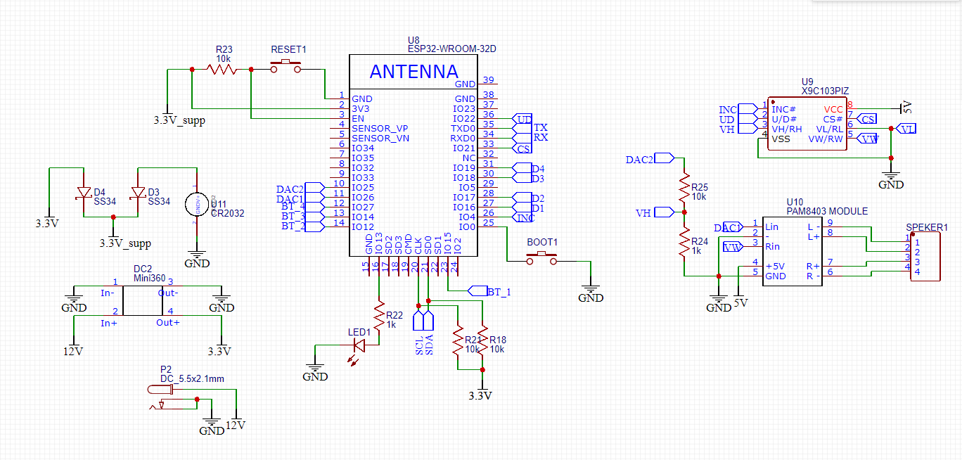

    I would be very grateful for constructive answers:) I am building a radio on an ESP32 with battery backup. The amplifier is a PAM8403 module, for which I would like to adjust the signal power from the DAC by software with a digital potentiometer: X9C103 (one channel). Therefore, I have some questions for the following schematic:
    1. does such a battery backup scheme have the right to work?
    2. I have a separate +5V line (missing on the schematic) - since the ESP32 runs on 3.3V, can I connect the VCC for the X9C103 to +5 and its logic will be controlled from the ESP32 pins without some logic state conversion?
    3. does anyone see any errors in the schematic?
    For all answers thank you in advance.

    khoam wrote:
    It may work, but if it's going to work like this for longer, get a spare ESP32.
    The standby ESP can always come in handy :) but I don't understand what you are trying to scare the author of the topic with, damage to the ESP from a device that only has inputs? As long as it doesn't burn up the X9C103 then nothing will happen to the ESP either.
    The logic levels of the X9C103 are TTL, so compatible with the 3.3V CMOS outputs.

    khoam wrote:
    I'm not trying to scare you, just trying to develop good habits
    If you're not scare-mongering, why the comment about a back-up ESP? What did you want to show in the manufacturer's documentation? I don't like vague hints, how is an amateur supposed to guess what problem you are writing about when I don't see any problem. Maybe you thought there was an output from the 5V circuit, but you wrote so vaguely that you could always change your mind and no one would know?
    khoam wrote:
    The internet is full of so-called fritzing with ESP, which is a simple (or rather primitive) circuit conversion from AVR.
    Probably this is the case, but what effect does it have on the circuit we are discussing?
    Good habits means checking the facts, and the facts are that the input of a circuit supplied with 5V will not supply voltage to the output of a circuit supplied with 3.3V, i.e. there is no risk of damage to the ESP. The second fact is that the output levels of a 3.3V CMOS chip (ESP) are within acceptable limits for a 5V TTL-compatible input.
    And coming back to the topic, the divider by 11 before the potentiometer is strange, what should be the maximum signal level at the output?
    Another thing is that the DAC has to work with an offset in order to process audio signals correctly, and if you apply a DC voltage from the DAC to the potentiometer, you will hear crackling during the adjustment, before the potentiometer or before the divider there should be a capacitor to cut off the DC component.

    A CR2032 battery might be able to withstand a momentary load of 30mA, but 300mA is not even possible on a short circuit, so such a backup can only work in the case of Hibernation mode and Deep Sleep, when the ESP will have the radio part and the core switched off all the time, leaving RTC and ULP.
    https://lastminuteengineers.com/esp32-sleep-modes-power-consumption/
    https://data.energizer.com/PDFs/lithiumcoin_appman.pdf

    Thank you for your replies, and confirmation that it does not need logic state conversion.
    1. battery backup - I only care about remembering the current time (RTC&ULP). From what I've read, assuming the ESP32 will detect a change in voltage, then go into "Deep sleep" mode then the CR2032 should pass the test. There are also LIR2450 rechargeable batteries available at 3.6V - if the regular CR2032 doesn't pass then I'd replace it. Larger 18650 type solutions are unfortunately out of the question as there is no room for them for this project.

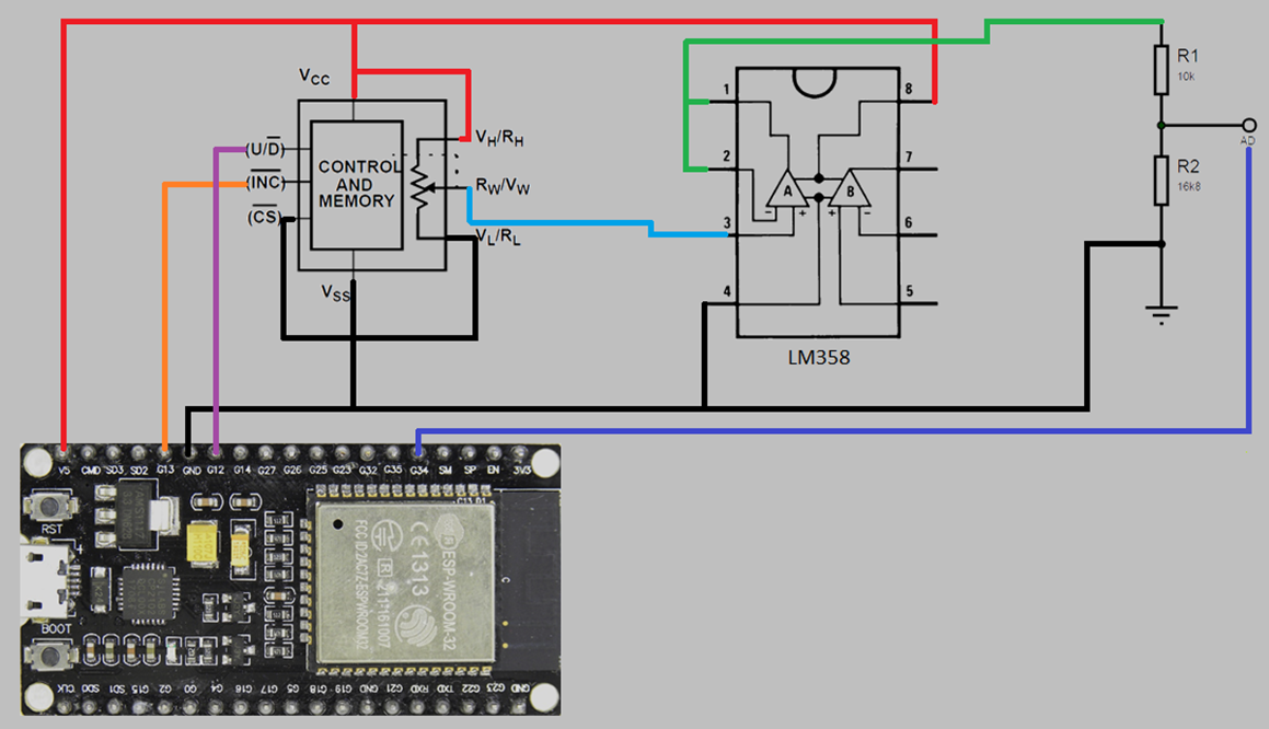

    2 Voltage divider: I downloaded the schematic and library from the following project:
    https://www.xtronical.com/basics/audio/dacs-on-esp32/
    https://www.youtube.com/watch?v=xotWNWUh7i4
    a1e103bb8 .
    Regarding power - the PAM amplifier that is in the project is 2x3W - but I only need 1x1W - I don't have room for large speakers. So perhaps you know of some other circuit/module that I could use?

    czarny8322 wrote:
    Battery backup - I only care about remembering the current time (RTC&ULP). From what I've read, assuming the ESP32 will detect a change in voltage, then go into "Deep sleep" mode then the CR2032 should pass the test.
    You are making a logical error. An ESP32 powered by a CR2032 battery will not detect anything. It will stop working.

    What about power - the PAM amplifier that is in the project is 2x3W - but I only need 1x1W - I don't have room for large speakers. So maybe you know some other circuit/module that I could use?
    Power depends on the supply voltage, if you supply from 5V it will be up to 3W as from 3.3V it will be 1.3W. You can reduce the power by limiting the input level of the amplifier.
    And as for the power monitoring transition, do you need to measure with ADC? not a simple GPIO connected to an external 3.3V or other power line via a suitable divider will suffice? I used to trigger an interrupt at power loss, and as I detected a voltage drop before the inverter feeding the uC, I had a moment to react before the voltage feeding the uC dropped, but I didn't do this with the ESP.

  • IO0 pull-up missing caused boot into download mode
    #29 18482563
    czarny8322
    Posts: 81
    Rate: 14
    Thanks for all the tips. In the end I opted for simplicity and an external RTC - DS3231MZ+. However, this is not the end of the problems:) .
    The ordered PCBs arrived, I soldered the components and after the first flashing on the uart I was getting a message:
    ets Jun 8 2016 00:22:57
    rst:0x1 (POWERON_RESET),boot:0x3 (DOWNLOAD_BOOT(UART0/UART1/SDIO_REI_REO_V2))
    It turned out that pin 25th - IO0 - should have a high state during normal operation so the pull-up resistor in the schematic from page 1 is missing. After soldering the resistor - the test program started.

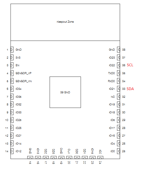

    Problem 2 -> I2c - I switched from Eagle to EasyEd. My project uses the model for ESP32-WROOM-32D in which the pins are labelled like this:
    pin 20 - marked as SCL
    pin 21 - marked as SDA
    In the documentation it is as follows:
    pin 20 - CLK
    pin 21 - SD0
    https://www.espressif.com/sites/default/files...32-wroom-32d_esp32-wroom-32u_datasheet_en.pdf
    On a development board e.g. ESP32 devkit and similar:
    pin 21 - SDA
    pin 22 - SCL
    https://rntlab.com/question/what-pins-are-the-i2c-pins-on-the-esp32/
    I have a bare ESP32-WROOM-32D chip.
    Can someone direct me under which pins I should connect my peripherals: DS3231MZ+, mcp23017 ?
    ESP32-WROOM-32D pin numbers versus GPIO mapping
