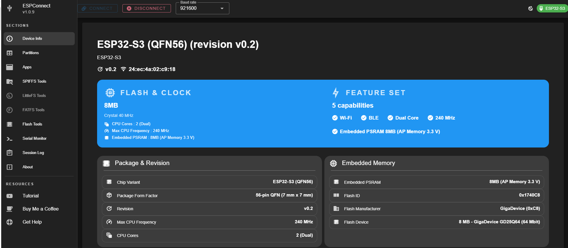

    ESPConnect is an advanced tool for managing ESP family microcontrollers without having to install desktop applications. It allows you to read and upload the contents of the chip's Flash memory. It allows you to view detailed device information such as chip family, MAC, Flash size and clocking. It also has an extensive file system manager (SPIFFS, LittleFS and FATFS) with file viewing, writing and reading. ESPConnect offers a graphical representation of the Flash partition layout and tools for backing up or restoring them.
    Let's test this tool with ESP32-S3-Touch-LCD-4.3 .

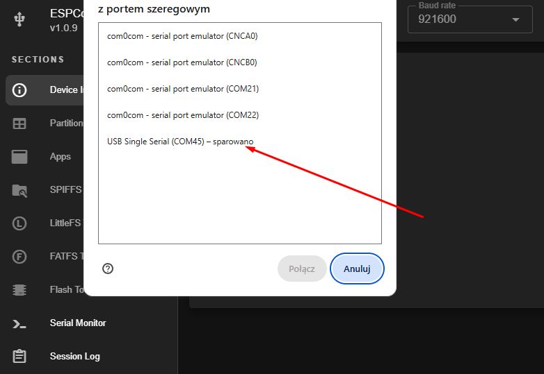

    Connect the board to the computer, open the tool window . The serial port is selected. You don't need to load anything on the ESP32 - the program shown reads everything from outside via the virtual serial port. This works analogously to esptool.
    Serial port selection window with USB Single Serial (COM45) highlighted

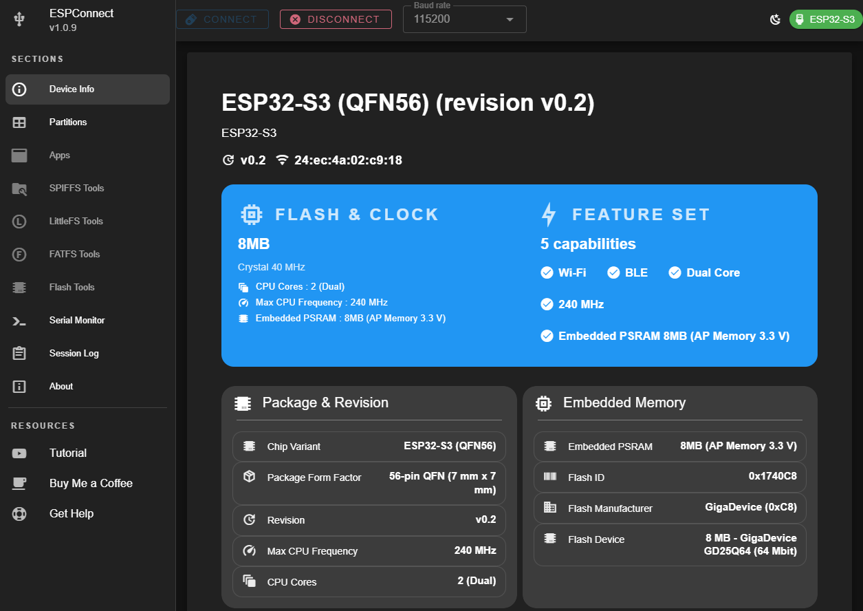

    Immediately everything becomes clear - we see information about the CPU itself, the size of the Flash memory, the capabilities of the chip, the size of the external PSRAM bone and even the Flash ID.
    ESPConnect screenshot showing ESP32-S3 chip details, flash, and PSRAM info

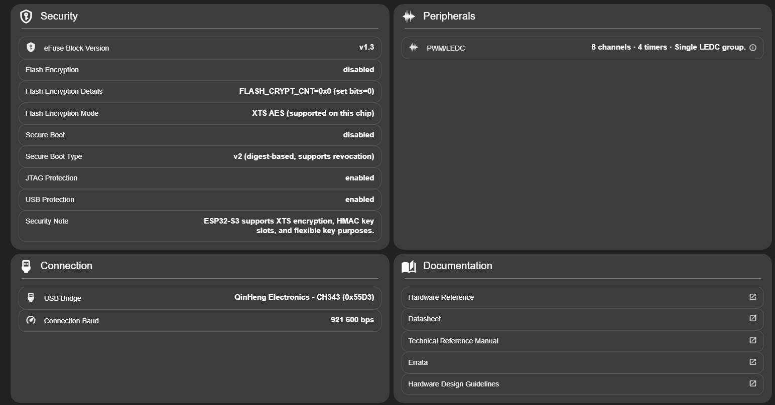

    Similarly, we have information about Flash security and the USB-UART connection:
    ESPConnect interface showing Security and Connection panel with device protection details

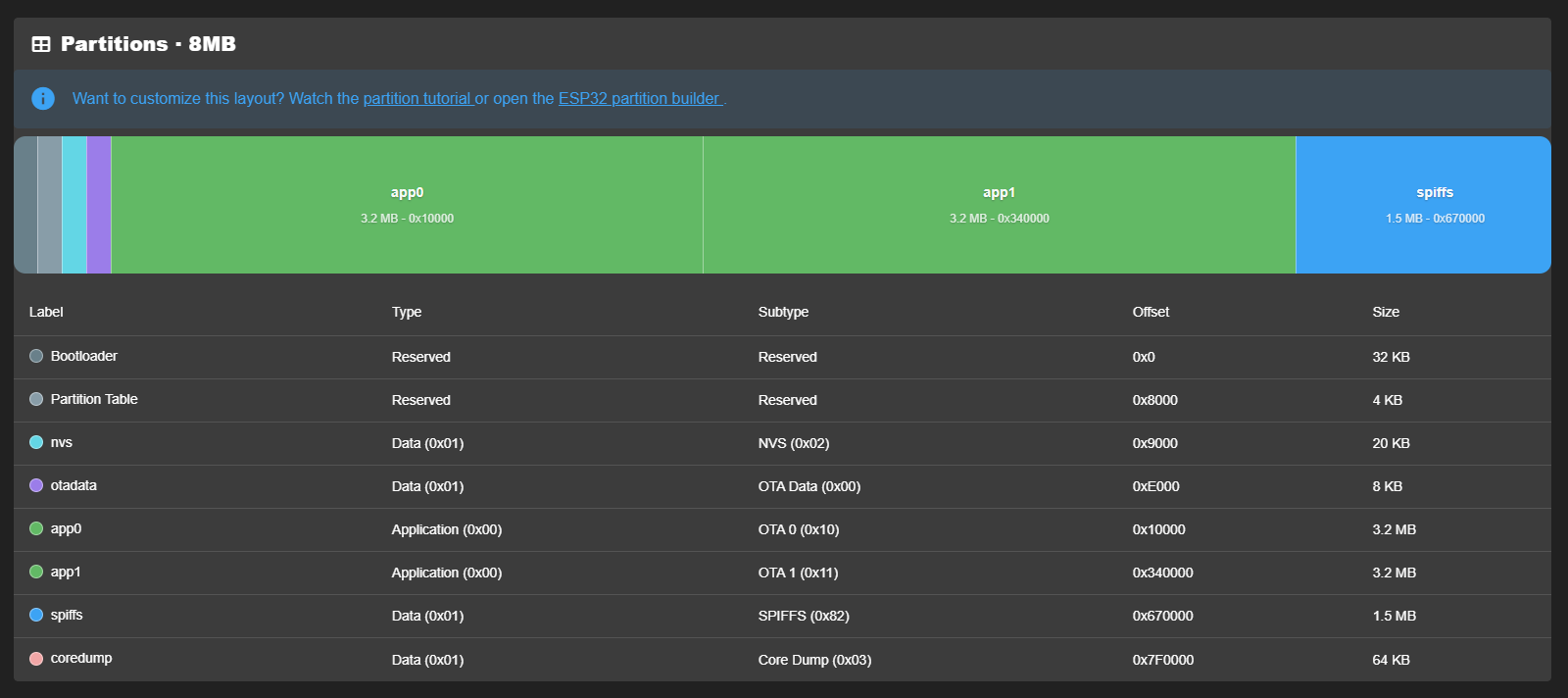

    In the Partitions tab we have the partitions from the Flash format:
    ESP32 Flash partition layout with visual map and detailed partition table

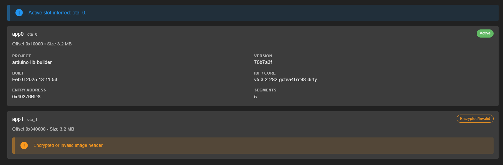

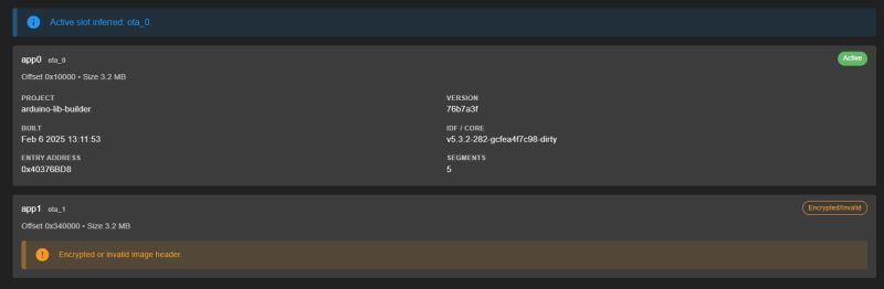

    In the App tab we have information about the program, how it was compiled, etc:
    View of two OTA slots in ESPConnect showing app details and firmware version

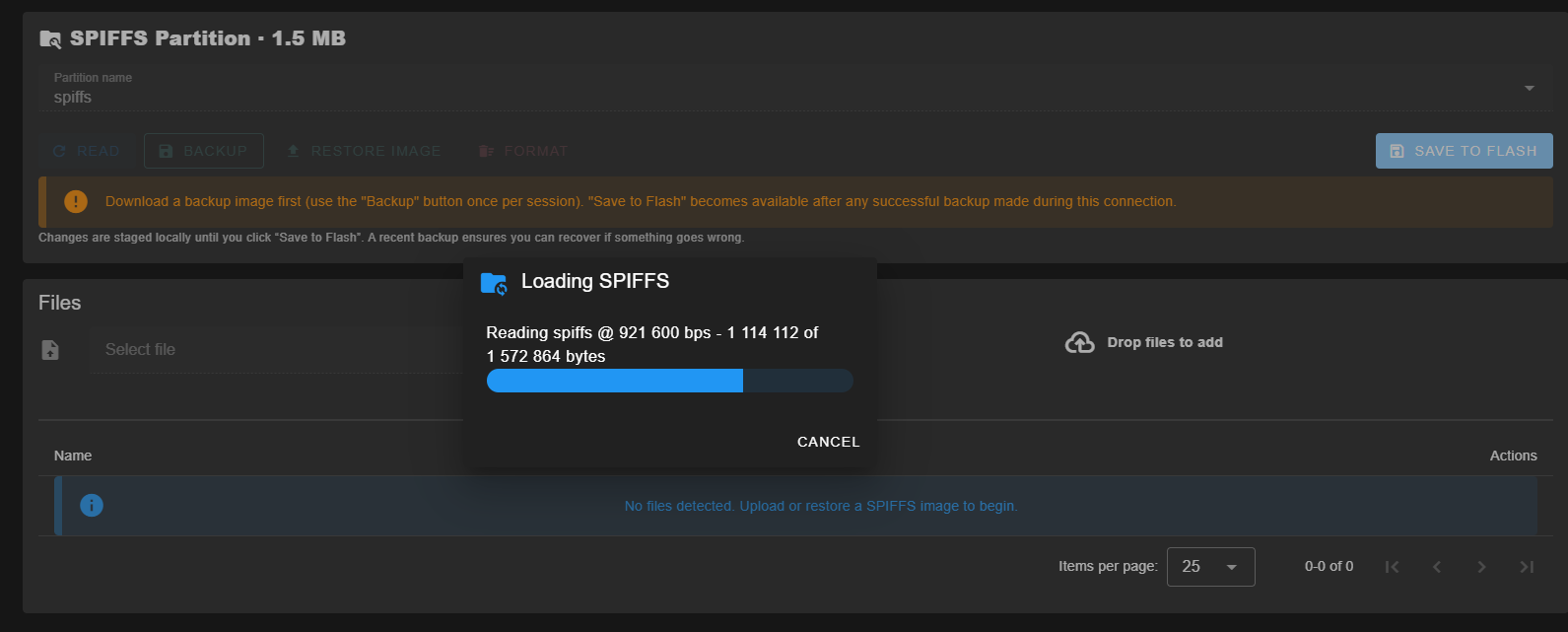

    SPIFFS allows you to manage the file system on your device. The whole idea is that we have to back up all the memory first, so we are unlikely to lose anything, even if we mess something up.
    SPIFFS loading window with a progress bar for reading flash memory data

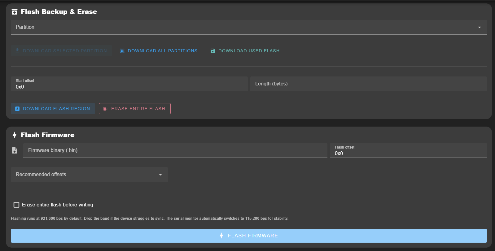

    In Flash Tools we have the usual firmware write and read operations:
    ESPConnect interface with flash backup, erase, and firmware flashing options

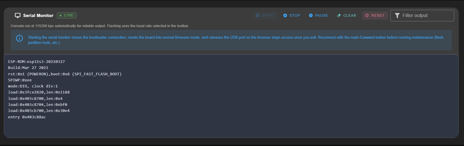

    Serial monitor is simply a serial port console - RealTerm is no longer needed:
    ESPConnect screenshot showing ESP32-S3 boot data in Serial Monitor console

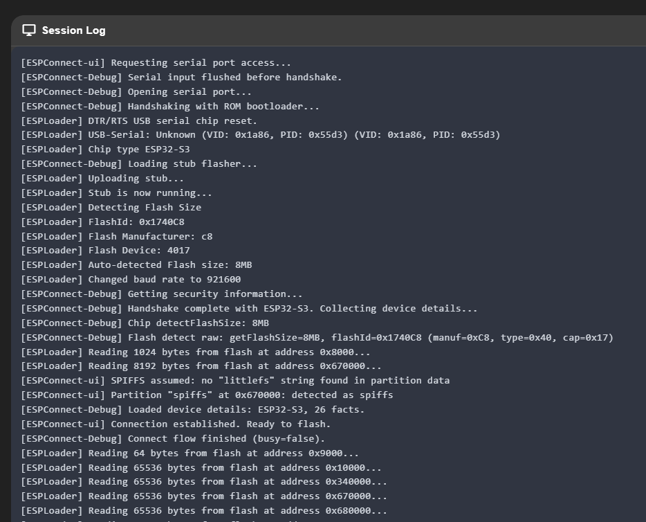

    The Session Log, on the other hand, tells us what the ESPConnect was doing - you can view there what was read, what went wrong, etc:
    Screenshot of ESPConnect's Session Log showing ESP32-S3 chip and flash memory information

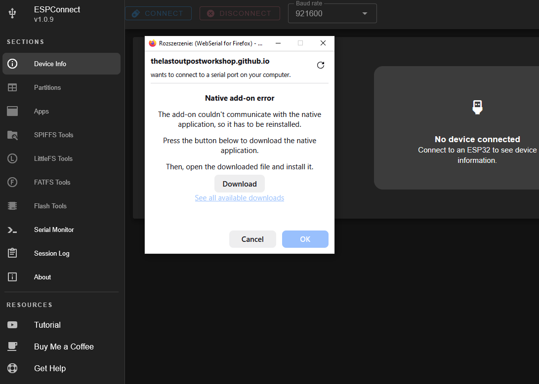

    1. Does not work with Firefox:
    This browser does not support the Web Serial API. Use Chrome, Edge, or another Chromium-based browser.
    2. Under Opera (Chromium-based):
    Processing error
    An error occurred while processing information from the device.
    Latest error: Unable to read undefined property (read 'productName')
  • #3 21783471

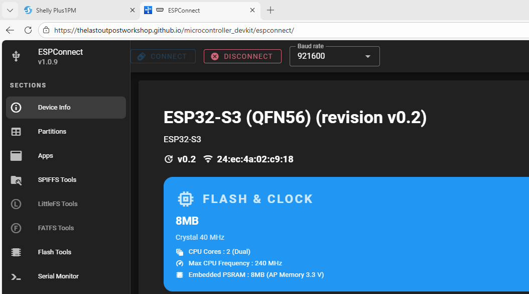

    Good idea to check it out. It doesn't work on Firefox for me either. On Edge it works:
    ESPConnect interface showing ESP32-S3 info and 921600 baud rate selected
    On my Opera it works:
    ESPConnect page in Opera browser showing ESP32-S3 device info and connection controls
    On WaterFox: This browser does not support the Web Serial API. Use Chrome, Edge, or another Chromium-based browser.

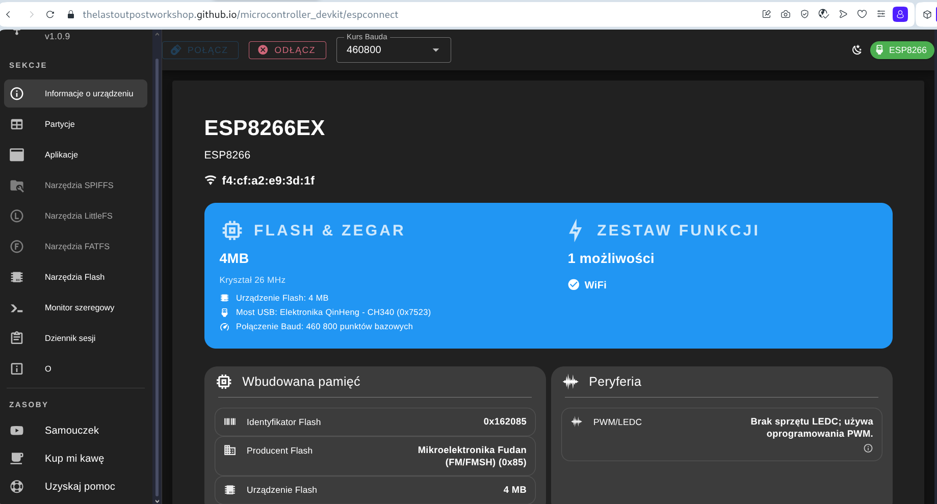

    These problems concern the ESP32 S3 (with USB-OTG).
    I connected the ESP8266 and here it worked without a miss:
    ESPConnect interface showing ESP8266EX data with 4MB flash and WiFi connection
  • Security concern over exe prompt in browser add-on
    #8 21783495
    Posts: 14771
    Rate: 12914
    Interesting, I added this add-on to Firefox and now when opening the UART port the browser suggests me to download some exe....
    WebSerial add-on error message in Firefox suggesting download of .exe application
    I took a chance, installed and:
    Error message after failed UART connection attempt with ESP32 board
    Something flawed this solution seems to be.
    And another thing is that the solution soliciting to install the exe looks weak. An attacker could also distribute malware this way.
