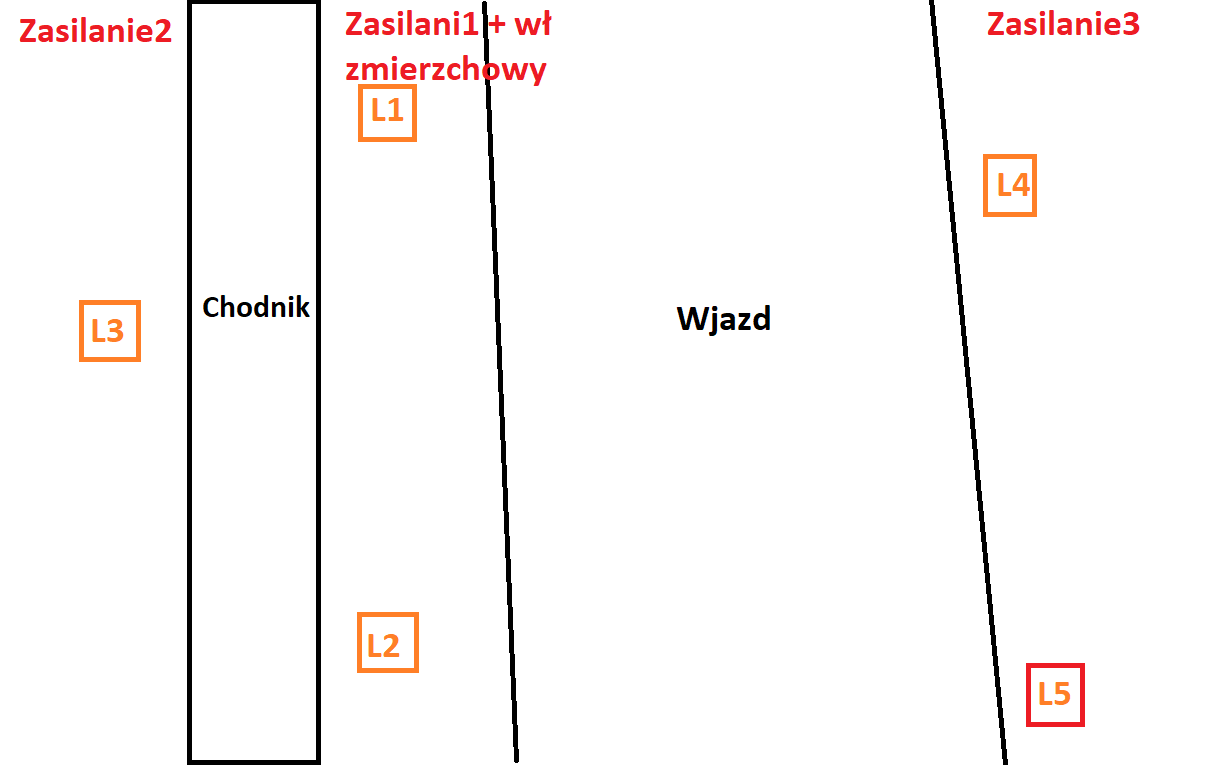

    Is there a non WiFi and Smart cloud based device that will allow five garden lights to be switched on but connected to three power sources?
    I would like all the lamps to turn on and off at the same time. Are there any radio transmitters and receivers with relays? Below is a sketch with the lamps.

    Distance between lamps:
    L1 and L2 from L3 approximately 4m
    L1 and L2 from L4 and L5 approximately 8m
    As for WiFi and the cloud, I would have to install another AP as I have practically no WiFi coverage at this location. This is a last resort. Hence looking for another solution. I was thinking of something along the radio path.
    The L1 and L2 lamps are controlled by a twilight switch. I was hoping that it would be possible to transmit the signal by radio to some receiver with a relay to the power sources of lamp L3 and lamps L4 and L5. I don't want to control this manually, but only with a twilight switch.

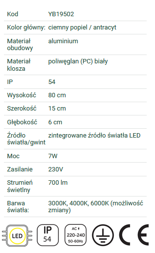

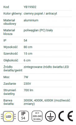

    >>21158661 Correct adjustment is possible, but will the light-sensitive probes and other components allow "reasonably" good on/off synchronisation?
    Here is the info on the lamps
    Device to control 5 garden lights without WiFi and cloud, 3 power sources?
