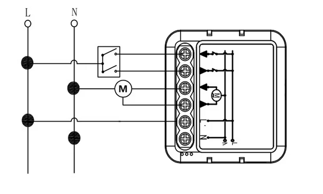

    Here is a wiring diagram for reference:
    Wiring diagram with L and N lines, a switch, motor M, and terminal connections inside a device housing
    Active signal on external buttons is LOW, while it is triggered by phase to the external contact.
    External buttons are probably made high voltage to allow the use for longer wires.

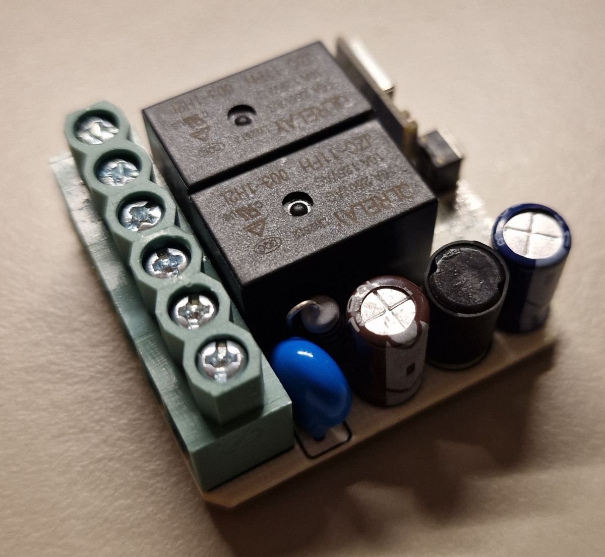

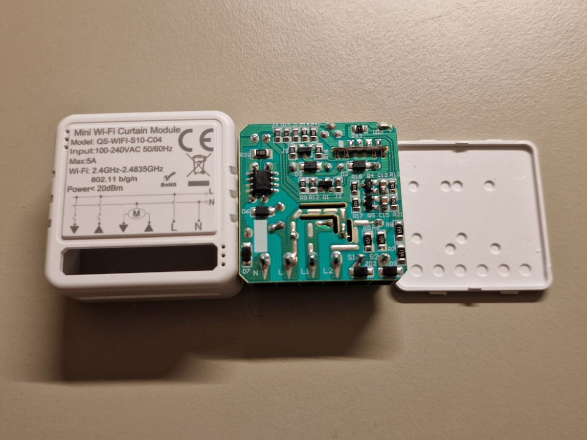

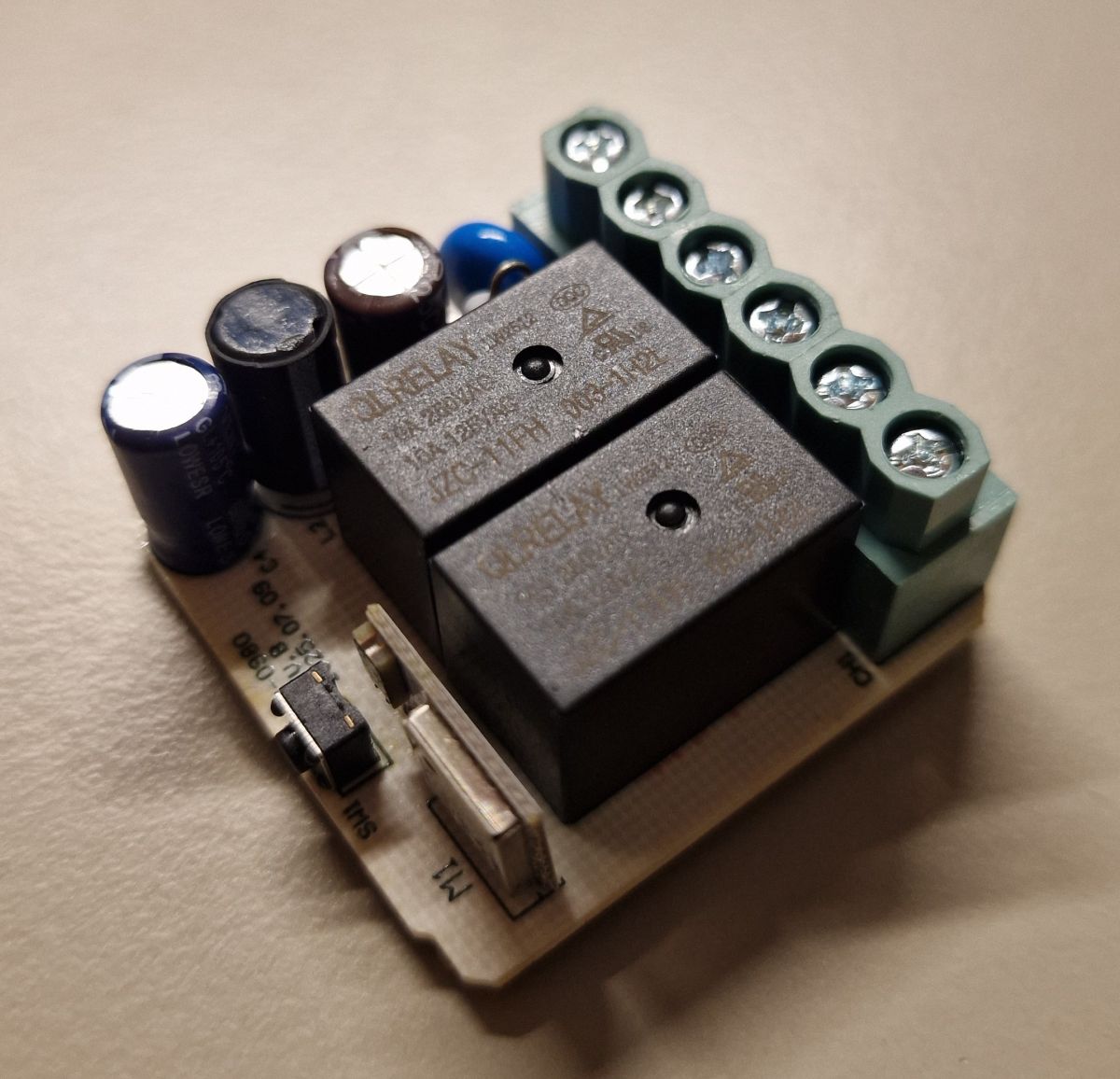

    Here is what inside:
    Opened Wi‑Fi curtain control module with exposed PCB and labeled white housingClose-up of a PCB with two relays, electrolytic capacitors, and a green screw terminal block Close-up of a PCB with a screw terminal block, two relays, and capacitors

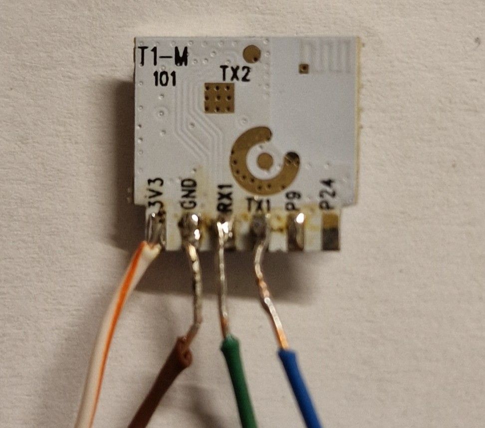

    Wifi module is T1-M.
    Flashing procedure is very human - unsolder the module and flash it with GUI Tool.
    TX RX are not connected and it will probably flash without removing module.
    Config seems to be encrypted and nothing has been automatically extracted, so I had to debug the pinout.
    Small PCB with soldered wires and pin labels 3V3, GND, RX1, TX1, P9, P24

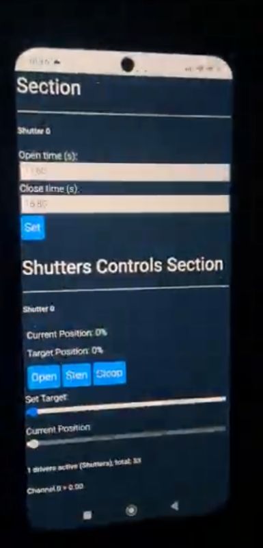

    Posts: 14770
    Rate: 12913
    Nice script, but we have internal Shutters driver in OBK now. Have you tried it?
    Smartphone screen showing “Shutters Controls Section” with Open, Shut, and Stop buttons

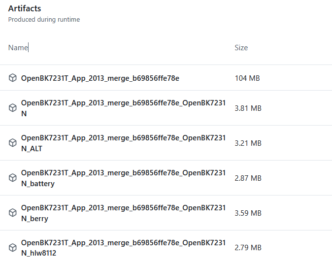

  • #6 21851426
    Posts: 14770
    Rate: 12913
    I've merged shutters driver into main tree, but it's disabled by default. Here is enabled build:
    https://github.com/openshwprojects/OpenBK7231T_App/pull/2013
  • #7 21851468
    Hamalaon
    Posts: 12
    >>21851426

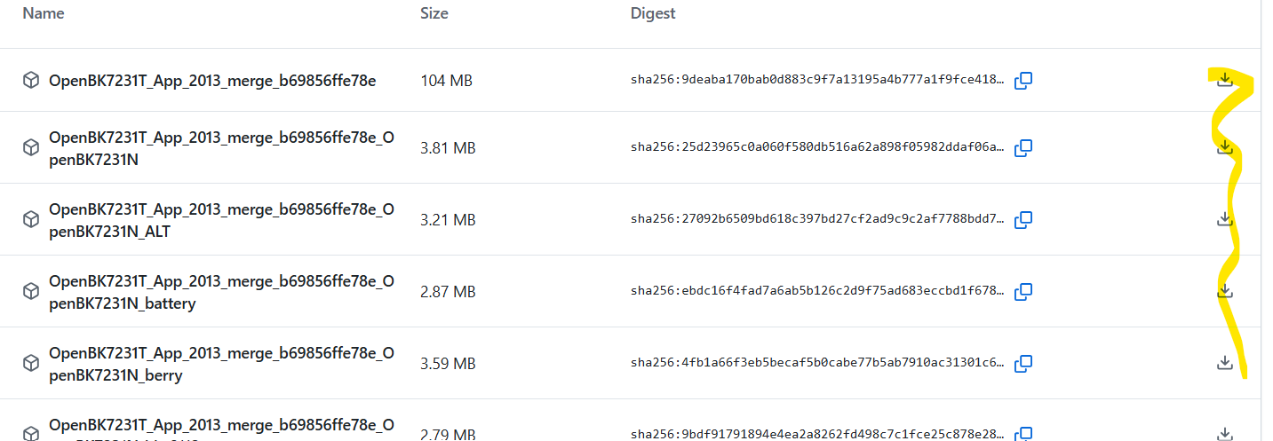

    Good. How can I download any of these files?
    Screenshot of an “Artifacts” list showing OpenBK7231T file names and sizes in MB.
  • #8 21851488
    Posts: 5220
    Help: 449
    Rate: 918
    login to GitHub first
    File list with OpenBK7231T names and download icons on the right, highlighted by a yellow line.

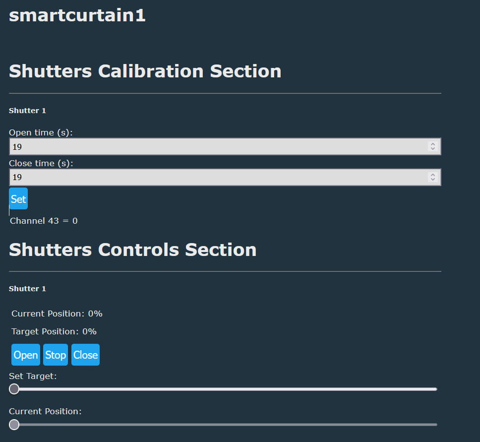

    Today I found out that login may be required to download from github.
    I have tested the new Shutters driver and from UI it works fine.
    Screenshot of “smartcurtain1” with shutter calibration and control sections and Open/Stop/Close buttons
    With updated pin roles the template looks like this:

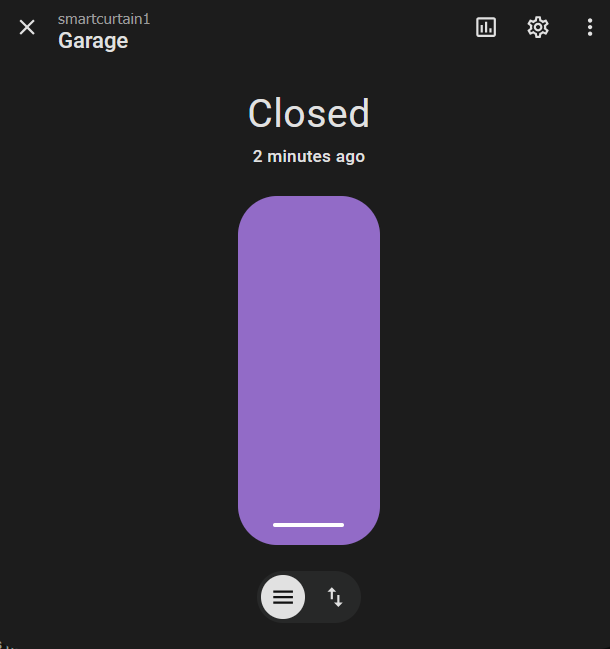

    Also works with HA
    Screenshot of a smart home app showing “Garage” with status “Closed”.
    The calibration thing does not work instantly after driver start, so I added a delay before it.
    startDriver Shutters
    delay_s 1
    ShutterCalibrate 1 19 19
    Wired buttons are not functional however. Seems like driver not getting it.

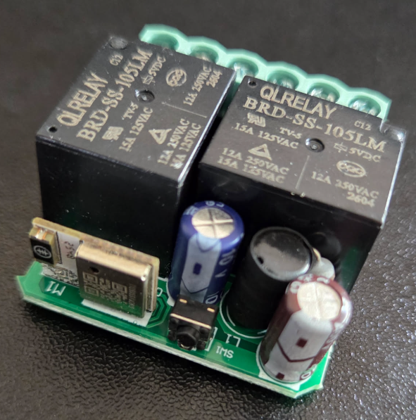

    lcapriotti
    Similar device here, different pin settings:
    "pins": {
        "6": "ShutterA;1",
        "9": "WifiLED_n;0",
        "24": "ShutterB;1",
    Small PCB with two ORELAY relays and capacitors, plus a green screw terminal block
    BtnShutterDown, BtnShutterUp are not working though.
