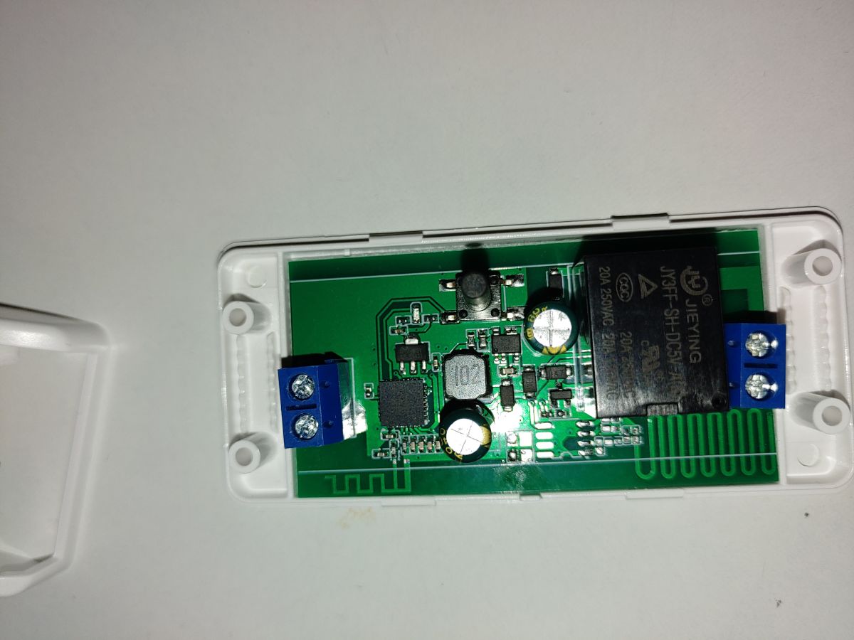

  • No visible UART points on BK7231N switch board
    #1 21850861
    leon22heart
    Posts: 72
    Rate: 7

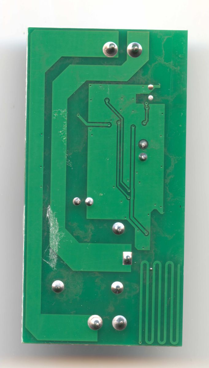

    Hello again . Got this last batch of smart switches on aliexpress. From a first glance i cant seem to find any uart points on the board. So i want to ask this , has anyone on the forum posted something similar or has any thoughts if it can be flashed with openbk ?

    Any markings on that black square chip?
  • #3 21850874
    leon22heart
    Posts: 72
    Rate: 7
    >>21850865 i am scanning now the board . Had to remove the button in order to scan properly. Will post in a little while.
    Added after 58 [minutes]:
    >>21850865
    T34
    Z547GYYJ9
    Y50B3C
    or
    T34
    2547GYYJ9
    X50B3C
    Seems to be a Beken BK7231N
    Ps1 if pin 2 and 3 are tx and rx i think i have found them on the back of the board. Missing vcc and ground.

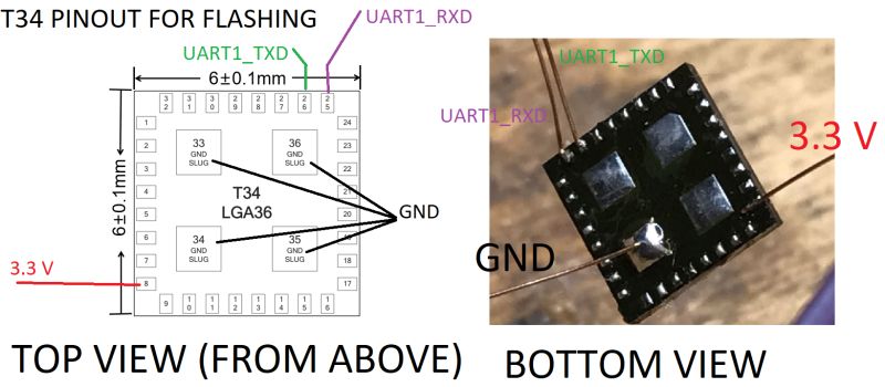

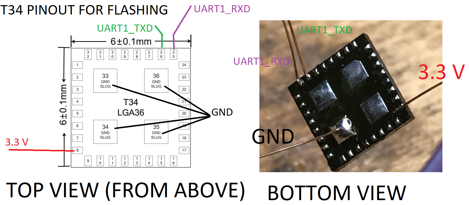

    #4 21850996
    Posts: 14755
    Rate: 12881
    Where do you see RX and TX?
    This is T34 (BK7231N).
    T34 LGA36 flashing pinout diagram and a bottom-view photo labeled UART1, GND, and 3.3 V connections

    >>21850996 the shematic i saw was for 7231t . So either its t or n or the rx tx are not connected to the board.
    #6 21851049
    Posts: 14755
    Rate: 12881
    Here is T34 guide:
    https://www.elektroda.com/rtvforum/topic4151159.html
    I think you still have easier scenario, you have physical access to TX and RX on pads of the T34, you can solder a very thin wire there...

    >>21851049 thank you my friend i think i absolutely fall in this scenario. Thankfully i have a solder station with heat gun. Bad thing is i never tried for someting this small.
    #8 21851053
    Posts: 14755
    Rate: 12881
    Well, you can try on scrap boards first. Get some old device and play around...
    One of the crucial things is to use thin wires, if you solder huge wire directly to T34 pad, you will tear off the pad.

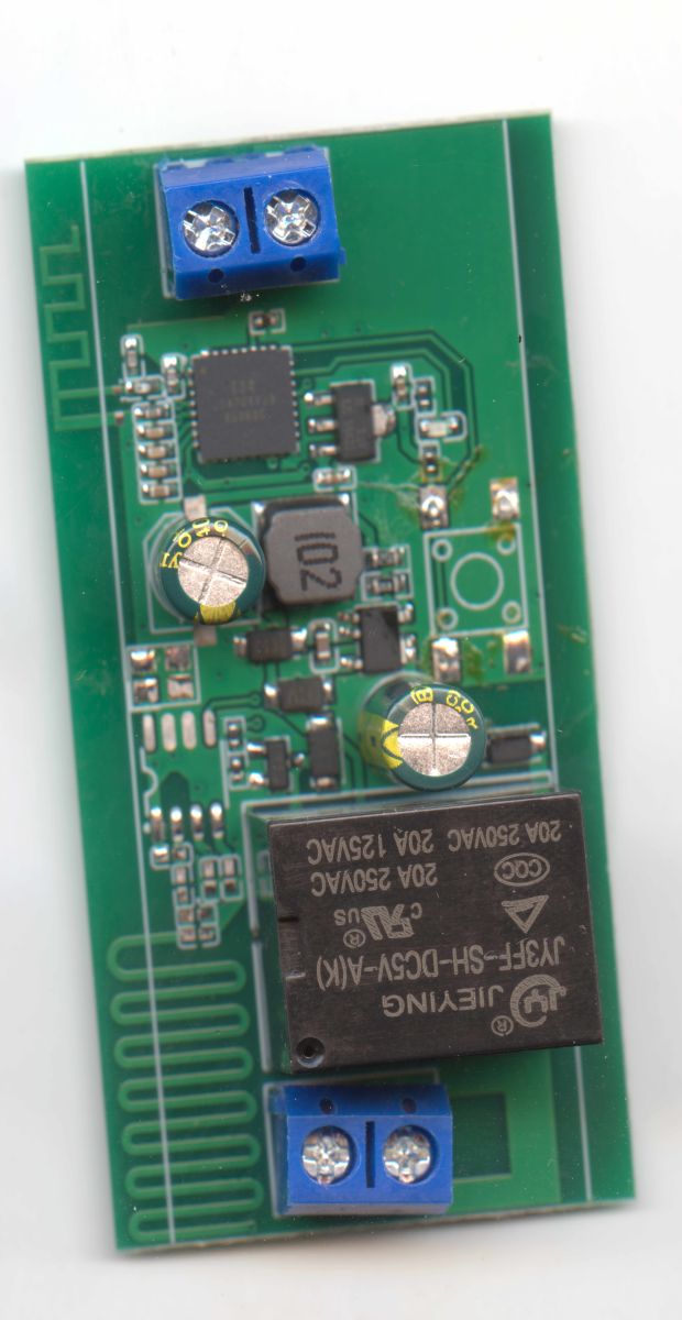

    #11 21851127
    leon22heart
    Posts: 72
    Rate: 7
    >>21851105 Unexpectedly it went perfect . Posting firmware for the collection . Will update the template . Have another 3 to flash.

  • #12 21851145
    Posts: 14755
    Rate: 12881
    Yes! Did you also manage to solder it back in place?
    I usually solder it back in place on the same solder as it used to be, altough I often see people cleaning ICs with solder wick and applying new solder.

    #13 21851149
    leon22heart
    Posts: 72
    Rate: 7
    >>21851145 using the same solder as it had . Have no confidence to add more solder or clean the pads . if it was a bigger chip np . Also i use the creamy solder wick not the liquid one thus making it more difficult.
    ps1 flashed and soldered successfully my 2nd switch .
