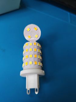

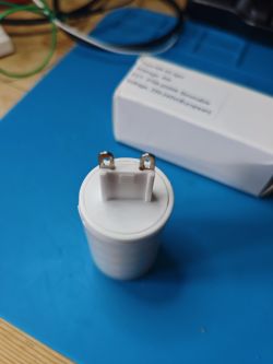

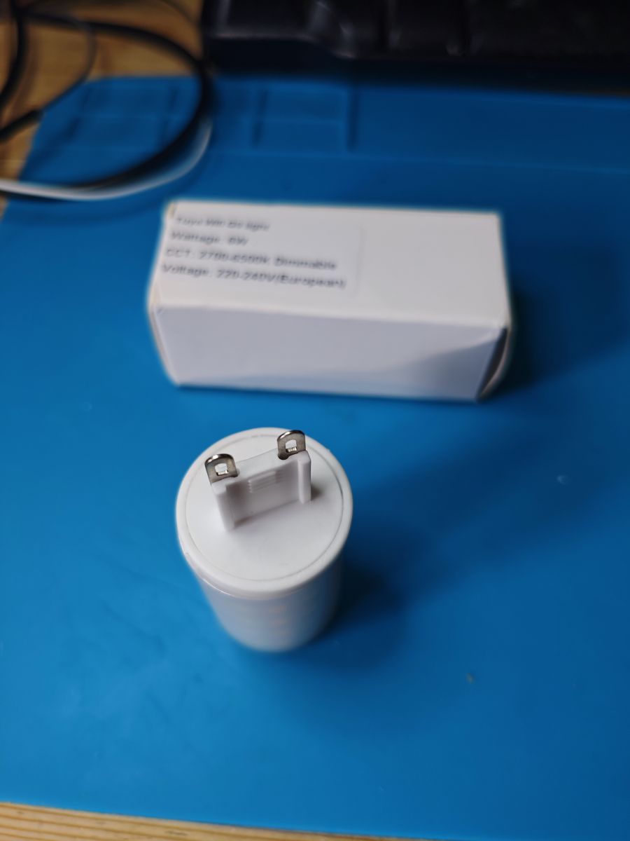

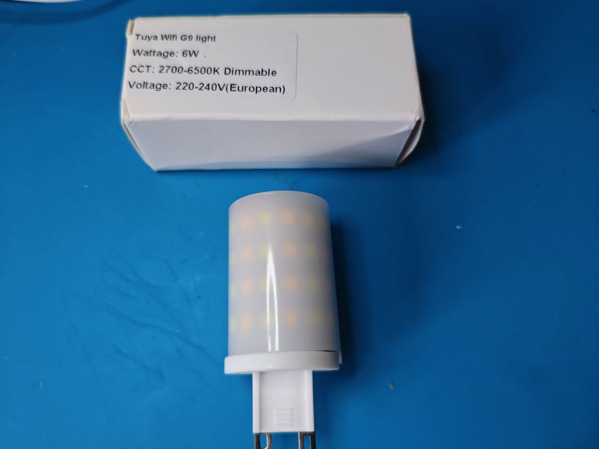

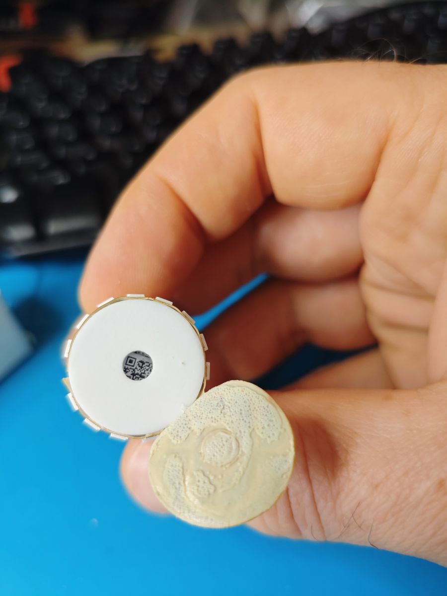

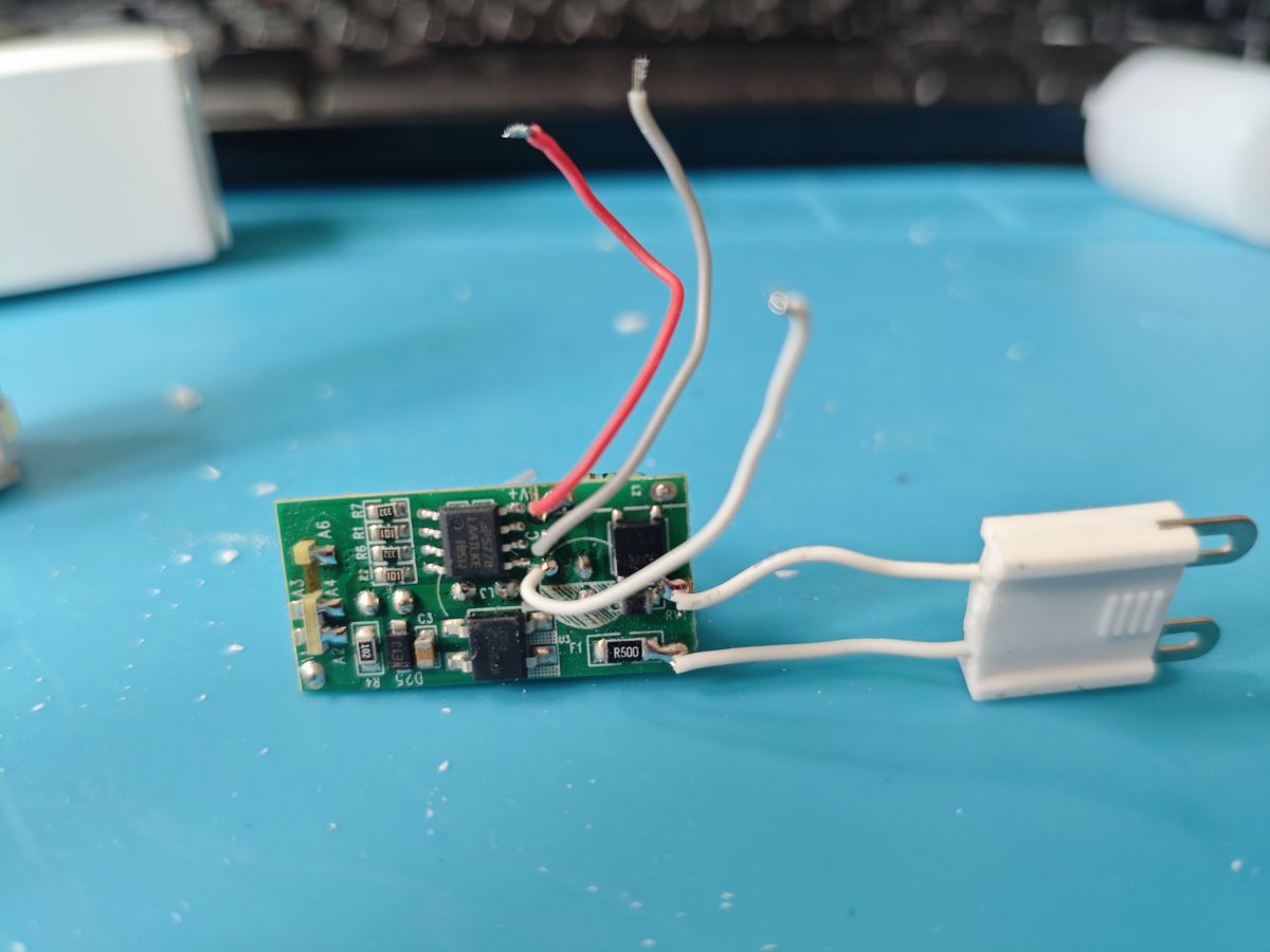

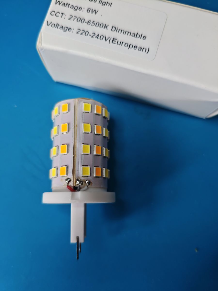

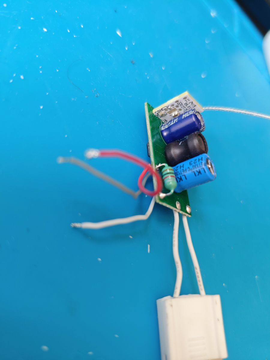

    This is a generic Tuya G9 LED smart bulb. The device looked interesting and I haven't seen any teardowns on the internet for bulbs of this form factor. I didn't even know G9s were a thing. I was hoping for some exotic new module perhaps. I do not have any light fixtures for the G9 to plug into so it would need wiring up for testing.
    Tuya G9 smart LED bulb with mobile app on screen.

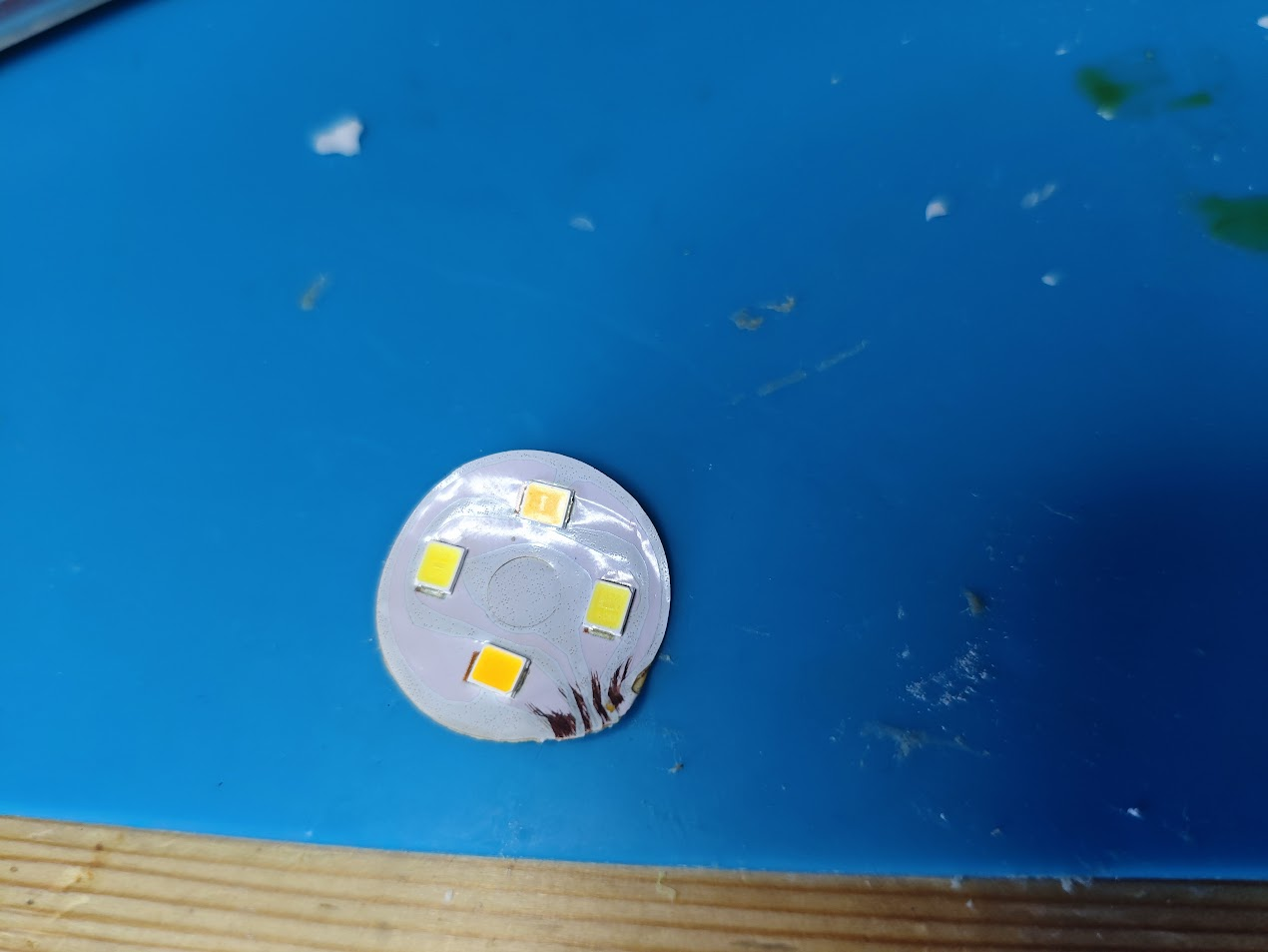

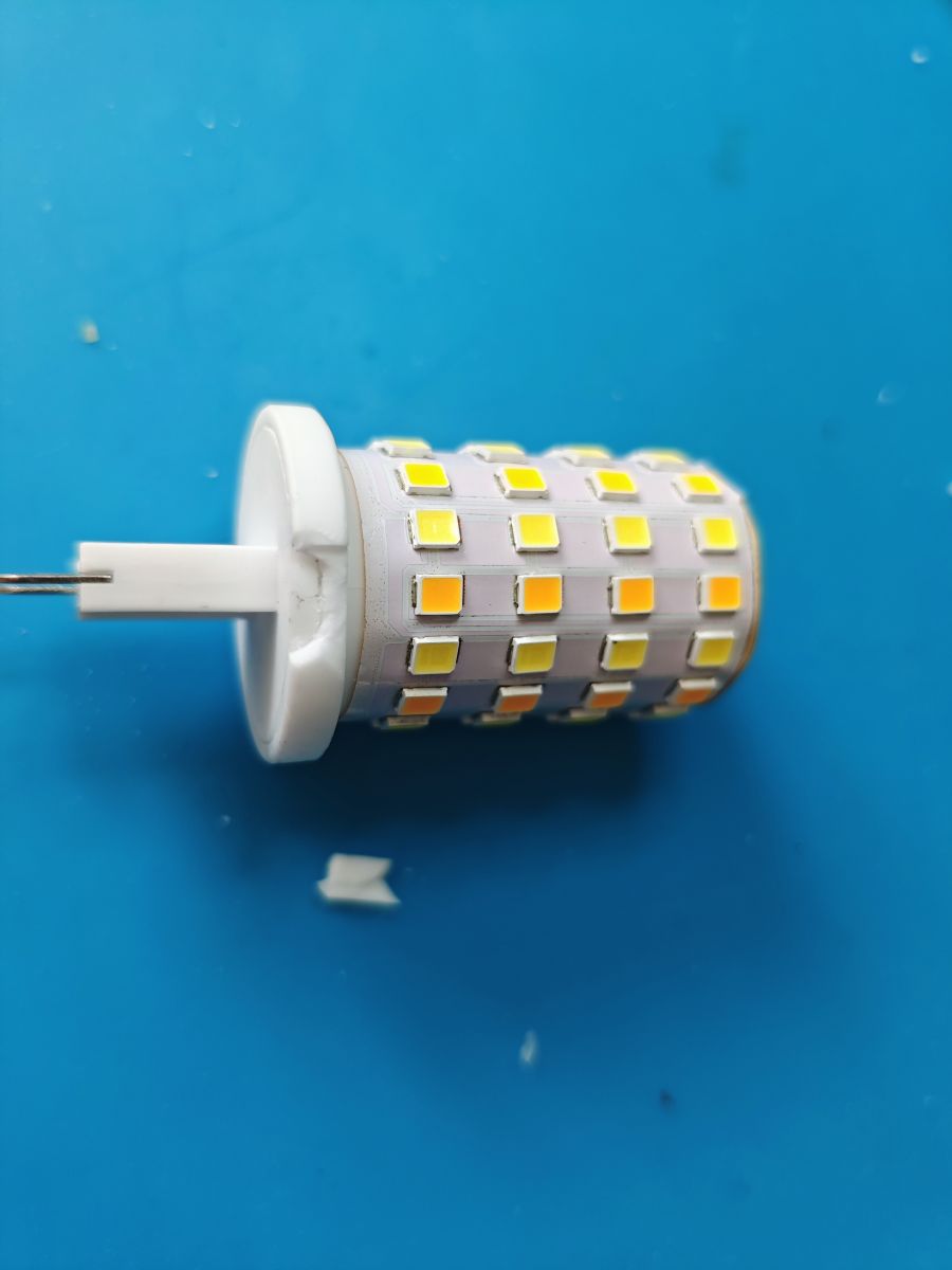

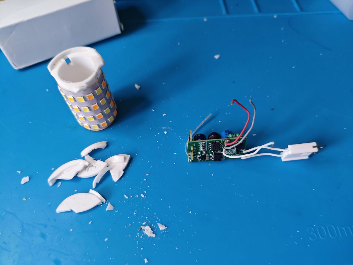

    Unfortunately, the main body is ceramic, presumably because of the heat potential, and so getting it apart proved impossible without breaking it.

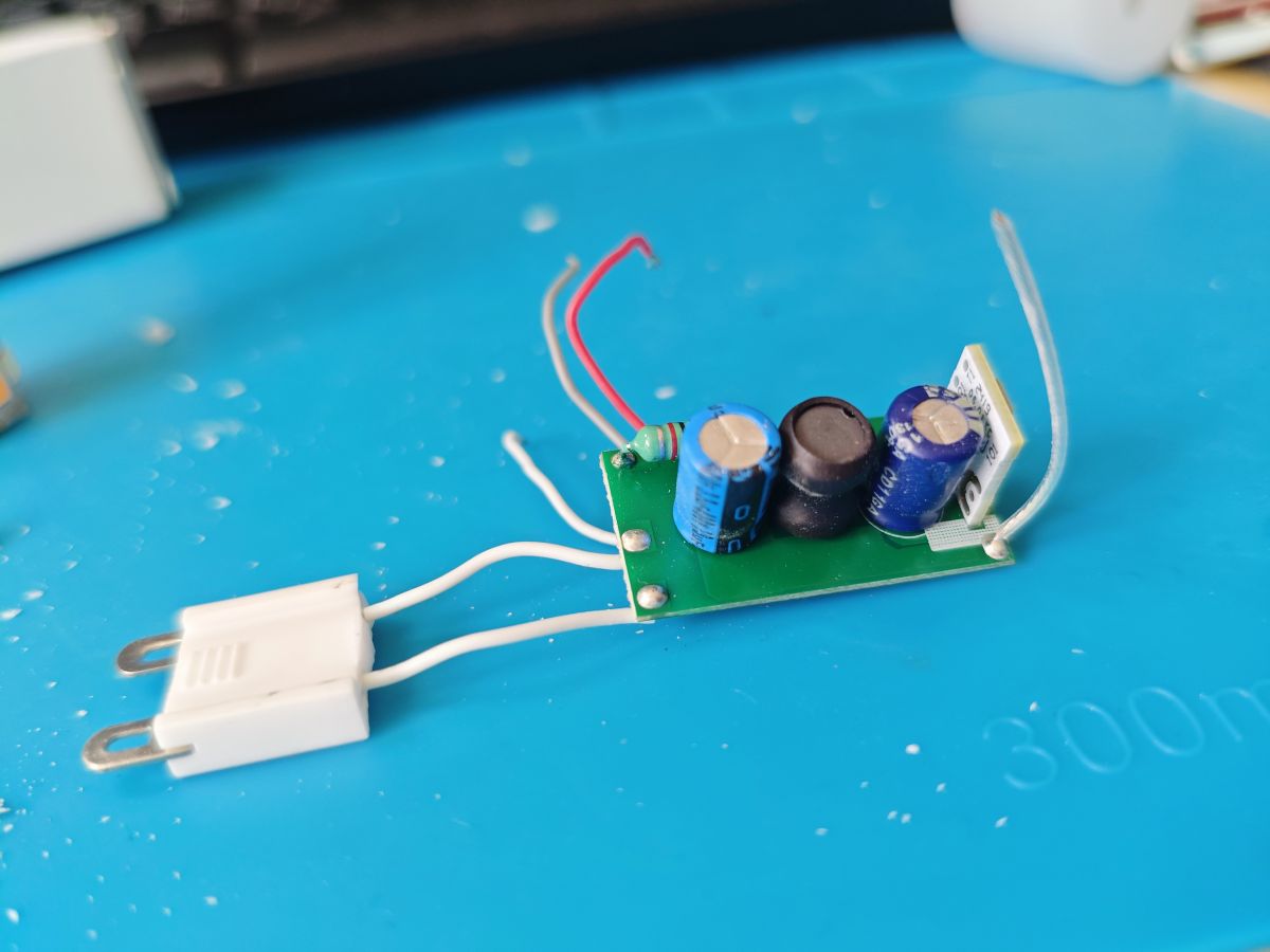

    Electronic circuit board with components on a blue surface Photo of a Tuya electronic module with visible components on a blue background. LED bulb electronic module on a blue mat. Interior of a smart LED bulb with visible electronic components on a blue background. Electronic module with wires on a blue background. Electronic circuit board with integrated circuit and connected wires on a blue background Close-up of a circuit board with connected wires. Dismantled Tuya G9 smart LED bulb disassembled into parts. Smart LED bulb Tuya G9 with LEDs on a ceramic cylinder. Disassembled Tuya G9 smart LED bulb on a blue background. Smart Tuya G9 LED bulb with cover removed. Tuya G9 LED bulb with BK7231N chip and LED diodes. A Tuya G9 smart LED bulb lies on a blue surface next to a white box. View of a Tuya G9 smart LED bulb on a blue mat, with a white box in the background. Smart LED bulb Tuya G9 and its box on a blue surface.
    in my haste to peel off the main flexible LED skin around the body, I didn't notice the top lid had stuck back down, so I sheered that off! 😡
    View of an LED module on a blue background.

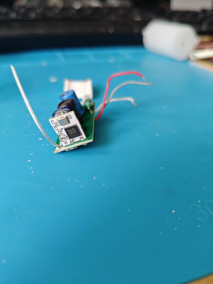

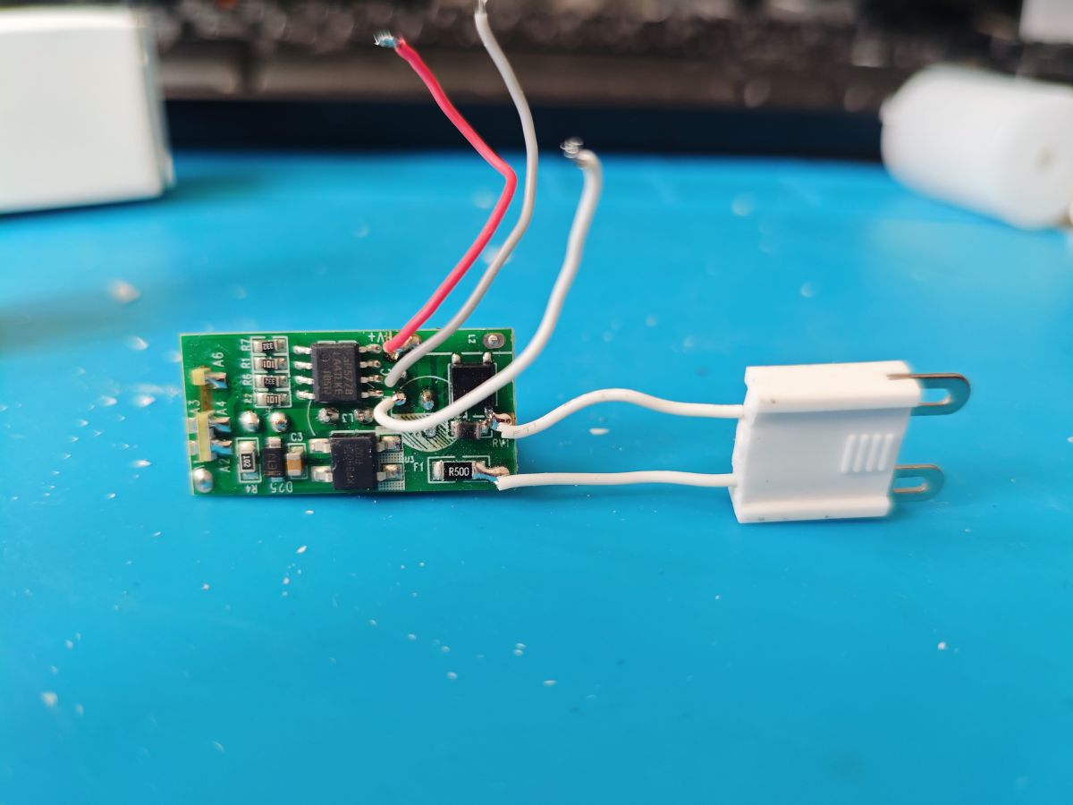

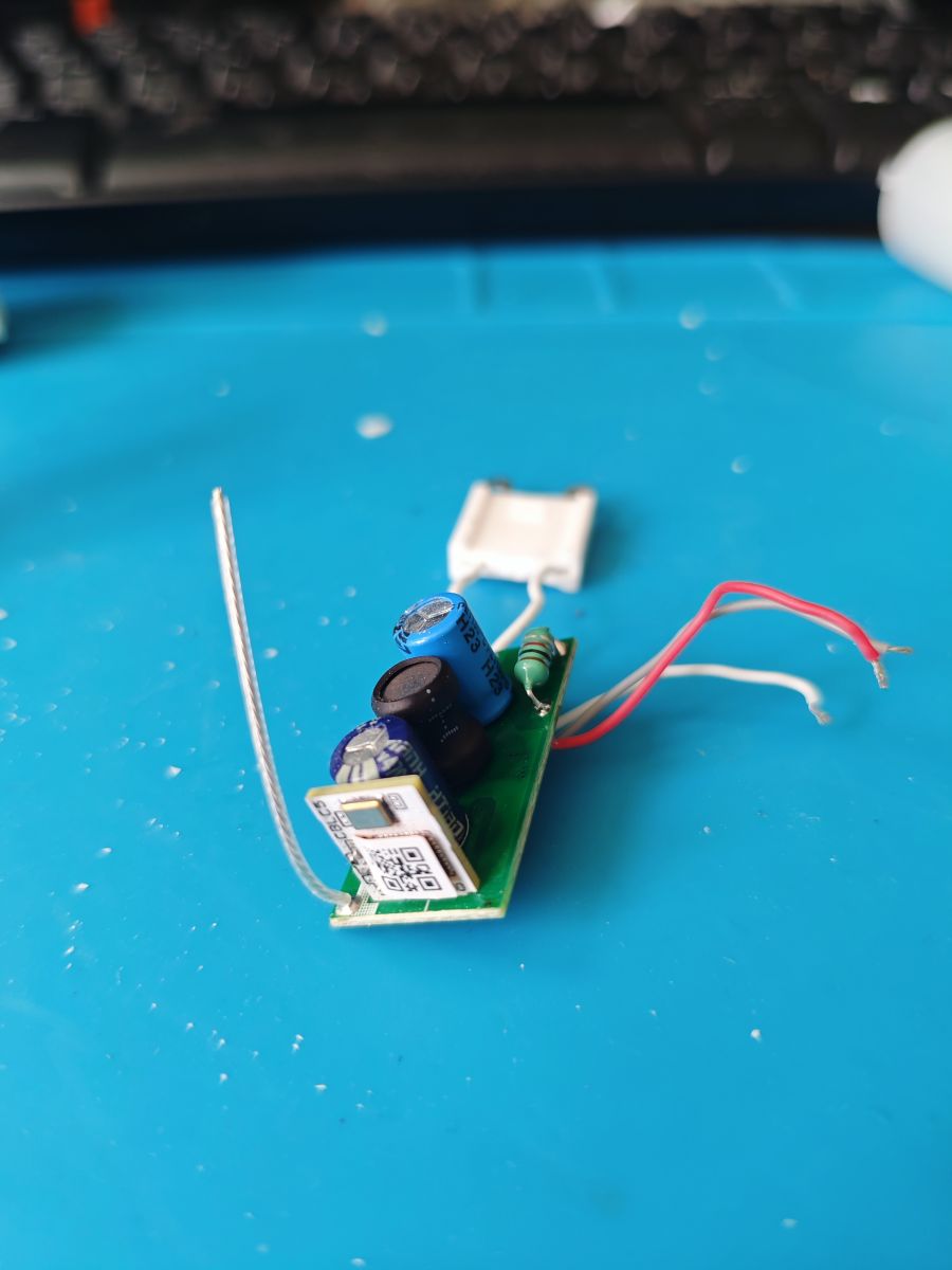

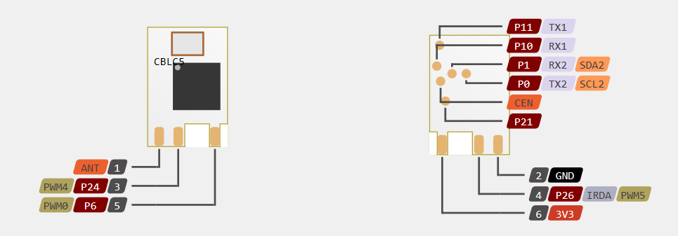

    So, a standard BK7231N CBLC5 module. I unsoldered that and hooked up 3v3 and GND to an external power source. Ground shared with a USB-TTL and pogo pins used to get the boot log from TX2.
    Circuit diagram with pin designations for the CBLC5 module.

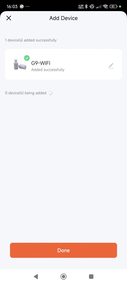

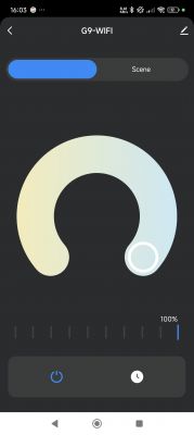

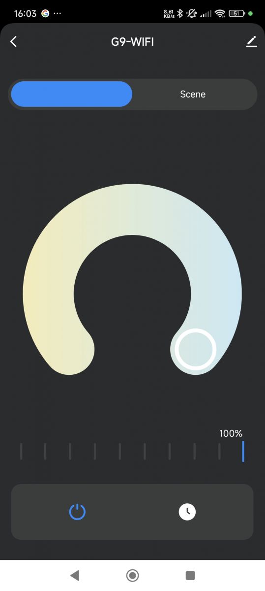

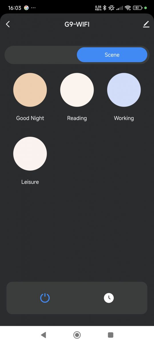

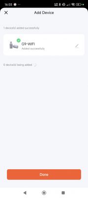

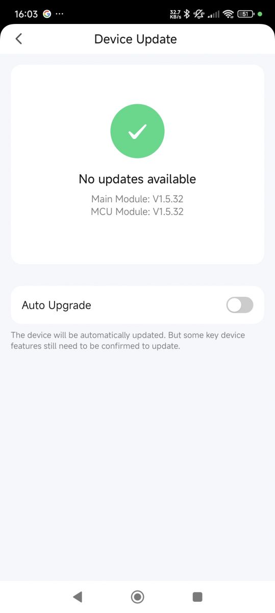

    Paired in Tuya app
    Device update screen with a message indicating no updates available. Tuya app interface with light scene options for G9-WIFI bulb. Control app for G9-WIFI smart bulb showing light color adjustment. Device adding screen showing successful addition of G9-WIFI device.
    fw version 1.5.32 so not cloudcuttable, which is a shame because I'm not sure this is a goer for cutting off from the cloud otherwise. Maybe the glue holding the ceramic base in can be dissolved somehow in a solvent.
    Factory fw dump attached. Easy Flasher extracted the config without issue

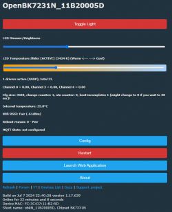

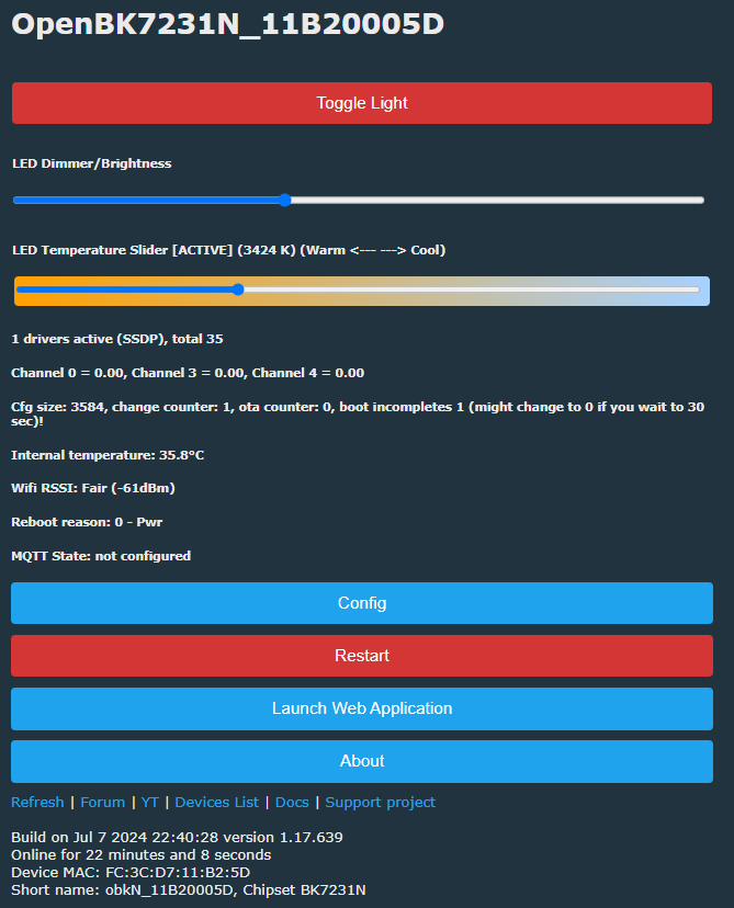

    making the template
    OpenBK7231N software interface with LED bulb control options

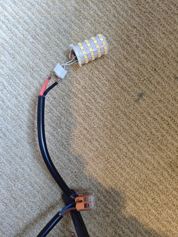

    Sadly ripping off its lid was catastrophic so the LEDs do not light. OBK boots fine though.
    Dismantled Tuya G9 smart LED bulb with connected wires on a carpet background.
