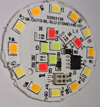

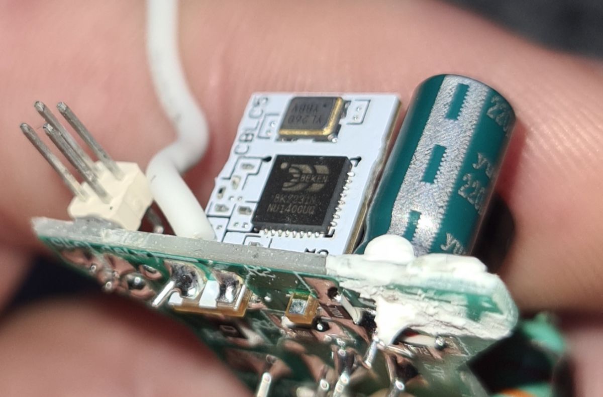

    Hi all,
    Packaging of the LSC Smart Connect bulb model 3004919 with energy label. Label on packaging with a barcode and product information alongside recycling symbols. Packaging of the LSC Smart Connect LED light bulb Printed circuit board with multicolored LEDs and BK7231N chip. Close-up of a circuit board with a BK7231N chip and a capacitor visible.
    I have flashed before some LSC GU10 devices using the BK7231T version but now i bought some new ones which have the BK7231N chip and also another driver then the ones listed before.
    For flasing using tuya-cloudcutter use the profile 1.3.21 BK7231N.
    After flashing completes configure the module with the following options:
    "24": "BP5758D_CLK;0",
    "26": "BP5758D_DAT;0"
    I have already two different versions with another map.
    One default so no changes are required and the other one needs the following map (startup command):

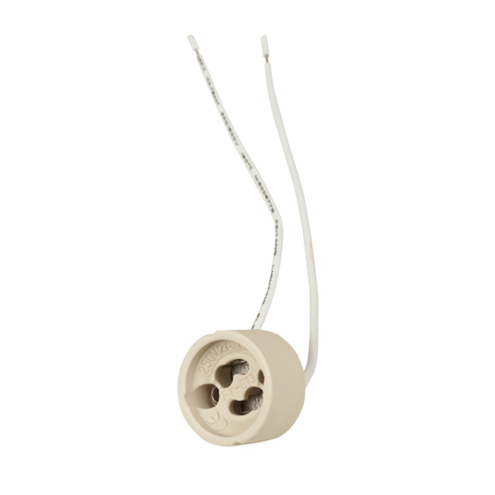

    These gu10 is a bit tricky to dismantle, thinking of getting this gu10 holder and just pull/tilt until the pins are removed securely
    GU10 socket with wires.
