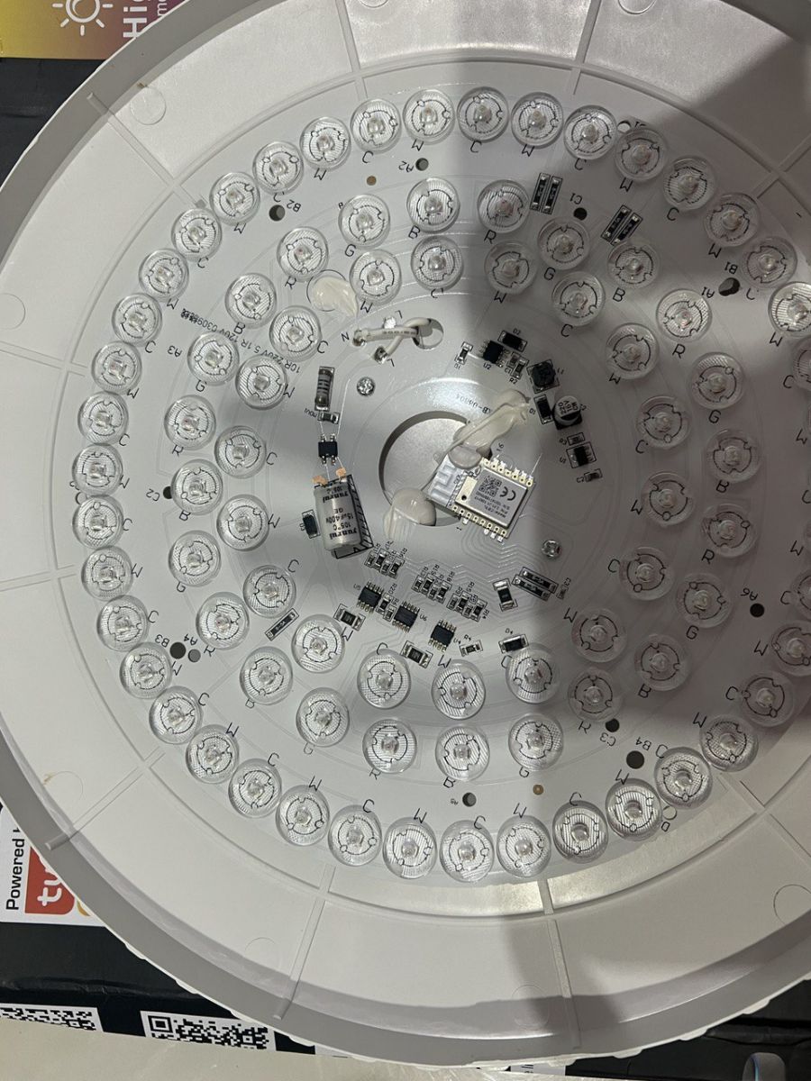

    Teardown Photos:
    Box of a Tuya smart WiFi ceiling light, model LSC RGBCW. Tuya sky-BK smart ceiling lamp resting on a box. Interior of a smart ceiling lamp with visible LEDs and electronics. Image of an electronic module with BK7231N chip on an LSC ceiling lamp

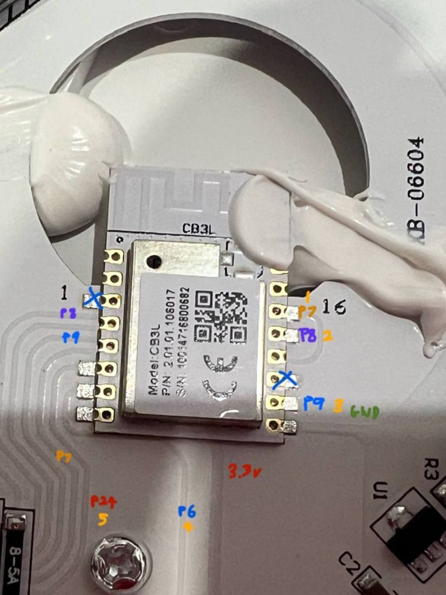

    Pinout:
    CB3L/BK7231N module mounted on an LED lamp board with pin numbering marked.
      "vendor": "Tuya",
      "bDetailed": "0",
      "chip": "BK7231N",
      "board": "TODO",
      "flags": "134484995",
      "keywords": [
        "TODO",
        "TODO",
        "TODO"
      "pins": {
        "6": "PWM;4",
        "7": "PWM;1",
        "8": "PWM;2",
        "9": "PWM;3",
        "24": "PWM;5"
      "command": "",

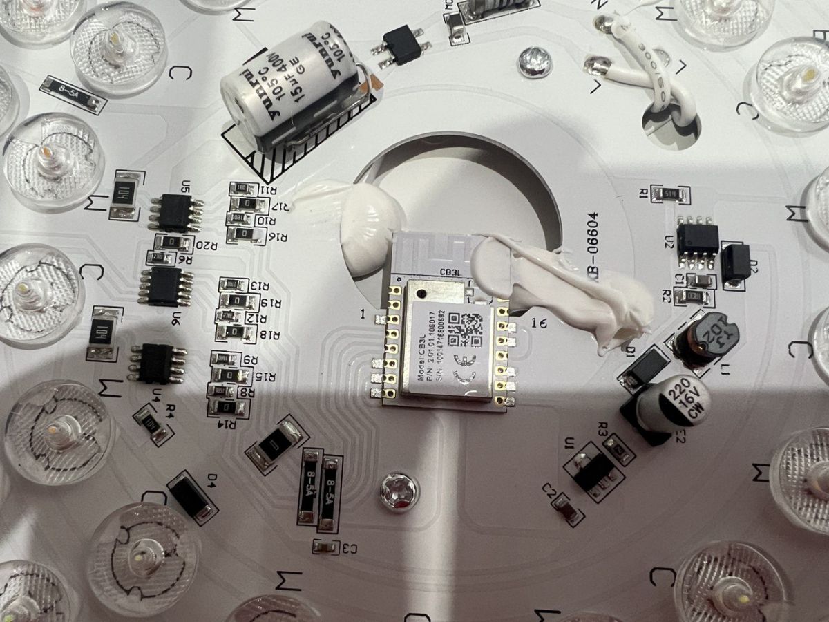

    Anyway I'm having difficulty to desolder the chip with hot air off the LED plate, even with flux & extra solder added to the pads, I'd appreciate some advice to desolder it properly.
  • Desoldering advice for BK7231N chip removal
    #2 21156200
    Posts: 5220
    Help: 449
    Rate: 918
    how come you want to desolder? it seems like you have already flashed it...

    It's usually easy to desolder chip but this is the first one that I have with the chip on the led plate.
    It's not budging even after 4 minutes of hot air with flux and I'm worried about damaging nearby components if I exposed them any longer.
    Btw, I'm using the default 360 C temperature for the hot air rework station
  • #4 21156206
    Posts: 5220
    Help: 449
    Rate: 918
    hmm OK. I think I'd suggest more pb solder, flux and faster swiitching between pad sides before it solidifies, but it sounds like you already know this method.

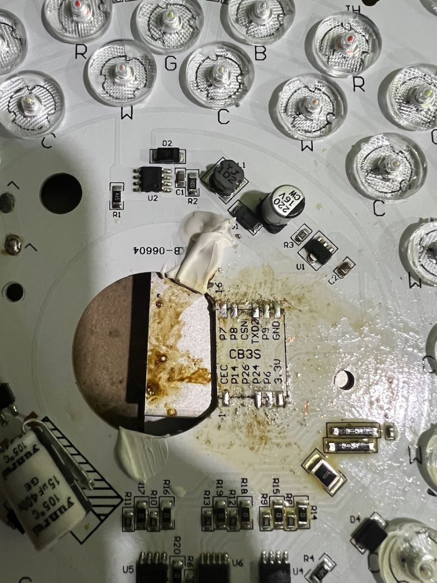

    but what will you do with the module once desoldered?
    Swapping it with esp for tasmesh, i need something that works when I’m using lights with detached mode if wifi goes offline
    Are you using flux to desolder the chip?
    Have you tried adding Pb solder to the pads?
    Trid adding flux and solder, but didn’t really work for me
    I actually ended up ripping the pads for the first ceiling light. Was able to get it working again by etching off some of the copper trace to the pad and solder wires to the chip
    divadiow wrote:
    there is currently only 1 other CB3L device in the device list
    Apparently it’s placeholder for cb3s but they used cb3L
    Close-up of the inside of a lighting module with a visible PCB and electronic components, such as a capacitor, LEDs, and a CB3S chip.
