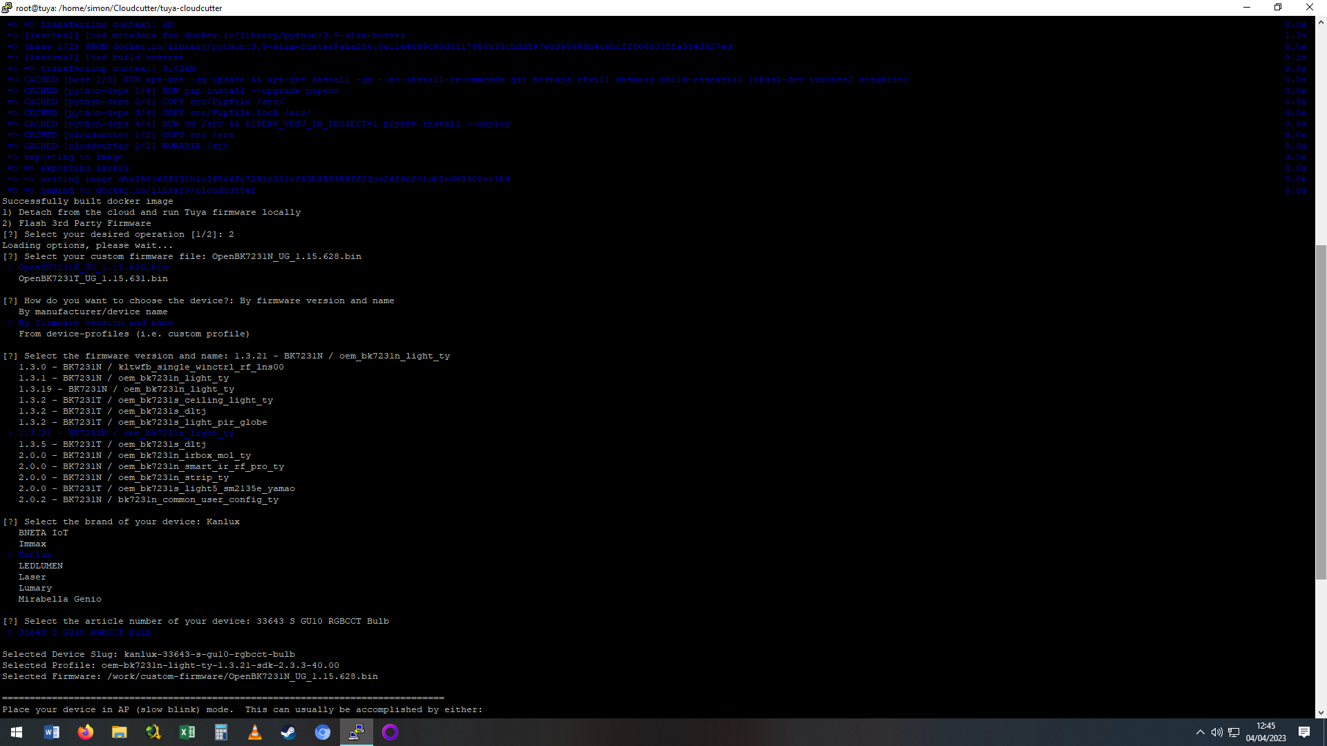

    Flashing OpenBeken firmware:
    Using cloudcutter
    [BK7231N - CBLC9] Teardown & Flashing GY GU10 RBGWW: Tuya Module, Pin Config & OpenBeken Fir
    Select OpenBK7231N / By Fimware version and name / 1.3.21 BK7231N / Kanlux / 33643 GU10 RGBCCT

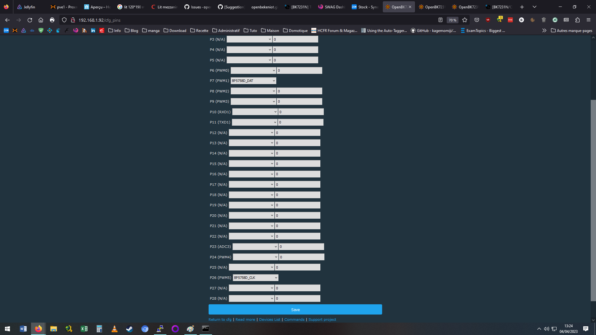

    after the firmware change, for pin configuration
    P7 = BP5758D_DAT
    P26 == BP5758D_CLK

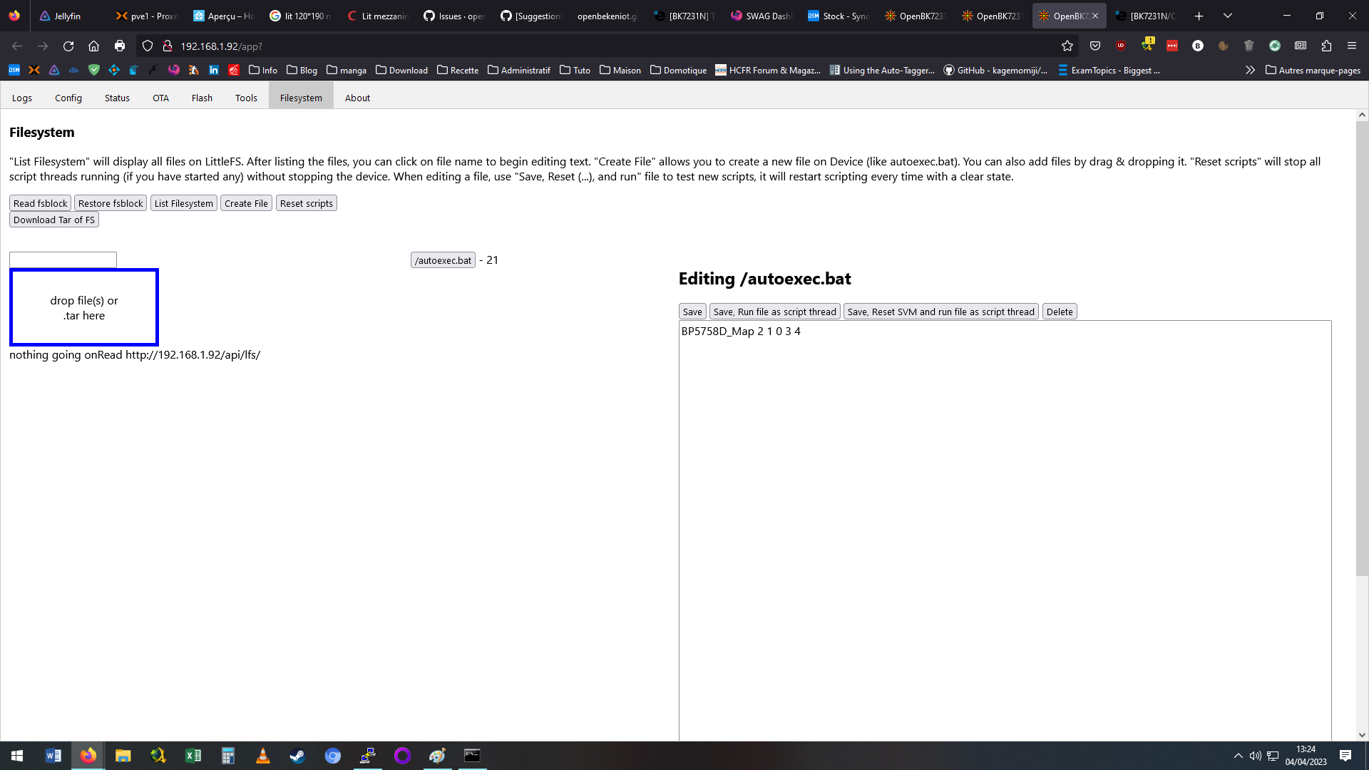

    add the start command
    BP5758D_Map 2 1 0 3 4
    Enjoy

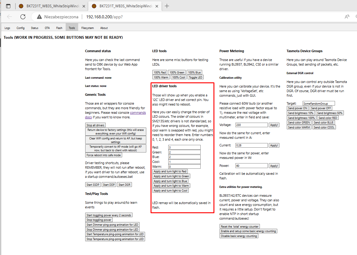

    Thank you, I will just add that, starting with latest updates, the LED Map can be done via Tools tab:
    Added after 3 [seconds]:

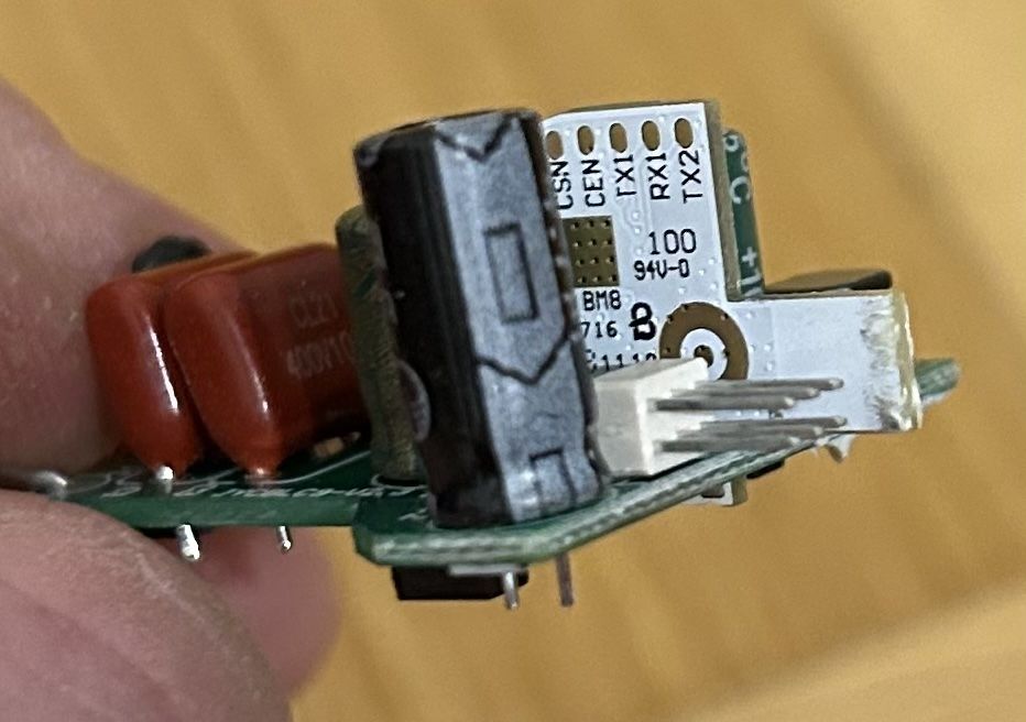

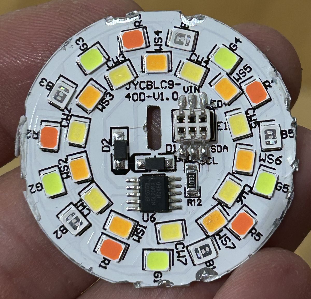

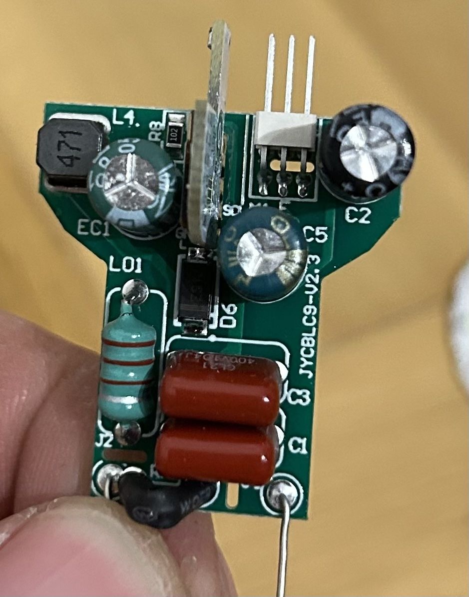

  • Teardown method for accessing CBLC9 serial pins
    #3 21282126
    sboldt

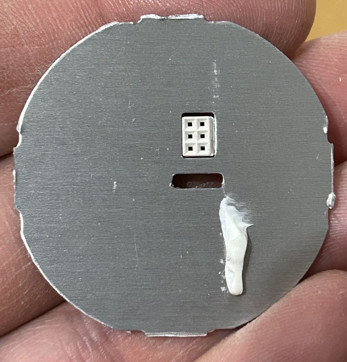

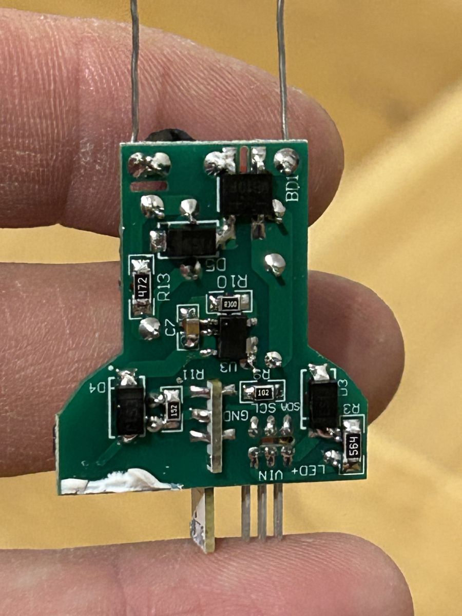

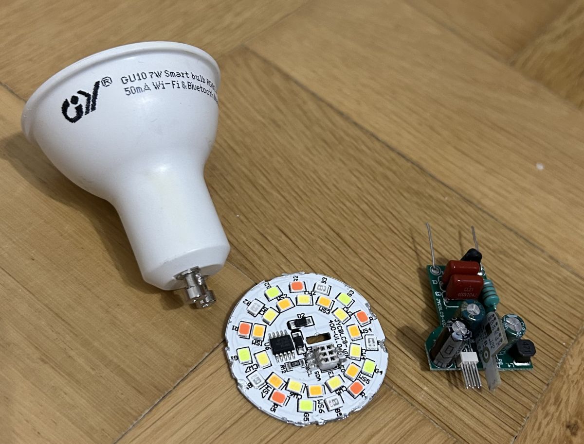

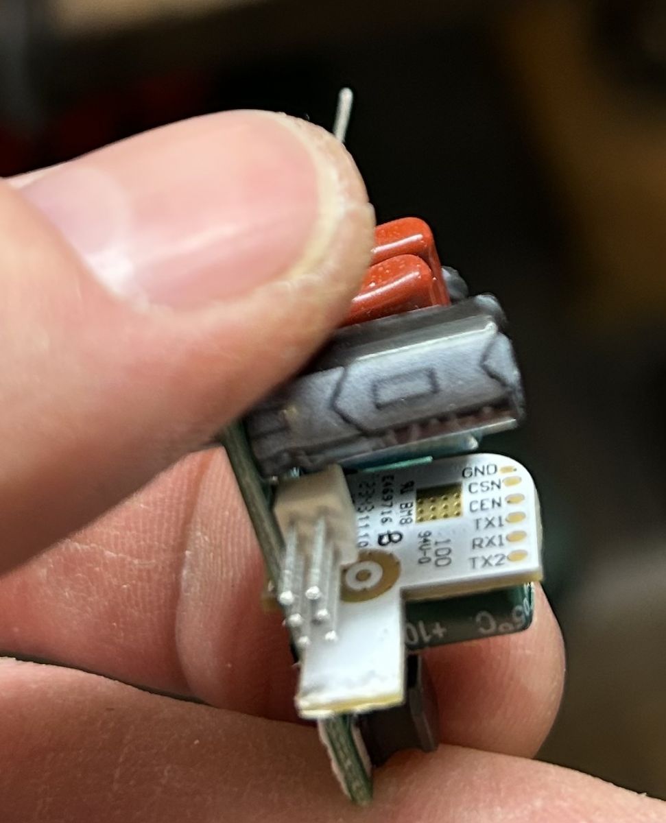

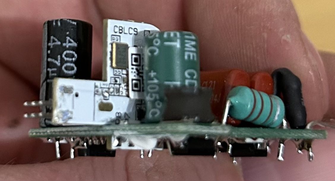

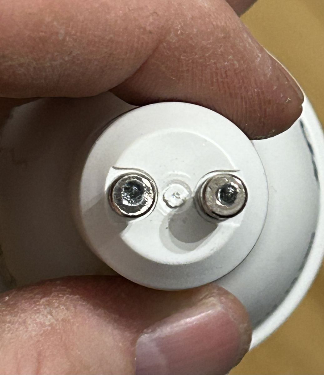

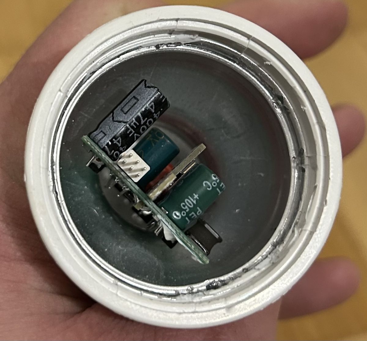

    Sadly with the current firmware the cloud cutter way is no longer possible. Therefore I opened one bulb to see how easy it is to flash it using serial cable. I did not try to flash it yet but got some experiences about opening the bulb and accessing the CBLC9 chip that I would like to share with you.
    1. Removing the transparent cover: Easy, because it is not glued. You can just pop it off when you pry a bit between the cover and the bulb casing.
    2. Removing the LED "hat" right below the transparent cover. That is rather tricky with this bulb. It is clipped into the case and also glued at one point (the white line on the back). Heating it up with an hotair gun didn't help as it did with other bulbs. The only way I managed to get it out is this: Drill a hole right in the middle of the bottom of the connectors where the wire is crimped into. I tried to drill the core out, but before I got very deep the whole connector started rotating. This prevented me from drilling through it but the rotation led to the wire becoming loose. Then I grabbed the part of the controller CBLC9 that sticks out a bit on the LED board with a pair of pliers and pulled with some force. Sadly that led to a component (probably from the antenna) broke off. I would recommend pulling it by grabbing and pulling the differently and not applying force to where the component is soldered onto.
    As you can see the RX and TX pins are not that hard to reach, especially when the whole PCB is out of the casing. But even if only the LED board is off it should still be fairly reachable using some fine clamps. Maybe someone can figure out how to only remove the LED board and not having the need to remove the wires from the 220V connectors.
    Disassembled GU10 smart LED bulb with visible components. LED board with CBLC9 circuit and various electronic components on a white background. Close-up of the back of an LED board with a transparent glue mark. Close-up view of a PCB in the electronic component of a light bulb. Printed circuit board with electronic components held in a hand. Close-up of an LED bulb PCB with various electronic components. Close-up of a PCB board with a CBLC9 chip and other electronic components. Close-up of a circuit board with a chip and labeled RX1, RX2, TX1, TX2, CEN, CSN pins. Interior of an opened LED bulb showing electronic components. Close-up of the bottom part of a bulb with two visible wires and drill marks.
    I hope these images and description helps one or the other of you.
    regards
    Stephan
