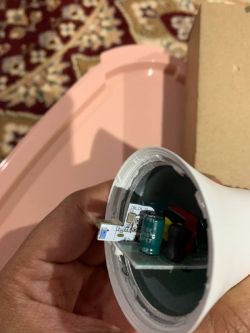

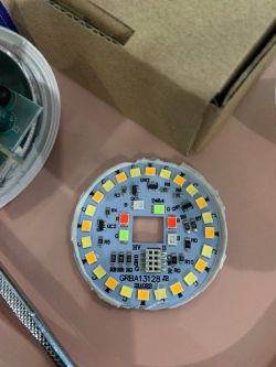

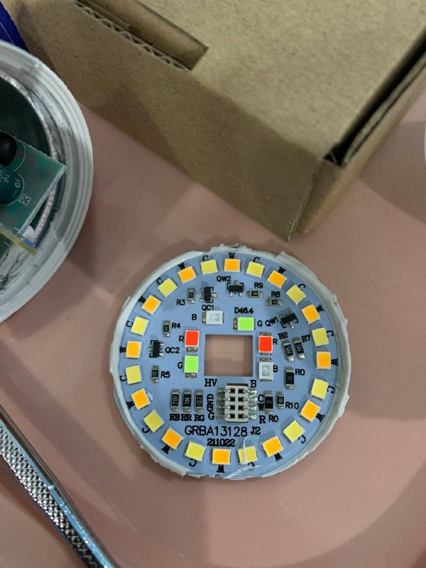

  • This is a short teardown of the Smartrul E27 WIFi bulb which is based on BK7231N and it uses a tuya module CBLC9
    Basic Info:
    Brand: Smartrul
    Model: SMR-DP005-WIF-A19
    Chip: BK7231N - CBLC9

    Pinout:
    Pin Assignment
    P8 PWM 1
    P9 PWM 2
    P26 PWM 3
    P24 PWM 4
    P6 PWM 5
