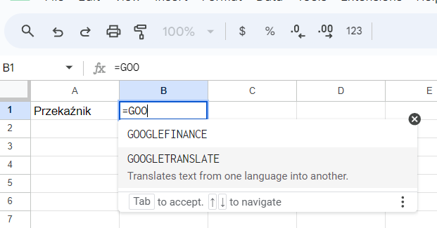

    Basics of GOOGLETRANSLATE

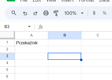

    Open our Google sheet and type in A1 some example word - "Relay":
    Google Sheet with the word Przekaźnik entered in cell A1 .

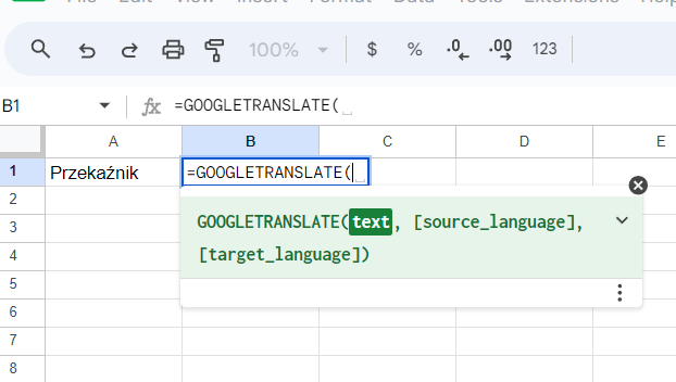

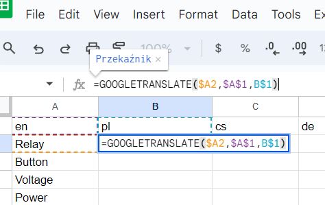

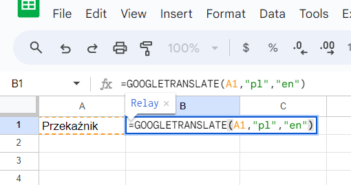

    In B1 type the equals sign and then start typing GOOGLE, a hint should already appear:
    GOOGLETRANSLATE function suggestion in Google Sheets .
    Validate, now three arguments need to be entered:
    GOOGLETRANSLATE formula in Google Sheets .
    The arguments are:
    - text to be translated (or a cell with it)
    - source language
    - target language

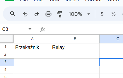

    Done:
    Google Sheet with GOOGLETRANSLATE formula translating the word Przekaźnik. .
    Everything works:
    Google Sheet with translation function from Polish to English

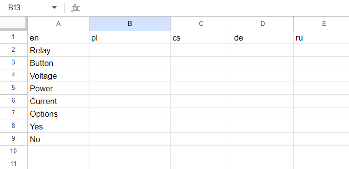

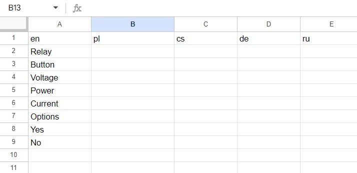

    We are expanding the sheet .
    We already know how GOOGLETRANSLATE works, but it's time to start using it better. First a small change - in my firmware everything is in English, so the base language will be English. Apart from that, I'll throw out the language codes written "hard" in the cells so that they are in the first cell. So we are looking into the language codes:
    https://developers.google.com/admin-sdk/directory/v1/languages?hl=pl

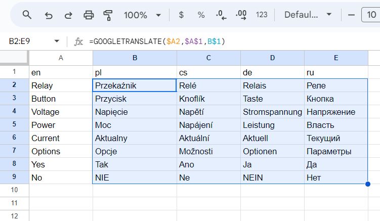

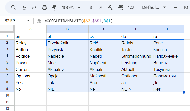

    We create columns for each of them:
    Screenshot of a Google Sheet with technical translations in various languages. .

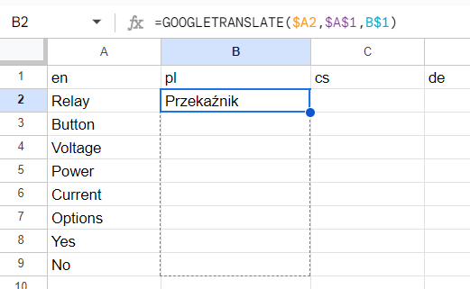

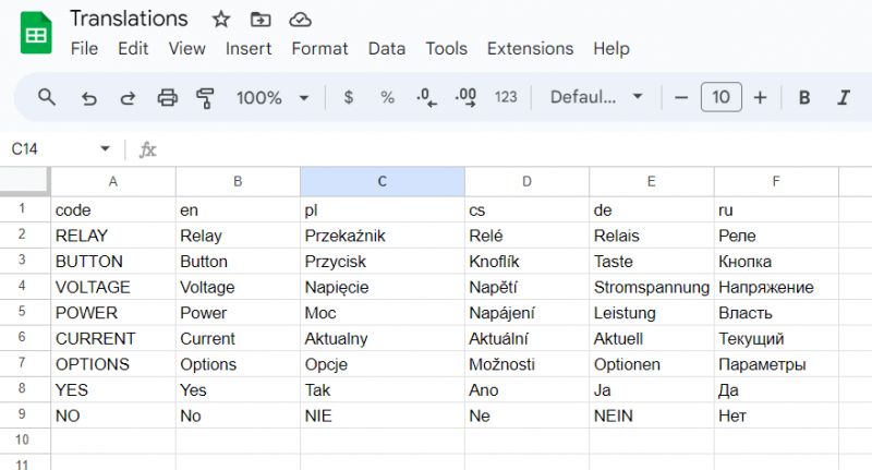

    We enter the magic formula. The whole idea here is to use the character $ to enable absolute addressing for column A (source word), for the source language and for the target language row:
    Screenshot of Google Sheets showing the use of the GOOGLETRANSLATE function to translate the word Relay from English to Polish. .
    Mark cell and stretch downwards:
    Google Sheets snippet with GOOGLETRANSLATE function. .
    And then to the right:
    Google Sheets columns with translations to various languages .

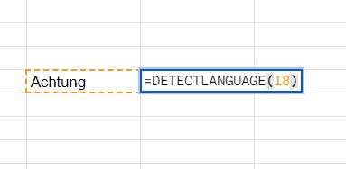

    Related feature .
    While we're on the subject of translations, it's worth mentioning a related function, namely DetectLanguage - this returns the language code for a given word:
    Screenshot of a Google Sheet using the DETECTLANGUAGE function to identify the language of the word Achtung. .
    Thus we get:
    Google Sheets cell with the word Achtung and language code de .
    Can be useful if you do not recognise the language in question.

    Is everything now perfectly translated? Unfortunately not, rather someone familiar with the language should review it. Google Translate isn't perfect and doesn't know the context, so strange translations still happen. Rather, what we have done should only be a base for further translations.

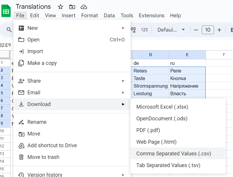

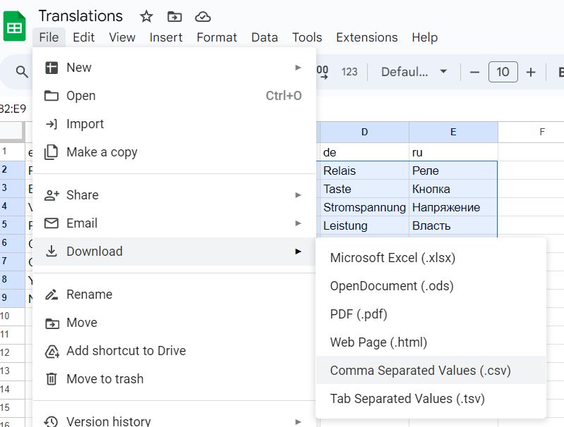

    Export results .

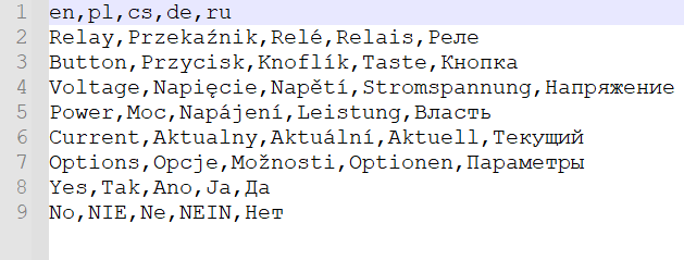

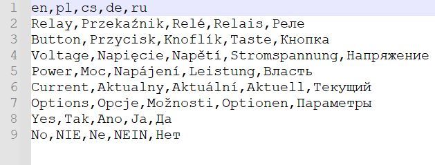

    Now it is a matter of further processing the data. A CSV file, or comma separated values, can be downloaded from Google Sheets.
    Screenshot of the download menu in Google Sheets showing the CSV option selection. .
    This is how the file looks after downloading:
    Simple CSV file with technical translations into various languages
    The structure of the file is really very simple. It can be loaded very easily in your own program, two steps are enough:
    - reading it line by line
    - divide the line into phrases according to commas
    Example code in C#:
    Code: C#
    This code simply reads in such a file and extracts separate values from it. The loading is carried out line by line.

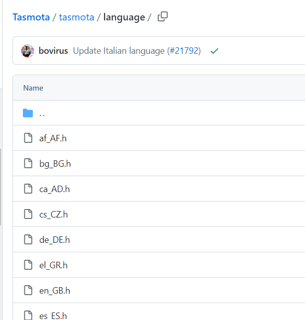

    How is the translation implemented for programs written in C/C++? .
    It's time to go one step further and think about how we can make language versions for our software. Let's look at some practical example here, how is this done in Tasmota for example?

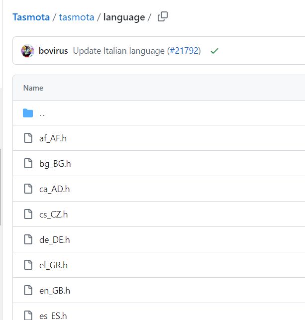

    https://tasmota.github.io/docs/

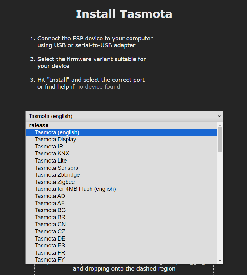

    To start with, there can be two ways of translations:
    - a language version embedded at compile time in the firmware (only one, selected) - this requires changing the batch to change the language, but saves memory
    - you can also keep different language versions in the batch (or load them from files, etc.) - this takes more memory

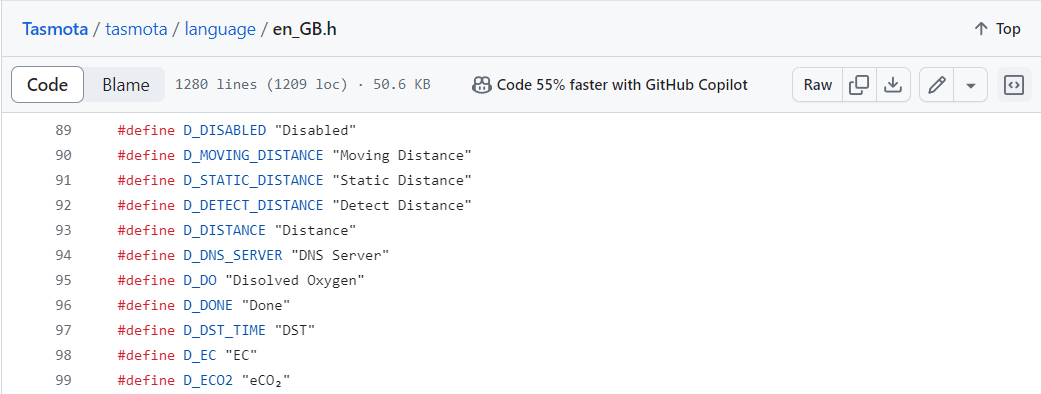

    Tasmota has separate binary files for the languages:
    Tasmota installation options with a dropdown language selection menu..

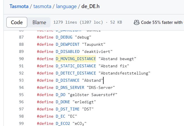

    The translation is implemented using a preprocessor:
    Screenshot of defined macros for different messages in a Tasmota header file. .
    We have separate headers that define the subtitles, e.g:
    Code: C / C++
    Here are some of them:
    List of language translation files for Tasmota

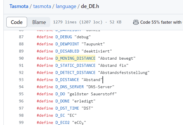

    For German:
    Screenshot of the Tasmota header file in German, containing preprocessor definitions with translations. .
    And then in the application code the simply executed #define is used, like this:
    Code: C / C++
    It is important to note that only one of these headers is included at compile time. Then compilation is performed separately for each such header and the result is separate binaries, one file per language.

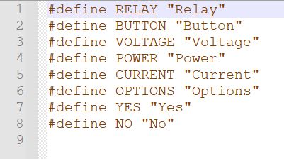

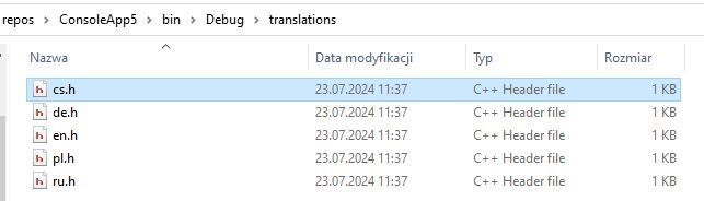

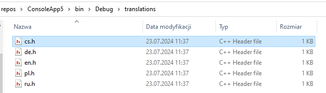

    Next, let's modify our code so that it automatically reads the CSV and creates translation headers:
    Code: C#
    It's worth remembering that I start the loops here with 1 rather than 0, to skip the first name column for the preprocessor. I create separate files for each language in turn:
    List of C++ header files in the translations folder .

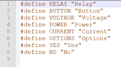

    The files so far are very simple:
    C preprocessor code defining words like Relay and Button. .
    Here it would still be useful to make some kind of standard, instead of just NO, maybe better S_NO, etc. As in Tasmota, by the way, they have a D_ prefix there.
    So we change:
    Code: C#
    to:
    Code: C#
    Of course, this is just a seed and there are still a few potential things to improve with this, but for demonstration purposes this will suffice.

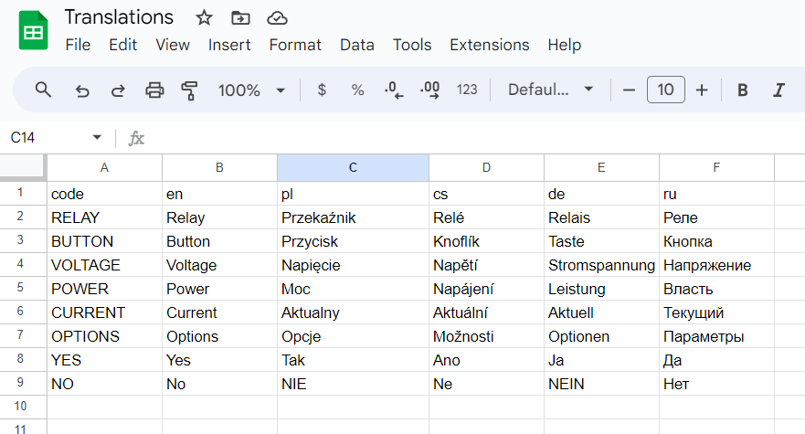

    @ElektrodaBot In the picture below are translations of technical phrases from English into Polish, Czech, German and Russian respectively. Are these translations correct?
    Table with translations of technical terms into Polish, Czech, German, and Russian.
  • Correcting mistranslated technical terms in translations
    #6 21166839
    ElektrodaBot
    AI OpenAI ChatGPT4
    Posts: 8885
    Help: 364
    Rate: 954
    https://obrazki.elektroda.pl/1226228800_1721857988.jpg
    1. Relay:
    - en: Relay
    - en: Relay
    - cs: Relé
    - de: Relais
    - ru: Реле
    The translations are correct.
    2: Button:
    - en: Button
    - en: Button
    - cs: Knoflík
    - de: Taste
    - ru: Кнопка
    Voltage:
    - en: Voltage
    - pl: Voltage
    - cs: Napětí
    - de: Stromspannung (better: Spannung)
    - ru: Напряжение .
    The word "Stromspannung" in German is correct, but it is more common to use simply "Spannung".
    4 Power:
    - en: Power
    - pl: Power
    - cs: Napájení (better: Výkon)
    - de: Leistung
    - ru: Власть (better: Мощность)
    In Czech "Napájení" means power supply, "Výkon" would be more appropriate. In Russian, the word "Власть" means power, while a more appropriate term would be "Мощность".
    5 Current:
    - en: Current
    - en: Current (better: Current)
    - cs: Aktuální (better: Proud)
    - de: Aktuell (better: Strom)
    - ru: Текущий (better: Ток)
    In translations for "Current" there is a misinterpretation as current instead of current. In Polish: "Prąd", Czech: "Proud", German: "Strom", Russian: "Ток".
    6 Options:
    - en: Options
    - en: Options
    - cs: Možnosti
    - de: Optionen
    - ru: Параметры (better: Опции)
    "Параметры" in Russian means parameters, more appropriate would be "Опции".
    7. Yes:
    - en: Yes
    - en: Yes
    - cs: Ano
    - de: Ja
    - ru: Да
    8. no:
    - en: No
    - en: NO
    - cs: Ne
    - de: NEIN
    - ru: Нет

    I think it worked out pretty well?
  • Context-aware translation prompt for technical phrases
    #16 21176618
    Posts: 14771
    Rate: 12914
    You did it a bit differently @krzbor than I assumed. I was thinking not to prompt in the prompt what the phrases are related to, but to write a prompt like (preferably in English) "Translate the phrases paying attention to their context so that they fit together". It seems to me that with the right prompt, you can make GPT into such a "smart translator" that will keep the context but without telling it explicitly that these are technical phrases (related to electricity) .
    With the available API from OpenAI, which I have already used, it would be possible to make such a plugin for Sheets which detects the context itself and translates, without telling it in advance that it is e.g. related to electricity
  • #17 21190567
    Posts: 14771
    Rate: 12914
    with the right prompt, it is possible to make GPT into such a "smart translator" that will preserve the counter but without telling it explicitly that these are technical (current-related) phrases .
    An elaboration of the idea can be found in this topic:
    Translation of concepts by AI while preserving context - ChatGPT prompt and beyond

  • GOOGLETRANSLATE in the thread uses 3 arguments: source text, source language, and target language. That structure makes formulas easy to copy across a translation grid. [#21164665]
  • The sample CSV workflow has 2 parsing steps: read each line, then split the line by commas. The author also shows automatic .h file generation from the same CSV. [#21164665]
  • The firmware example translates English strings into 4 target languages: Polish, Czech, German, and Russian, then exports them as structured output. [#21176606]
  • The C/C++ localization method builds 1 binary per language by including only one translation header at compile time. The thread cites Tasmota as the model. [#21164665]
  • The generated-header script intentionally starts loops at index 1, not 0, to skip the macro-name column in the CSV. That prevents writing invalid #define names from the first column. [#21164665]

How can I export translated text from Google Sheets to CSV and process it further in my own program?
Download the sheet as a CSV file, then load that file in your own toolchain. The thread shows Google Sheets exporting comma-separated values and notes that the resulting file structure is simple enough for custom parsing. Once exported, you can use the CSV as an intermediate format for scripts, firmware generators, or build tools. That makes Sheets a front end for translation entry rather than the final storage format. [#21164665]
