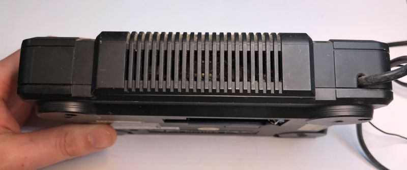

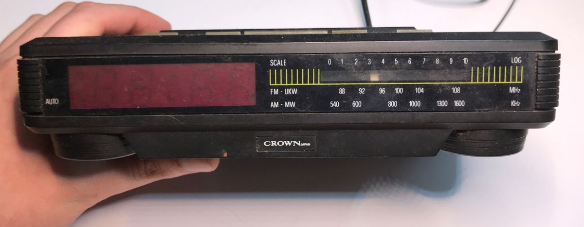

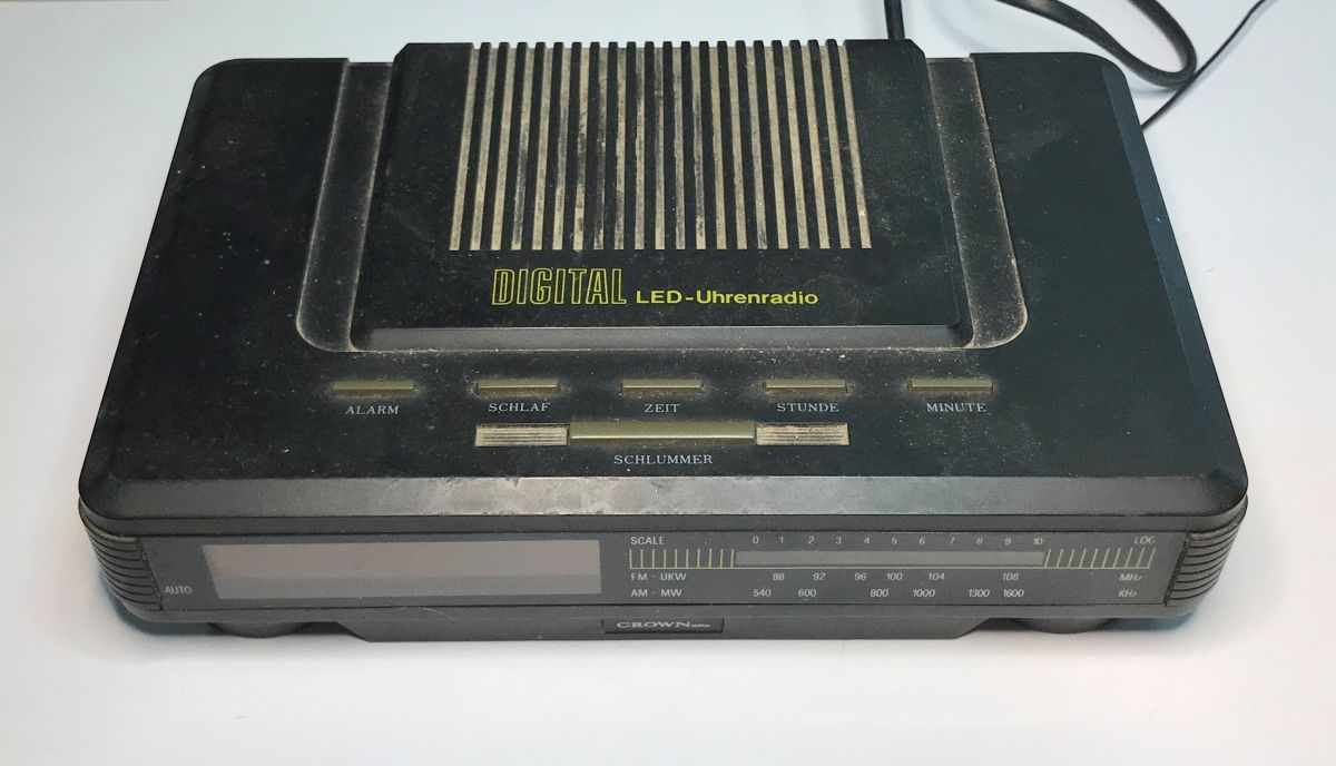

    I would like to invite you to a presentation of the interior of an older Crown Japan radio alarm clock model CR-S9028, designated DIGITAL LED-Uhrenradio. The unit offers FM reception in the 88-108 MHz range and AM reception in the 540-1600 kHz range. It is equipped with an LED display showing the current time, an alarm clock function with snooze option, and battery back-up of the clock in case of mains power failure.
    Retro radio alarm clock with LED display - interior, construction, principle of operation Retro radio alarm clock with LED display - interior, construction, principle of operation .
    The inscriptions on the housing are in German. Uhrenradio, as you might guess, is a radio alarm clock. Schlummer is a snooze (postponement of the alarm). Zeit is the time, Stunde is the hour, Schlaf is sleep (this is probably the radio automatically switching off after a set time).

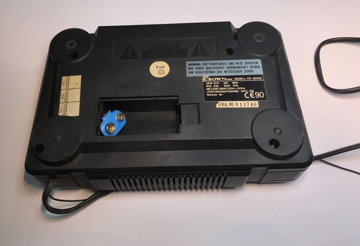

    At the bottom is a space for a 9V battery, just for backup:

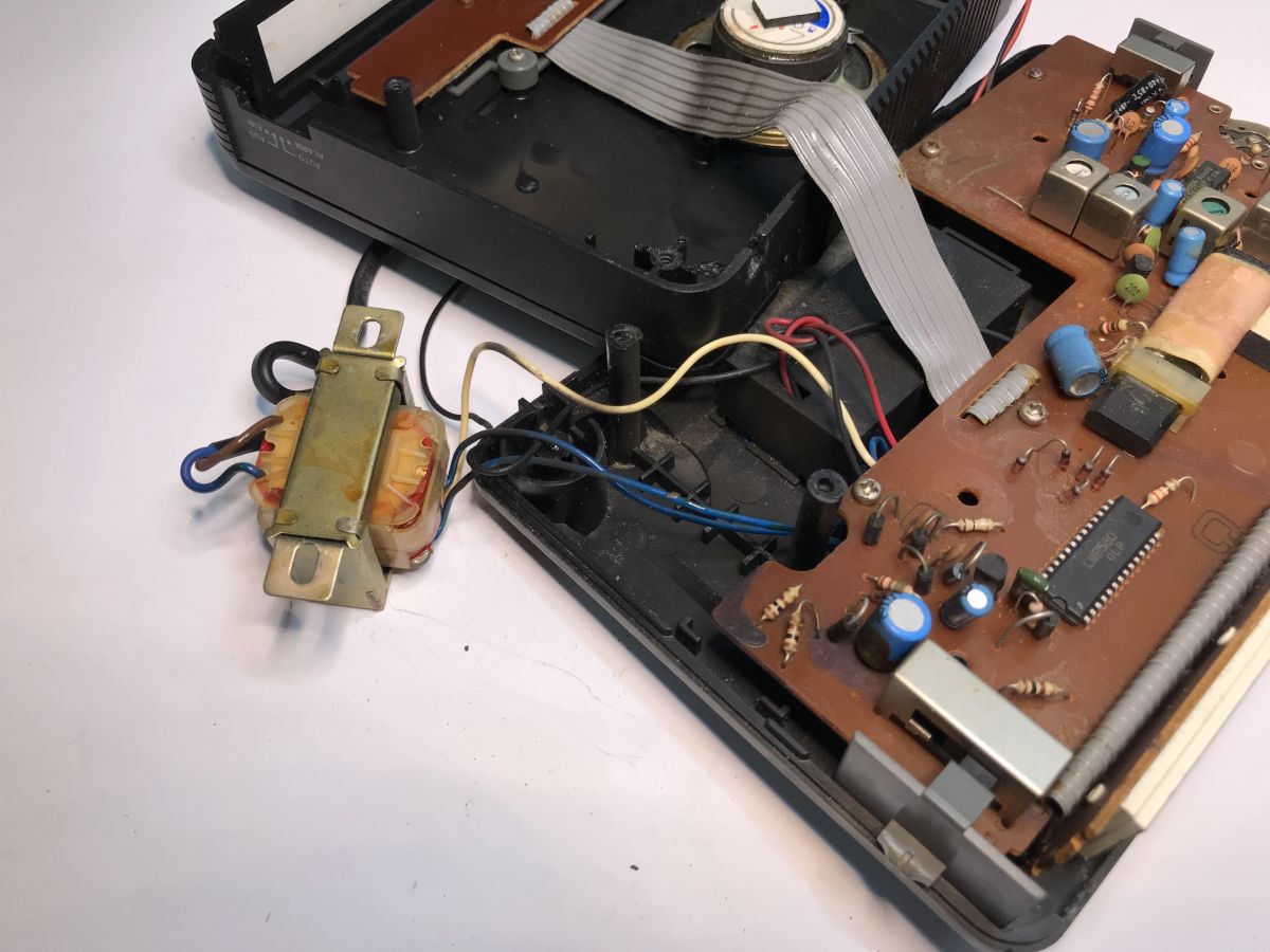

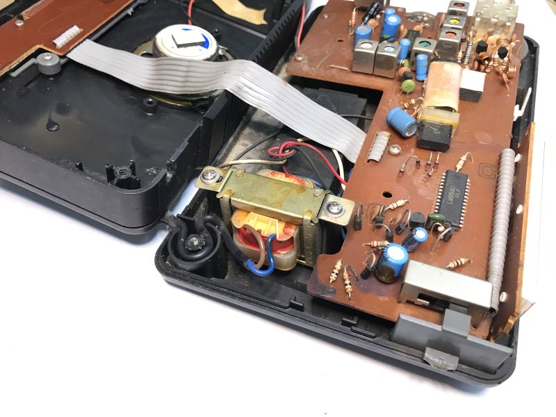

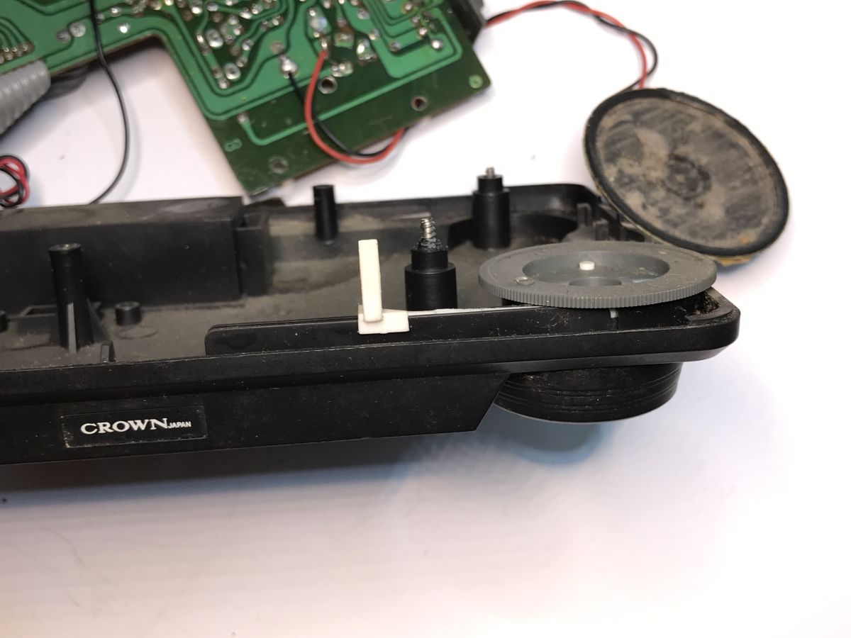

    Let's take a look inside. The laminate inside is single sided and single layer. The assembly is fully threaded. The radio relies on a ferrite antenna and an adjustable capacitor and on coils protected with paraffin so as to prevent the coils from physically moving relative to each other.

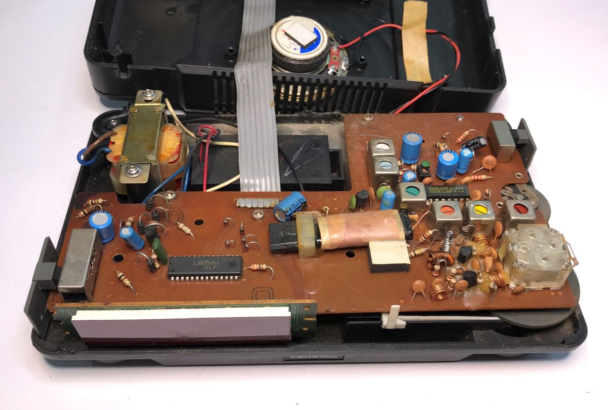

    The first thing we see is the display and alarm clock controller - the LM8560. About it in a moment. First, let's turn our attention to the power supply section - there is no switching power supply here, just a simple transformer. Heavier, but simpler to build.

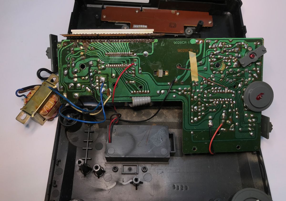

    Now the underside of the PCB. It's been a long time since I've seen paths routed like this, is it handmade? Modern CAD programs don't run tracks like this. Here you can also see that the LM8560 directly controls the display.

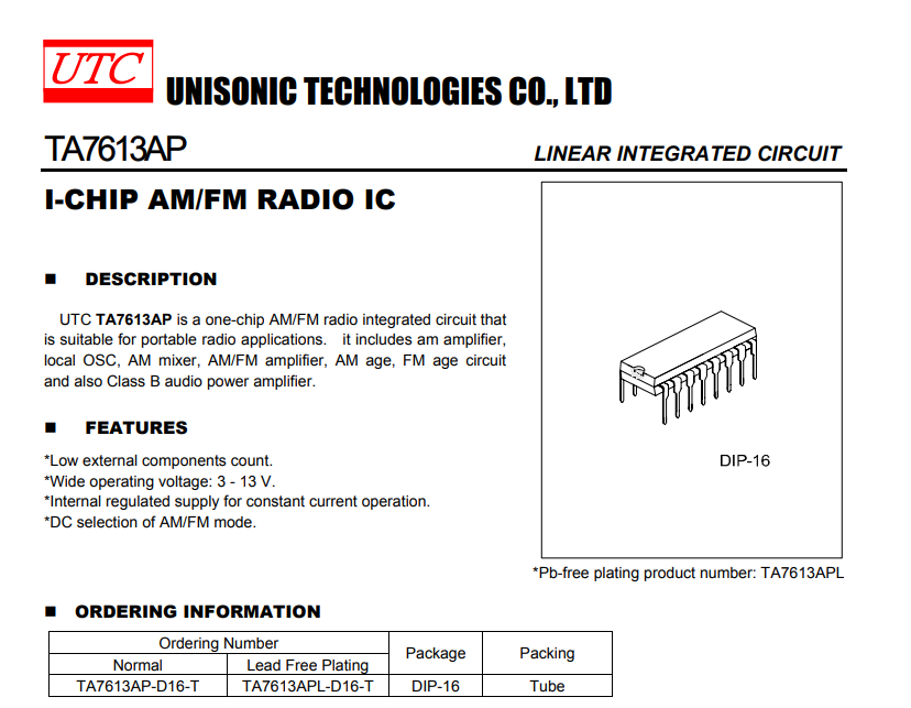

    The radio itself is based on the TA7613AP:

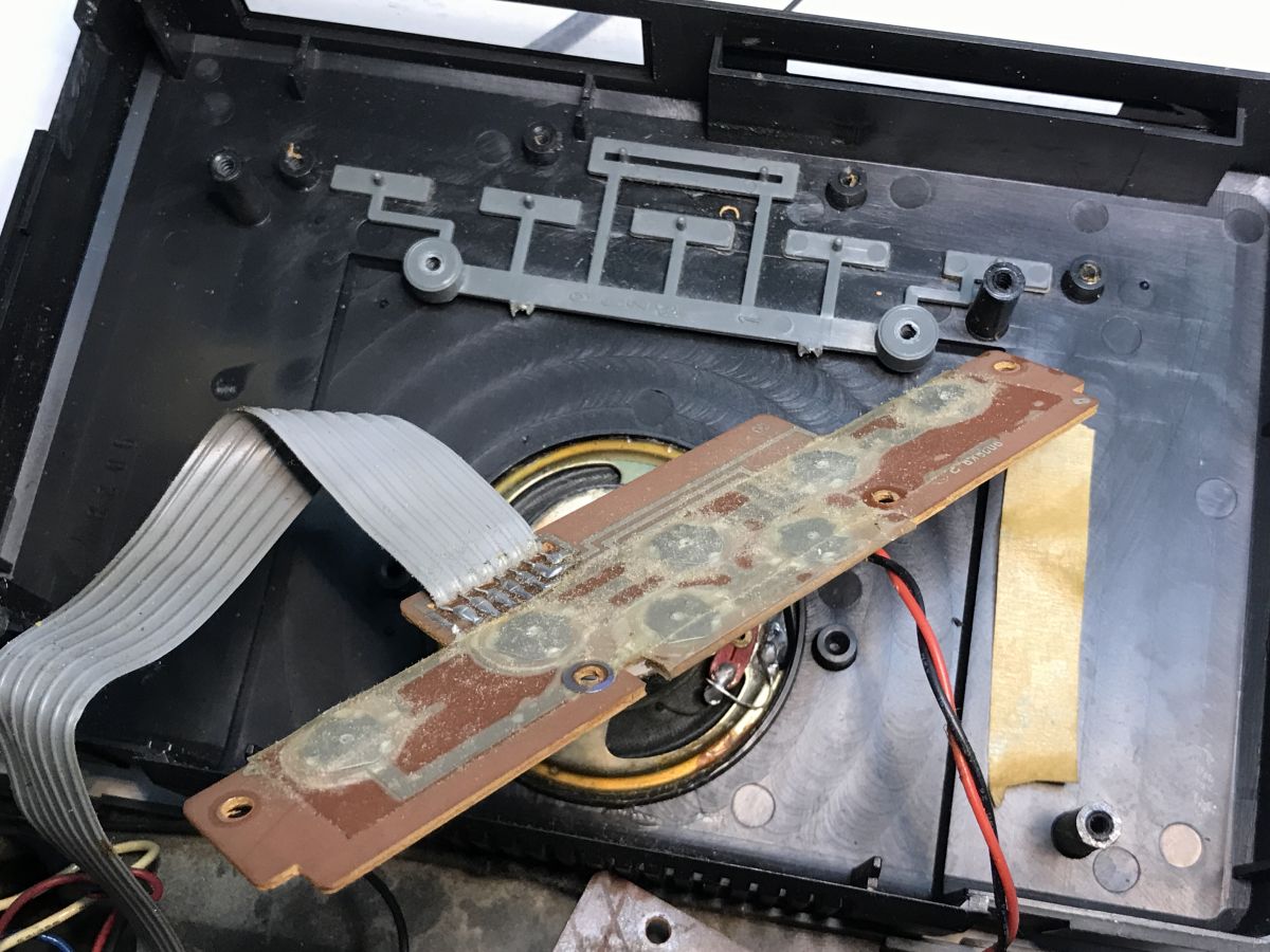

    Basically that's it, the button board has no more electronics.

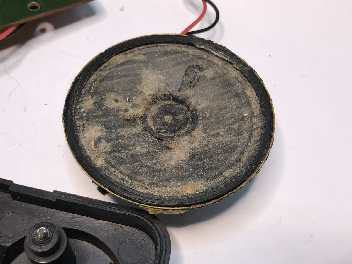

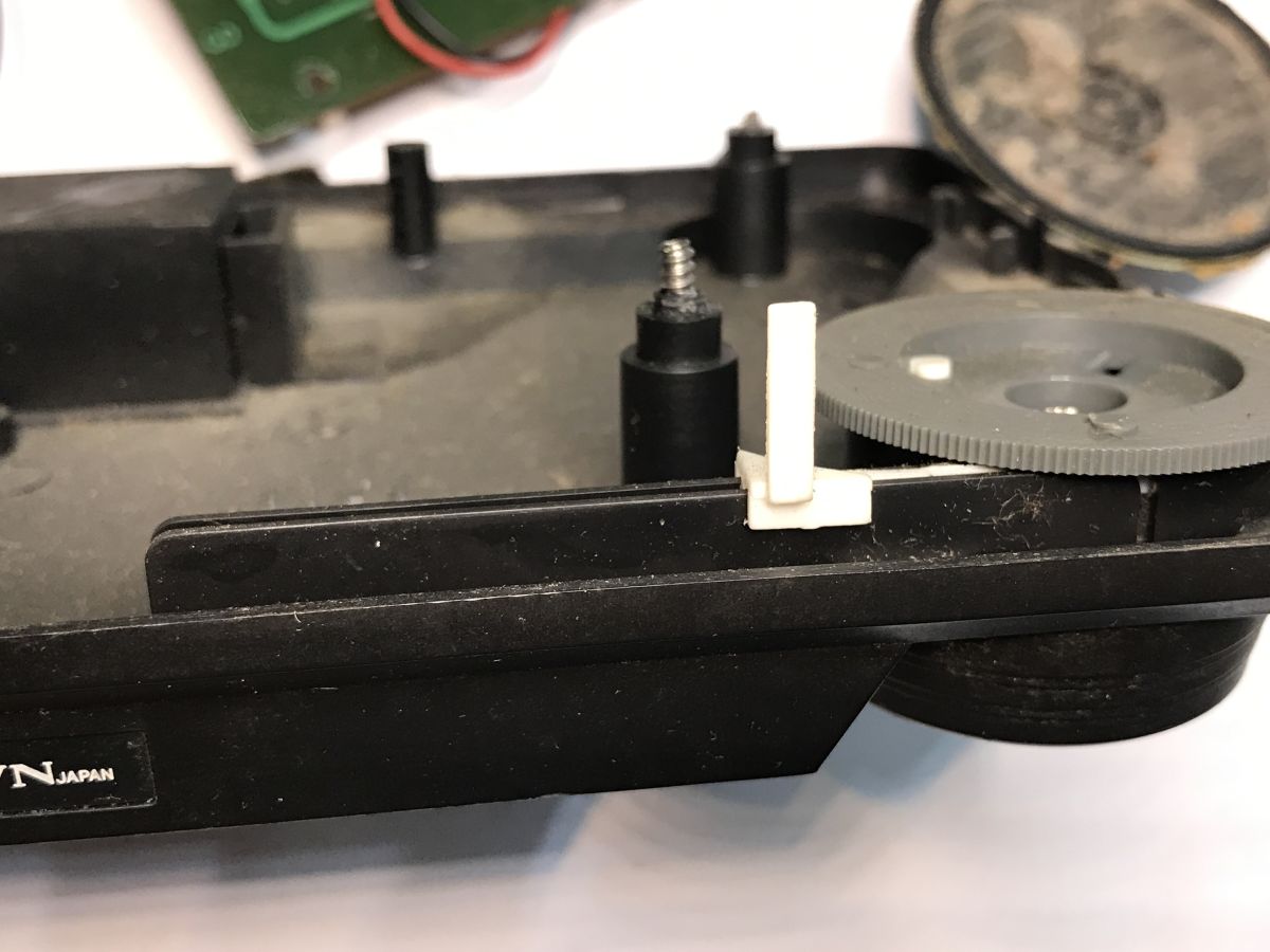

    All that remains is the speaker:
    Retro radio alarm clock with LED display - interior, construction, principle of operation Retro radio alarm clock with LED display - interior, construction, principle of operation Retro radio alarm clock with LED display - interior, construction, principle of operation .

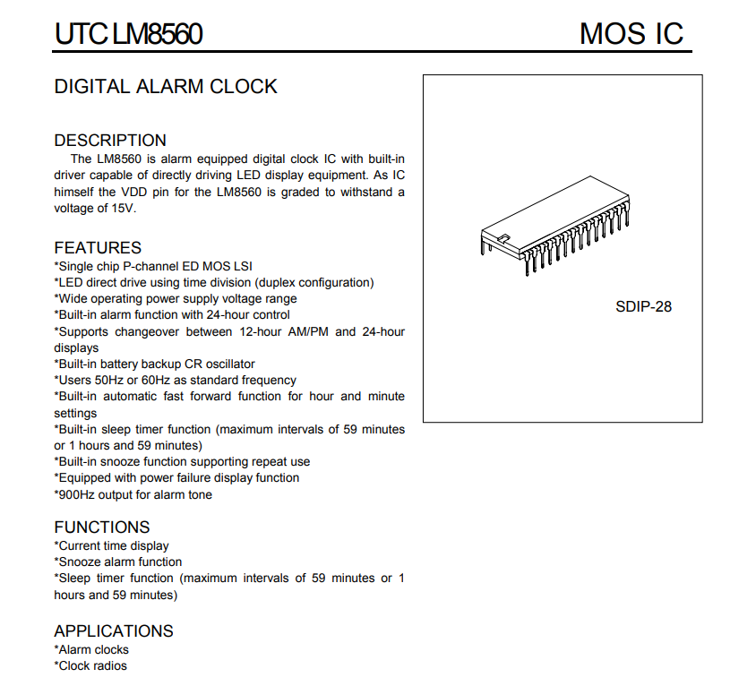

    Now it is time to look at the principle of operation. Here we have two circuits:
    - LM8560 - a digital clock controller with built-in alarm, display, pushbutton operation and clocking from the mains via 50 or 60Hz
    - TA7613AP - a single-chip AM/FM radio controller, including AM amplifier, oscillator, mixer, etc.
    Don't confuse the LM8560 with a microcontroller - this chip was designed directly for alarm clocks:

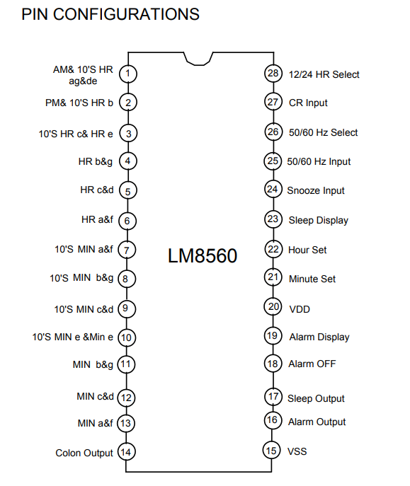

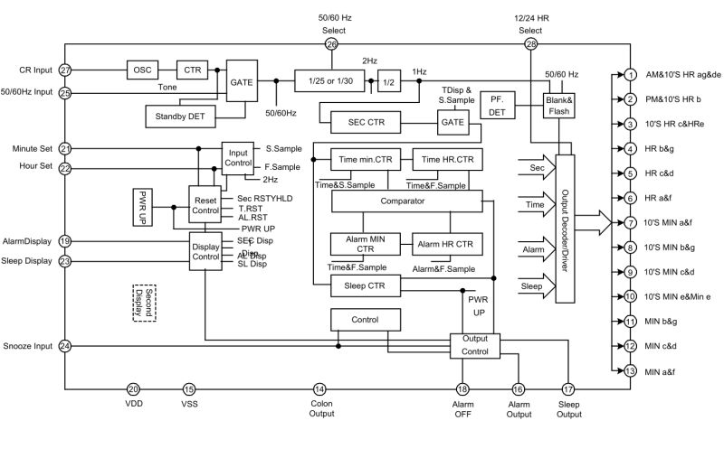

    Pinouts:

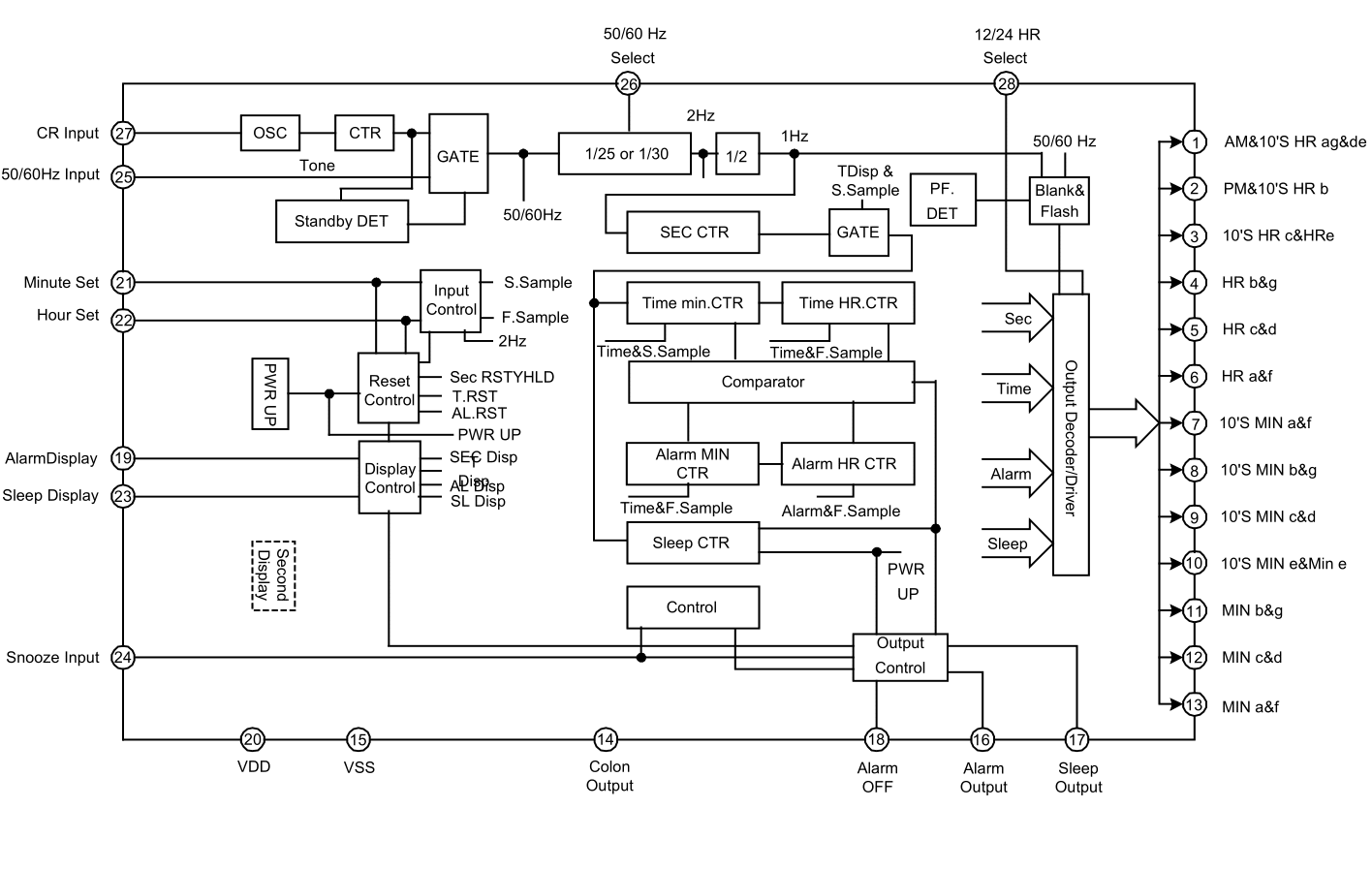

    The internal design shows the pulse counting route well. We have two inputs - CR (oscillator) and 50/60Hz (from the transformer). These go to a gate which decides which pulses are counted. Then there is a divider for 50 or 60Hz (1/25 or 1/30) and then a divider in half so that we get 1Hz. This is then processed by the blocks from counting time, alarm and snooze...:

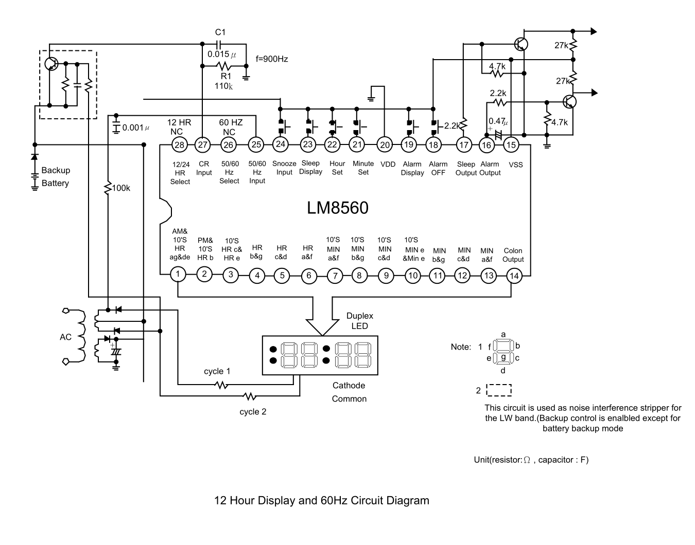

    The LED multiplexing is solved in an interesting way. The display is with a common cathode, but the LM8560 only controls the segments. The common cathodes are controlled from... transformer, from the respective halves of the sine wave. The obvious consequence of this is that the display does not work when the whole thing is powered by battery only. Moreover, these common cathodes are two - and 14 segments each.
    193650bb6 .
    The schematics illustrate well how the clock is clocked from the mains, this is done by connecting from the transformer before the rectifying diode to the 50/60 Hz Input pin. Right next to it you can see the battery backup and the oscillator with resistor and capacitor (CR Input pin). The alarm output can switch the radio or buzzer.

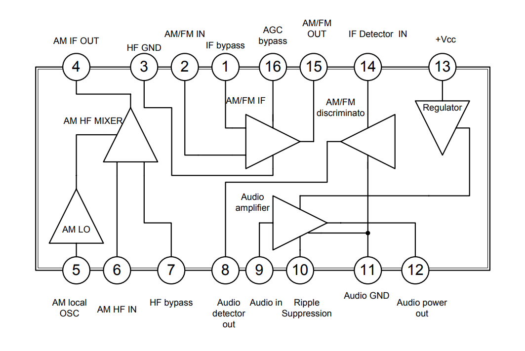

    This leaves the TA7613AP. As I've written before, it's basically a single chip AM/FM radio controller:
    You don't even need an LM386 - there's already a Class B audio amplifier inside.

  • Battery backup uses a 900 Hz RC oscillator
    #7 21597825
    Citizen75
    Level 30  
    Posts: 2460
    Help: 157
    Rate: 473
    Ktoś_tam wrote:
    As far as I remember this has the battery itself been even worse.
    In the case of the battery, there is no 50 Hz clocking and it is replaced by an internal 900 Hz oscillator with RC elements attached to pin 27 of the LM8560 chip. Without this oscillator the clock would stop. Clock solutions are known with the LM8560 chip having a 3.2768 MHz quartz generator and the CD4060 and CD4013 chips.

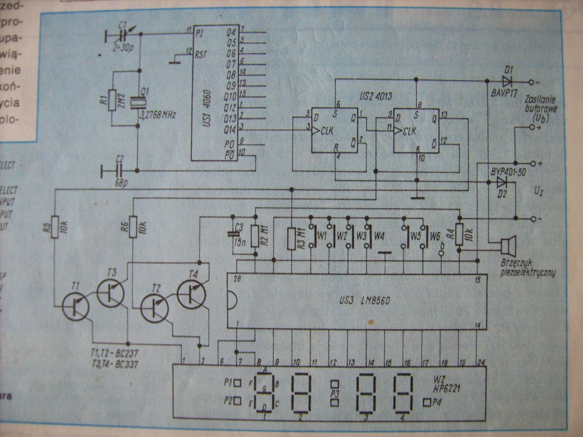

  • Quartz generator retrofit planned with MM5369 to fit case

    I have a radio alarm clock on the same chip, or perhaps on its twin brother (TMS3450) I'm not sure now. It's been going strong for a couple of years now; a few minutes a day* and I've been collecting to fit a quartz generator in it for about two years now. I have already made one such generator on a prototype board. On circuits 4060 and 7490 (with a 78L05 stabiliser) and a 4.096 MHz quartz. Unfortunately, due to the tightness, it was not possible to screw the case together after adding the generator board. I am currently waiting for the MM5369 chips ordered from China. One DIP8 chip, fewer components, then maybe such a generator can be squeezed into the case. As long as the circuits from Majfrends will work. The generator gives 60 Hz not 50 Hz so something needs to be changed in the clock IC connection.
    *I've read that this can be caused not so much by a deviation in the grid frequency as by the presence of "dirt" from inverters or converters. Actually, the neighbour has PV panels; maybe it's from that?

    By using SMD ICs and instead of a TTL 7490 chip a CMOS 4013 chip, such a generator can be significantly miniaturised. In the process, the LM78L05 stabiliser is eliminated. Pin 26 of the LM8560 chip is used to select the 50/60Hz frequency.

  • Higher mains voltage can burn out LED segments
    #11 21598061
    kris8888
    Posts: 6998
    Help: 533
    Rate: 1906
    CHCl3 wrote:
    I've read that this may be caused not so much by the deviation of the grid frequency as by the presence of , "sludge" from inverters or inverters. In fact the neighbour has PV panels; maybe it's from that?
    Unlikely, but if even that, just filter out with a suitably sized RC circuit these potential interferences on the 50Hz clocking input of the TMS3450 chip. So as not to significantly attenuate the 50Hz but to cut out all the higher harmonics.
    The grid is currently very stable as far as the 50Hz fundamental frequency is concerned. If the watch is rushing a few minutes a day this is also more likely to indicate some sort of damage to the watch.
    The LED multiplexing is interestingly resolved. The display is with a common cathode, but the LM8560 only controls the segments. The common cathodes are controlled from... transformer, from the respective halves of the sine wave.
    Unfortunately, this also has its drawbacks. This radio alarm clock was still designed for 220V AC on the mains. Now we have 230V and beyond. The LED display is therefore treated with a slightly higher voltage/current which can lead to segments burning out.

    Using SMD ICs and instead of a TTL 7490 chip a CMOS 4013 chip such a generator can be significantly miniaturised. In the process, the LM78L05 stabiliser is eliminated. Pin no. 26 of the LM8560 chip is used to select the 50/60Hz frequency.
    SMD soldering doesn't really work well for me; making boards with such tiny tracks even more so. I used whatever circuits I had at hand.

  • Crown Japan CR-S9028 odbiera FM 88–108 MHz i AM 540–1600 kHz, a zegar podtrzymuje bateria 9 V po zaniku zasilania sieciowego. [#21597161]
  • Tor zegara LM8560 używa wejścia 50/60 Hz z transformatora albo wejścia CR, a z dzielników 1/25 lub 1/30 oraz dalszego podziału powstaje sygnał 1 Hz. [#21597161]
  • Na baterii wyświetlacz LED nie pracuje, bo wspólne katody są sterowane połówkami sinusoidy z transformatora, a nie w pełni z samego układu scalonego. [#21597161]
  • W praktycznej naprawie pomogły kondensatory 100 nF równolegle do elektrolitu zasilacza i 4.7 nF między pinem 25 a masą; 10 nF i 100 nF na pinie 25 powodowały już świecenie nadmiarowych segmentów. [#21608064]
  • Starsze wersje projektowano na 220 V AC, a przy dzisiejszych 230–245 V warto lekko zwiększyć dwa rezystory katodowe 120 Ω, aby zmniejszyć stres prądowy LED. [#21598409]
1. What is the LM8560 chip and how does it work in a retro LED radio alarm clock like the Crown Japan CR-S9028?
LM8560 is a dedicated digital clock IC for alarm clocks, not a microcontroller. It handles time counting, alarm, snooze, pushbuttons, and direct LED segment control in one chip. In the CR-S9028, it takes timing from mains 50/60 Hz or a backup oscillator path, then drives the display and alarm output that can switch either the radio or a buzzer. The thread also notes battery-backed operation and mains-derived display multiplexing as key design features. [#21597161]
2. How does the TA7613AP integrate the AM/FM radio stages, oscillator, mixer, and audio amplifier in this type of clock radio?
TA7613AP integrates most of the radio into one IC. It combines the AM/FM radio stages, including amplifier, oscillator, and mixer, and it even includes a Class B audio amplifier, so this design does not need an LM386. In the shown clock radio, the radio section is largely built around this single chip plus the tuning components such as the adjustable capacitor, ferrite antenna, and coils fixed with paraffin. [#21597161]
3. Why is the LED display in an LM8560 alarm clock multiplexed from the transformer’s 50/60 Hz mains waveform instead of being driven entirely by the IC?
Because this design offloads the common-cathode switching to the transformer waveform. The LM8560 drives the segments, but the display’s common cathodes are switched by the respective halves of the 50/60 Hz sine wave from the transformer. That reduces what the IC must drive directly, but it creates one hard limit: on battery only, the LED display does not work. The thread also notes there are two common cathodes serving 14 segments each. [#21597161]
4. How do you trace the timekeeping path inside an LM8560, from the 50/60 Hz input or CR oscillator input down to the 1 Hz clock signal?
You trace it through the LM8560 divider chain. The IC accepts pulses from either the CR oscillator input or the 50/60 Hz mains input, then a gate selects which pulses are counted. After that, the chip divides by 1/25 or 1/30, then divides by two to produce a 1 Hz signal for time counting, alarm, and snooze logic. This path is shown directly in the internal block diagram discussed in the thread. [#21597161]

6. Why does adding too much capacitance on pin 25, the 50 Hz input of the LM8560, make extra LED segments glow?
Too much capacitance distorts the 50 Hz signal that also multiplexes the display. One repair test showed 100 nF on pin 25 to ground caused clearly wrong segments to light, and even 10 nF still produced faint extra glow. A later explanation states that the 50 Hz waveform is used both as the time pattern and by the internal Blank & Flash display logic. If you heavily distort or weaken that waveform, multiplexing fails. [#21608093]
7. How can you filter interference on the 50 Hz clock input of an LM8560 or TMS3450 alarm clock without breaking display multiplexing?
Use light filtering, not heavy filtering. A working example used three steps: 1. add 100 nF in parallel with the power-supply electrolytic, 2. add only 4.7 nF from pin 25 to ground, 3. verify that no false LED segments appear. The thread warns that 10 nF to 100 nF on the 50 Hz input can already disturb multiplexing. As one expert put it, you must not significantly attenuate 50 Hz while cutting higher harmonics. [#21608064]

9. How do you retrofit a quartz time base into an LM8560 or TMS3450 clock radio using parts like CD4060, CD4013, 7490, or MM5369?
You replace the mains-derived timing with an external frequency generator and feed the clock IC the expected reference. The thread gives a concrete path: build a quartz generator with CD4060 and 7490 around a 4.096 MHz crystal and 78L05, or miniaturize it with CD4013 or a single MM5369. You then change the clock IC connection for the required output, because one user’s generator produced 60 Hz, not 50 Hz. Pin 26 selects 50/60 Hz on LM8560. [#21597984]
10. LM8560 with mains-frequency timing vs a quartz generator mod — which gives better long-term accuracy in a vintage radio alarm clock?
A quartz generator mod gives better long-term accuracy. Mains timing can be stable today, but the thread records older clocks needing correction weekly, and battery RC timing can be far worse. A quartz mod replaces that dependency with a dedicated crystal-based source, which one user pursued specifically because his TMS3450-class clock still gained a few minutes per day. The tradeoff is practical, not theoretical: extra parts, tight internal space, and the need to adapt for 50 Hz or 60 Hz operation. [#21597903]
11. What is an Uhrenradio and what do German panel labels like Schlummer, Zeit, Stunde, and Schlaf mean on old clock radios?
"Uhrenradio" is a clock radio that combines radio reception, time display, and alarm functions in one appliance, usually with labeled front-panel controls for sleep or snooze behavior. In this thread, the German labels are explained directly: Uhrenradio means radio alarm clock, Schlummer means snooze, Zeit means time, Stunde means hour, and Schlaf refers to sleep, likely the timed radio shutoff function. These labels appear on the Crown Japan housing. [#21597161]
12. How can you reduce LED display stress in older 220 V clock radios now that mains voltage is often 230–245 V?
Reduce current in the display path. The thread notes these alarm clocks were designed for 220 V AC, while modern mains can sit at 230 V or even 245 V. That higher voltage can overdrive LED segments when the display uses a non-stabilized supply tied to the transformer waveform. A practical fix is to slightly increase the display’s series cathode resistors so the segments see less current. One contributor says he does this routinely in older LED, NIXIE, and VFD equipment. [#21598409]
13. What role do the two 120 ohm cathode resistors play in the LED display circuit, and how should their values be adjusted safely?
The two 120 Ω resistors limit current in the display cathode paths. Because the common cathodes are driven from transformer halves, these resistors directly affect LED stress and brightness. The safe adjustment is modest: increase their value slightly if present-day mains voltage is higher than the original 220 V design target. The thread presents that as the practical remedy when older clocks now run from 230–245 V sockets and segment burnout becomes a concern. [#21598325]
14. How does a single-sided, single-layer, fully through-hole PCB with rounded tracks compare to a modern KiCad or Eagle PCB layout?
It is simpler, more manual-looking, and less typical of current auto-routed boards. The opened CR-S9028 uses a single-sided, single-layer, fully through-hole PCB, and the author specifically remarks that modern CAD tools do not usually route tracks in that rounded vintage style. The comparison in the thread is visual and practical: old layouts often prioritized hand-friendly geometry, while modern KiCad or Eagle projects usually show straighter, more standardized routing unless a designer forces a retro style. [#21597161]
