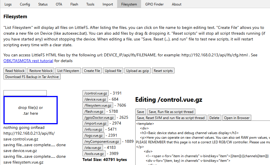

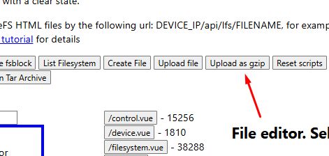

    This is where the second optimisation comes in. Our microcontroller is only supposed to host the page, it doesn't need to edit it, so we can compress the files before putting them in LittleFS .

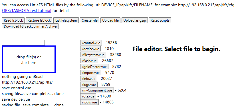

    I've created a helpful button in the web app for this, meaning the compression is done in the browser rather than on the MCU:
    Efficient hosting of a simple HTML page on a microcontroller - GZip compression in HTTP .
    Let's see the implementation of the compression:
    Code: Javascript
    There really is only enough - Javascript does the rest. The MCU itself doesn't even know that a gz file is being uploaded. Zero changes to the firmware.
    However, you still need to change the sending of files from the MCU to the browser. Here you just need to detect the gz extension and add the information to the HTTP header:
    Code: C / C++

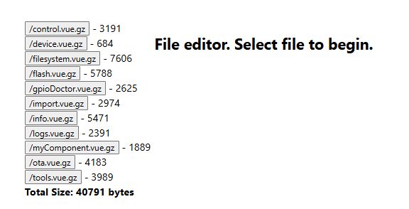

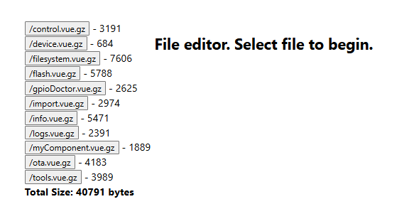

    It's time to see how much memory this will save us:
    167kB versus 40kB is a very big difference - that's more than four times less! In this way, it is not only possible to save space in the flash memory, but also to speed up the transfer, because less data is sent faster. All this at practically zero cost.

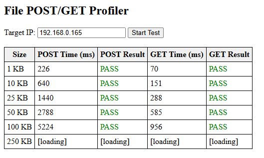

    1. LFS profiler .
    This simple program checks the timing of sending and receiving files from the LFS via HTTP GET and POST requests. The times and results of the operations are shown in the table. Below are the results for LFS on an external flash drive connected by software.

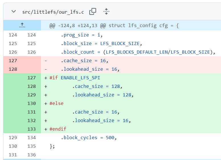

    3. LFS optimisation .
    One of the simpler LFS optimisations is to increase the size of the working buffer. This allows faster read/write operations (more bytes are processed at once) at the cost of slightly higher RAM usage:
