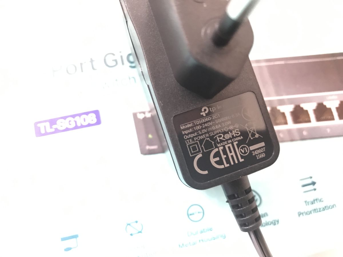

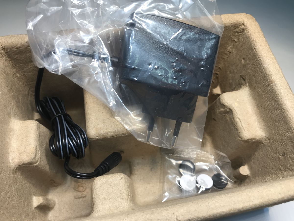

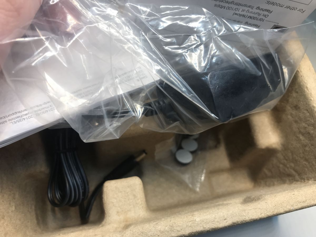

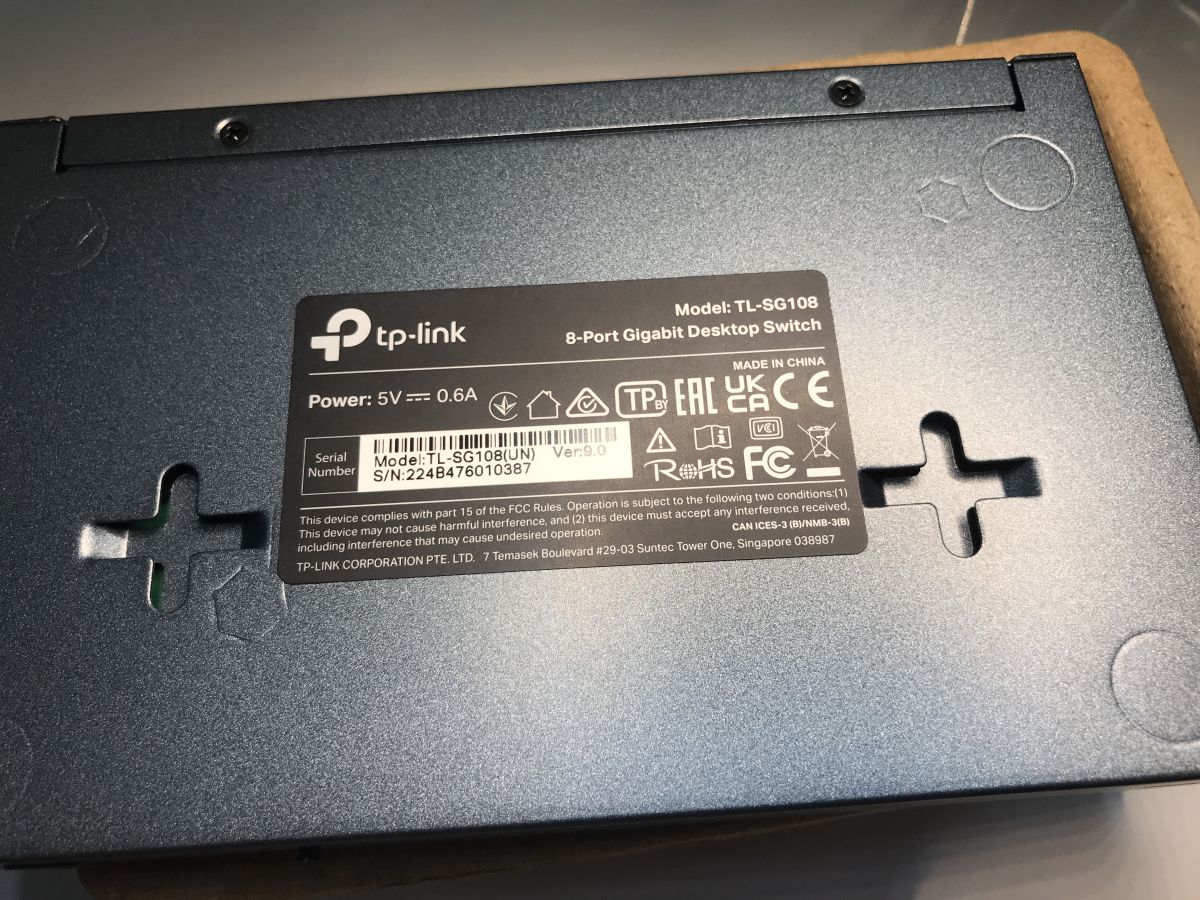

    The TL-SG108 is equipped with 8 10/100/1000Mbps ports. It also comes with a power supply and instructions. The power supply is T050060-2C1 5V 0.6A 3W, so such a switch is undoubtedly not a power hungry device. We unpack - there are even feet included.
    What's the difference between a smart switch and a regular switch? TL-SG108 vs TL-SG108E comparison What's the difference between a smart switch and a regular switch? TL-SG108 vs TL-SG108E comparison What's the difference between a smart switch and a regular switch? TL-SG108 vs TL-SG108E comparison .
    Connecting the switch is very simple - it simply, in simple terms, 'expands' the router's ports. We tested it on a workbench before installing it:

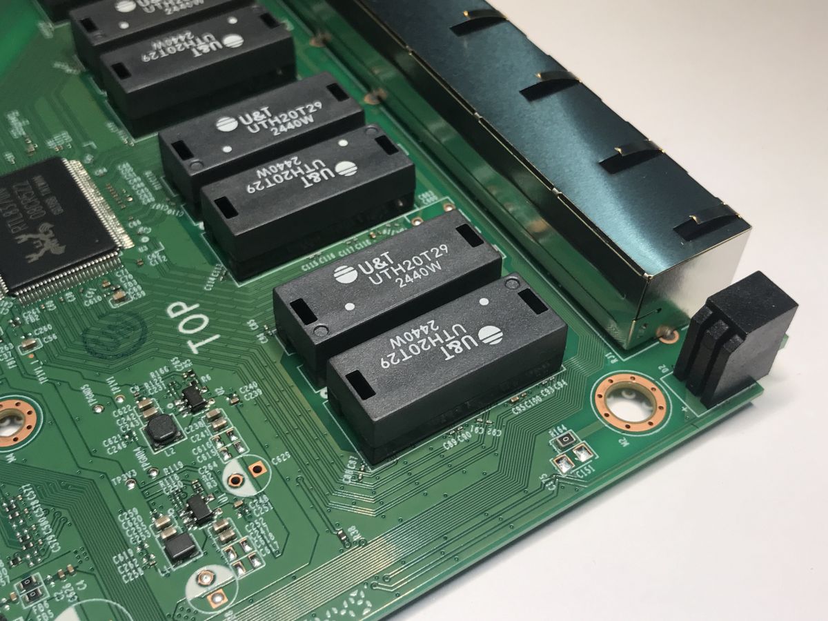

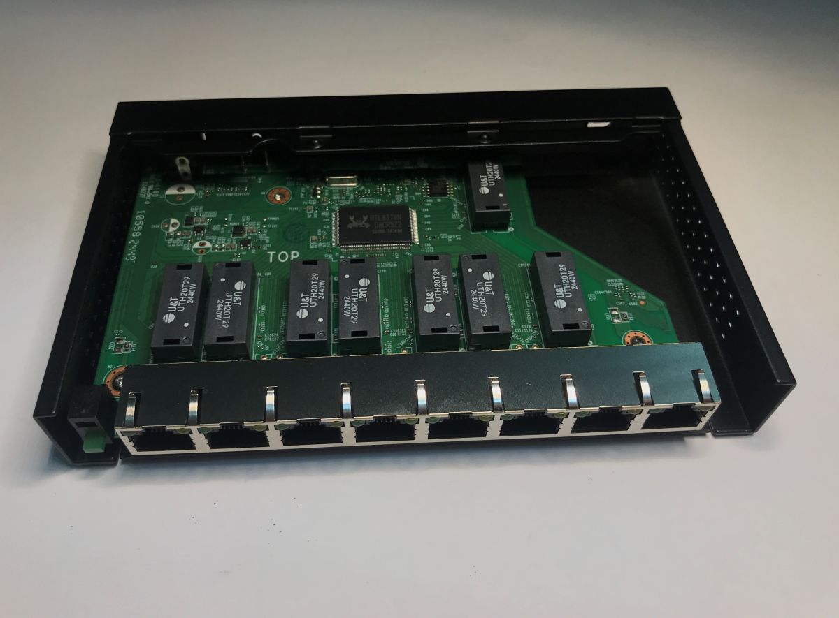

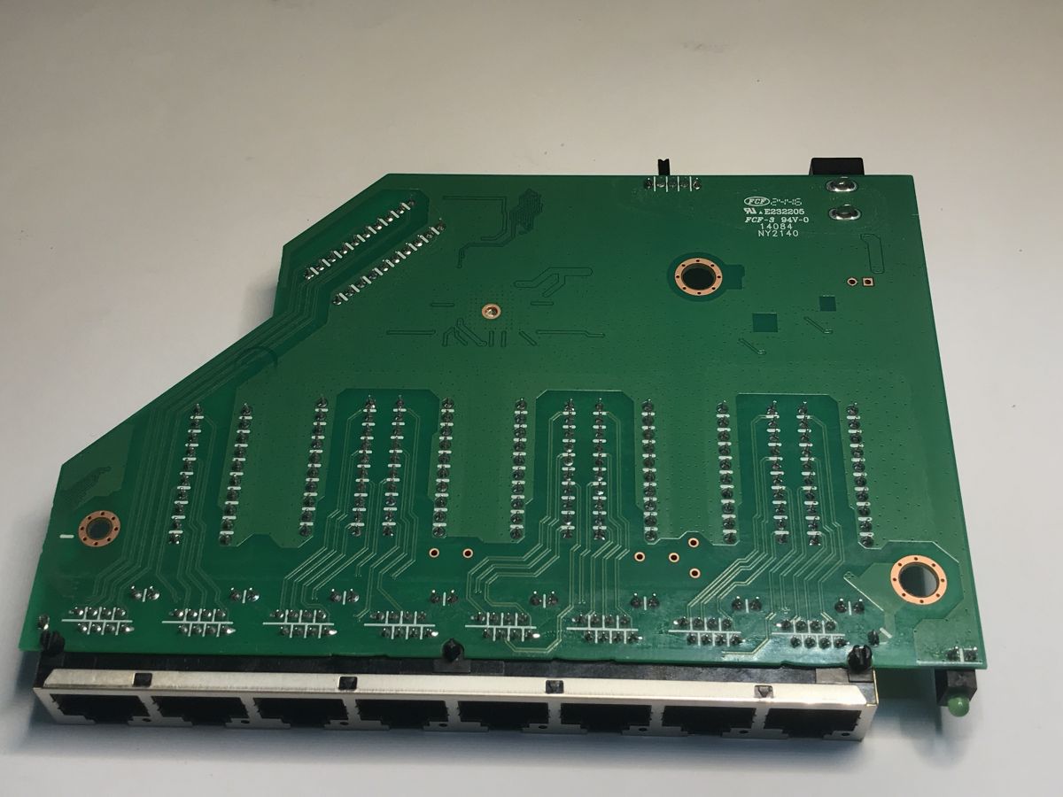

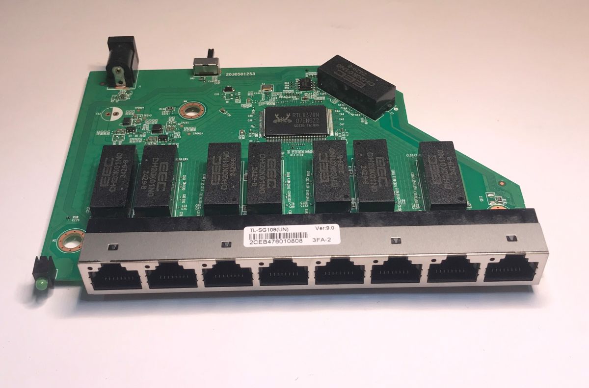

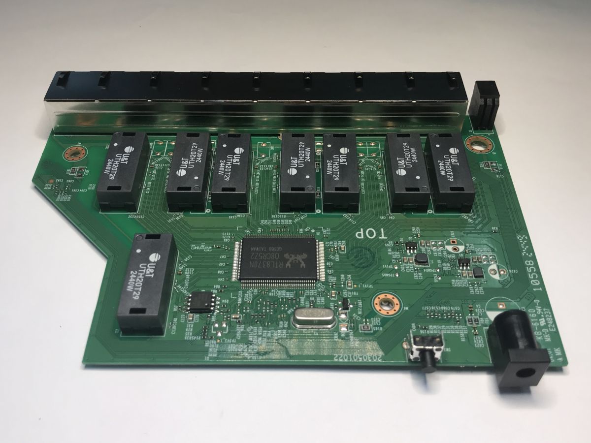

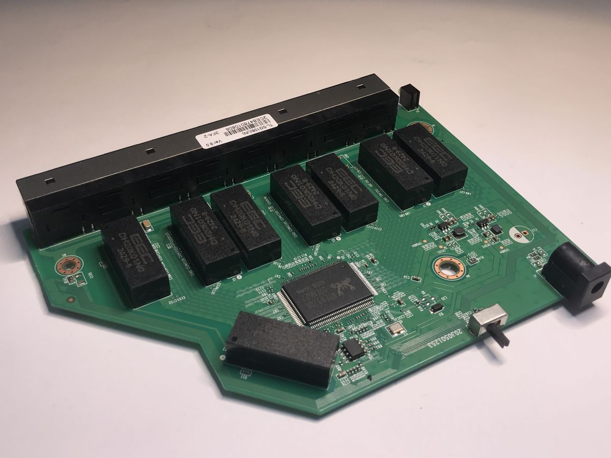

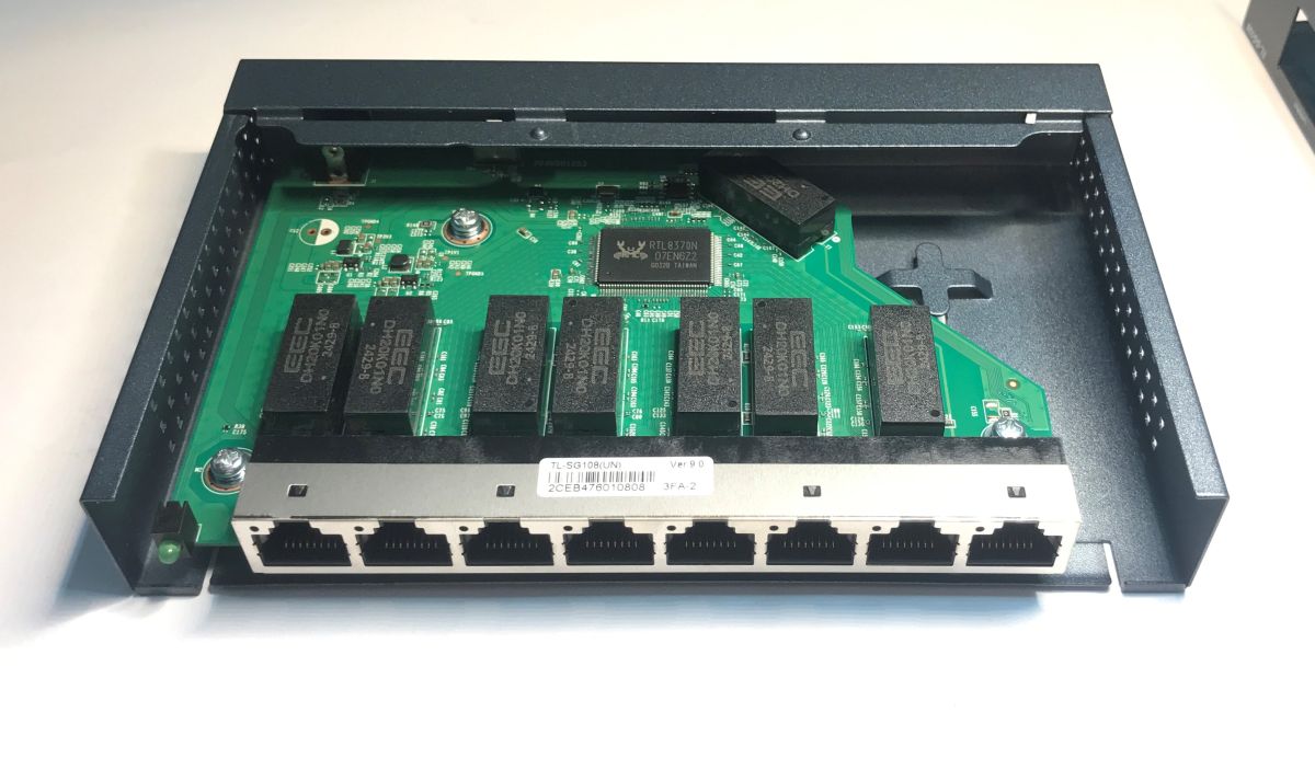

    However, we're in the 'Inside the devices' section, so it's time to take a look inside. The casing is solid and metal. I was surprised by its weight.
    All eight Ethernet ports are one module. It's probably cheaper that way. In addition, they have separate eight signal/isolation transformers. The eighth is on the front of the unit - it didn't fit them on the PCB.

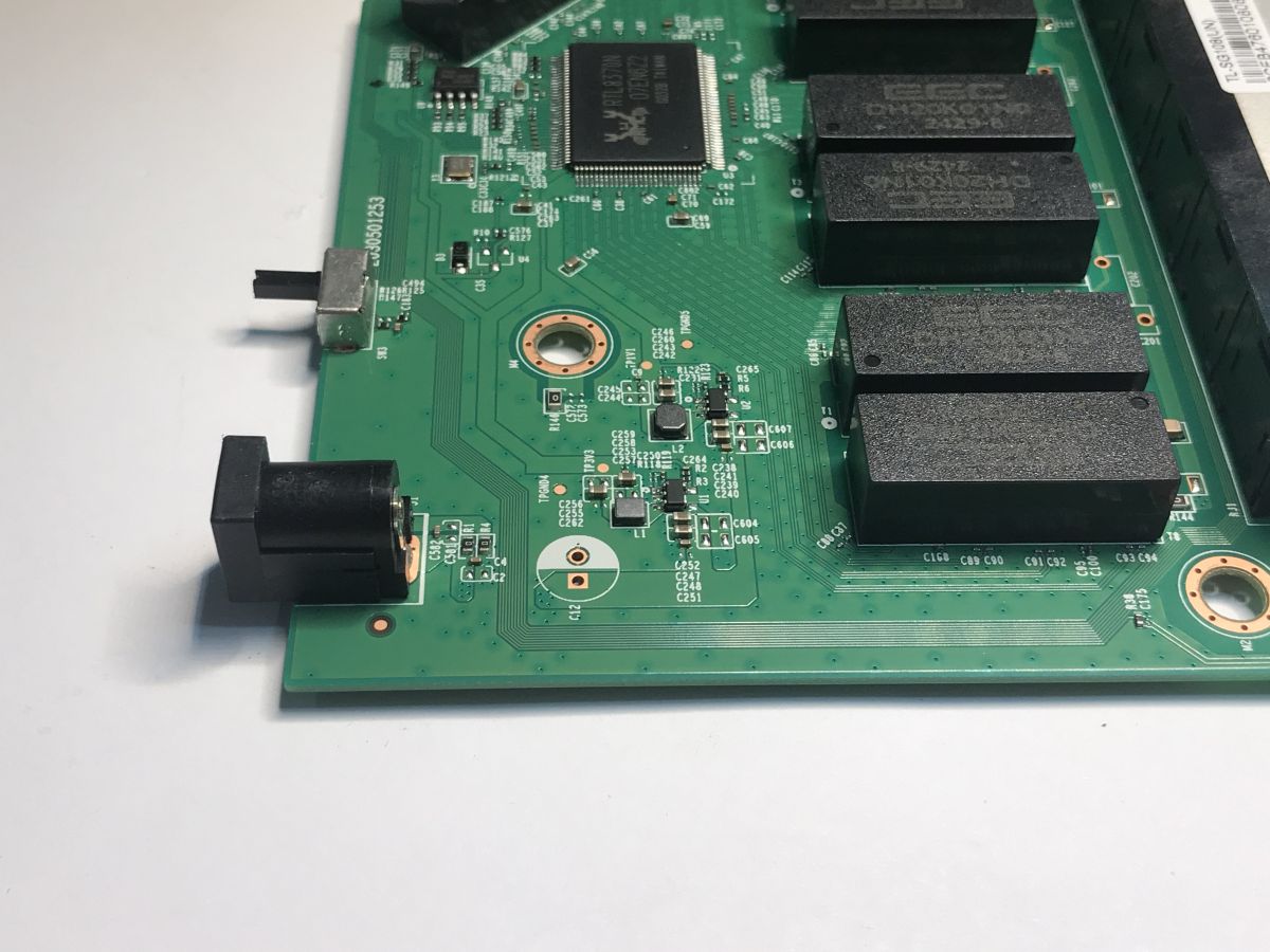

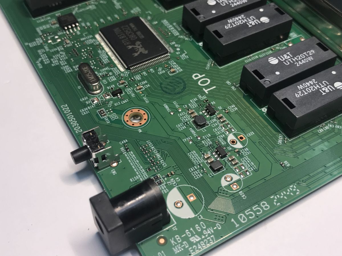

    Next to the DC Jack is a section with inverters providing lower voltage for the main MCU and memory.

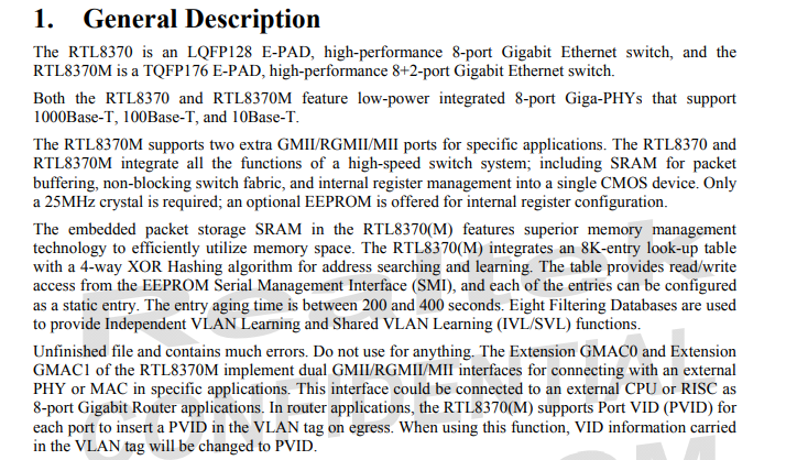

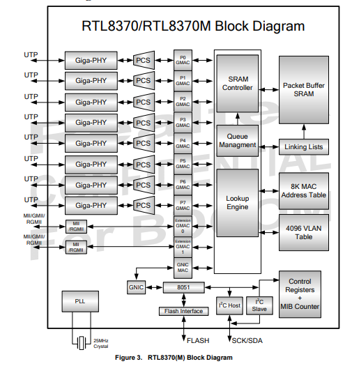

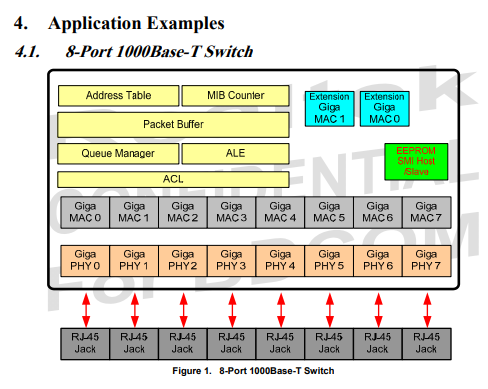

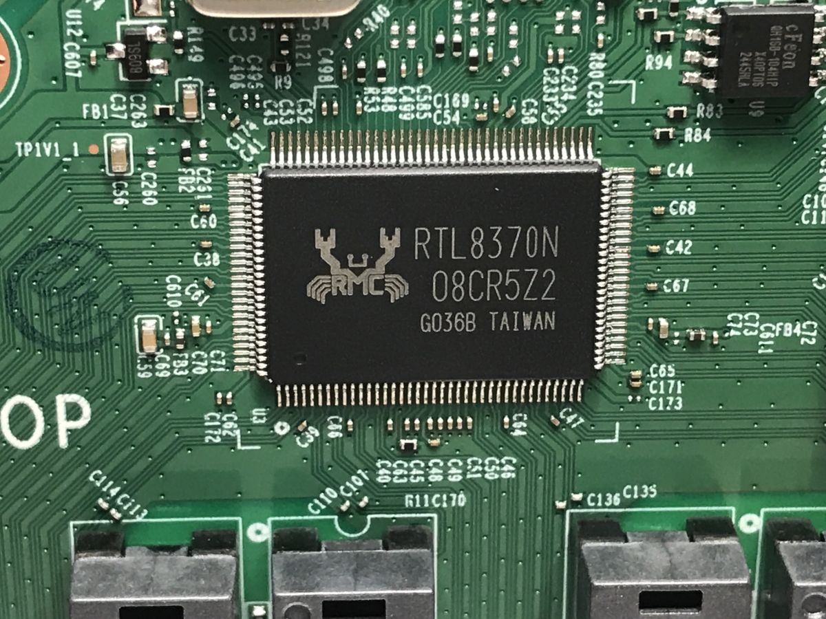

    The switch is based on the RTL8370N. The catalogue note describes it as a managed switch controller - "LAYER 2 MANAGED 8-PORT 10/100/1000 SWITCH CONTROLLER ". Managed? That's interesting, because after all, this version was supposed to be the "unintelligent" switch.
    Block diagram:

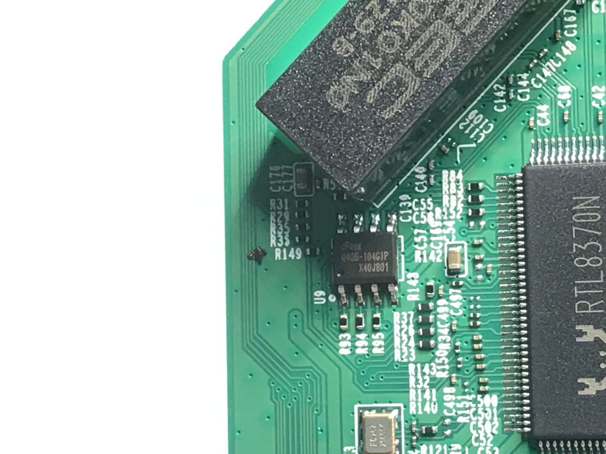

    Indeed, there is a Flash memory nearby:

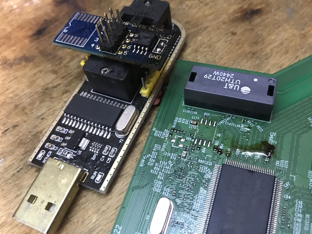

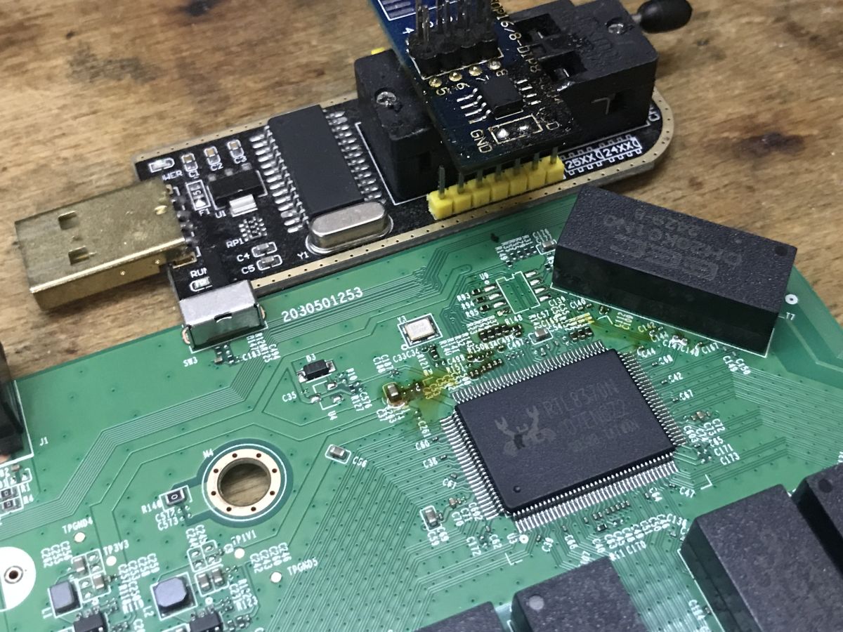

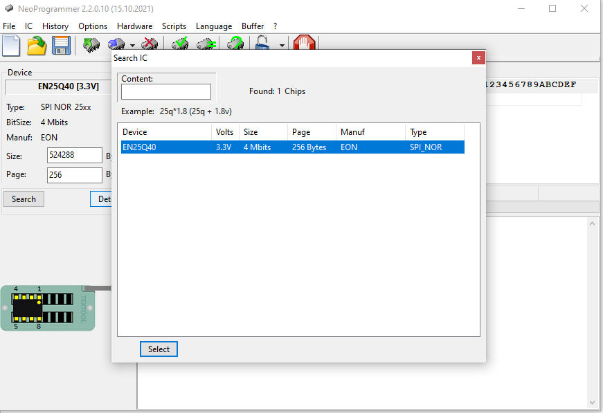

    That's now a few more pictures and it's left to dump the memory to a file.
    I have not played with the clip method. It is not very reliable. I have a hot air and can quickly solder such a memory bone onto the CH341 programmer overlay with it.
    The memory is EN25Q40, 4 megabits, SPI NOR from the 25xx family.
    A snapshot of the memory is available on my repository:

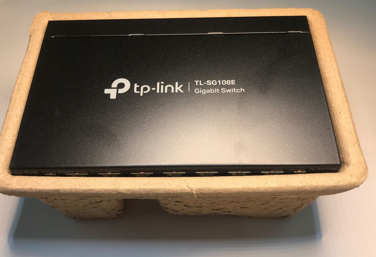

    Now it's time to take a look at a brother product - a managed switch.
    What's the difference between a smart switch and a regular switch? TL-SG108 vs TL-SG108E comparison What's the difference between a smart switch and a regular switch? TL-SG108 vs TL-SG108E comparison What's the difference between a smart switch and a regular switch? TL-SG108 vs TL-SG108E comparison What's the difference between a smart switch and a regular switch? TL-SG108 vs TL-SG108E comparison What's the difference between a smart switch and a regular switch? TL-SG108 vs TL-SG108E comparison .
    Extract. Set as before.

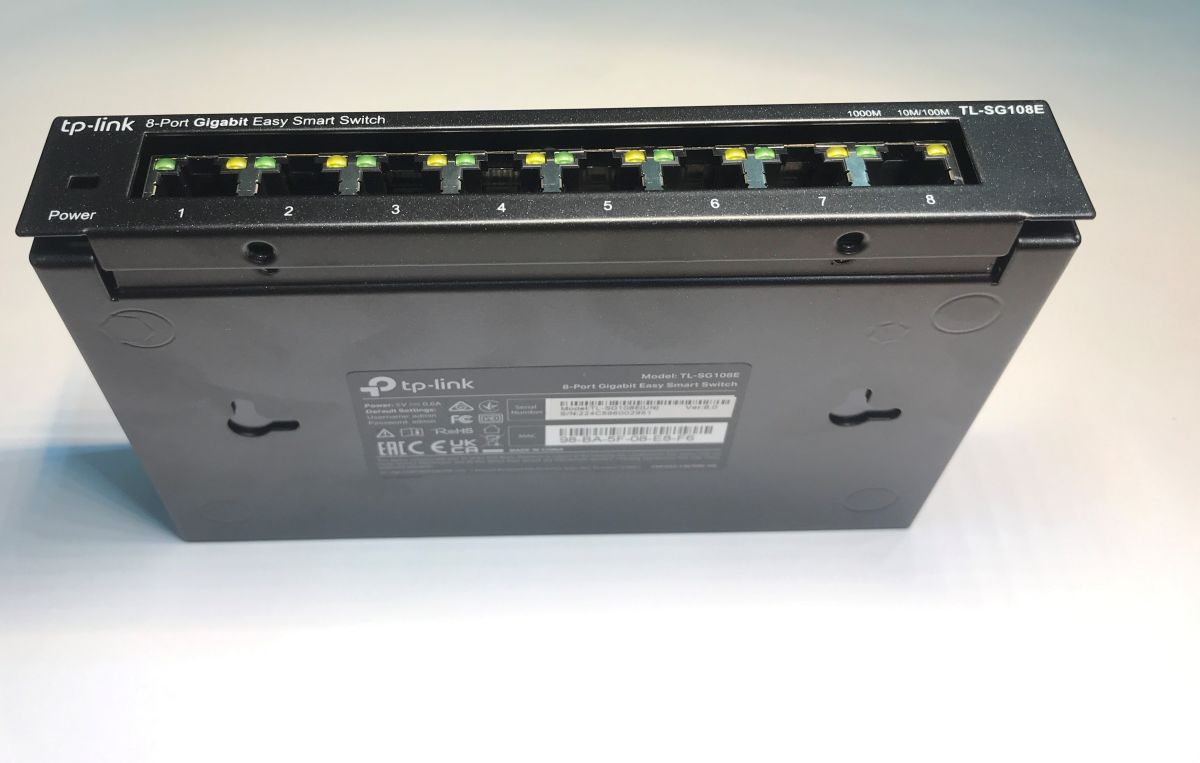

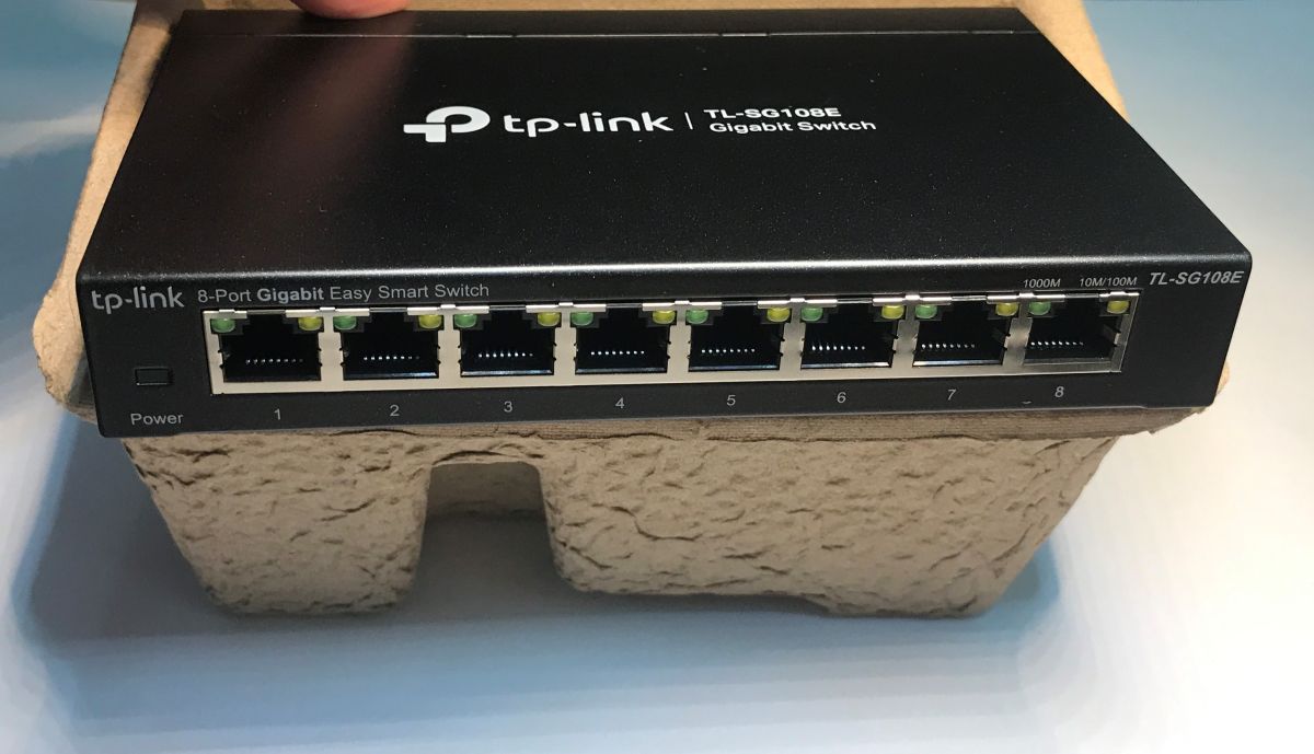

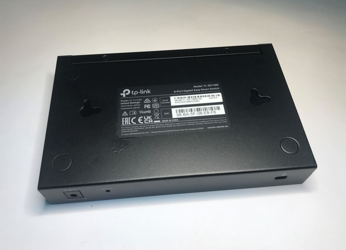

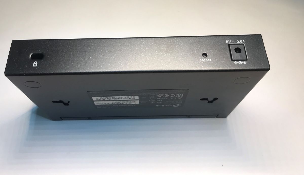

    The switch looks very similar from the outside. The RESET button on the back is obligatory, the Kensington connector (for the anti-theft cord) is too.

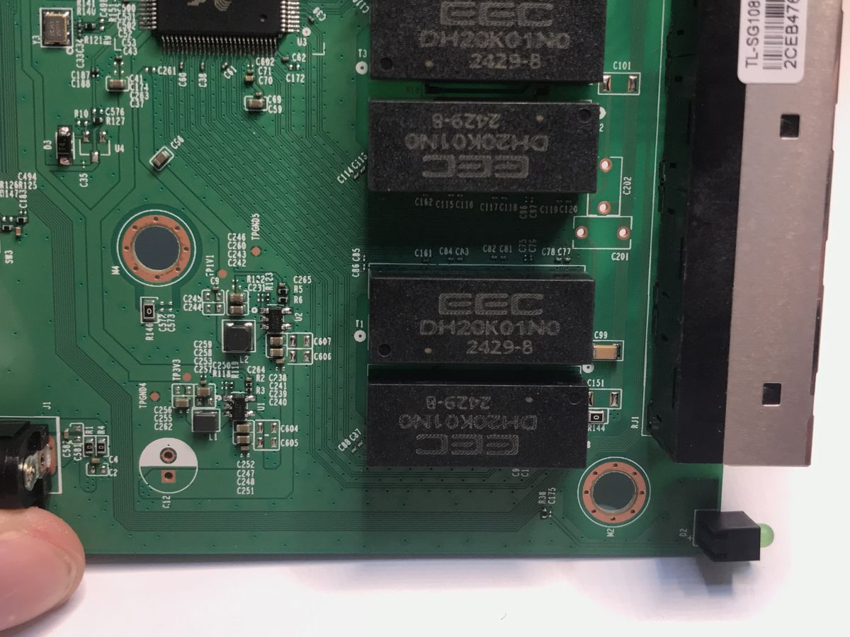

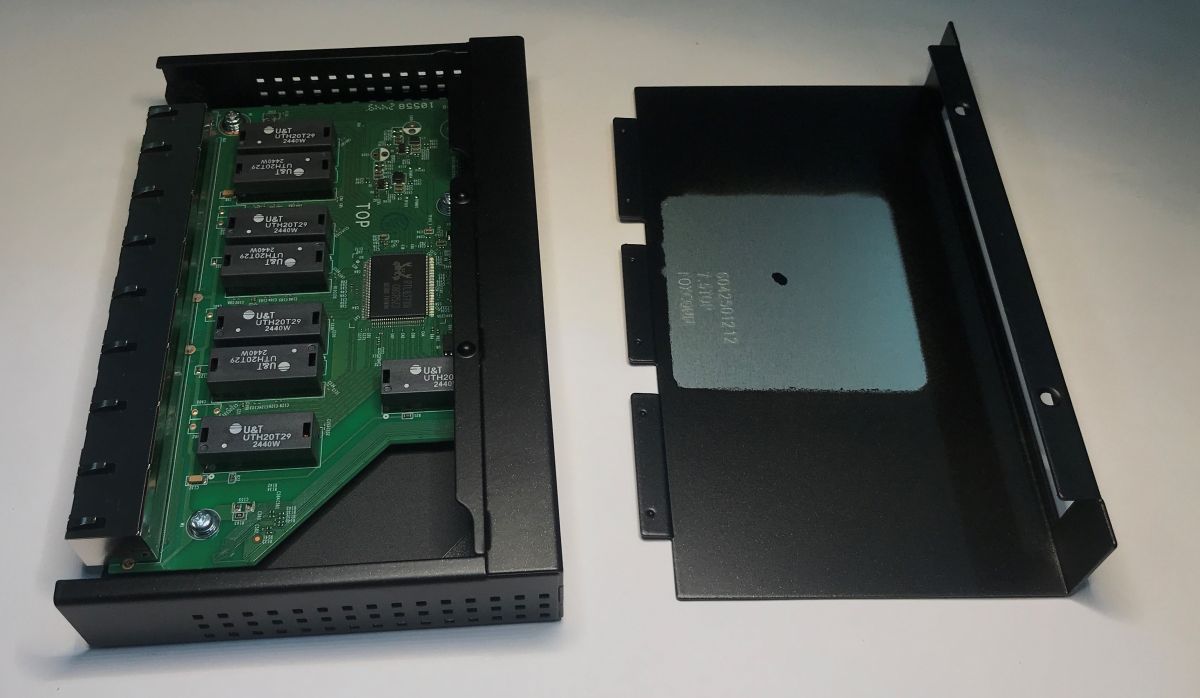

    We take a look inside. The interior is ... quite similar, although the isolation transformer is a different part model.
    Everything looks very similar. The power section, the memory, the main controller ... The quartz resonator is in a different housing, but the attention is drawn to something else.

    The main controller is the RTL8370N. Again - it's the same one as before. The difference seems to be in the software itself. I'm inclined to go as far as to say that it's likely that after losing the Flash memory from the TL-SG108E to the TL-SG108, the latter would gain manageability.

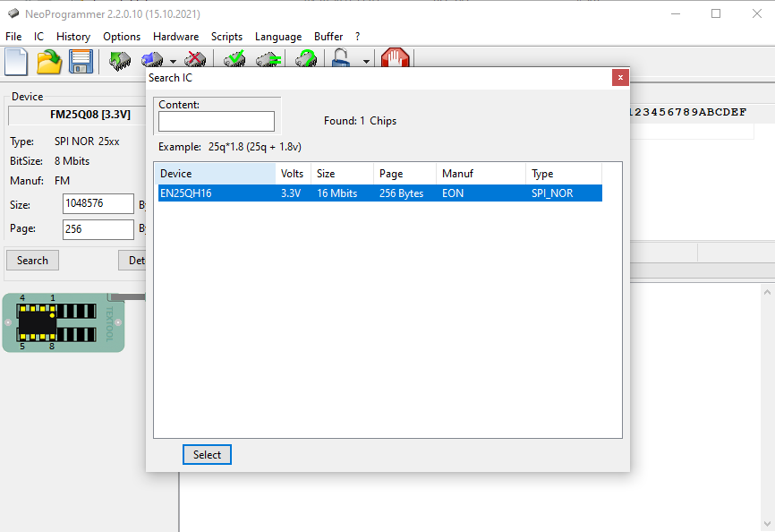

    I ripped the memory, of course:
    Here the memory is slightly larger.

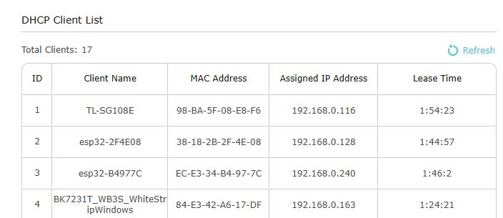

    Our DHCP router will detect the new device:

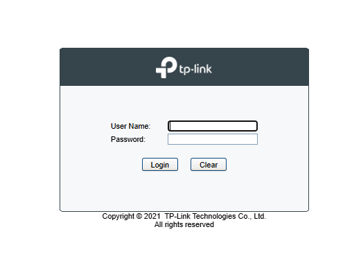

    We visit its IP address and log in with the data from the sticker.

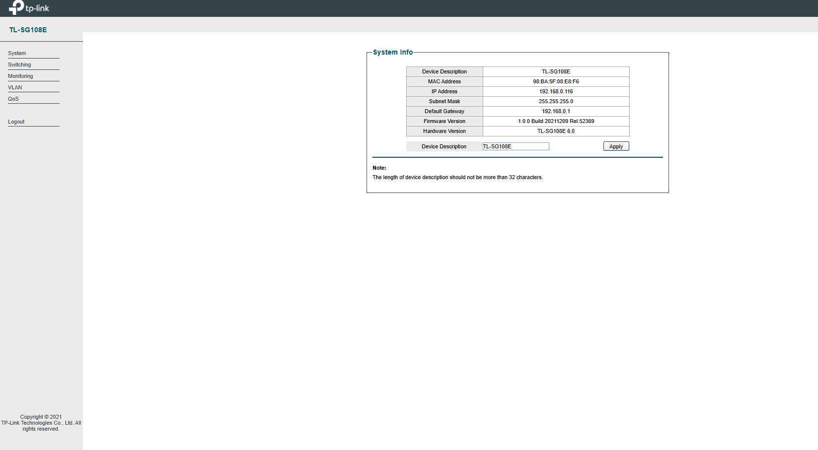

    On the homepage we have general information about the device:

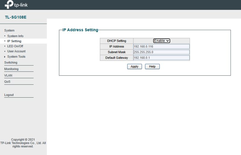

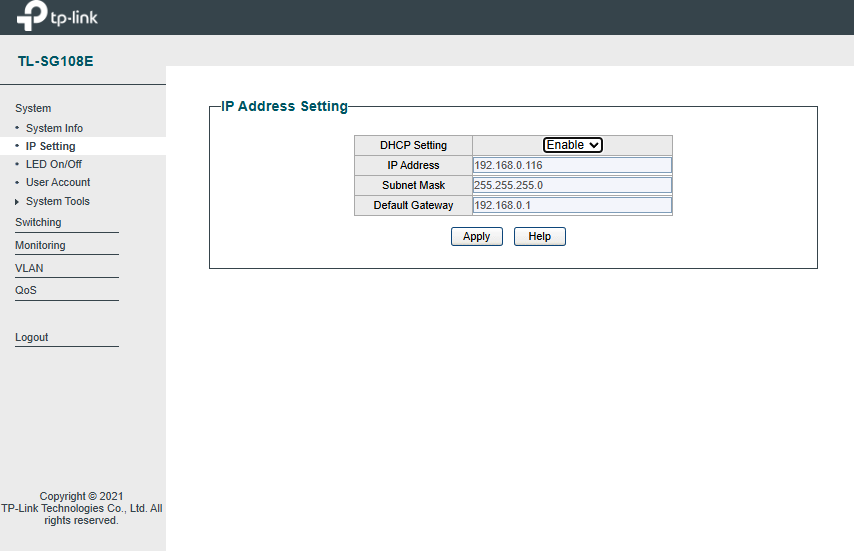

    DHCP and IP is configurable - this is basic.

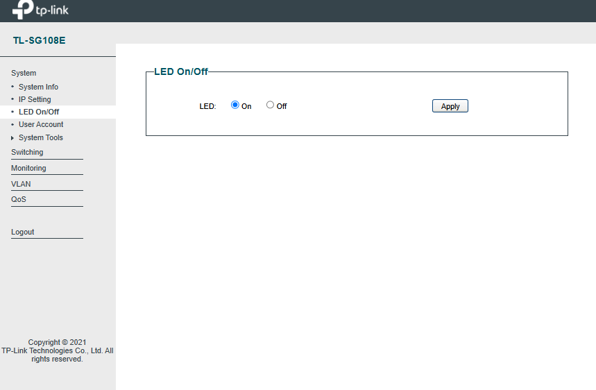

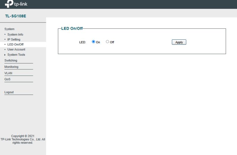

    Does the blinking LED bother you at night? Not a problem, here you can switch it off.

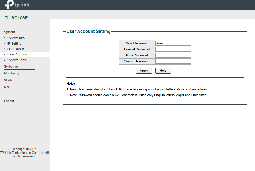

    The login password can of course also be changed.

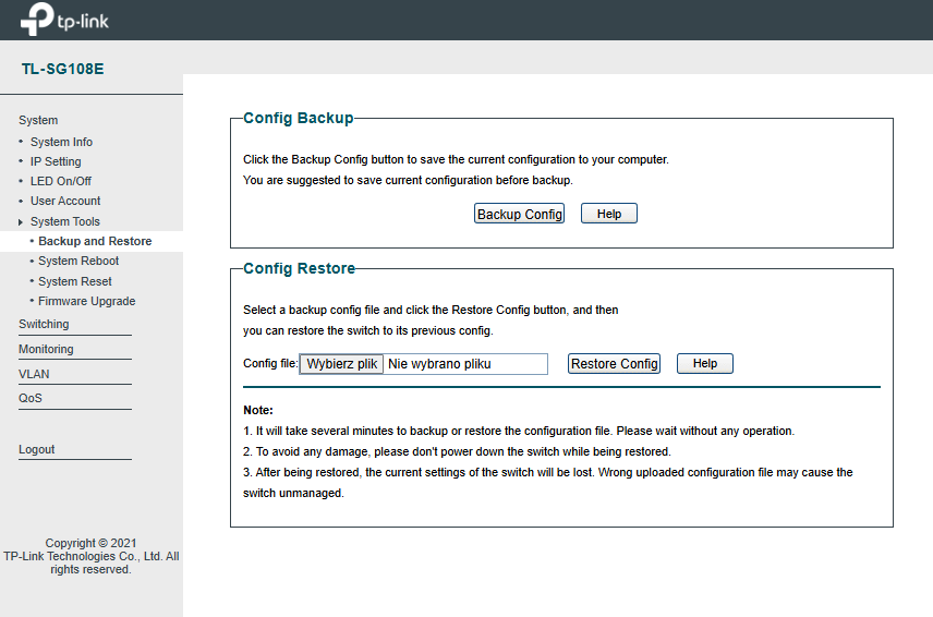

    The entire configuration can be saved to a file and restored from the file.

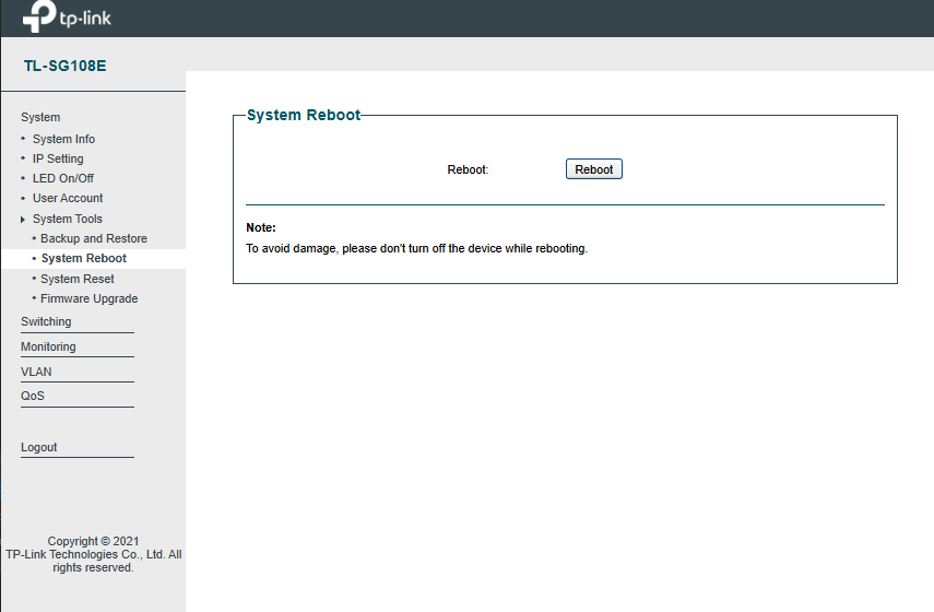

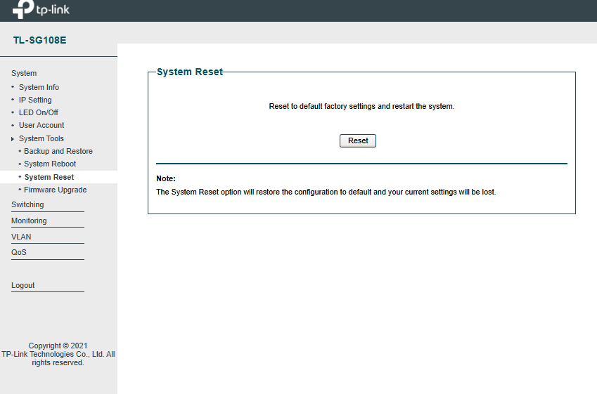

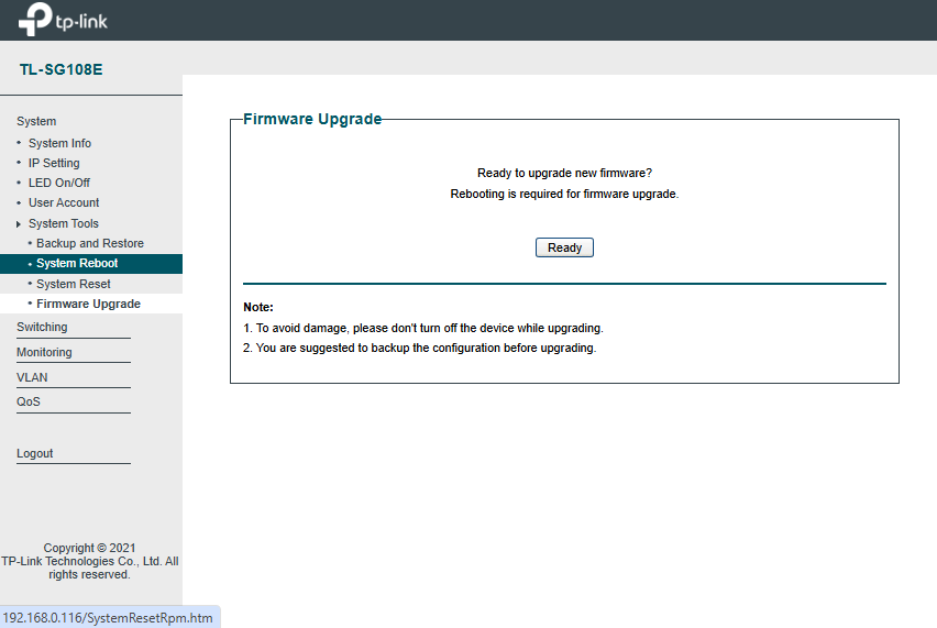

    The reboot (restart) and reset (restore to factory settings) options are unlikely to require comment.

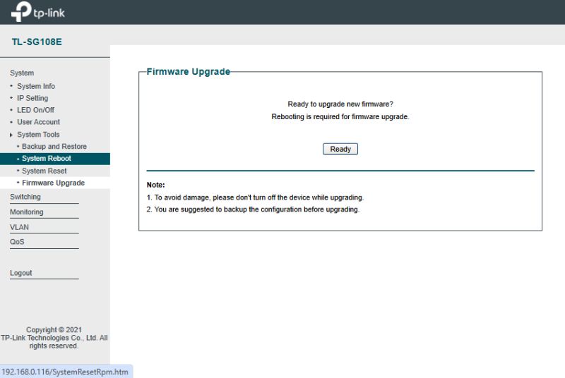

    Update option:

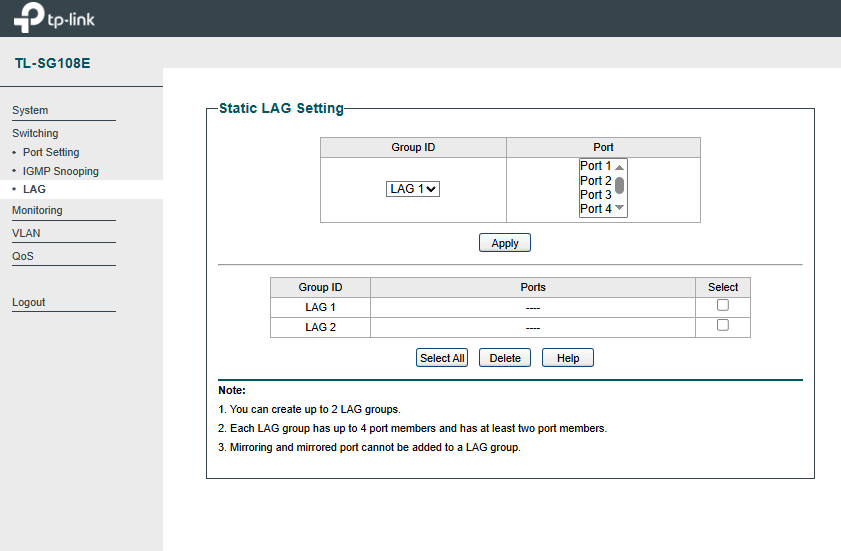

    The LAG setting is, counter-intuitively, not a delay setting, but a Link Aggregation Group option. It allows several physical ports to be combined into one logical port. This increases transfer and adds redundancy.

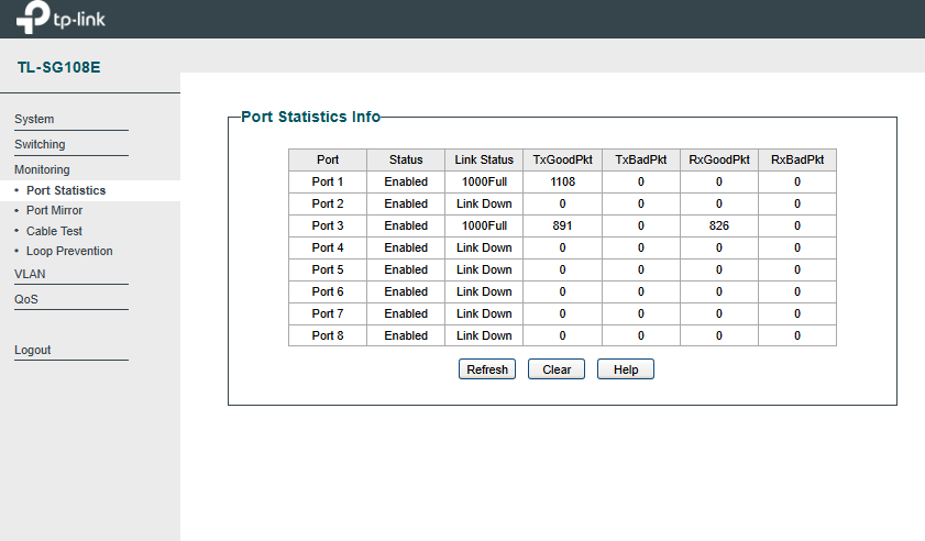

    In the monitoring tab there are, among other things, port statistics:

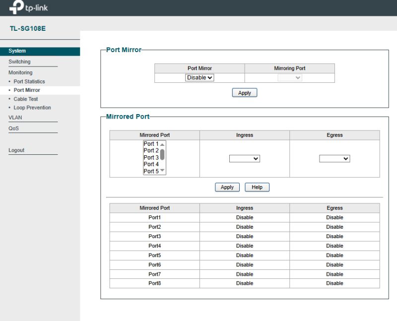

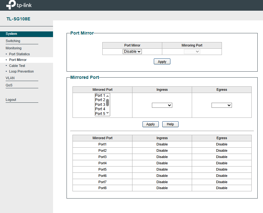

    Port mirroring allows traffic to be duplicated from one port to another. Ingress is the incoming traffic on a given port and egress is the outgoing traffic.

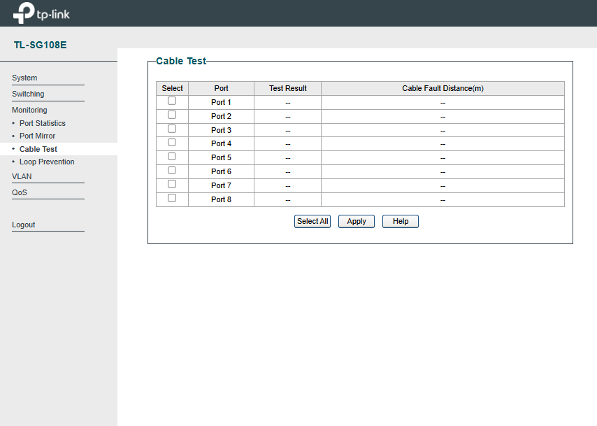

    Cable test is used to check the connection. It is capable of detecting short circuits, opens and even distance estimation.

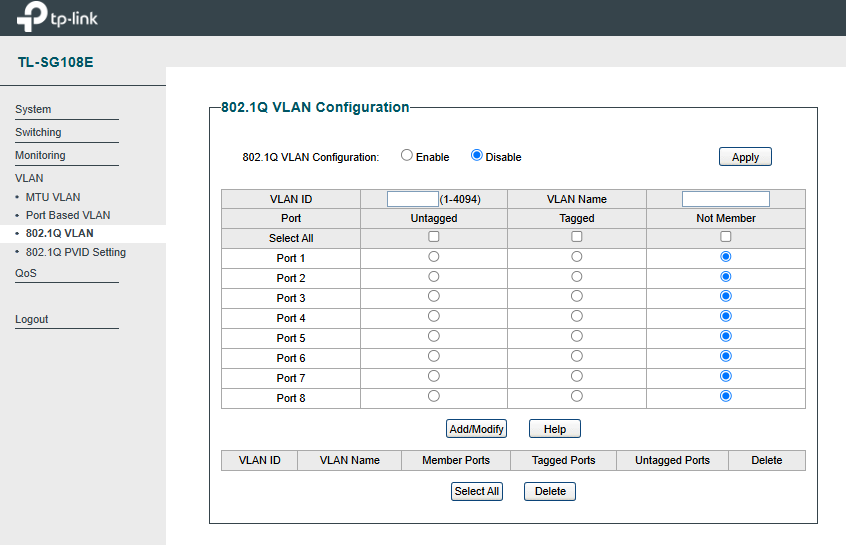

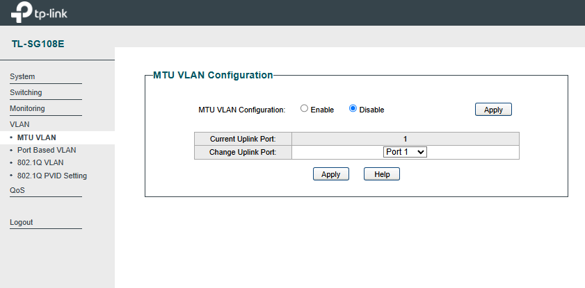

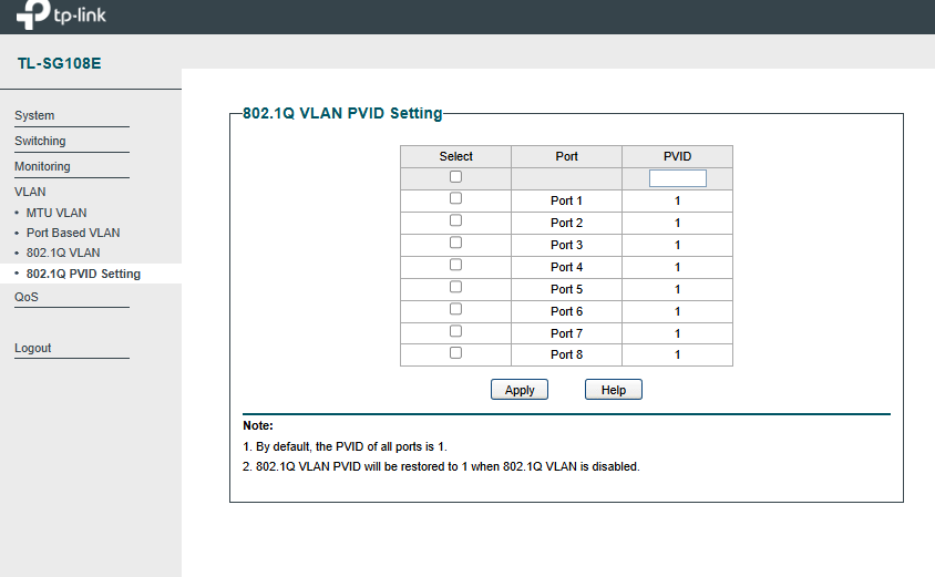

    Obout is the configuration of VLANs, or virtual networks. VLANs are used to logically divide one physical network into several separate parts + e.g. separately for departments in a company, even though everything runs on the same cables. This increases security, order and control over who can communicate with whom on the network.

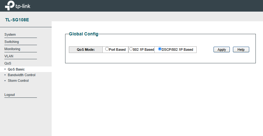

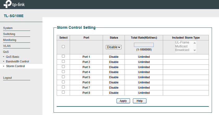

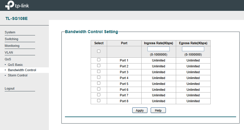

    Finally, there are the QoS settings, or Quality of Service. They allow you, for example, to prioritise or limit the transfer for a particular port.

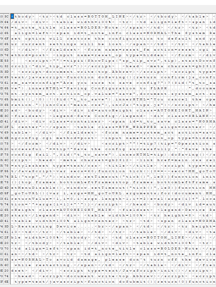

    I looked at some more memory dumps:
    You can see here the system messages and the page sources (HTML, CSS, Javascript...).

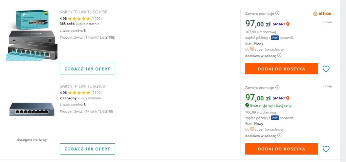

    In our case it was... PLN99 for a 'regular' switch, and PLN105 for a managed one. I guess that clarifies things a bit and at the same time nullifies the point of flipping the flash memory.

    Is LAG a LACP or is it a solution that will allow link aggregation between two identical switches?

    Such a switch smart can be useful, especially portmirroring will help with mobile debugging when we wireshark on a laptop to see what a problematic network device is doing. On the other hand, we are adding a device with a web interface to the network which is a potential attack vector....

    For me, at this price, a switch with a portmirror is a great tool for initial diagnostics of suspect network devices, or to help with deployments and integration.

    How does this LAG work? Can it be collated to devices with LACP or is it a LAG only between TP-LINK switches?

    >>21586931 I have not tested with other LAG manufacturers, between TP-Links it works fine, I have also tested RSTP and it works seamlessly with UBNT switches.

    >>21587609 I know that before 2020-2021 it was possible to modify TL-SG108 switches to TL-SG108E - by replacing the memory with flash and changing a few resistors. The modification worked as long as there were resistors on the flash memory data lines from the factory.
    Now, from what I've read on Russian forums and from my own attempts, it looks like TP-Link has added hardware or software security that blocks access to the web panel even after modification. It seems that from the new board revisions it is no longer possible to rework this.

    Just why do it when the prices are identical:

    #13 21590259
    wals12
    Posts: 36
    Help: 5
    >>21589060 I have not seen any alternative software for these switches. As far as I know, there is no publicly available sdk for the Realtek RTL8370 chip.I know, however, that someone from China managed to establish communication between ESP and the RTL8370 chip and made a switch of their own. The 8051 core built into this chip is used to operate the web server and manage the switch and the flash stores this although by default the chip prefers the eeprom. link to github from the Chinese person https://github.com/libc0607/Realtek_switch_ha...es?tab=readme-ov-file#rtl8370n_switch_hacking
  • Single 8051 MCU handles switch control and features
    #14 21590629
    aadeer
    Posts: 280
    Help: 11
    Rate: 178
    wals12 wrote:
    However, I know that someone in China has managed to establish communication between the ESP and the RTL8370 chip
    It seemed to me that in addition to this controller, there is a separate CPU (some ARM or MIPS) responsible for configuration, page handling and additional functions, communicating serially SPI or I2C with the switch port controller. This is also the case in OpenWRT for hardware that has more advanced features, looking quickly, some driver is: https://github.com/cgoder/openwrt_rtk/blob/ma...ers/net/rtl819x/RTL8370_RTL8367_API/rtk_api.h
    I was surprised that here this '51 is responsible for everything.
