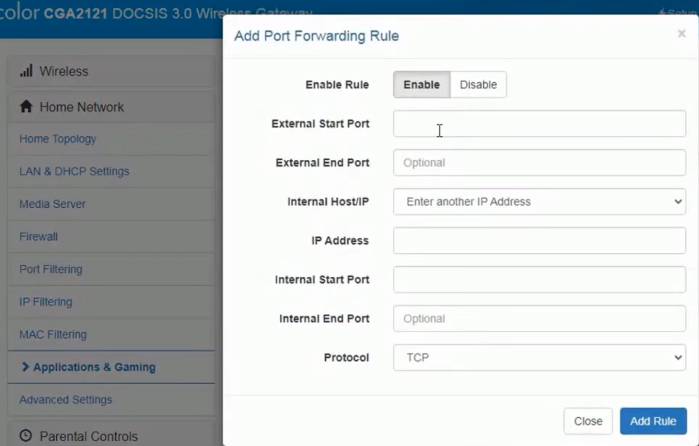

    Port forwarding settings window in Technicolor CGA2121.

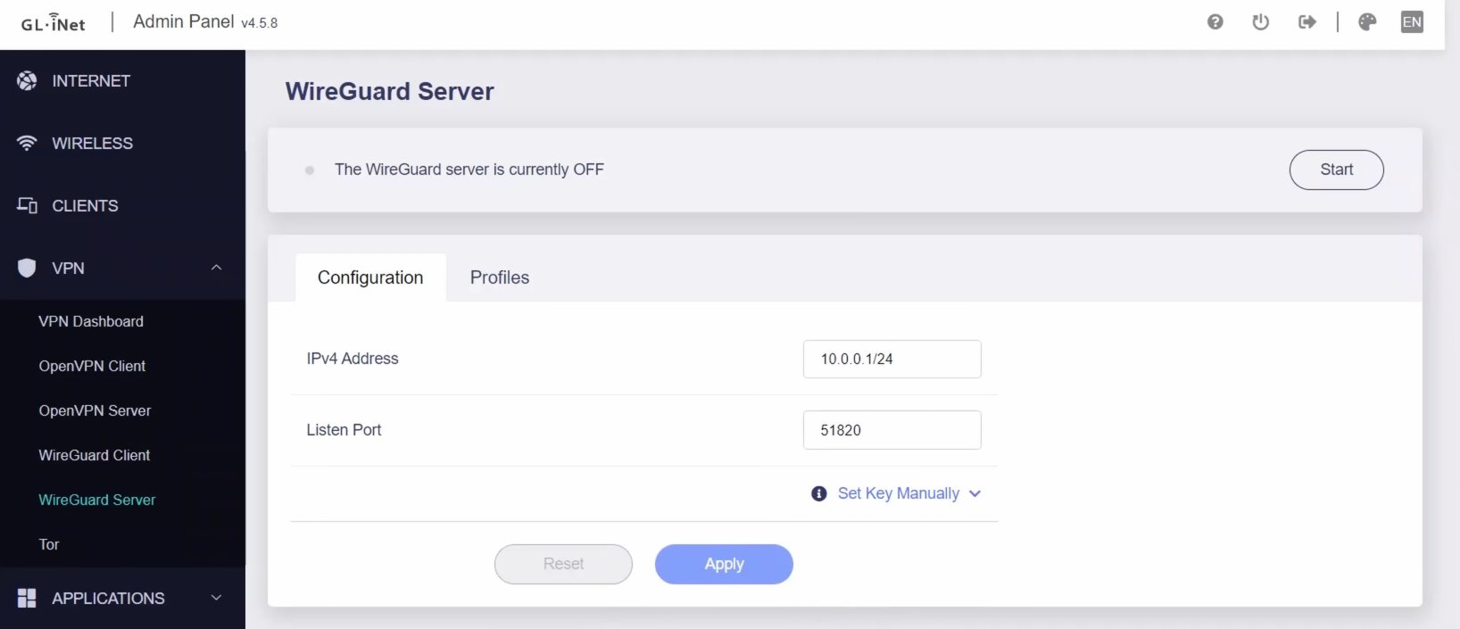

    VPN Wireguard settings :
    IPV4 adress : 10.0.0.1/24
    Listen Port : 51820
    Screenshot of GL.iNet admin panel showing WireGuard server configuration.

    1- How to fill the port fowarding settings in the settings of the Technicolor CGA2121. i dont know if we need to make port forwarding....

    @Fraizer
    Is the IP address on the WAN side of Technicolor public (preferably public static)?
    Without this, you will not be able to run the VPN server.
    Without a public IP address, port forwarding will also not work.
    If we want to connect our own router to Technicolor, it must be operated in bridge mode.
    Otherwise, there is no point in using two routers in one network.
    Connecting two routers together is correct, but you should apply what I gave in the paragraph above.
    If you have a public IP address for Technicolor, Technicolor will be in bridge mode, you don't set anything there (anyway, in bridge mode, you can't set anything). You set everything on GL.iNet.
    Regards

    michaeljamesromt
    Posts: 19
    For remote VPN access, you’ll need to forward the WireGuard port from the Technicolor CGA2121 to the GL.iNet GL-AX1800 Flint’s local IP. Ensure the Flint has a static IP, then in the Technicolor’s settings, create a port-forward rule for the UDP port WireGuard uses. Double-check firewall settings to allow the connection through.
