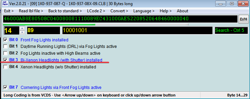

    I changed low beam lights for LEDs on octavia mk2 (also sometimes called 1Z or A5) (no led h7 bulbs, but LED projector retrofit).
    Car is based on PQ35 platform.
    Issue is that there is cold bulb check when key is moved to ignition is on or accessory position. Most times this results in error about one or both headlights having light bulb not working.
    So far I have tried:
    looking in VCDS and there is no way to disable cold bulb check for low beam
    VCP - this has option to program BCM eeprom, options for every bulb to disable cold bulb check EXCEPT low and high beams
    Vaghelper - this is basically what VCP copied
    I have added capacitor into one headlight and it seems to eliminate the error. but every time I turn on the car headlight does flash as it does the cold bulb check, which is kinda embarrassing. It does so even without the capacitor, but very dimly.
    from the ELSA it seems that BCM pins they cold bulb check need to be disabled are A11 and C52.
    Is there a known way to program BCM to not do cold bulb check for low beam?
    Is there known hardware workaround that would get rid of the error and not cause headlights flashing?

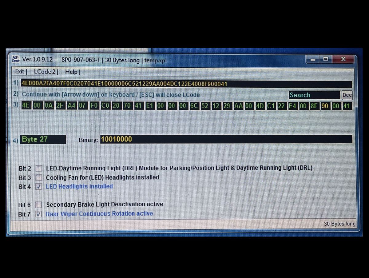

  • VCDS parameter change stopped headlight flashes
    #7 21349956
    Gerri
    Mercedes specialist
    Posts: 5699
    Help: 865
    Rate: 3629
    I don't know how helpful this is or how to judge the similarity of our cars, but I had a spare moment today and sat down on VCDS to find what I changed. And I found it. So I am posting - but how much it will help you I don't know....
    Computer screen showing VCDS software for automotive diagnostics. .
    I had the same symptom as you: after turning on the ignition a few flashes in one headlight, immediately afterwards the same in the other. After changing the parameter "like a hand, it went away".

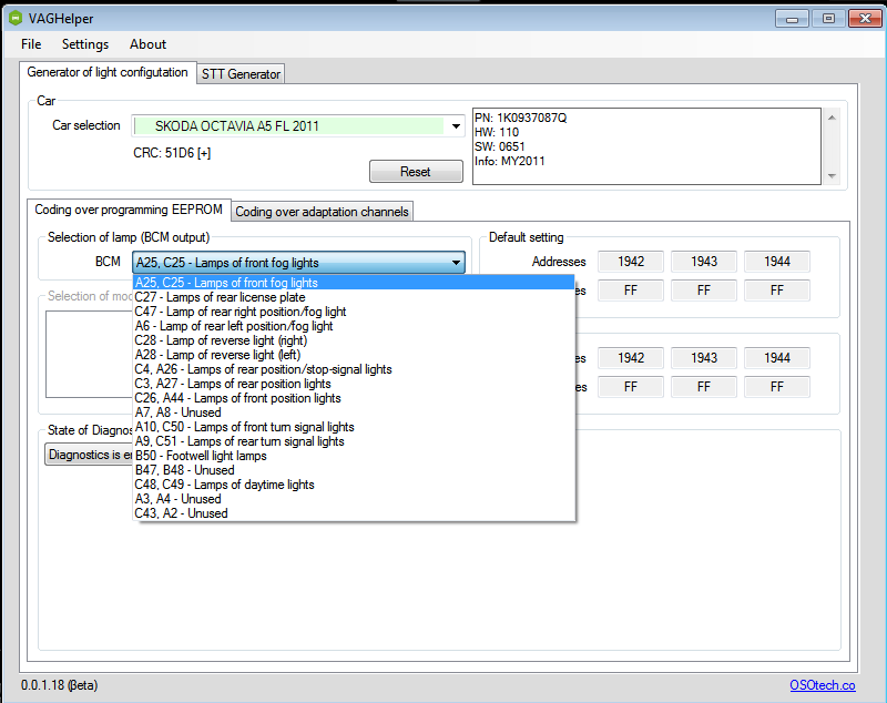

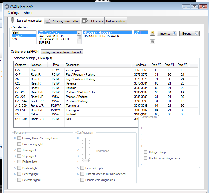

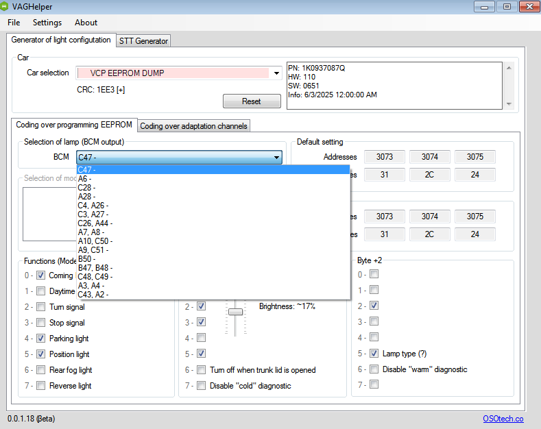

    #9 21578340
    evlo2
    Posts: 35
    Anyway today I wen to local equivalent of MOT/TUV - STK I do not know if in Poland you call it BTP? And they did not like the flashing.
    Since my last post I found out that it does happen when you turn the car off and then on shortly. No idea how to get rid of this now. I'm guessing it is something related to the fact that during cranking car does disable accessory power.
    I figured older VAGhelper can decode VCP exported HEX string to the corresponding pins in bcm - but asi zou can see neigher A11, nor C52 is there so I do not know if it is VCP export at all
    46000AB8E80508C040080081110081EC431000AE52208520648460000040
    maybe this export is some predefined addresses just put right one after the other and not just som "FROM TO" part of BCM eeprom
    So seems to me, that issue is that VCP and VagHelper only export byte18, while the config for the pins i need is somewhere else :/ (byte18 is what vcds tells you not to change basically ever :D )

  • VCDS xenon settings that disable cold bulb check

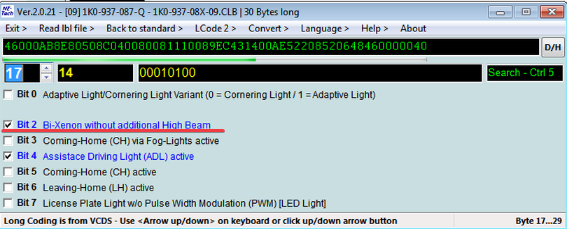

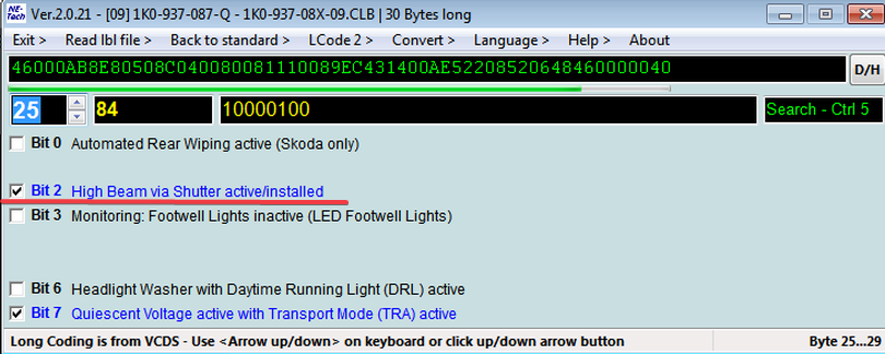

    #10 21578618
    evlo2
    Posts: 35
    So there is one exact combination of xenon settings that makes everything work in VCDS
    14-3
    17-2
    25-2
    this way - no cold bulb check (I did not test hot bulb) for low beams and high beams, still high beams turn on, even automatically when lights are set to auto and even the halogen high beams do work in conjunction with bi led shutter. Even the lights signal to the radio and interior lighting works correctly.
    Another update - for cars with factory DRLs you can set xenon without active shutter in screen 14 as xenon shutter uses same pins on BCM as the ones used for DRLs on halogen cars.
