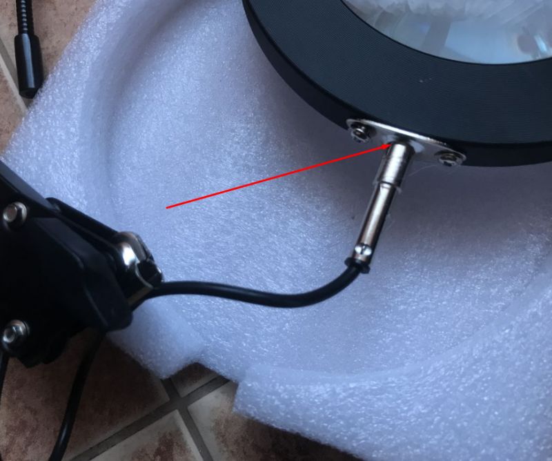

    I presented the lamp three years ago in the topic: Large "third hand", magnifier, USB lamp - Newacalox - review

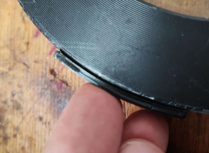

    So the damage was done to this joint:

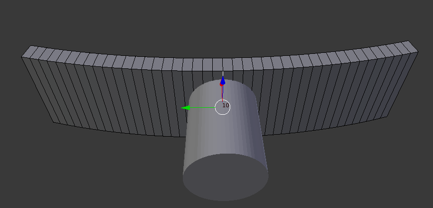

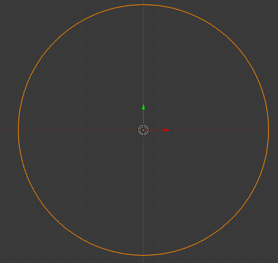

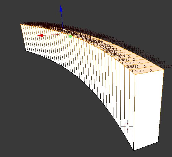

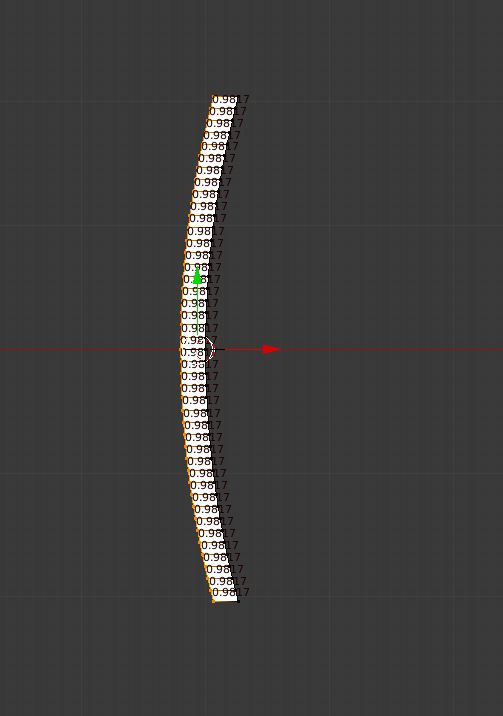

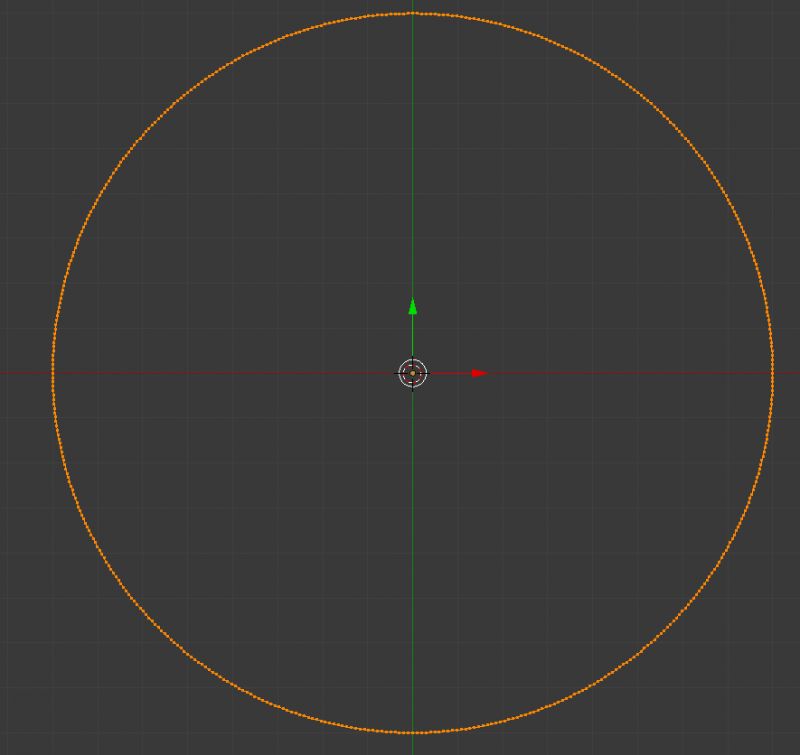

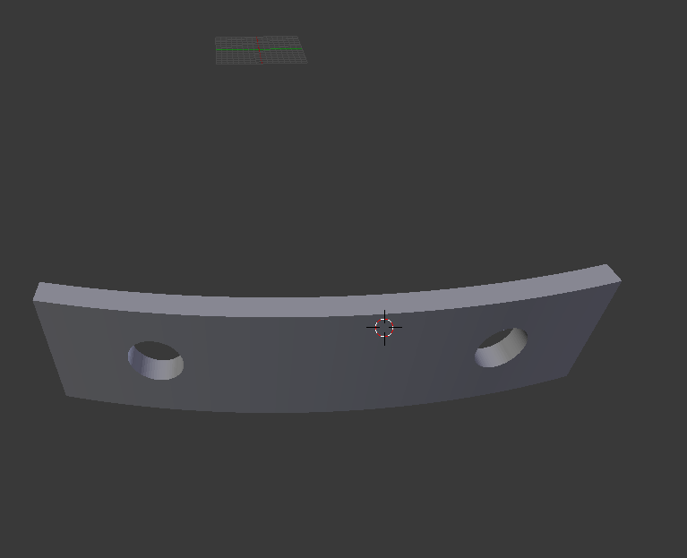

    I created the replacement in Blender. I started the adventure with a circle of diameter in line with the diameter of the lamp:
    Print-experiment - repairing a workshop light, replacing a metal component

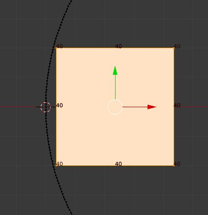

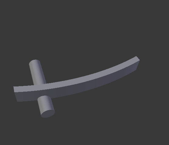

    I then prepared myself a block with a length that matched the desired element (circle cutout):

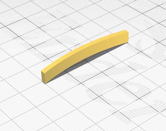

    Based on this I cut out this cutout and gave it a thickness:
    At this point it was still two-dimensional:
    For this reason I then gave it a third dimension:
    I made a print for the fitting:
    Fits:
    Now it's time for the holes. I have created the cylinder so that its origin point is on the symmetry axis of the piece, this in order to later add a mirror image to have the two holes symmetrically:
    After adding the "mirror" modifier:
    Then I added "boolean" - i.e. we cut a new shape from the previous element:

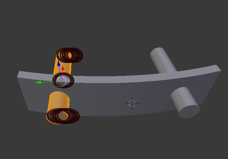

    Then it was time for another cylinder, also with "boolean" - but this time a sum operation:
    Fitting:

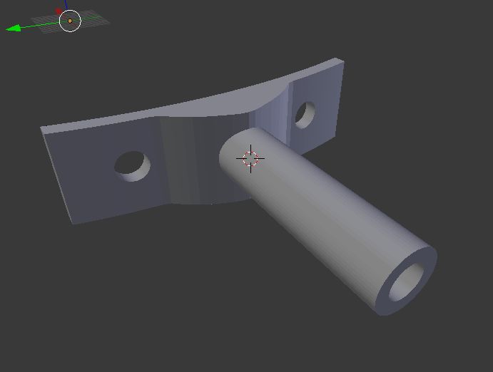

    A few improvements later I still cut the third hole and the shape is tentatively ready:
    The third hole is needed because the wires are routed through it.

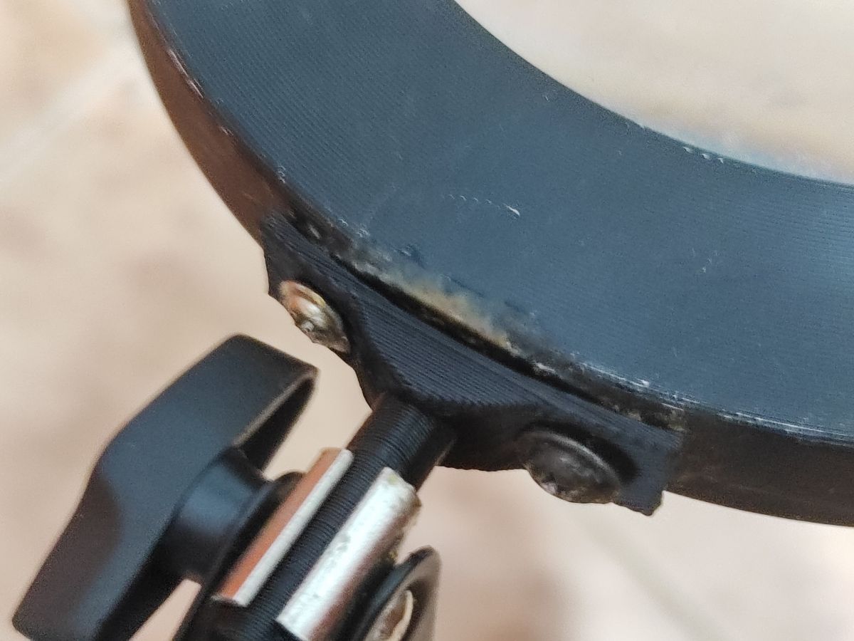

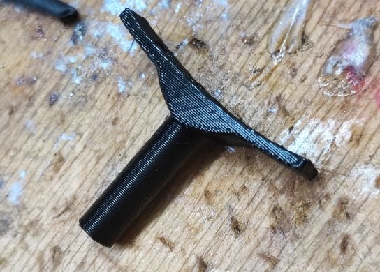

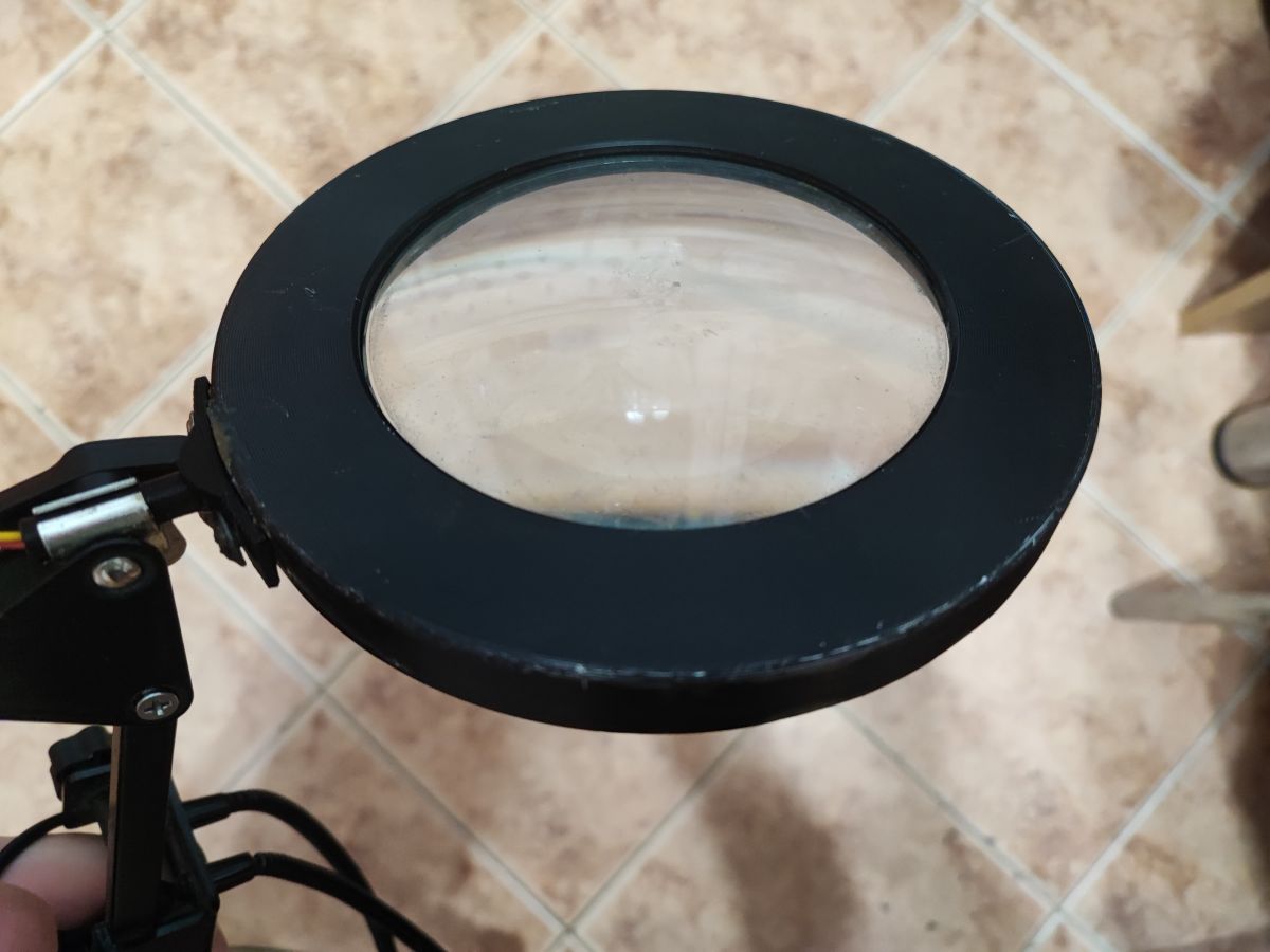

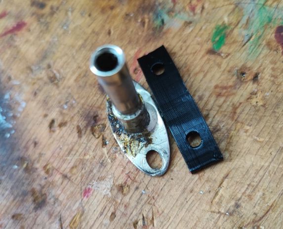

    Printed component:
    I printed the piece on a slant to reinforce the structure a little.
    Print-experiment - repairing a workshop light, replacing a metal component Print-experiment - repairing a workshop light, replacing a metal component
    Done! Now the only question is how long it will last....
    Summary
    I waited about a month before writing the topic, during this time I have used the lamp normally and I can already state with a clear conscience that the print has performed well. Nothing has broken yet, and even if it does, I have a second piece in reserve. It costs practically nothing. The piece only weighs 2-3 grams, and considering that I pay about PLN50 for 1kg of filament it's really pennies, even including electricity and time spent in Blender.
    Could it have been fixed any other way? I don't know, you guys can tell me, but in terms of my capabilities the 3D printing solution worked perfectly.

    PLA, despite appearances, is quite hard and stiff. If it is not heated too much, it can surprise with its toughness.
  • #3 21202241
    lukasrsv
    Level 20  
    Posts: 591
    Help: 41
    Rate: 165
    I would suggest a different print layout to reinforce the strength of the component.

    All in all you're right about the angled print, although at the same time I'll stress that I didn't print flat. I set it at an angle and the tree supports held it, I just didn't take a photo.
    @Grzegorz_madera I did an experiment and without respecting the dimensions I modelled such a shape in Blender in 5 minutes (recorded non-stop, not sped up):
    EDIT: Pre-empting a potential discussion - I'm not saying this is the fastest and best way to 3D print, quite the contrary, but simply everyone uses what they know and have at hand.

    without respecting the dimensions, I modelled such a shape in Blender in 5 minutes
    In my case, it would have taken less than a minute to weld up the original component with a migomat.

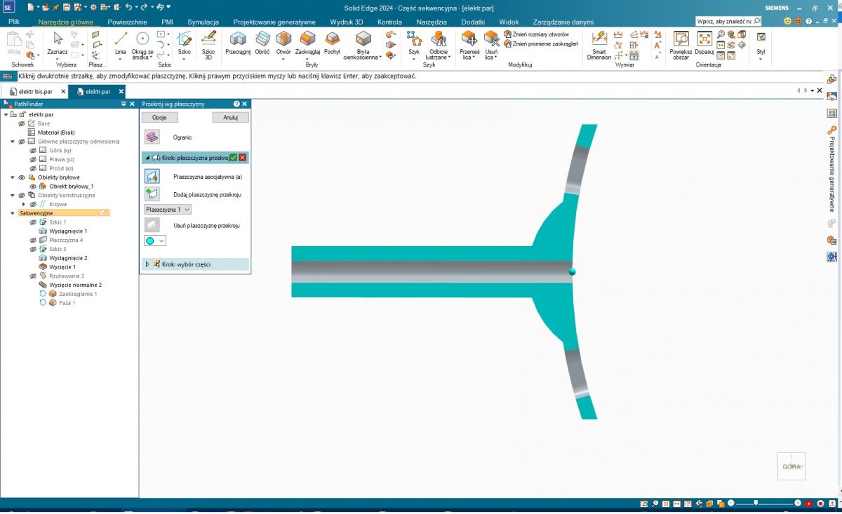

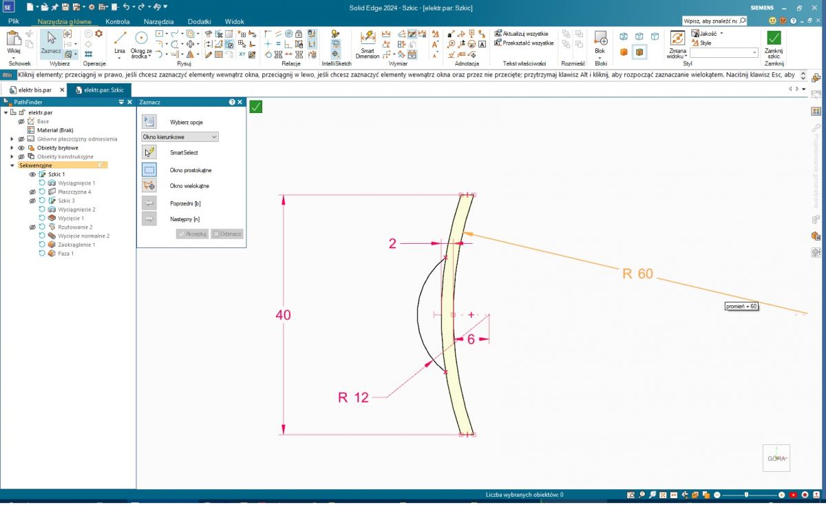

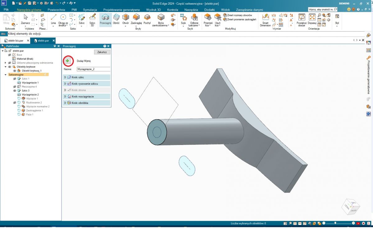

    @p.kaczmarek2 You print (also described in other topics) specific items useful in life or spare parts for broken devices which I very much support. Not like most printers useless figures downloaded from the Thingverse or other portals. Although I am not a haunted environmentalist I don't like waste and throwing away repairable things. But - that there is nothing so good that cannot be improved, let me make two comments.
    FIRST COMMENT

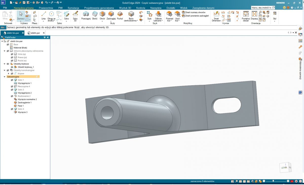

    Concerning the programme. It is true that the best programme is the one we know how to use. But nothing prevents you from trying another. For so-called technical projects, real CAD works much better.
    This is what it looks like in Solid Edge, the dimensions are "by eye" because I couldn't find the right ones.
    Sketch of the part adjacent to the lamp (on one of the main planes):
    Sketch of the sketch, in this case symmetrical:

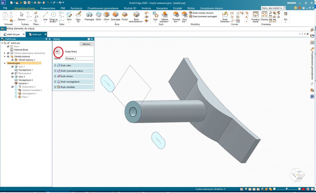

    Sketch on a plane offset to the length of the tube:

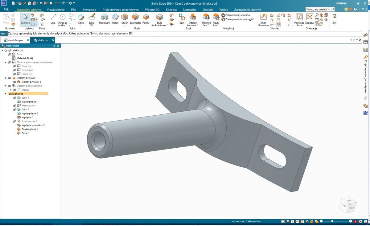

    Extracting the cylinder:

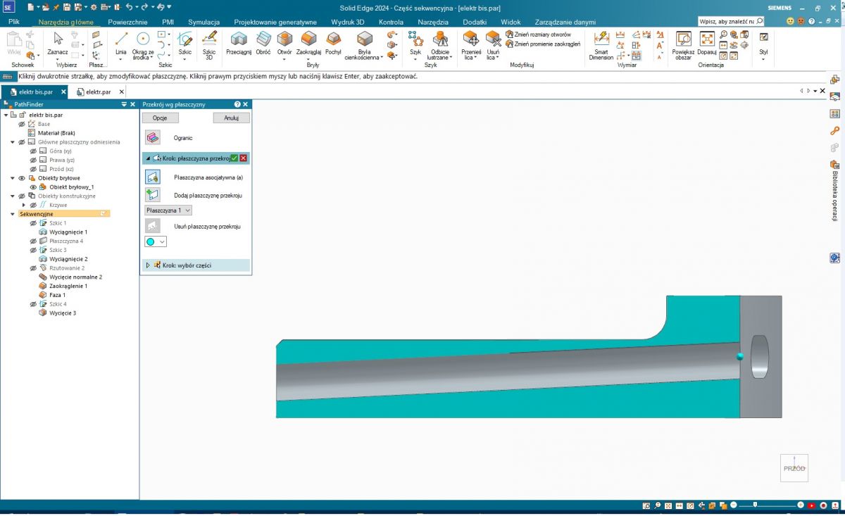

    Cutting out the hole:

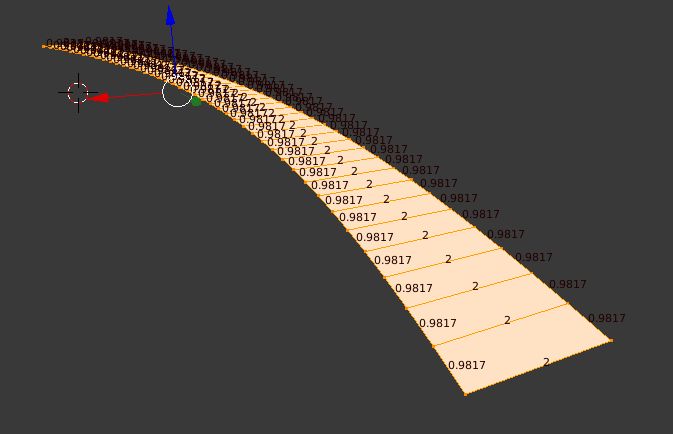

    Projection of a sketch of the oblong holes onto a cylindrical surface. The original part shows this shape.
    Normal cutout of these holes. For the less oriented - in geometry, the term 'normal' means perpendicular. This can be seen in the section; the hole is perpendicular to the cylindrical surface....
    Rounding and chamfers:
    View from all sides:
    For dessert, parametricity. Every CAD has something like a spreadsheet built in. In SE this is called a Table of Variables. All the dimensions assigned to the variables are there, you can give them their own names, edit them to enter relationships between them. For example, I have entered the relationship between the width of the part adjacent to the lamp (abutment) and the spacing of the fixing screws. This is useful, for example, in order to easily and quickly adapt such a holder to another lamp. Or to make a correction when material shrinkage has changed the dimensions too much.
    I recommend the programme to everyone; it is not truncated like Fusion and not clumsy like FreeCAD.
