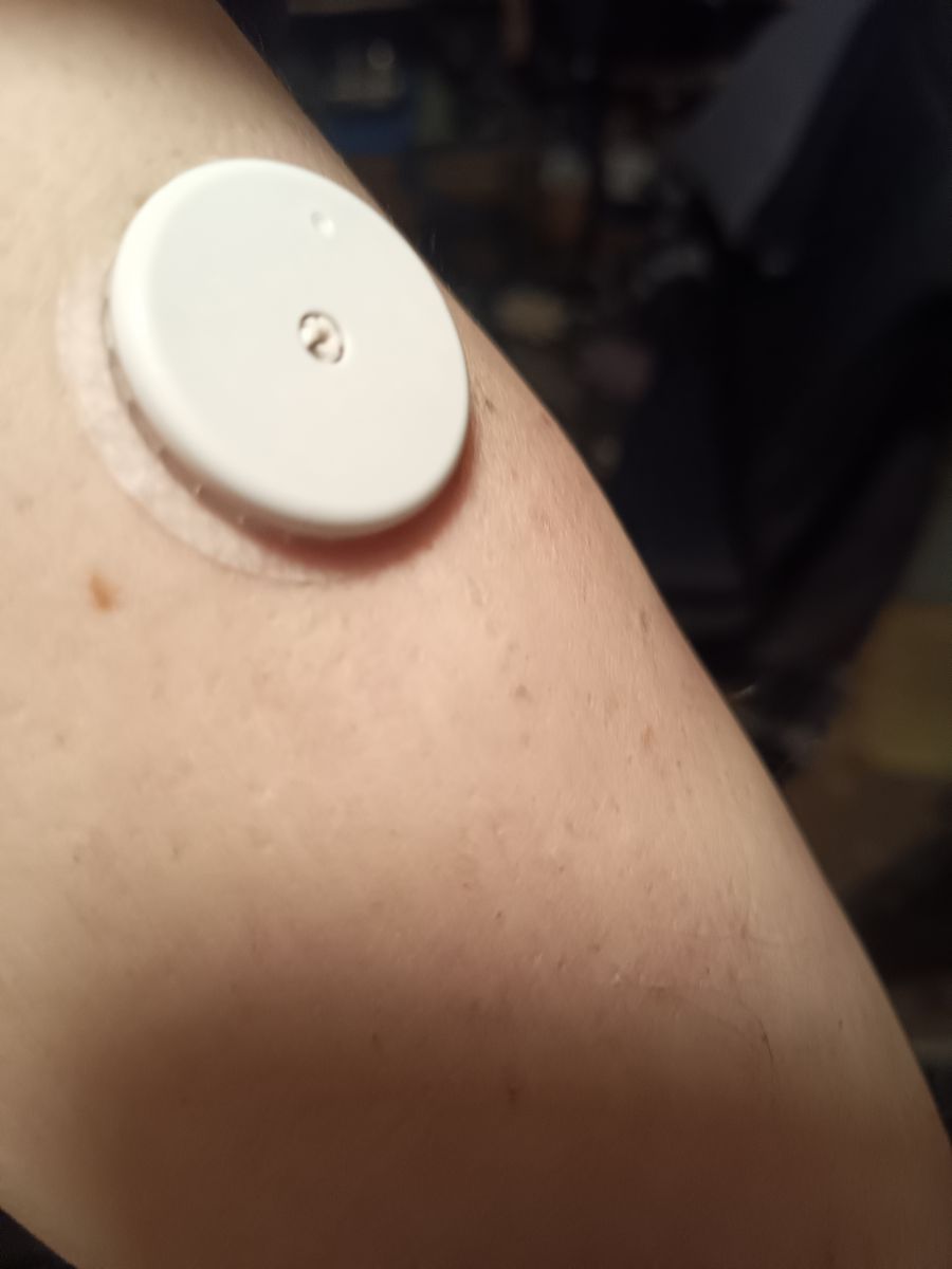

    I am disabled due to my job (and type II diabetes), so I have LIBRE reimbursed by the National Health Service. Finally, no more stubbed toes. And this is how it looks on the hand.
    Glucose monitoring sensor on a person's arm. .
