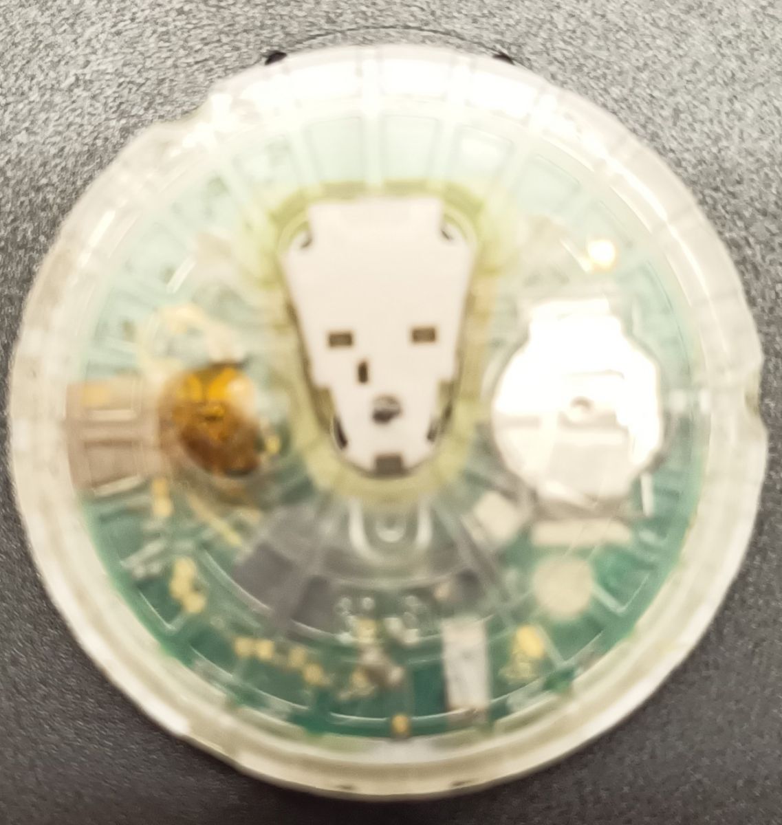

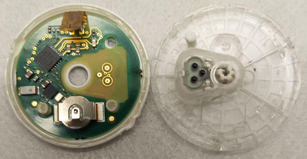

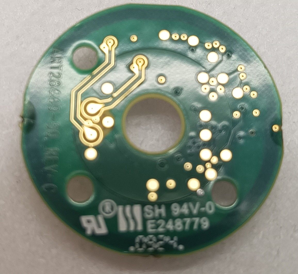

  • FreeStyle Libre 2 continuous blood glucose sensor is dismantled to show what sits under the skin and how its electronics communicate.
  • A spring-loaded applicator drives a 5.5 mm composite blade and a 1 mm sensor 2–3 mm into flesh.
  • The PCB is 0.5 millimetres thick and uses an RF430 MSP430-based chip plus an EM9304 Bluetooth 5.0 controller.
  • RFID pairs the phone by close contact, then Bluetooth sends measurements; the sensor stores several hours of readings if the phone is out of range.
  • The sensor lasts 14 days, but the design throws away blood-contaminated medical waste and advanced electronics every replacement.

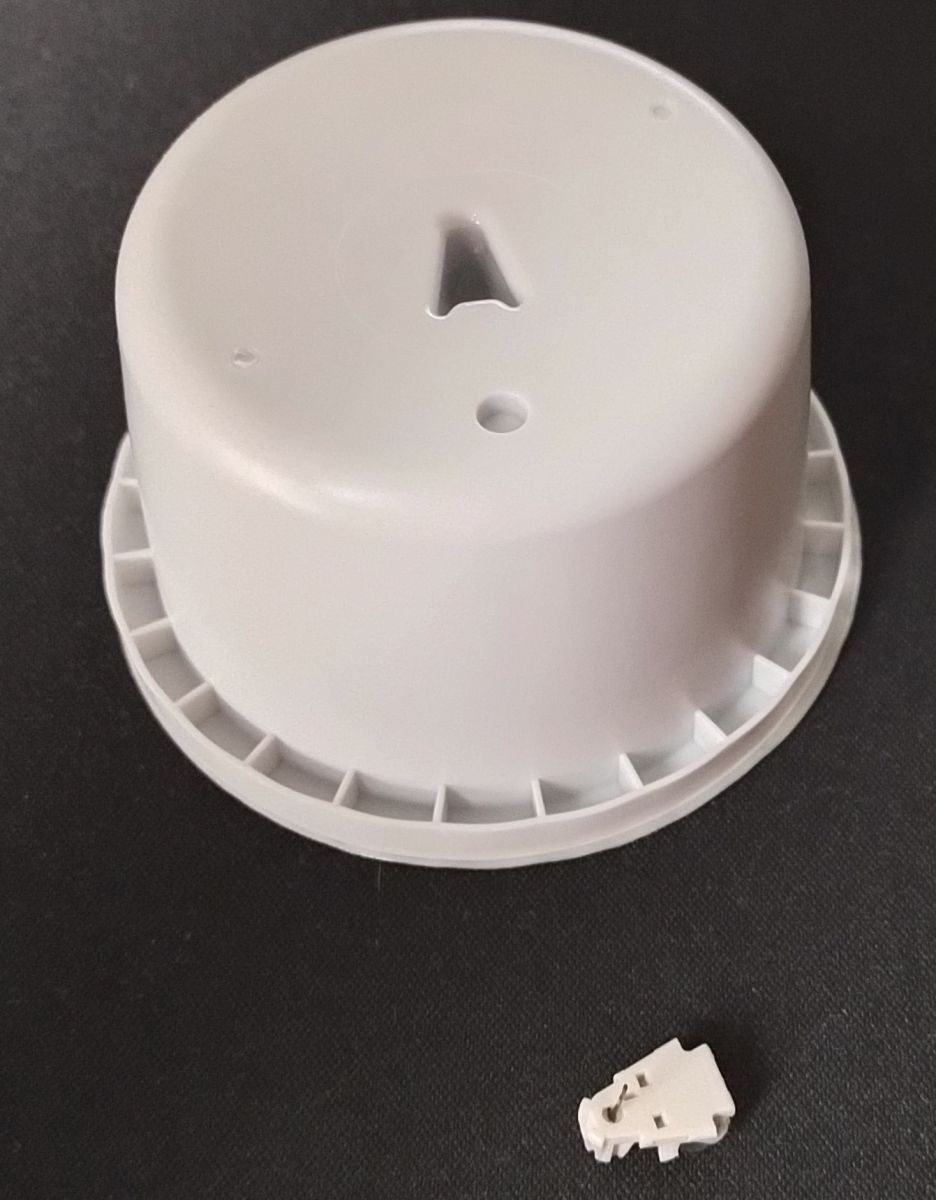

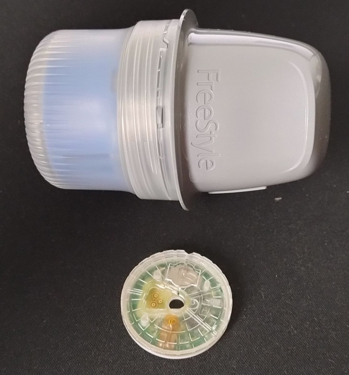

    The kit itself for 'mounting' the sensor in the body is also interesting. The kit consists of two parts: one is the electronics with the applicator, which does not appear to be sterile, and the other is the electrode with the needle that inserts it into the body.
    This is what the electronic part and its applicator look like:
    Freestyle Libre applicator and electrode transport packaging. .
    This is what the electrode and its transport packaging looks like.
    Plastic lid and small white component on a black background. .
    And this is what the rubbish looks like after the sensor has been installed.
    Plastic components of a medical device, including an applicator.
    I leave it to the reader's own judgement as to whether this could somehow be handled better. Leading perhaps, however, to the answer I would like to get: Abbott in the West launched a third version of the device some 2/3 years ago (a fourth version has already been announced for 2022) and boasts, among other things:

  • Questioning whether the sensor MCU firmware can be changed

    Galareta
    Posts: 696
    Help: 14
    Rate: 182
    As to the causes of the onset of diabetes - I will not comment. I do not have sufficient knowledge.
    As for the construction of electronics, costs and recycling:
    Why do we have this and not another MSP here? Because it has RF, it's infernally cheap - before Covid to buy for ~30gr / piece when buying 100k. It has indestructible memory - it's on FRAM. It has a DAC, a pretty tolerable ADC. We can put it to sleep almost completely - including RAM, we write data for 8h in program memory, it can withstand 10^15 writes minimum.
    chip for BT - it's economical and also a hell of a lot cheaper, pre Covid ~25gr / 100k.
    Board about 1-2PLN at 100k
    Plastic case? 2-3PLN. I'm betting the most expensive is the housing for this.
    So the price is only made up by these plastic inventions for applications etc. in general, battery replacement. Some programming, chipping it out of the case etc. will come out more expensive than manufacturing.
    As for damaging the sensor - dropping to a low value and a sudden rise can lock it in programmatically, not physically damage the sensor. Likewise staying in a low glucose state for a long time. Some safety algorithms, it's better to 'break' a device than to let it show stupid things - which can endanger the life of the owner.
    But the latter is just a guess, I don't know the exact working system of this 'needle'.
    I wonder if it is possible to change the programme of such a uC? Does anyone perhaps have some "bulk" pieces? I'd be happy to send a label to the package:) .

    I managed to take the sensor apart, unfortunately I don't have a microscope and can't read the IC, 1.5V battery.
    Image of a printed circuit board with visible traces and mounting holes. Disassembled electronic sensor with visible internal components Disassembled electronic sensor with visible circuit board and 1.5V battery slot. .

    klamot wrote:
    unfortunately I do not have a microscope and cannot read the IC,
    All you need to do is take a sharp photo at a good angle, it would be possible to read.
