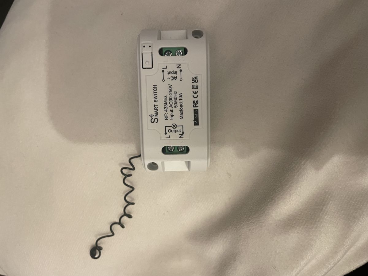

    Hi, we bought a wireless light switch on allegro (but from China)
    How to connect it to the chandelier? We try according to the instructions but it doesn't work. As it is connected it also cuts off our regular light switch. Attached a photo How to connect a Chinese wireless light switch to a chandelier? .

    You don't know what it says because you didn't deign to include it. It is not possible to connect them both to work independently as there is no fixed phase on the chandelier's cube (only through a switch) so the additional one will only work when the regular one is on (but only if the wireless one is connected correctly).

    zaborowskan wrote:
    When it is connected it also cuts off our normal light switch.
    Leave the normal switch on and use the wireless one.

    I turned on the light switch and then plugged in.
