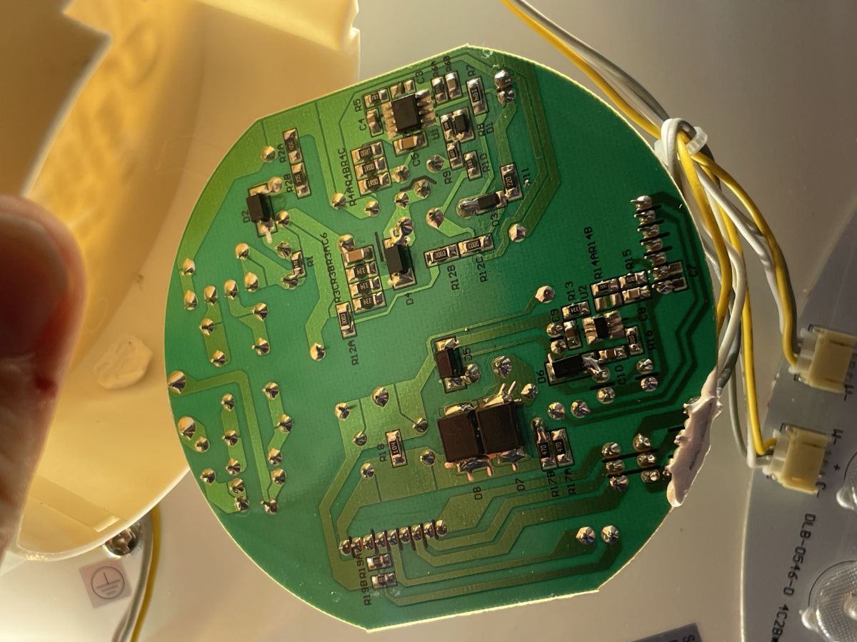

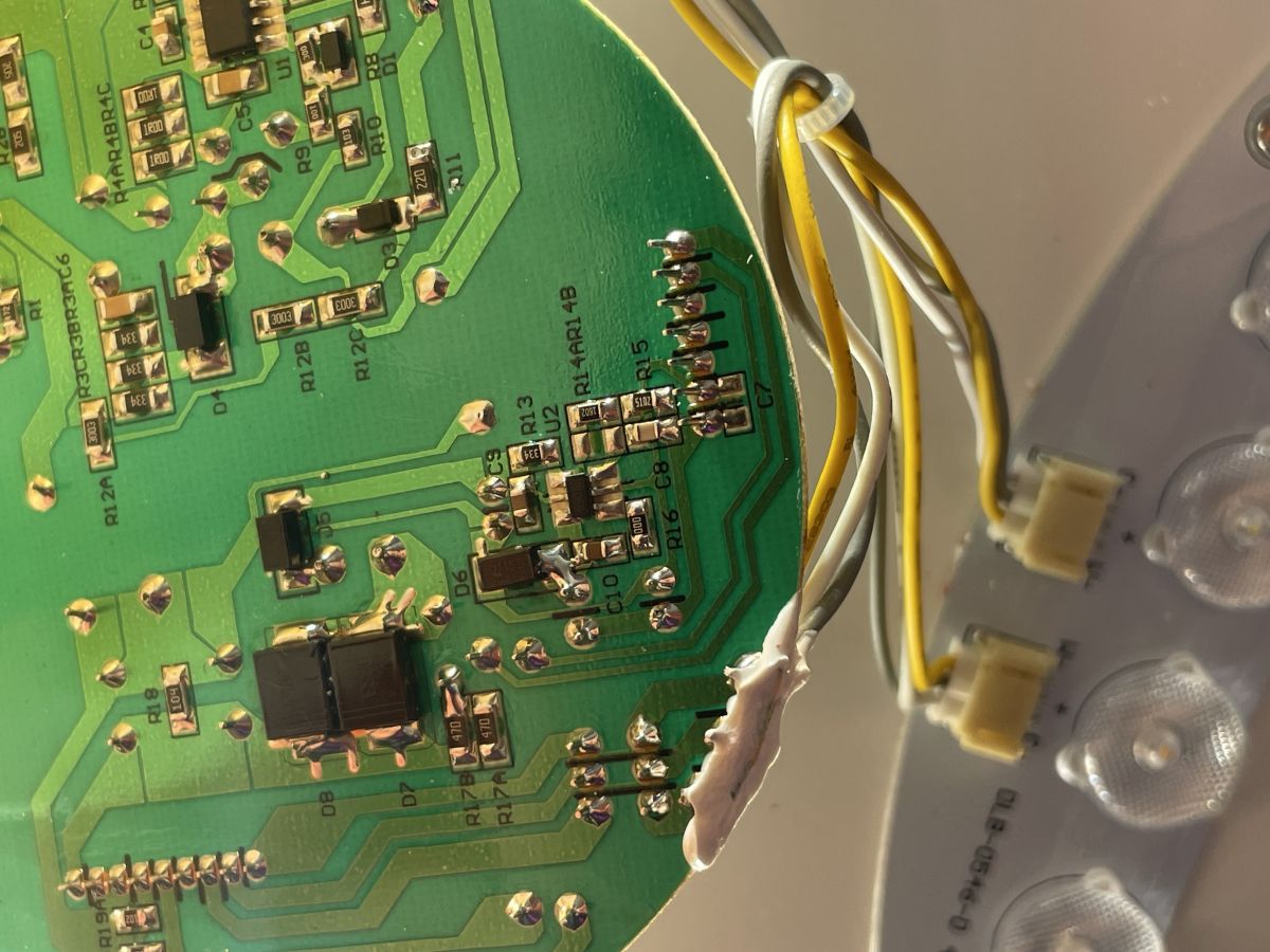

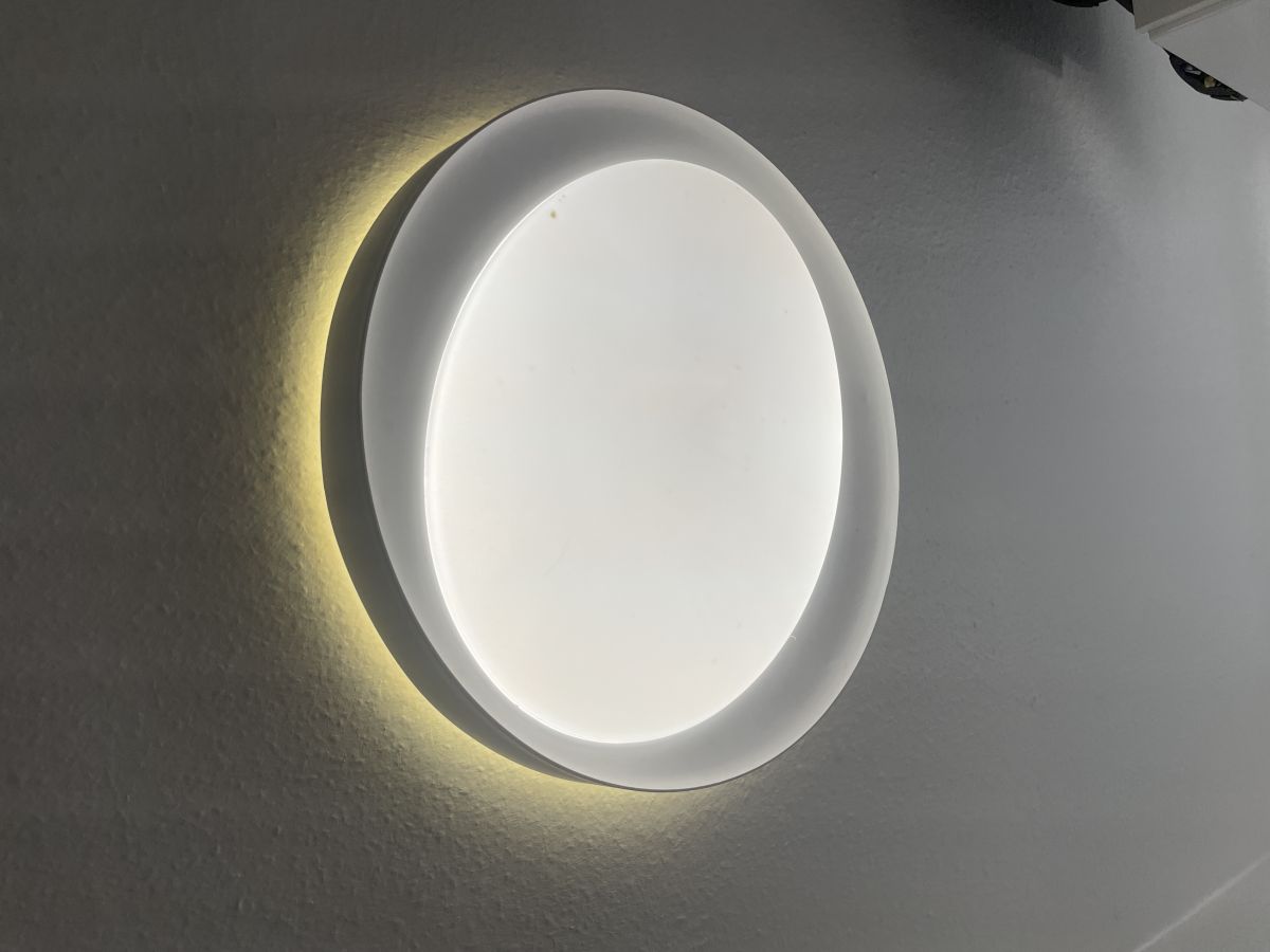

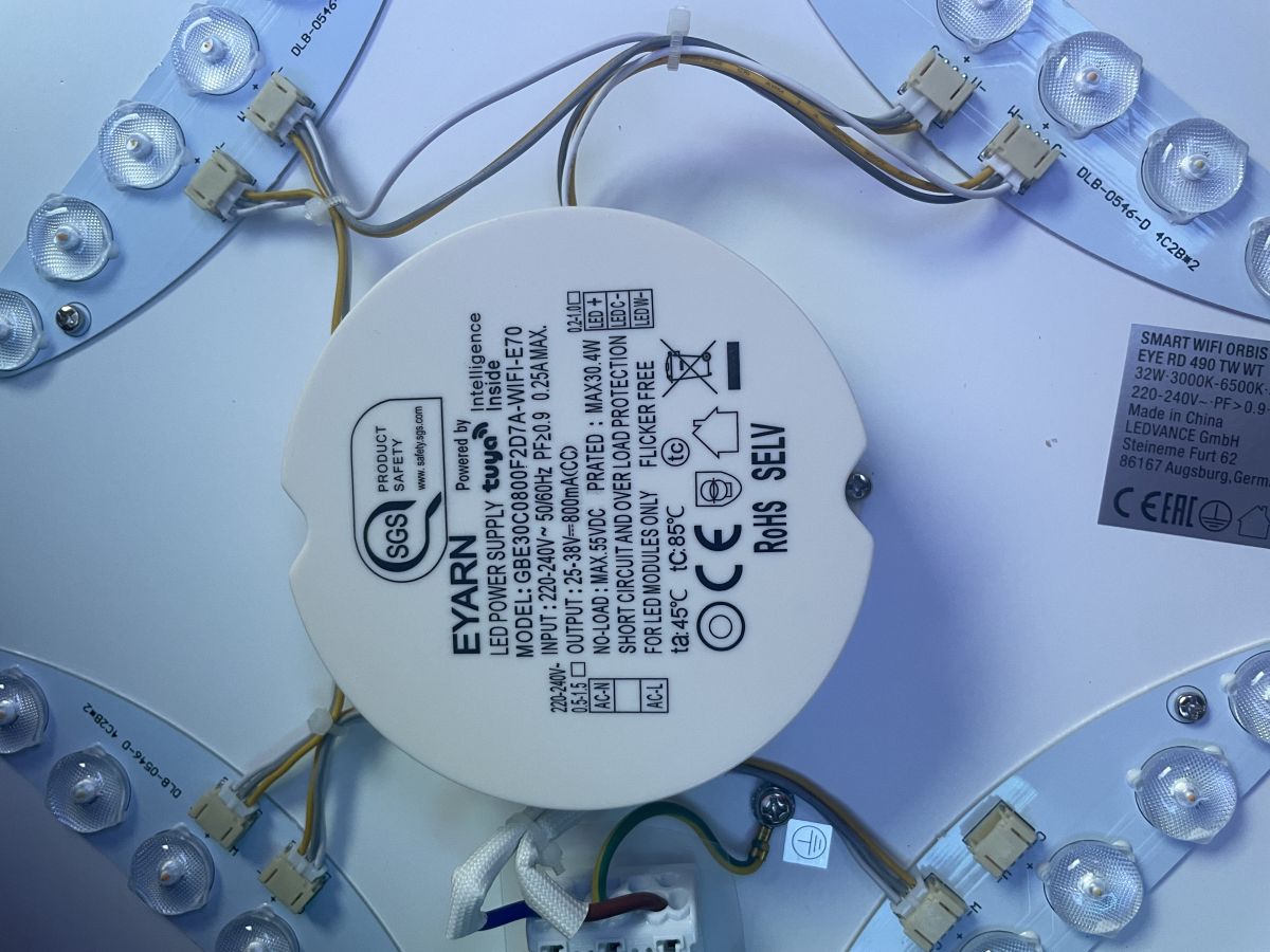

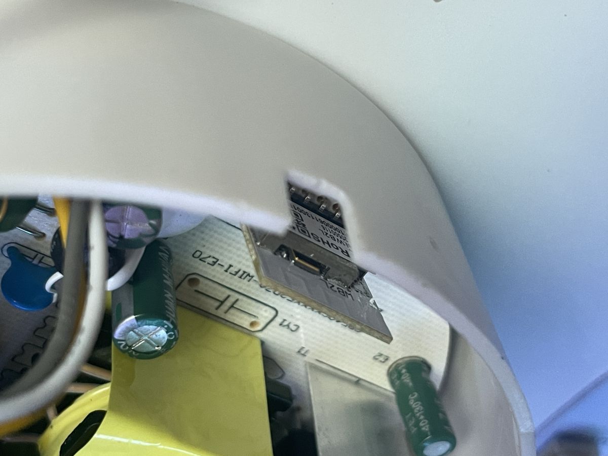

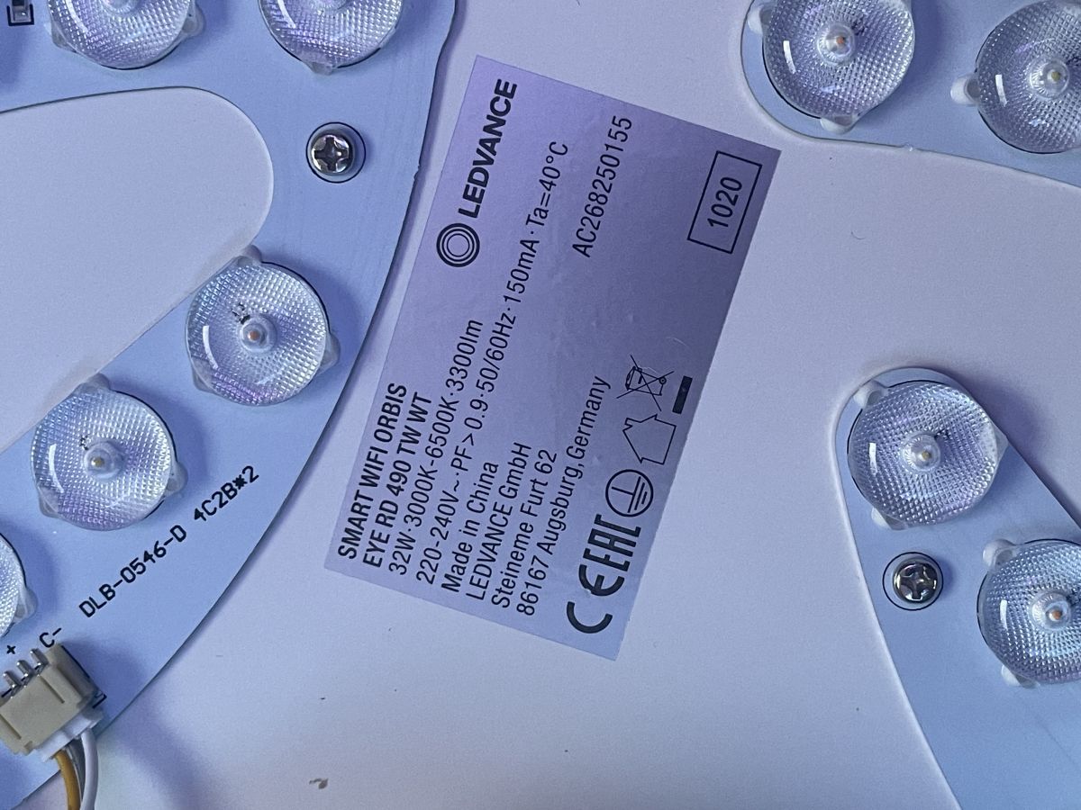

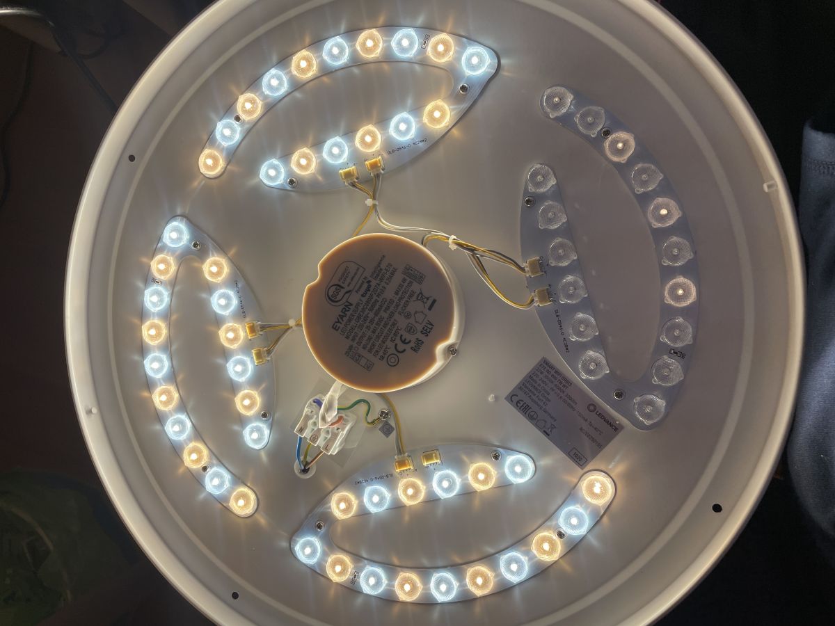

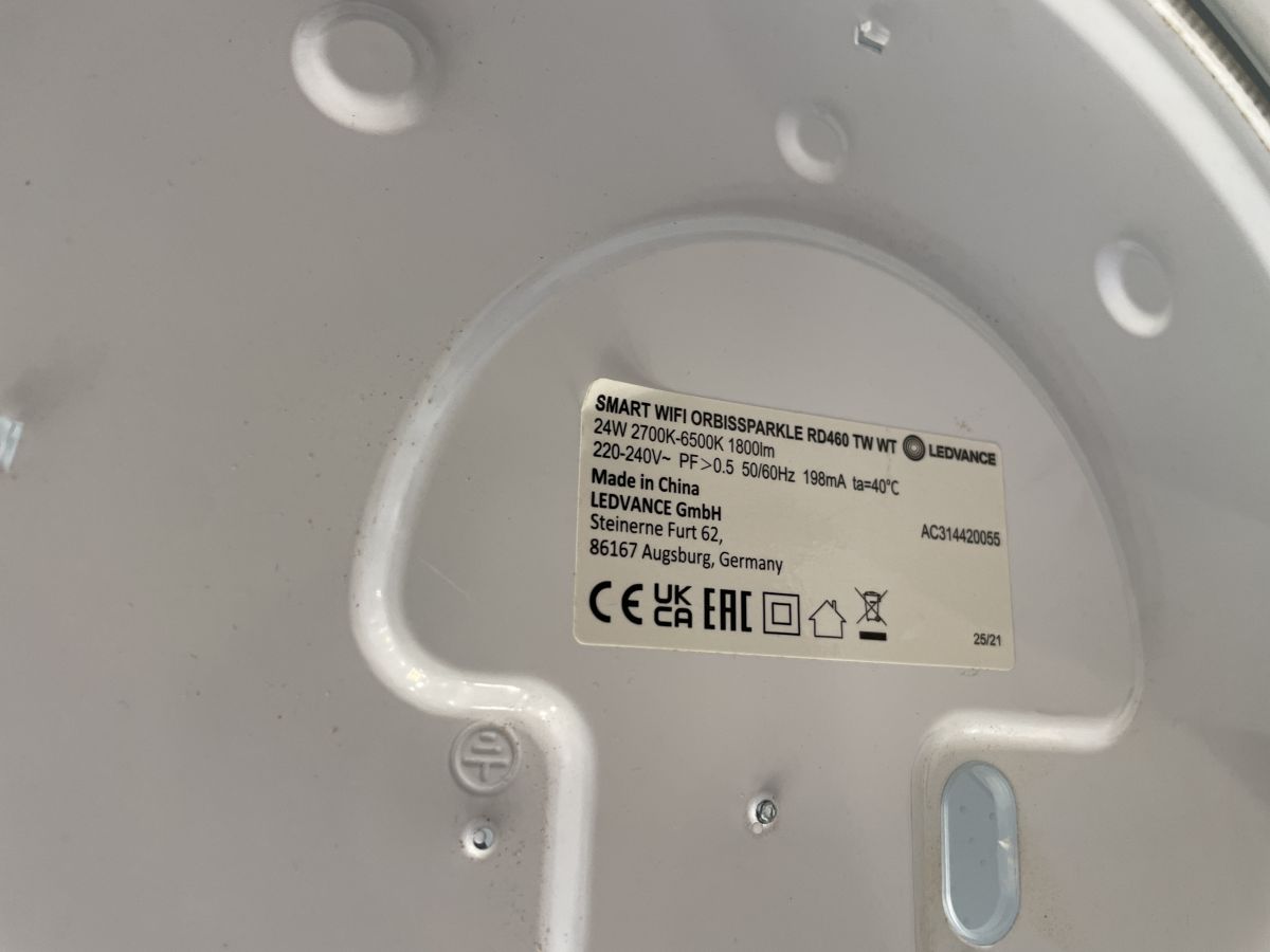

    BK7231T WB2L LEDVANCE Wifi SMART Orbis Eye LED Ceiling Light Tunable White 49cm 32W
    Round LED ceiling light with soft edge lighting on a white wall.Nameplate of Ledvance LED lamp with model and specifications.
    Please dismiss the dark LED bank. This was a fault of my unit and I got a replacement.

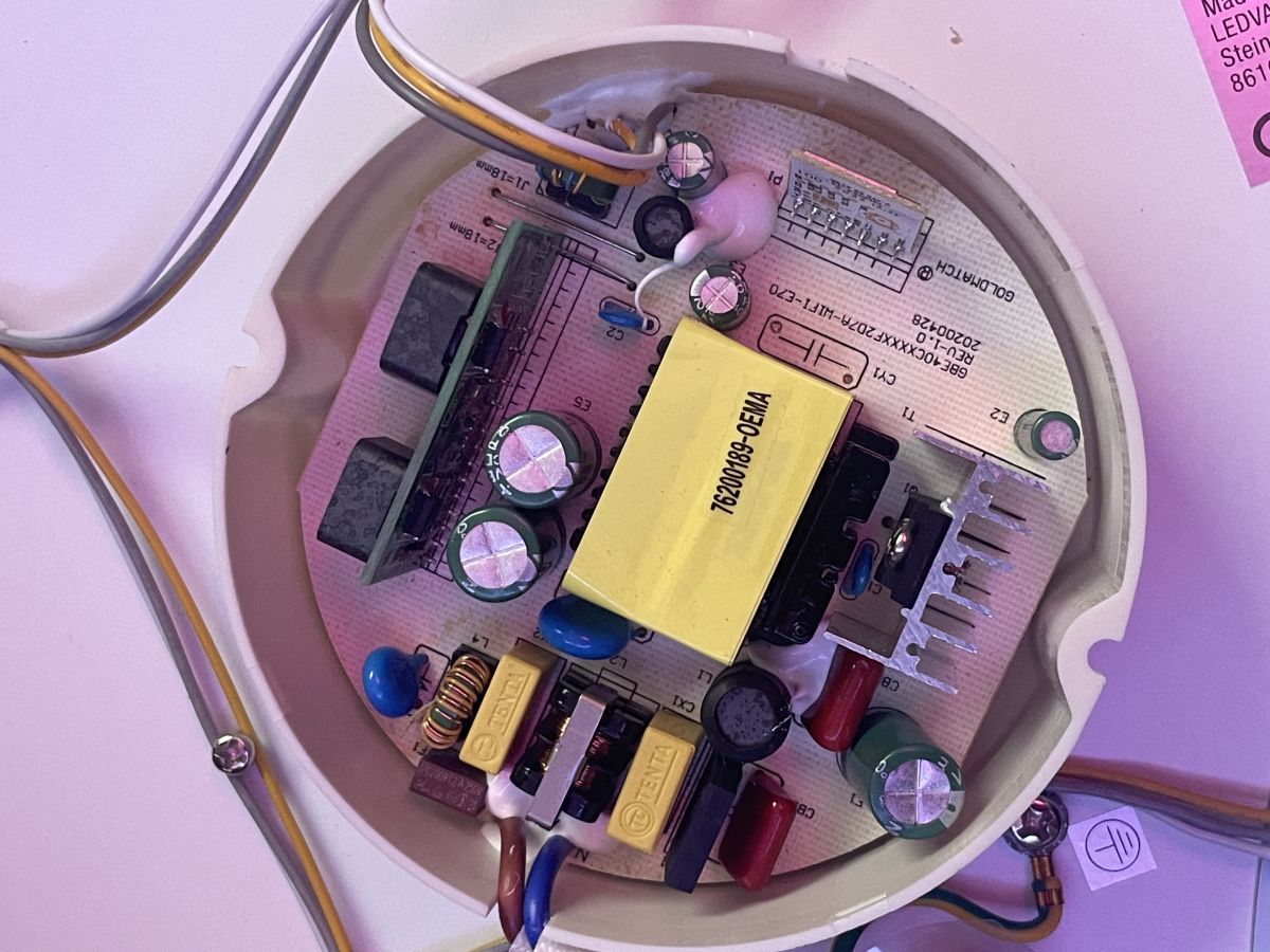

    View of the interior of the LEDVANCE Wifi SMART Orbis Eye ceiling light with LED array. Interior of the LEDVANCE Wifi SMART Orbis Eye ceiling lamp, showing the power module. Internal component of the LEDVANCE Orbis Eye ceiling light with wires and connectors. Nameplate of LEDVANCE SMART Wifi Orbis Eye LED.

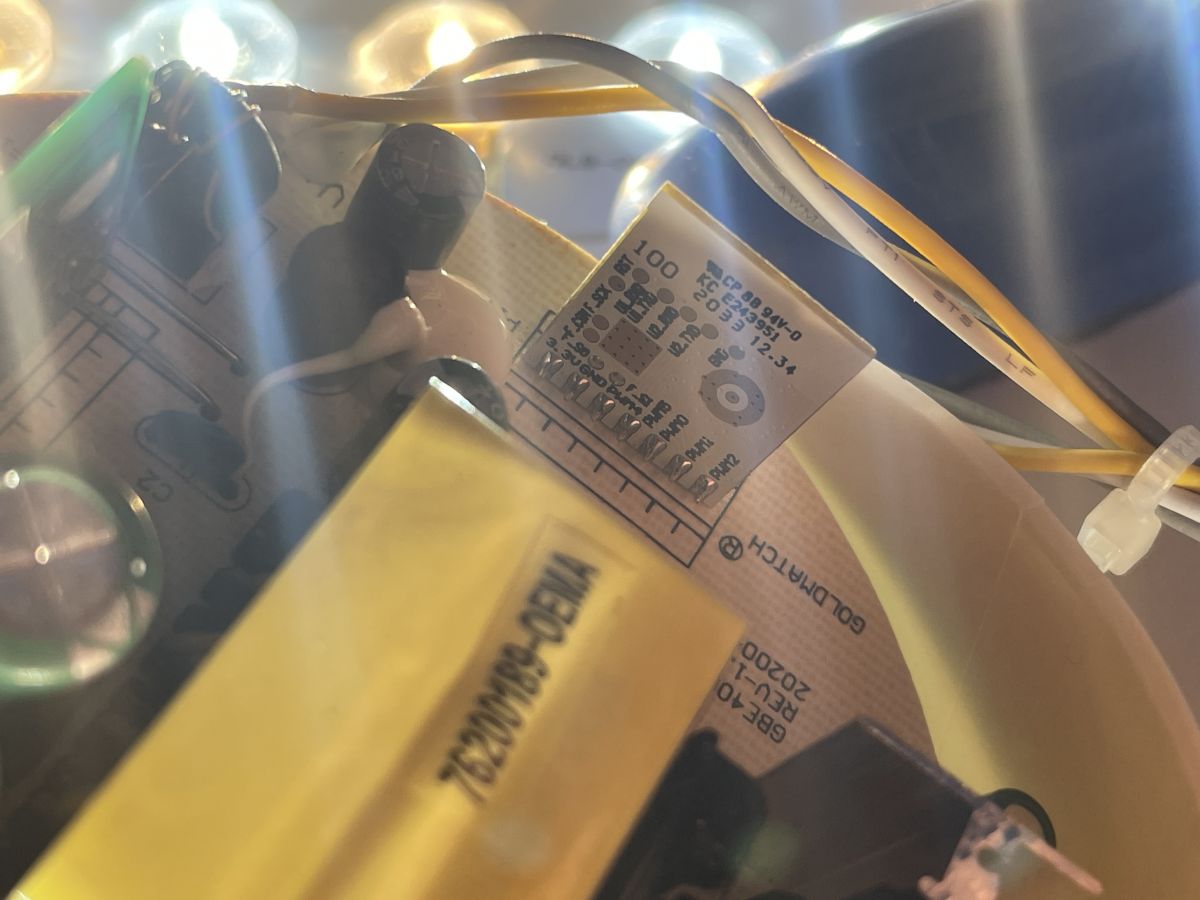

    View of the interior of an LEDVANCE ceiling light with electronic components and wiring. Close-up of internal components of an LED ceiling light. Interior of a LED ceiling light with visible electronic components.Close-up of a circuit board inside the LEDVANCE Wifi SMART Orbis Eye ceiling light. Close-up of the internal electronic circuitry of an LED ceiling light.
      "vendor": "Ledvance",
      "bDetailed": "0",
      "name": "LEDVANCE Wifi SMART Orbis Eye LED Ceiling Light Tunable White 49cm 32W",
      "model": "SMART Wifi Orbis Eye",
      "chip": "BK7231T",
      "board": "TODO",
      "flags": "1073748996",

  • #3 21274801
    Posts: 14637
    Help: 655
    Rate: 12649
    Thanks for sharing. Is this WB2L, I see? This could be easily flashed like we've shown on our tutorial here, just choose T platform instead of N:
