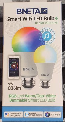

  • This is a short teardown of the BNETA IoT Smart WIFI LED Bulb E27 based on - BK7231N with Tuya module CB2L and LED Driver BP5758D
    Basic information:
    Brand: BNETA
    Chip: BK7231N/CB2L/BP5758D
    Local Vendor: https://www.bneta.co.za/product/smartbulb_e27
    Teardown Photos and Extracted bin file.
    Package:
    BNETA IoT Smart WIFI LED Bulb E27 - RGB+2700-6500K bulbs (BK7231N/CB2L/BP5758D) BNETA IoT Smart WIFI LED Bulb E27 - RGB+2700-6500K bulbs (BK7231N/CB2L/BP5758D) BNETA IoT Smart WIFI LED Bulb E27 - RGB+2700-6500K bulbs (BK7231N/CB2L/BP5758D) BNETA IoT Smart WIFI LED Bulb E27 - RGB+2700-6500K bulbs (BK7231N/CB2L/BP5758D) BNETA IoT Smart WIFI LED Bulb E27 - RGB+2700-6500K bulbs (BK7231N/CB2L/BP5758D) BNETA IoT Smart WIFI LED Bulb E27 - RGB+2700-6500K bulbs (BK7231N/CB2L/BP5758D)
