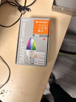

    Here are templates for bp1658cj-based bulb, bp1658cj is I2C RGBCW LED controller.
    LEDVANCE smart bulb packaging on a desk.
    Here you can find pins for flashing with UART ---> https://developer.tuya.com/en/docs/iot/wblc9-module-datasheet?id=K9hgglry2jp5h
    Diagram of boards with pin labels for flashing.
    Here is UART flasher: https://github.com/openshwprojects/BK7231GUIFlashTool
    But you can flash via Wi-Fi because there is a profile, so no soldering is required.

    Attach 2 MB dump extracted after I flashed with OpenBeken
    Thanks
    Added after 8 [hours] 57 [minutes]:
    You can flash with tuya cloudcutter
