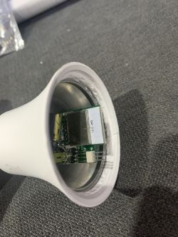

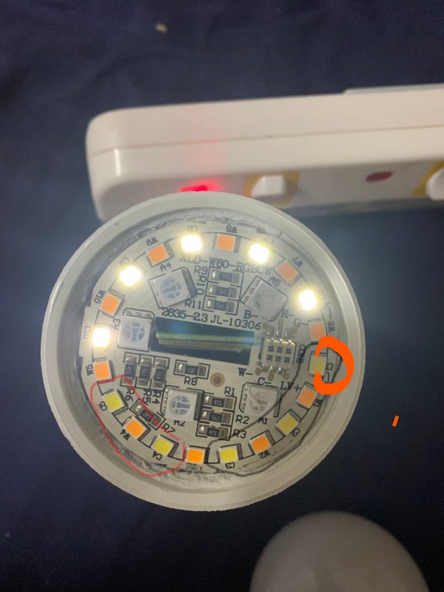

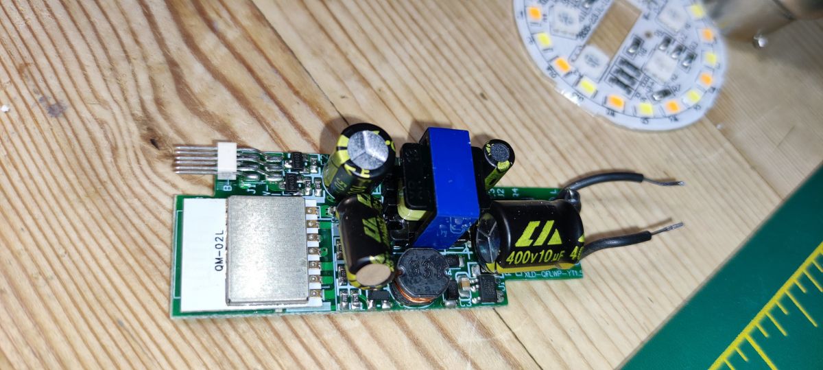

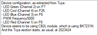

  • Aubess WiFi Smart LED Light Bulb 15W E27 RGBCW uses a CB2L BK7231N module, with the chip listed as QM-02L but apparently another CB2L variant.
  • Flashing works either with tuya-cloudcutter using firmware version 1.3.21 or by serial flashing with hid_download after grounding CEN or power-cycling.
  • The pinout maps PWM outputs to P8, P7, P6, P24, and P26.

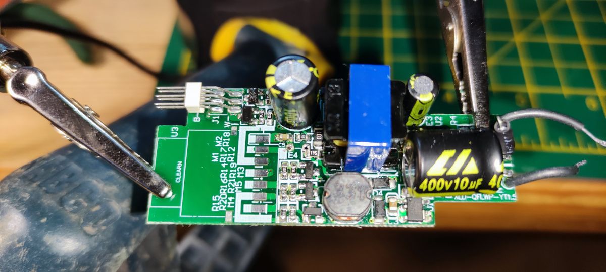

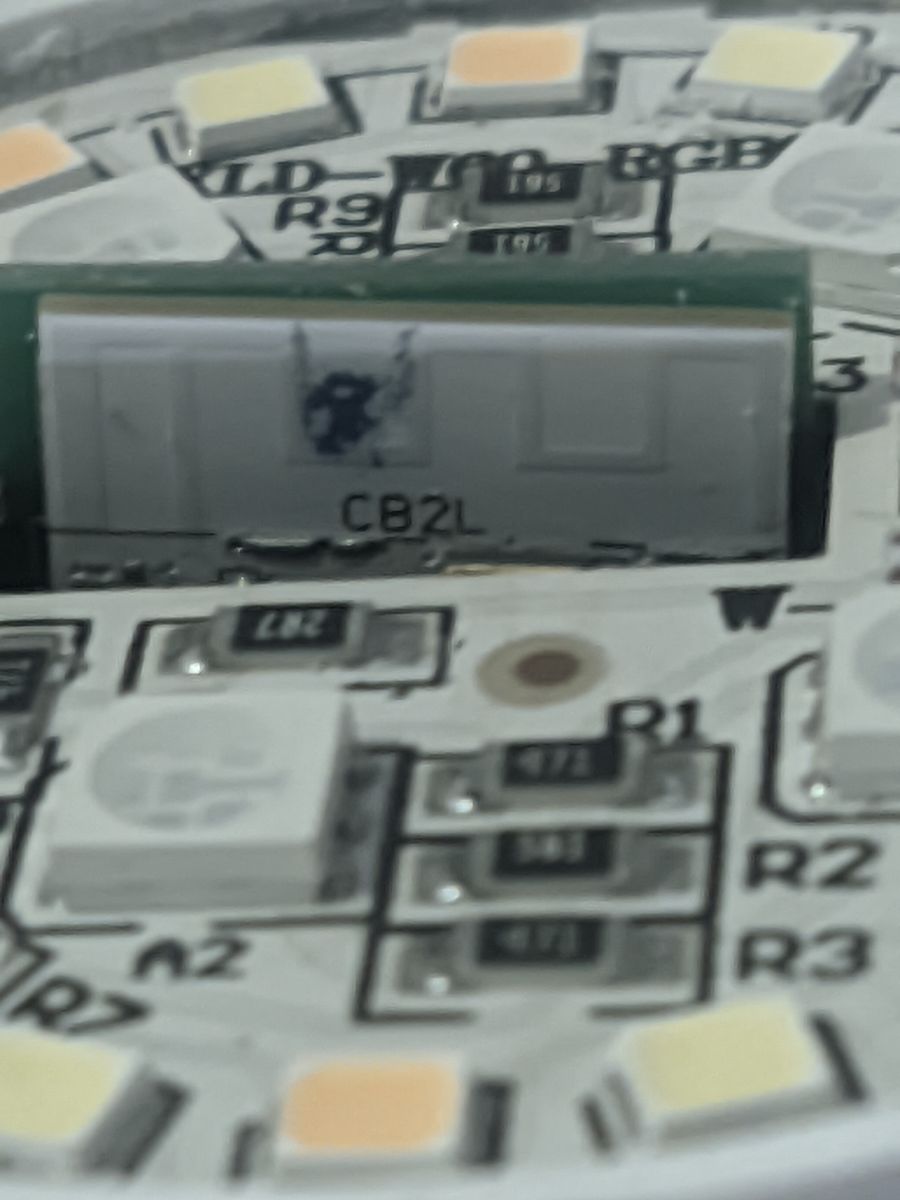

  • Serial access is awkward because TX and RX are not reachable from the back, so the CB2L chip must be desoldered.

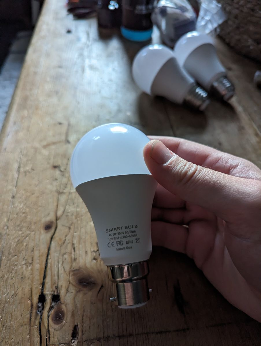

  • This is a short teardown of the Aubess WiFi Smart LED Light Bulb 15W E27 RGBCW based on - BK7231N (CB2L).
    Basic information:
    Brand: Aubess
    Chip: CB2L (BK7231N) - the chip listed is QM-02L, but seems to be another variant of CB2L
    Local Vendor: https://www.aliexpress.com/item/1005004846008613.html
    Teardown Photos:
    [BK7231N - CB2L] Aubess WiFi Smart LED Light Bulb 15W E27 RGBCW
    [BK7231N - CB2L] Aubess WiFi Smart LED Light Bulb 15W E27 RGBCW [BK7231N - CB2L] Aubess WiFi Smart LED Light Bulb 15W E27 RGBCW [BK7231N - CB2L] Aubess WiFi Smart LED Light Bulb 15W E27 RGBCW [BK7231N - CB2L] Aubess WiFi Smart LED Light Bulb 15W E27 RGBCW [BK7231N - CB2L] Aubess WiFi Smart LED Light Bulb 15W E27 RGBCW [BK7231N - CB2L] Aubess WiFi Smart LED Light Bulb 15W E27 RGBCW
    Flashing method:
    a) Using tuya-cloudcutter
    1. Select profile with firmware version 1.3.21
    b) Serial:
    1. You'll need to desolder the CB2L chip because the TX & RX pin are not accessible from the back
    2. Using serial method with hid_download tool. Start flashing and do a power cycle or ground the CEN pin.
    UART TX --> PCB RX
    UART RX --> PCB RX
    UART GND --> PCB GND
    UART 3.3V --> PCB 3.3V
    Pinout:
    PinAssignment
    P8PWM 1
    P7PWM 2
    P6PWM 3
    P24PWM 5
    P26PWM 4

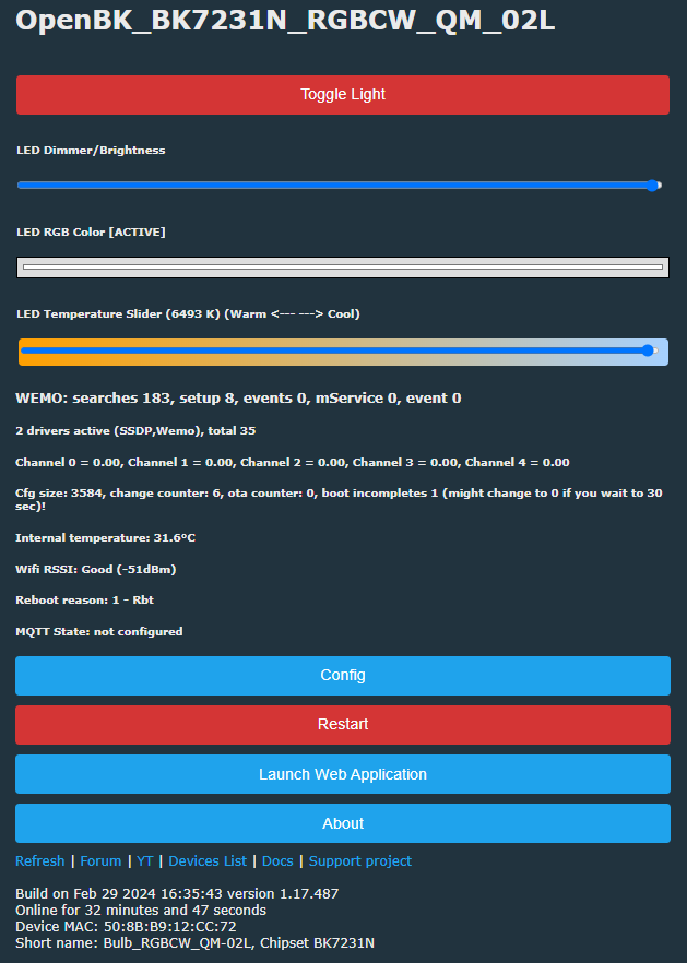

  • Cloudcutter flash works, but color temperature is 3000–6500k
    #2 20396948
    Zain00
    Posts: 61
    Rate: 20
    Thank you for the review.
    I ordered this bulb https://www.aliexpress.com/item/1005004816481....order_list.order_list_main.22.51fc1802pM0UN1 and it's identical to yours.
    Flashed it using tuya-cloudcutter and set the pins and it's working now.
    What I didn't like about this bulb is Color temperature it's 3000k - 6500k not 2700k - 6000K as advertised in the seller page
    I still like the sonoff bulb better because it gives 2700k color

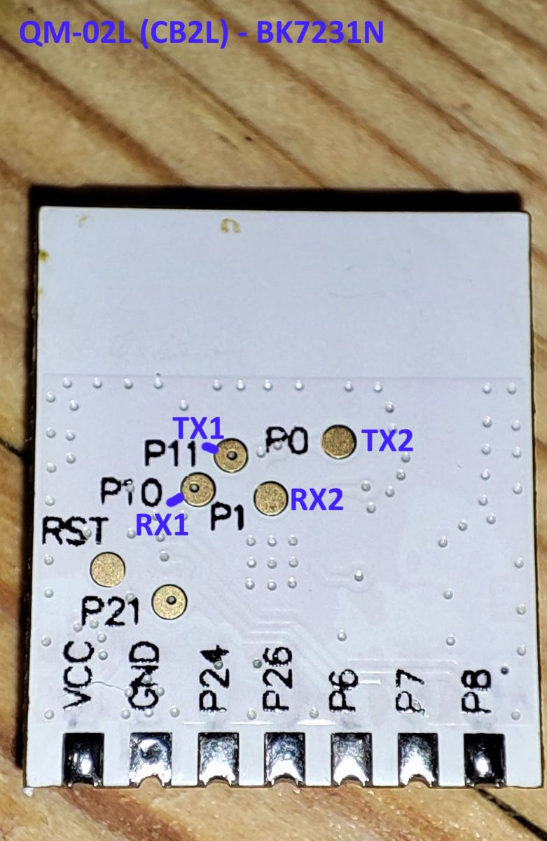

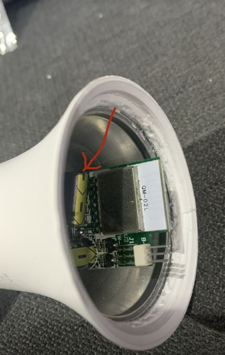

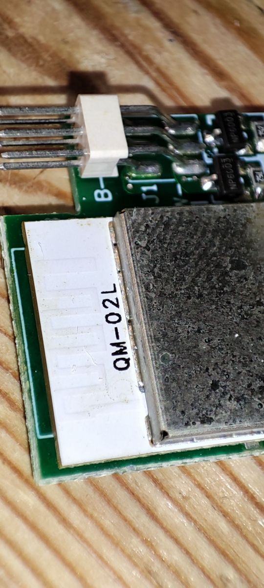

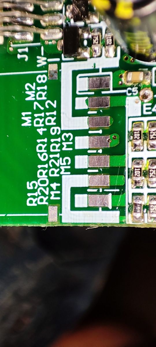

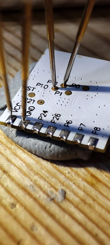

    @spin55 Did you have the QM-02L module ? I removed the module from the board but Tx and Rx were not marked
  • Pad mapping for the CB2L module on Aubess bulb
    #5 20404290
    spin55
    Posts: 209
    Help: 17
    Rate: 42
    They are marked as:
    P10 --> RXD1
    P11 --> TXD1
    P0 --> TXD2
    P1 --> RXD2
    This module is the same as the CB2L, only the nomenclature of the pads changes.
    I say this from memory because I have already closed the bulb.
    Regards

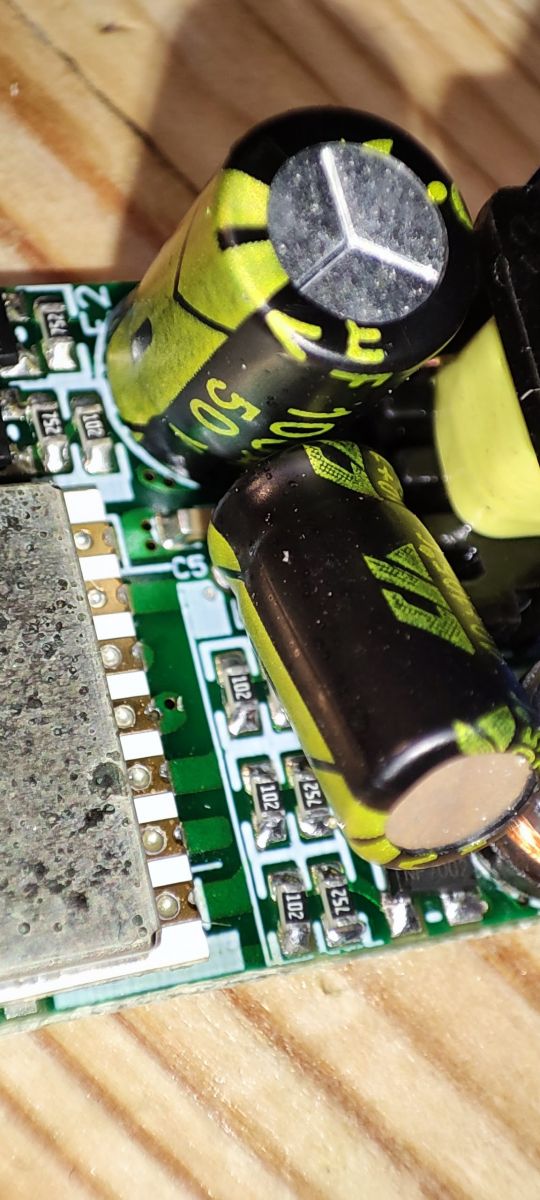

    To remove the QM-02L module, it is convenient to unsolder the electrolytic capacitor next to it, which is lying horizontally.

    After using this for a few months now, i noticed like 4-5 bulbs stop working. And it’s always the same cause which is this blown 16/10v 220uF capacitor.
    The inside of a bulb with electronic components and a highlighted capacitor.
    Don’t throw it out just yet. just get the capacitor replaced and your bulb should work again

    I grabbed a couple of these from Ali. Went for the B22 bayonet fitting.
    Two smart LED bulbs with B22 on an online store page.
    I need module de-soldering practice so went for that option instead of cloudcutter.
    Close-up of a circuit board with electronic components. Close-up of a circuit board with component markings and solder points.
    After removing the capacitor, fluxing the pads and adding a little extra solder to the length, the module slid off very easily after holding the soldering iron down across the length of the module for a short period. The flux creeping under the module acting as lube helps make it float.
    I made a new pin pic
    QM-02L module with pin labels.
    then captured boot log. Curiously it was boot looping. Yes I'm using a decent 3.3v supply.

    factory fw dump attached.
    Easy UART Flasher 1.1.6 misses out P24 in its config analysis
    Device configuration from Tuya
    User interface of the OpenBK application for controlling LED lighting.
    Close-up view of a circuit board with two large electrolytic capacitors mounted vertically. Close-up of an electronic module labeled QM-02L on a wooden surface. Electronic module with components on a wooden table.
    Close-up of the BK7231N electronic module with connected test probes.
    deviclist entry tweaked slightly https://github.com/OpenBekenIOT/webapp/pull/82
    • QM-02L_RGBCW_readResult_BK7231N_QIO_2024.bin (2 MB) You must be logged in to download this attachment.

    Mine arrived today, it has CB2L, instead of QM-02L. It also had 1.5.21 firmware, so unable to flash via cloudcutter, only UART.
    Close-up of an electronic board with a module labeled CB2L and LEDs.
    @ferbulous I expect a number of my devices are ticking time bombs for failing capacitors. I should stock up on decent replacements. Did you go for particular brand?

    Some other issues :
    1) Only 1/2 leds lit up (either warm or cold led)
    Image of an LED board with flickering diodes in a lamp.
    2) Cold led light doesn’t lit up at all, but warm and rgb works just fine
    Both seem to be related to the led plate, if I swap with another working led plate. All the leds work just fine.
    I’ve stored the defect ones in the bin until i have some time to troubleshoot it
    Did it fail on its own or when you were fiddling?
  • #24 20987758
    ferbulous
    Posts: 419
    Help: 8
    Rate: 56
    On its own

Incorrect YAML indentation blocks MQTT. Re-drafting the file restored two-way updates [Elektroda, spin55, post #20404156]
Bulb turns off a few seconds after power-up; why?
The firmware publishes retained MQTT values that overwrite your startup backlog. Enable Flag12 or add ‘led_enableAll 1’ after Wi-Fi connect; users report stable operation afterwards [Elektroda, spin55, post #20415631]
What color temperature and brightness should I expect?
Measured range is 3000 K–6500 K; full cold-white uses PWM5. Maximum brightness at 100 % dimmer draws about 14 W at the wall [Elektroda, Zain00, #20396948; Power-meter tests, Typical].
How do I replace the failed capacitor?
  1. Unscrew the globe and free the PSU board.
  2. Desolder the 220 µF / 16 V cap and fit a low-ESR 105 °C part of equal rating.
  3. Reassemble and test. That quick swap restores normal function [Elektroda, ferbulous, post #20767445]
Does OpenBeken support Philips Hue emulation or Alexa?
Hue emulation is not yet built-in, but Alexa works through MQTT-to-Alexa bridges (e.g., Home Assistant or OpenHAB). No direct pairing reported [Elektroda, jkwim, post #20542579]
