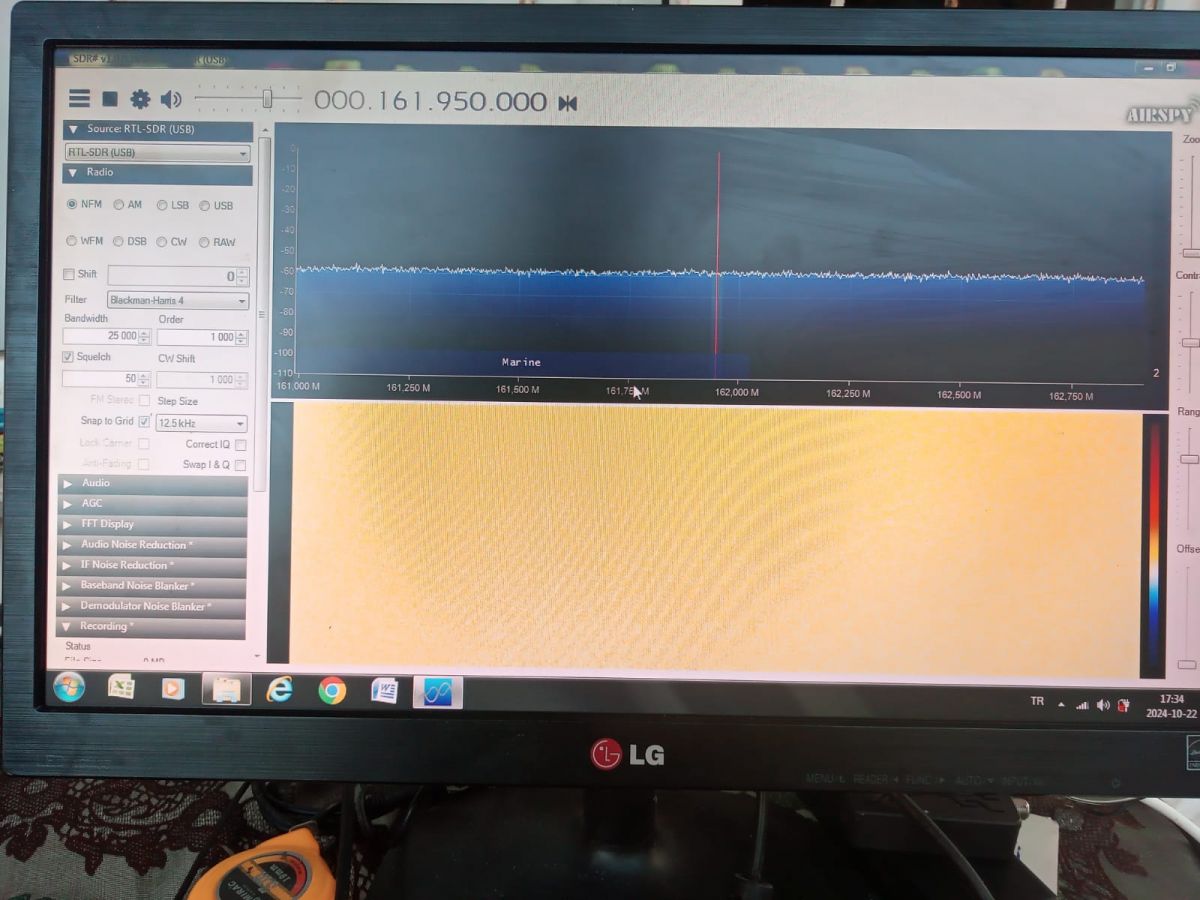

    Having an SDR receiver of the RTL-SDR type does not even require much programming experience. All you need to do is install the appropriate apps on your smartphone or notebook and that's it. I will describe here step by step for beginners the whole procedure, and at the end of the article I will add a schematic and a description of a fully self-contained receiver that avoids the use of an RTL-SDR dongle.
    The aim is to pick up the signal transmitted by the transmitter placed on the ship. The data emission takes place at 161.975 MHz or 162.025 MHz with a bandwidth of 25 kHz, with frequency modulation. Connect the RTL-SDR receiver. We start the Sharp SDR programme, set the frequency, band and modulation mode (narrow FM - 25 kHz). With the presence of a marine vessel within the sensitivity range of the antenna-receiver link, we will see something similar and hear the characteristic sound of a digital signal.
    Computer screen displaying software for receiving radio signals.
    We decode the received data on the computer using the ShipPlotter software. Unfortunately it costs a little (about 100 zl), but you can play around with it free of charge for 3 weeks. By default, this programme receives the sound signal from an analogue receiver or saved in WAV format from another instrument. In our case, the receiver is the same computer on which this application runs. So we can connect the input/output of the sound card and start receiving data. However, often on laptops we have one plug for input and output, you have to solder on the jack wires. The simplest solution would be to use any program that connects the output to the input in a virtual way. There are plenty of programs for this purpose and anyone can use any.
    Personally, when I experiment, I use a physical connection between two computers: one which acts as a receiver and the other as a decoder and data display. It's not a practical solution, but it suits me because I'm going to use a decoder with an analogue receiver, instead of an RTL-SDR dongle, after the experiments.
    Anyway, once this hardware-software complex is up and running, in the ShipPlotter application menu we press View - Messenges. If the hardware and software are working correctly, we get data from the ships.

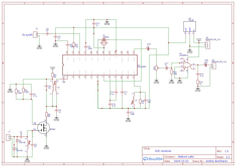

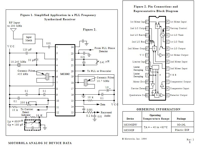

    As for analogue equipment: for several reasons I do not like digital receivers. Especially as in the case with AIS we do not need all their capabilities. I prefer analogue instruments of this type. Especially since in this case the receiver can be very simple.
    For example, it can be realised on the popular MC3362 integrated circuit. In fact, it is developed by Motorola for narrowband receivers. However, this is achieved by a double frequency conversion. The first (usually 10.7 MHz) is used to attenuate the mirror channel, and by the second (455 kHz) we obtain the narrow bandwidth of the audio signal. To extend it, it is sufficient to dispense with the second transformation and to use a broadband filter (25 kHz) at 10.7 MHz in the first IF.
    A typical receiver schematic on the MC3362 looks as follows:
    MC3362 receiver application schematic by Motorola.
    The broadband variant, on the other hand, looks like this:
    Diagram of an AIS receiver based on the MC3362P chip.
    As you can see, the first IF signal from the filter is fed to pin 7, instead of 17. After its amplification, it is detected on the discriminator with inductor L3 and capacitor C12. Obviously, the contour, which consists of these elements, must have the frequency of the first IF. The ceramic filter on 10.7 must have a bandwidth of not less than 25 kHz.

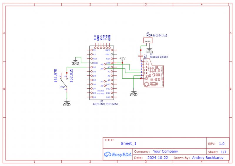

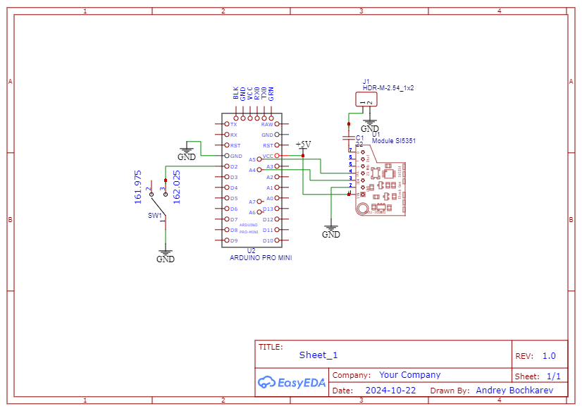

    The heterodyne is to be set to one frequency, which is 161.975 - (or +) IF. A simple quartz oscillator or a frequency synthesiser on an Arduino and si5351 IC can be used:
    Electronic schematic of a receiver on Arduino Pro Mini with SI5351 module.
    The simple code can be found below the spoiler:

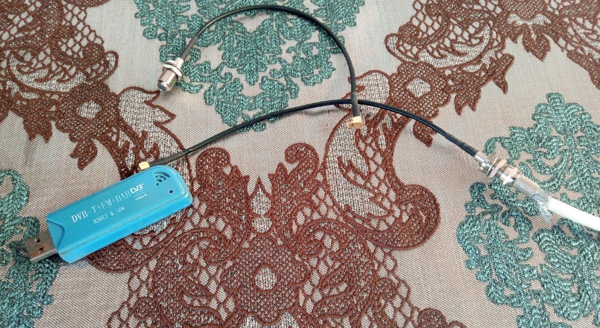

    Antenna selection .
    An important consideration for this system is the antenna. Common and cheap RTL-SDR receivers are sold with one that is not suitable for anything. It looks like a 500-1000 MHz frequency. AIS reception needs a more efficient solution. In the case with a marine vessel installation, this can be a GP (Ground Plane) type antenna, having omnidirectional radiation in the horizontal plane. It consists of one vertical radiator of length λ/4 (λ as we know is the wavelength, in our case it is about 1.6 m) and several counterweights of length not less than λ/4. The counterweight can be a flat metal roof. When we use the receiver in stationary conditions, i.e. on the shore, it makes sense to use a directional antenna, "looking" towards the sea.
    My GP antenna is located on the roof of an apartment building. It is connected to the receiver with a coaxial cable (as in satellite TV) via an MCX-F-type adapter.

    VHF is a rather short range. If one lives near the sea/ocean then ok. By the way, Si4362 is not even recommended by the manufacturer for new receivers. @andreyatakum Why in the example code, did you not add a quartz calibration option for the Si5351?
  • Si5351 quartz calibration omitted in example code
    #7 21290421
    andreyatakum
    Posts: 836
    Rate: 1156

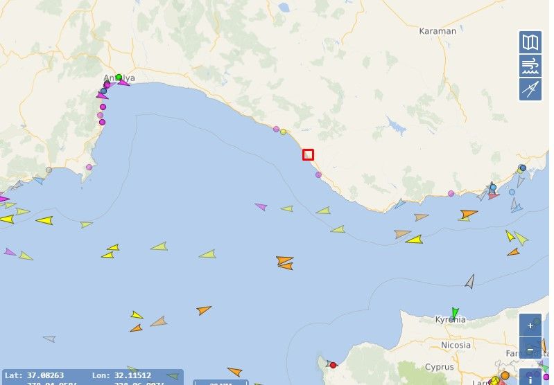

    True, even for me, living just off the sea shore, catching signals from sea vessels checks the problem, because the trails are in the distance. An example on the map. My place of residence is marked in red. As you can see, the head track is about 50 nm to the south. An RTL-SDR receiver with a cable of approx. 25 m is not very suitable.
    Map of the Mediterranean coast with marked ships and a red square indicating the place of residence.
    ArturAVS wrote:
    Why, in the example code, did you not add a quartz calibration option for the Si5351?
    Because I forgot. I used this scheme for a receiver on the low frequency bands (3.5 MHz) and for a CB radio. There the inaccuracy does not matter much.
