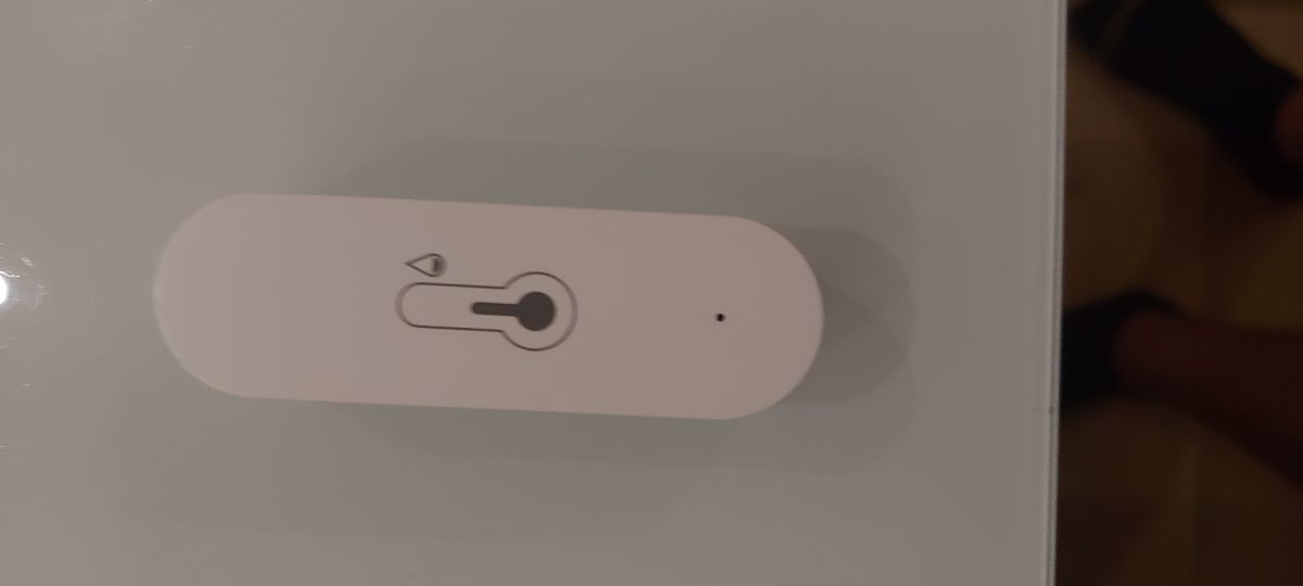

    Hello, I have a problem with this sensor. I can't get it to pair with the Smart Life app and I don't know if I'm making a mistake when trying to add it, or is there something wrong with this sensor? Please can you give me any hints or instructions on what I need to do.
    AI: What is the exact model and brand of the sensor you are trying to pair with the Smart Life app?

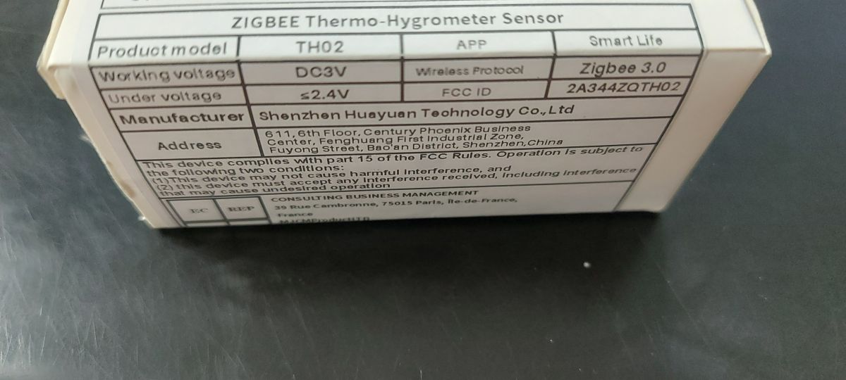

    Zigbee thermo - hydrometer sensor
    AI: Do you get any error messages when trying to pair the sensor? What steps have you already taken?
    In the app I wanted to add a new device, I found the temperature and humidity sensors and tried to add, but without success.

    Is the sensor ZigBee or WiFi? Do you have a ZigBee gateway?
  • #3 21299997
    sergiuszmichalak33
    I do not own a Zigbee gateway,
    How do I pair the sensor with the Smart Life app? Instructions and tips .
  • #4 21300327
    prosiak_wej
    Posts: 5273
    Help: 501
    Rate: 1461
    The ZigBee sensor will not communicate with the application without a gateway.
  • #5 21300675
    sergiuszmichalak33
    And there is no other option? Just to buy a gate?
  • #6 21300754
    prosiak_wej
    Posts: 5273
    Help: 501
    Rate: 1461
    Well, you can't do it any other way. It's like wanting to connect your phone via WiFi to the internet without having a WiFi router at home.

    ZigBee is ZigBee, best to take the latest version possible to avoid problems. I have an RTX gateway with ethernet and it works quite well.

    Not true. Zigbee devices are not compatible with each other. In order not to elaborate I will quote:
    "ecosystems are not compatible with each other, neither are devices relative to each other - unless explicitly written otherwise!".
    The RTX gateway works with Smart Life.
