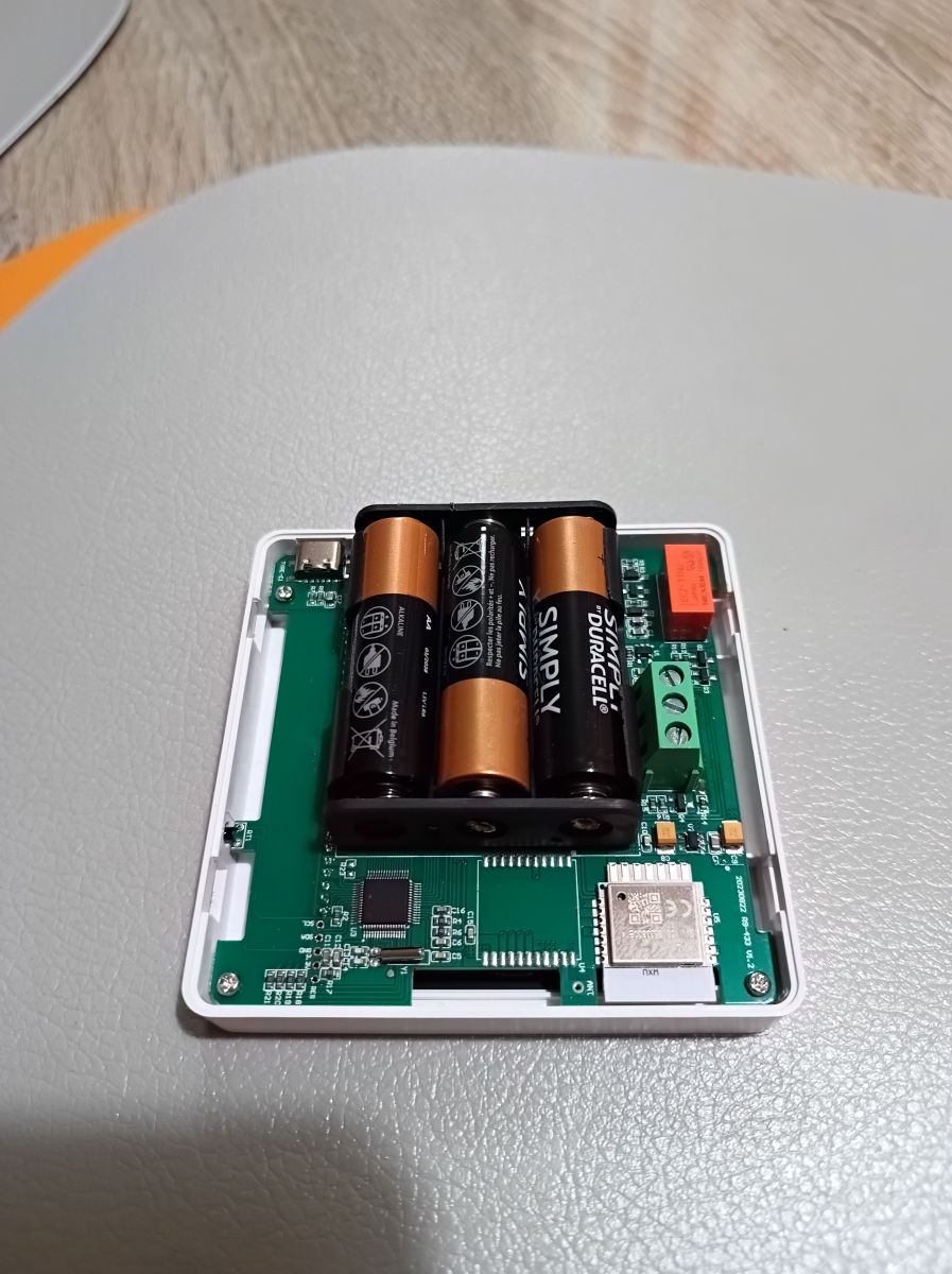

    Warm welcome.
    I am looking for a willing person or very (very) simple instructions on how to modify the software in the avatto zwt 198 thermostat, specifically two parameters:
    Hysteresis 0.5 to 0.1
    The jump of the set temperature from 0.5 to 0.1.
    How to modify the hysteresis and temperature jump on the Avatto ZWT 198 thermostat .
    PCB designation 20230822 R9-433 V1.2

    This module is signed WXU, I see correctly, not CBU?
    Is this a thermostat on WiFi or Zigbee? Hmm the name suggests Zigbee, that's what the network suggests too.
    What gateway are you connecting it to?

    I would guess that, if anything, the hysteresis is sent here from the WXU module to the MCU via the TuyaMCU, just a question if it is represented at all so that you can change it by as much as you want.... you would need to connect the UART and preview the packet.... TuyaMCU Analyzer - UART packet decoder for Tuya devices - dpID detector the worse thing is that the WXU is not flashable at the moment....

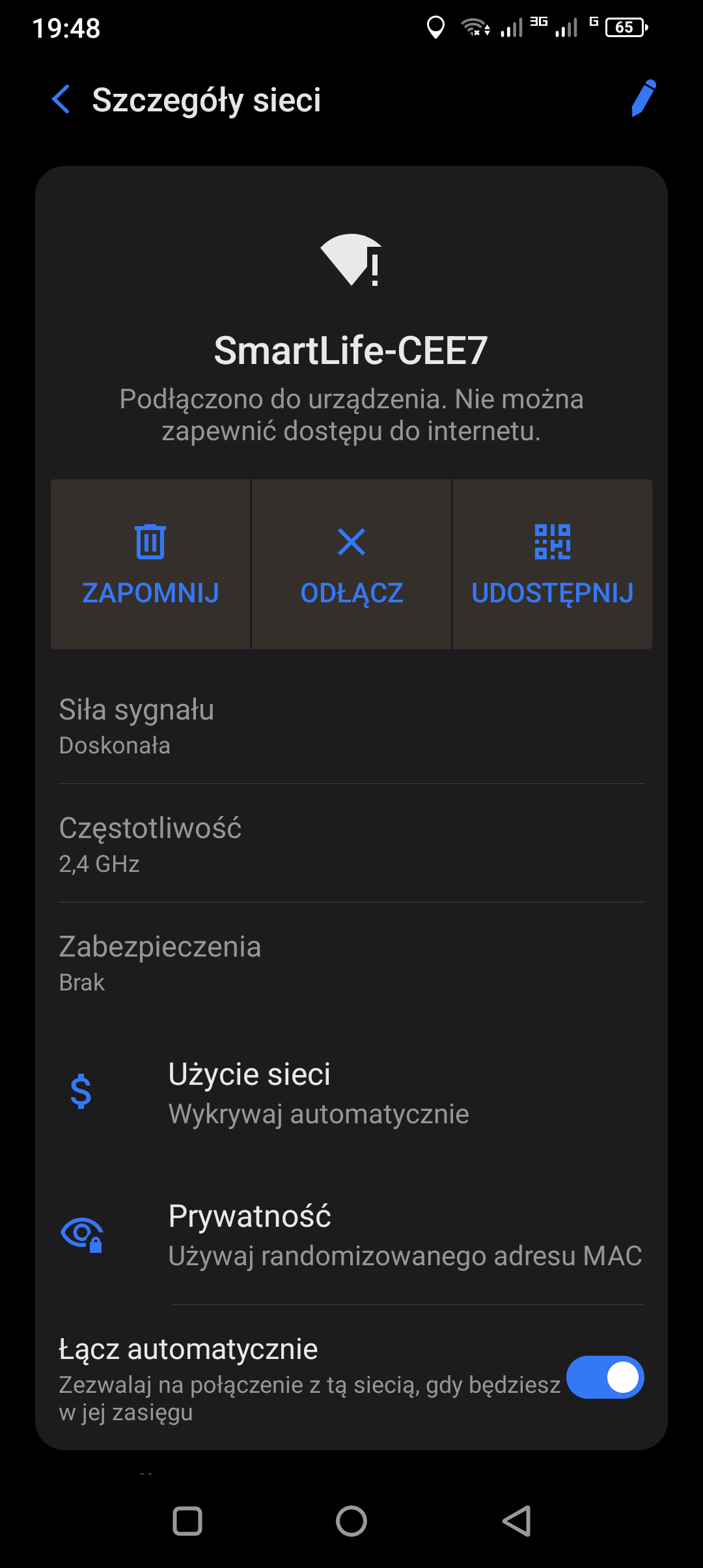

    With BT, I am combining to see if it is detected.
    As for the sensors on the Arduino it's ds18b20 in the case to92.
    Added after 7 [minutes]: .
    As for BT the device after BT is not detected.
    Over wifi it announces itself like this:

    If you plug in between the WiFi module and the WXU then you can do as @sentimental wrote , but it's a lot of fun, I was secretly hoping that either this is a Zigbee version though and that it will post with Zigbee2MQTT, or that this is a BK7231 version and you can program the WiFi module your way. Overall this is the first time I've seen a WXU module and it's not a BK7231 unfortunately....
    Sentymentalny wrote:
    package with changed "deadzone_temperature" value e.g. from 0.5 to 0.1 will this work
    the question is also whether this communication supports chopping into 0.1 at all, there only integer values are sent, and if a variable is to support e.g. a step of 0.1 then Tuya sends e.g. 30 degrees as 300, and e.g. 12.5 degrees as 125. Worse, if Tuya assumes that the step is 0.5, it sometimes then sends the value divided by two - so 10 sends as 20, 10.5 as 21, etc.... you'd have to know how it is internally. Intercept the packet and see.
    Certainly it's unlikely that typical floating point numbers are sent there, float, TuyaMCU doesn't even support that. Only bool, enum, value (integer), bitmap (flags), raw (string of bytes) values are there.
