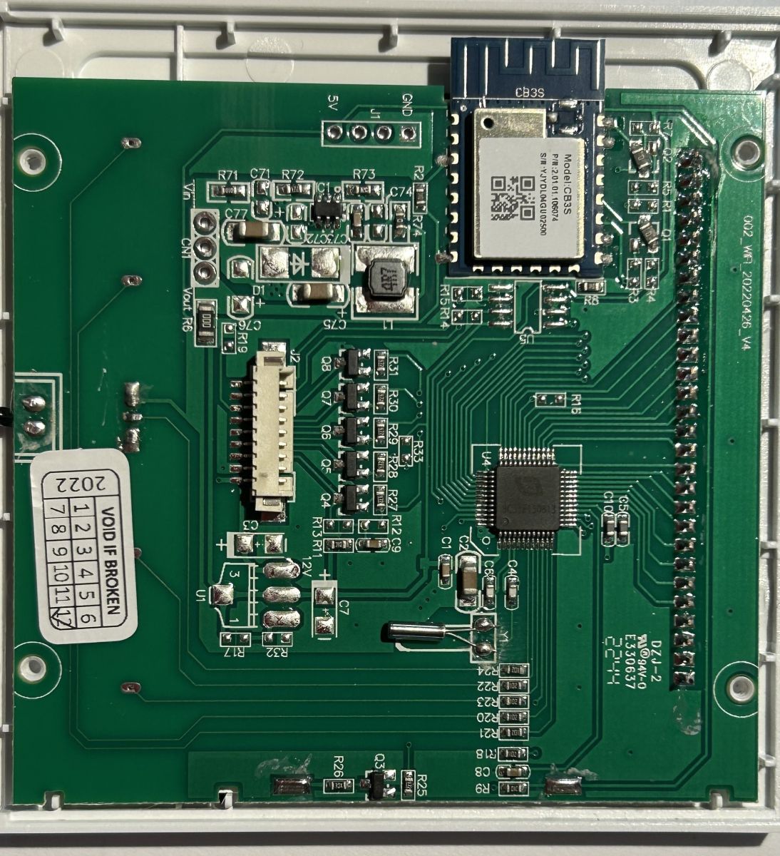

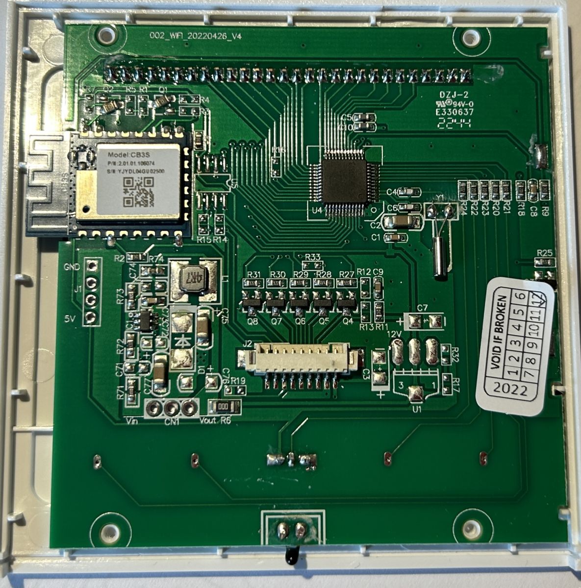

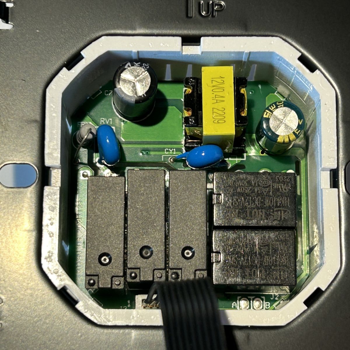

  • Hi all, i would like to flash my thermostat with openbk.
    There are several version of this thermostat.
    The oldest has a WB3S chipset inside.
    The newest has a CB3S chipset.
    I would also like to add a temperature/humidity sensor to the wifi chip soldering it directly on the board and i'd like to know the state of the relay (on or off) with this little mod (Link)
    Control panel of a Beca Smart thermostat with LCD screen and touch buttons. Thermostat circuit board with CB3S chip. Thermostat circuit board with visible CB3S chipset.
    Close-up of CB3S module on a circuit board. View of an open thermostat with visible electronic components on a circuit board. Close-up of the inside of a thermostat with visible relays and other electronic components. Close-up of the internal components of a thermostat with three HUI KE relays mounted on a circuit board. Close-up of the internal electronic circuit of a thermostat with visible components on a green board.
    I've already the thermostat working with local-tuya, an integration for home assistant that doesn't rely on tuya cloud but thermostats aren't disconnected from the cloud.

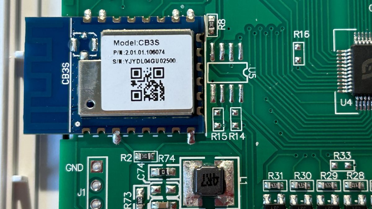

  • Flash backup now failing with flash read error
    #5 20908394
    shakin89
    Posts: 6
    Sorry for late reply, very busy week.

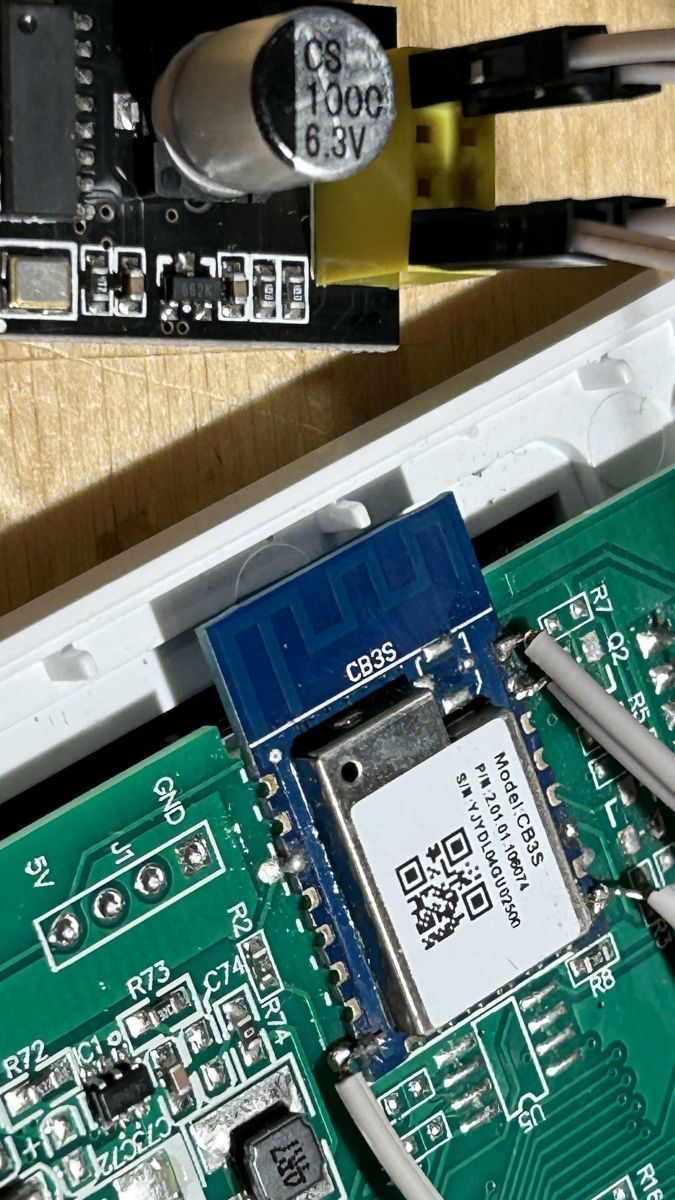

    Yesterday i had some spare time. I've desoldered two resistor which communicate with MCU.
    No luck with pogo pins, so i've soldered four wires to wifi chip.
    At first attempt i've backed up the memory of the original wifi chip and flashed OpenBK7231N_QIO_1.17.406.bin.
    Everything was successful.
    It was late so i didn't go on, and shut down everything.
    This morning i've tried to read obk config, buth with no success.
    I've tried to desolder wires and connect everything up to the mains, but still no wifi hotspot comes up.
    So soldered again wires to 3.3V, GND RX1 and TX1.
    Trying to backup again but everytimes the backup starts, fails at somepoing
    Reading 0x10000... CheckRespond_FlashRead4K: ERROR
    Failed! There was no result to save.
    I've already tried to desolder wires and resolder them a few times, with no luck.
    Any help would be appreciated.
  • #6 20908698
    Posts: 14755
    Rate: 12881
    OBK config will not help for TuyaMCU device. What does the TX2 log output say?
  • #7 20909063
    shakin89
    Posts: 6
    Well, i don't see any output connecting on tx2.
    I'm using putty in serial mode to see if there is an output, am i doing wrong?
    i'm using this as usb-uart adapter. Hope it is good.
    p.s. sorry for my noob question, it's my first time.

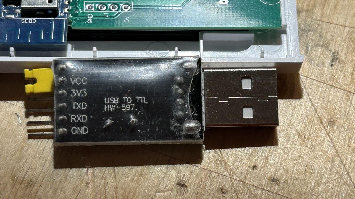

    #9 20909148
    shakin89
    Posts: 6
    Close-up of an electronic module labeled CB3S on a circuit board.
    This is how i am powering the device. Now i'm trying to use a usb-esp01 adapter, to see if it helps. Now the led screen of the thermostat powers up. but still not getting the hotspot or web interface.
    cannot see it pop up in the router asking for an ip.
    this is what i've used til now.
    TX to RX1
    RX to TX1
    3V3 to pin 8
    GND to pin 9
    USB to TTL adapter with pin labels.
    P.S. i am trying even with an external power supply, but with no luck. I've attempted to reflash the firmware but at the end it gave me CRC error.
    is the chip still good? or i've messed it up?
  • Use external 3.3V power for BK7231 flashing
    #10 20909568
    Posts: 14755
    Rate: 12881
    You are using your USB to UART converter incorrectly. You should use jumper to connect 3.3V to VCC on USB to UART converter to select 3.3V voltage levels and power the device externally from a reliable 3.3V source. This USB to UART converter will not provide enough current for flashing. Alternatively, you can get 5V from USB and connect it to the input of AMS1117-3.3V LDO regulator on the device board (if present) to get a stable 3.3V for WiFi module.
    Have you watched any of our BK7231 flashing tutorials on Youtube?

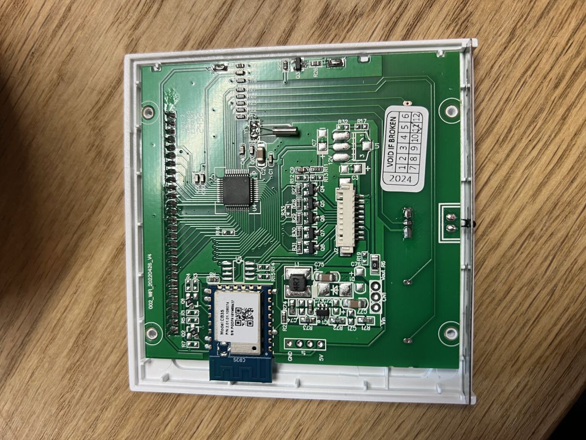

    Hi all, i want to "hi-jack" this post to post my first response on the forum. I just finished flashing 11 of these units with a simple pogo-pin set-up so if anyone needs some easy solution to flash these units let me know.
    The problem I'd like to ask advice on here is if anybody knows how to connect an external sensor. My thermostats are mounted fairly close to the fan-coils and the blowing of hot air affects the sensor (which is directly on the touch panel). It would be much better to have an external sensor somewhere else. I was wondering if I could swap out the sensor in the bottom with another one. Please see the image of the most recent bht-002 pcb here:
    Image of bht-002 circuit board.
    thanks!

    Some Tuya thermostats support connecting external sensor out of the box, is it the case here? Do you have a manual?
    If not, then we will have to try more DIY approach, but there is one problem - sensor is connected to the MCU and not to WiFi module, so we don't have control over the reading process..
    Added after 33 [seconds]:
    Or maybe the MCU has a dpID for calibration? I saw it available once or twice.

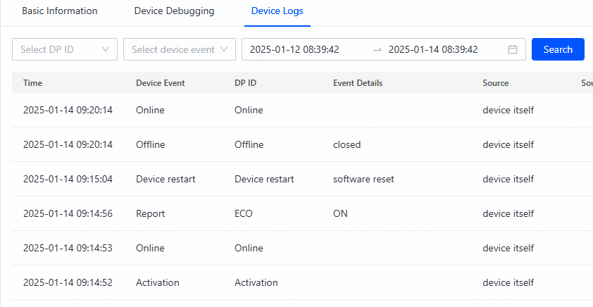

    >>21392025
    Screenshot of a device log showing various events without visible DP ID.
    not seeing dpID for that
  • #22 21392038
    insmod
    Posts: 1432
    Help: 168
    Rate: 455
    Maybe dpId will show if manually calibrated on device itself?
    Such was the case on my WT-100 thermostats.

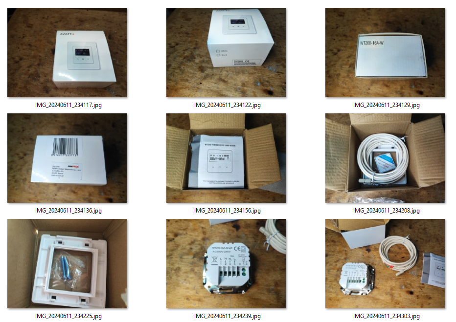

    Well, if there is no calibration available, the best you can do is to use existing sensor with some extra wires and hope that they will not introduce too much interference and resistance... you can give it a go on the table... depends on how far you need to move the sensor.
    Added after 3 [minutes]:
    Here is temperature calibration packet for WT200-16A-W:
    Temp calibration to 0.3:
    Sent by WiFi module:
    55 AA	00	06		00 08	1302000400000003	29
    HEADER	VER=00	SetDP		LEN	dpId=19 Val V=3		CHK
    Temperature sensor calibration kits with packaging and cables.

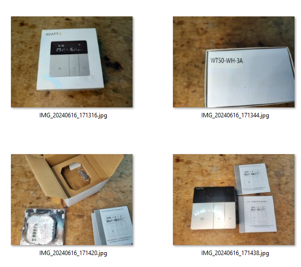

    and for WT50-WH-3A and WT100-WH-3A dpID seems the same.
    Four images showing different temperature calibration devices, including AVATTO models WT200-16A-W and WT50-WH-3A with instructions.

    >>20896307 I see that the thermostats have shown up again, the BHT-002 equivalents with a 3.3V MCU which means that deriving the relay switching signal/information is easier, no need to lower the voltage for the CB3S pin.
    These resistors are just jumpers (0)
