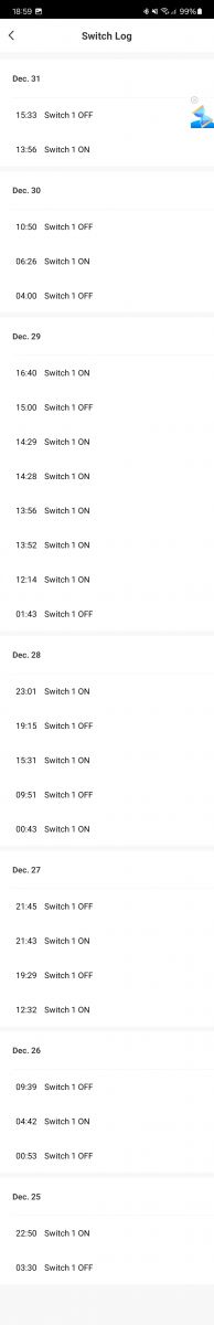

  • Logs show random switching since new units

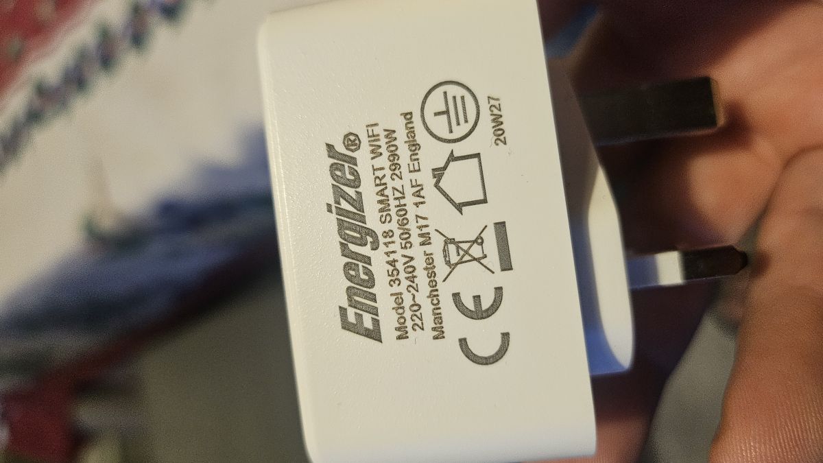

    It was being reset. I moved so they are now in a completely different house.
    They have been doing this since new. Three units bought from one shop and they have the same affliction. I also bought Energizer bulbs and they are fine.
    Close-up of an Energizer plug and adapter showing technical specifications. .

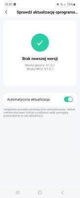

    Added after 1 [minute]:
    Software update screen on a smartphone showing no new version available and automatic updates enabled. .

    Screenshot showing a switch log from a smartphone.
    These are the logs.It was not once my involvement.There is also no visible diagram

    You should do it yourself, but I searched the net for the symbol and it comes out that it is the presence simulator, that is its correct operation. ( other users also complain about this )
    There is no manual for this - and what did you get with the packaging?
    Best regards. J.

    Yes, I searched and found the famous vacation mode, but while you can run such a thing in Zigbee, neither the Energizer app based on Tuya nor the original Tuya have this in the options.
    There was nothing else in the box apart from the pairing instructions.
