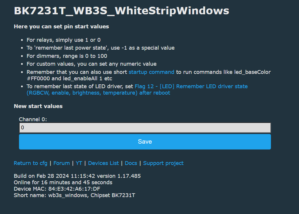

    biznessdronss88
    Posts: 7
    good afternoon. I flashed the CBE (tuya) socket. Everything turned out to be configured, except when power is applied (if you insert the outlet into the outlet), the outlet automatically switches to the on state, how to configure that when the outlet is turned on, it is in the off state? (please help, as this is my first experience with device firmware)

    In order to configure the startup state in OBK, go to "Config":
    User interface displaying information and configuration options for BK7231T_WB3S_WhiteStripWindows device.
    Then to "Configure startup":
    Screenshot of configuration panel with Configure Startup option highlighted.
    Then find the channel you've used for relay:
    Screenshot of startup configuration settings in the BK7231T interface.
    And enter 0 or 1 or -1 (-1 is remember last state).
    Alternatively you can just use Short Startup Command or autoexec.bat to put a command there, like:
    // setChannel index value
    setChannel 1 0
    Keep in mind that there may be other reasons for the relay turning on, like MQTT configuration (so first try without MQTT on), or you may already have some script in the startup, etc.

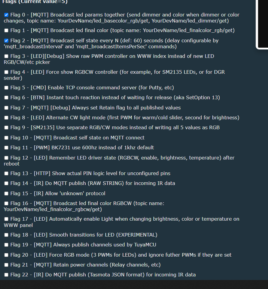

  • #4 20999121
    Posts: 14771
    Rate: 12914
    Maybe setting retain flag may help?
    Screenshot of a flags list for MQTT software, with the flag ID 7 highlighted.
  • #5 20999193
    biznessdronss88
    Posts: 7
    @p.kaczmarek2 List of configuration options and flags for an LED controller displayed on a dark background.
    The flag is not worth it, ((((((
  • #6 20999195
    Posts: 14771
    Rate: 12914
    You can also try flag 10, broadcast self state on MQTT connect.

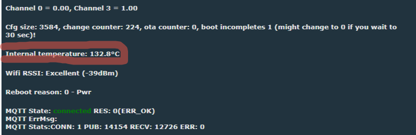

  • High device temperature above 100°C on both units
    #9 21000328
    biznessdronss88
    Posts: 7
    @p.kaczmarek2 Screenshot of the Home Assistant interface with BK7231T device data.
    yes, after changing the channel to 3, everything works during the day!
    Added after 3 [minutes]:
    @p.kaczmarek2 Screenshot of a device control panel showing an internal temperature of 132.8°C
    I also paid attention to the temperature of the device. there are two devices that are stitched and on both devices the temperature is more than 100, is this normal? It looks kind of scary. the chip itself, if you touch it with your finger, is very hot
