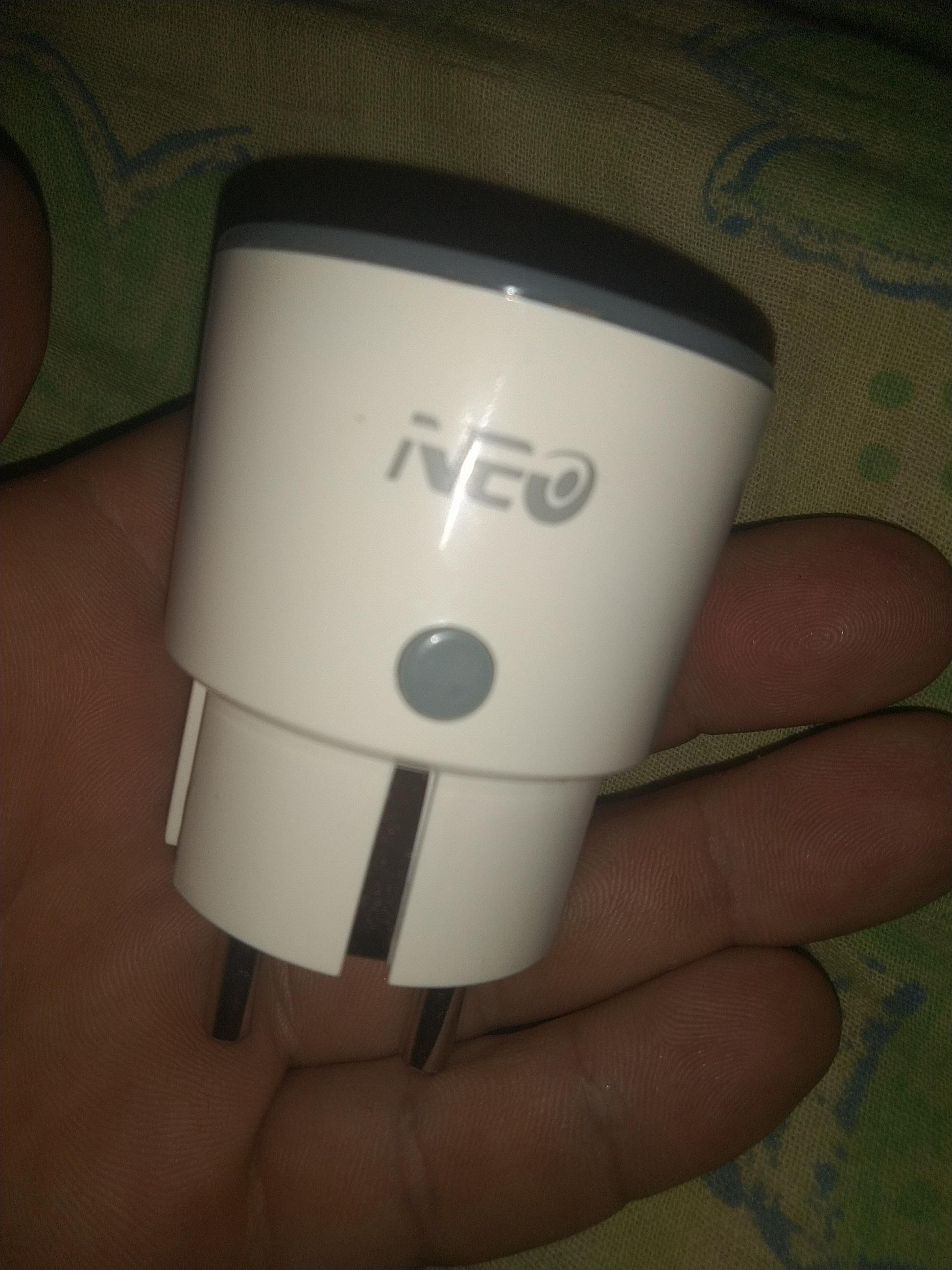

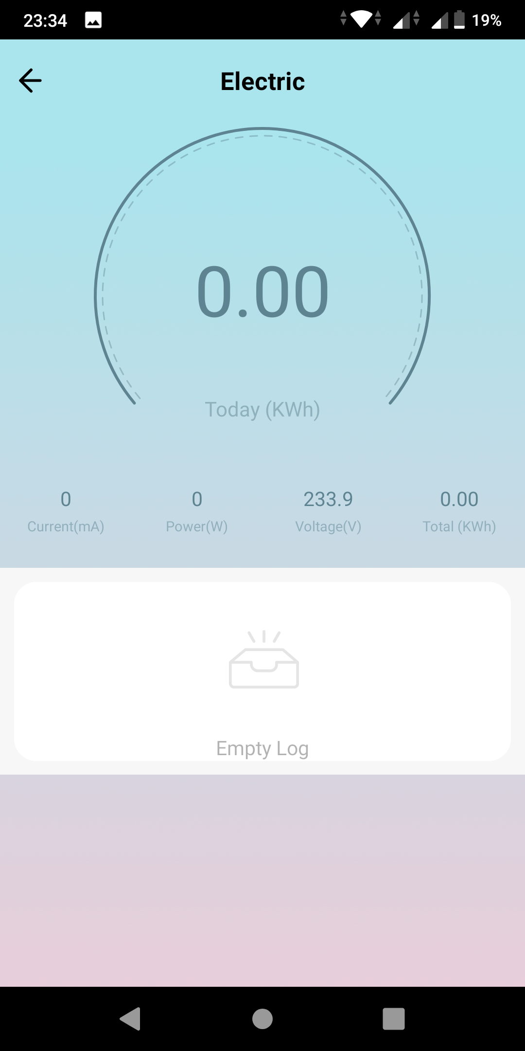

    Problem as follows.

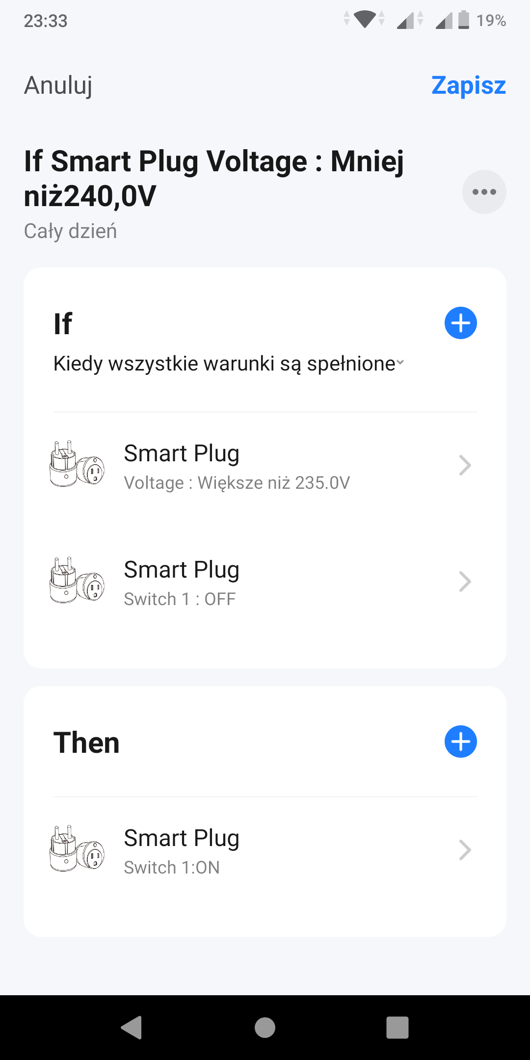

    Wifi smart plug socket, connected to home router,Tuya app on phone. The scene written: if the voltage higher than 245v and the socket off -> turn on the socket.
    And that's it, after five minutes the timer turns off the socket measurement and so on over and over again.
    The problem is that this automation works only when I have the application turned on and it is on the tab with the voltmeter just enough that I enter another tab or the application is running in the background automation stops working. Maybe someone of you has encountered a similar problem and has any ideas what could be the cause of this tragedy?

    What socket is this exactly?
    bolec310 wrote:
    Scene written: if voltage higher than 245v and socket off -> turn socket on.
    Insert screen of scene with voltage setting.
  • #3 20480265
    bolec310
    Posts: 122

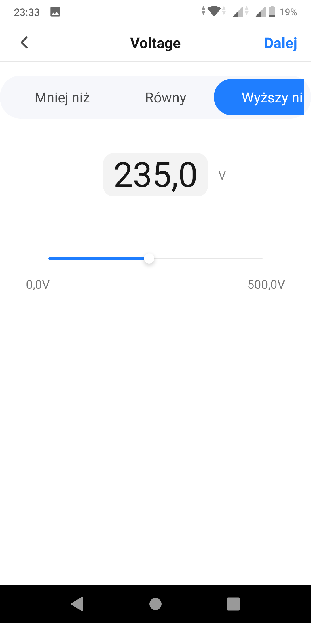

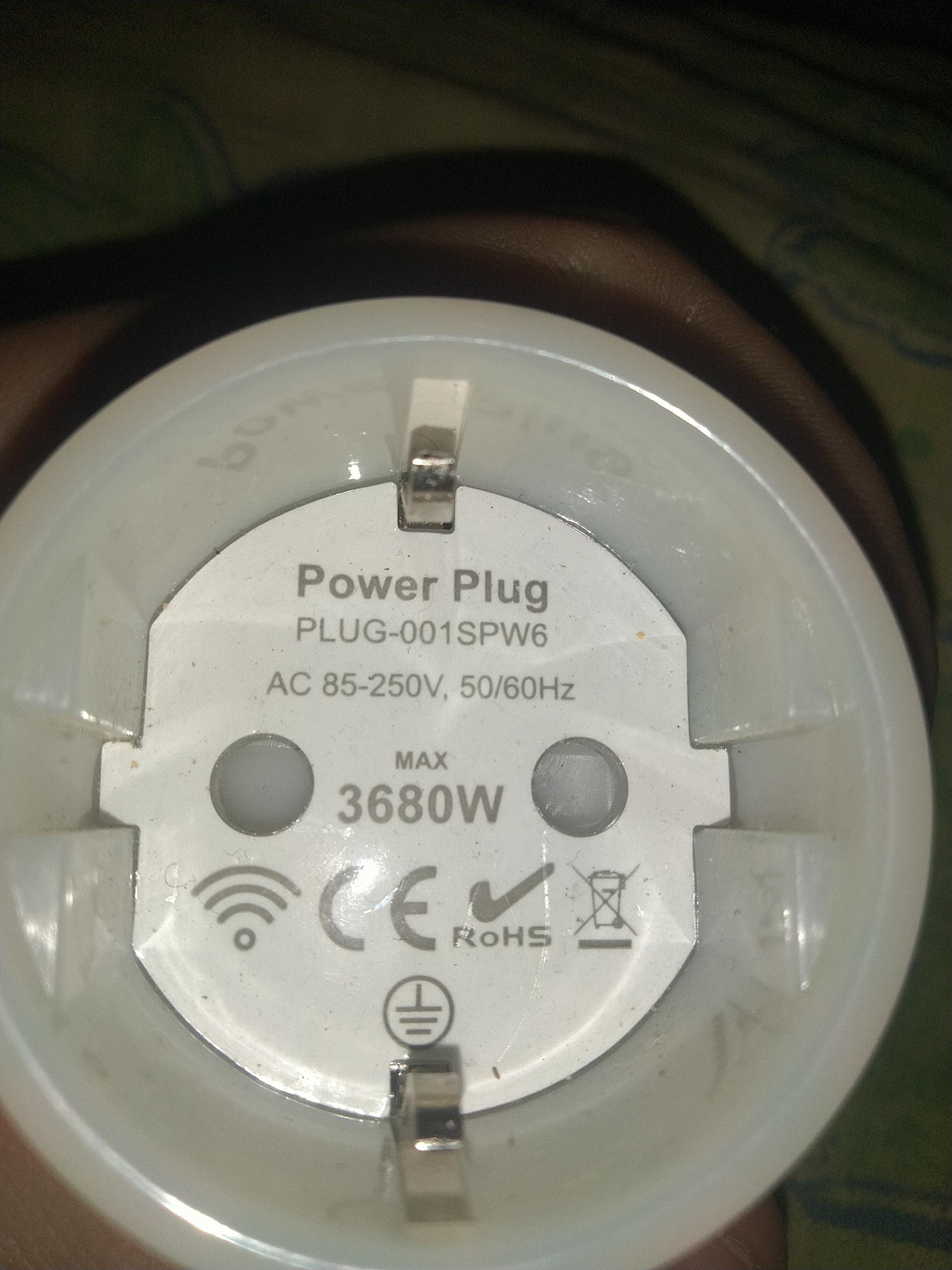

    Photos of the socket and settings, everything works when I have that voltmeter on which is on the only one of the screenshots

    I would start by reducing the voltage value in the scene. You have it set at 235V, sometimes it is lower, as shown in picture 4.
