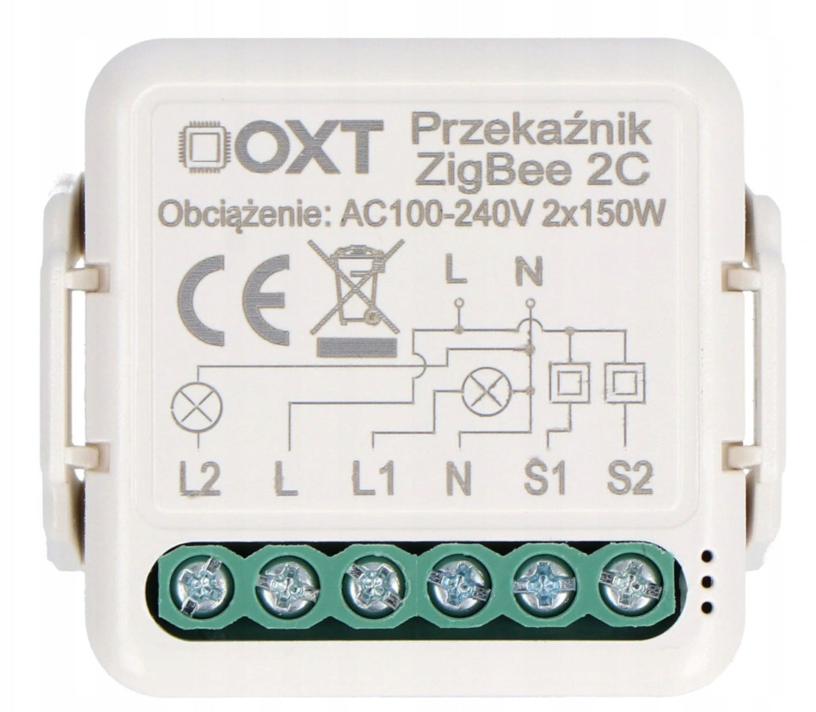

    Good morning,
    I have a problem integrating a Zigbee module with a Simon 55 illuminated switch.
    I have 2 different Zigbee modules from the light switches - an OXT and a straight from China GIRIER Tuya ZigBee 3.0 - externally, to be honest, they look identical.
    When I had the connectors themselves fitted to the bulb - everything worked as expected.
    When I connected the Zigbee module - I could only control the on/off via the Tuya app. The physical button didn't change state, as if it was still on.
    I went to my senses and measured the voltages with a meter. It turned out that the illuminated switch in the on position was giving an alternating voltage of 230 volts, but in the off position it was still generating a voltage of about 66 volts. The bulb did not light up, but when I changed the light source to a GU9 LED attached to the lamp I bought, it turned out that on the switch alone (without the smarthome module) in the on position the bulb shines brightly, in the off position much less, but still. I should add that the Zigbee modules claimed to be compatible with 110-230 volts, but yet when 66 volts was applied it still saw an 'ON' state.
    Do you know of any solution to the problem?
    - another Zigbee module
    - solder something in the circuit to reduce the voltage when in the off state, but so that the backlight in the physical button still works?
    Regarding the connection - according to the attached file
    Zigbee module OXT with connection labels and wiring diagram.

  • 0.1 µF capacitor between N and S1 works

    >>21390425 I was impatient, so I bought the first one I could find in the supermarket on a trial basis – it was called the ‘KS-1 backlit switch capacitor for LED lighting’ by Abex. This component differs from the WKSL model offered by Simon in that it contains only a 0.1 µF capacitor, with no resistor. Nevertheless, it works – connected between N and S1 of the Zigbee relay.
    Problem solved, many thanks for your help!

    The solution is a capacitor connected in parallel to the Zigbee module between the N and S1 inputs (the output from the physical switch). Specifically, I used a 0.1 µF capacitor rated for 275 V.
