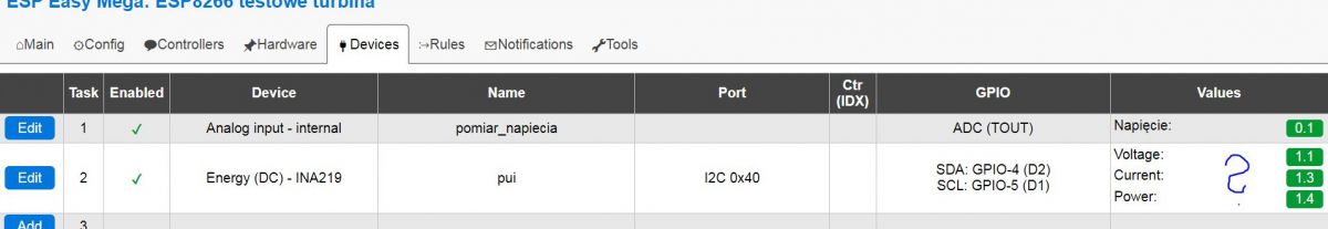

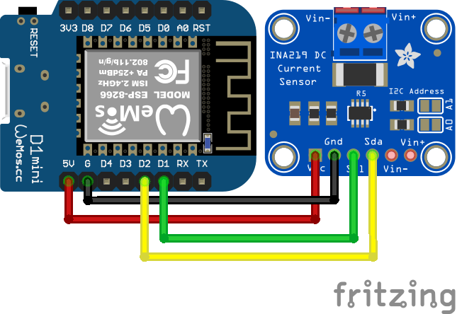

    Greetings esteemed members of the public. Please help. I am displaying too low current, voltage, power values. Is it a broken module or something needs to be set?
    Screenshot of the ESP Easy Mega interface showing low voltage, current, and power values. .
    Connection diagram of D1 mini Wemos with INA219 current sensor. .

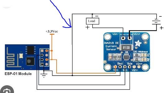

    Thanks, I didn't connect the ground :) . But that's not all, this module has a limitation of 26V and 3A. Is it possible to measure higher voltages, higher currents with it through a voltage divider ?

    and who knew about your ground problem, you didn't include it earlier.
    1 Read the datasheet, it will answer your questions.
    2. the INA219 can operate in differential mode, so connecting or not connecting the ground should not make a difference to the current measurement.
    3. just like any other meter, by adding a voltage divider, you can increase the voltage measurement range, and by changing the shunt resistor, you affect the current measurement.
    But you need to check:
    - that you do not exceed the dependent operating conditions of the circuit after the change
    - adding a shunt resistor and a voltage divider at the same time will affect the measurements and the way you measure, this is something you have to take into account.
    Regards

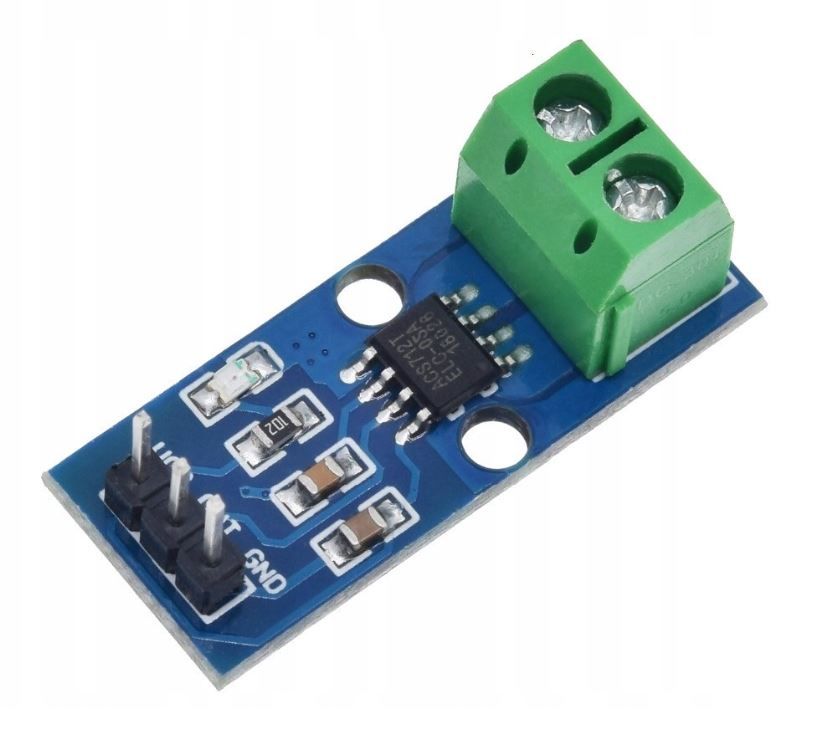

    I have done it differently. I used the ACS712 current measurement module - 5A and I measure the voltage via a voltage divider. I do not expect under load voltages>100V DC.
    I connected this to an ESP32 S2 board - it supposedly has 3.3V but this module pulled it. I've done as analogue inputs, we'll see how the measurement goes.
    A table fragment showing configuration of analog inputs for voltage and current measurement. .
