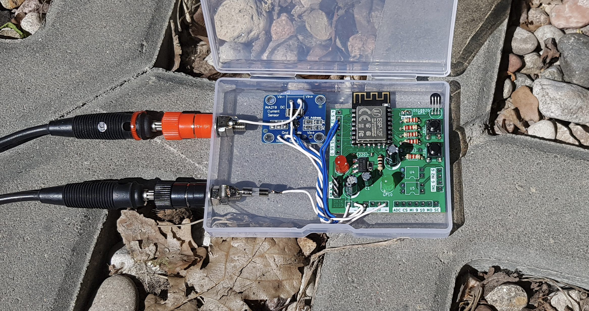

    An acquaintance asked me to assemble "something" that would give him notification when the battery in his very little used car discharges too much.
    For a quick thought I came up with ESP8266 + ina219 and a piece of code that would take a measurement, send it to the server and put the system to sleep for a set period of time in order to start the cycle again after waking up. The board is my universal board for the ESP8266 and additionally a module with the INA219 chip which I use to measure voltage.
    The whole thing goes to my server where the data is collected, visualised and, if necessary, a notification is sent by a simple SMS through the phone which I have connected to the server and makes for a universal SMS gateway.
    The device fit into a box from some small oled display, 2 banana sockets and a 300mA fuse were installed and I prepared wires with crocodiles to plug it straight into the battery. The unit draws about 6 mA when asleep, which can be greatly improved by using another linear stabiliser instead of the 1117 and go down to about 90 μA. When sending a measurement it draws about 200 mA for 300 ms. Quite by the way there is a DS18b20 on the board.

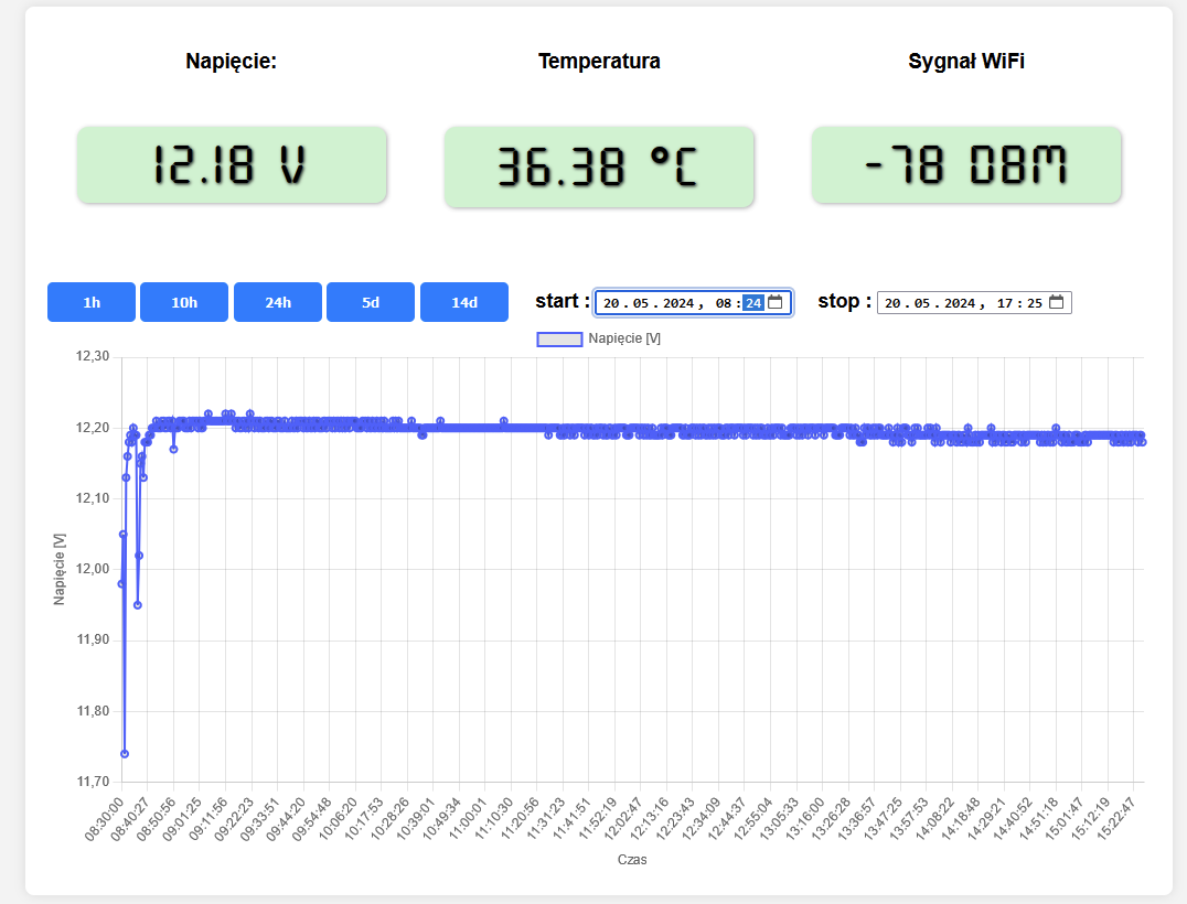

    This is where you can look at the measurement results

    This can be done on an ADC and a high-impedance divider without the INA219. If it's just a matter of measuring voltage.
    Although the ESP8266 has an ADC max of 1V.

    This Ina can measure voltage?

    Yes, up to 26 volts with pretty good precision.

    https://www.gotronik.pl/ina219-dwukierunkowy-czujnik-pradu-z-szyna-i2c-p-5736.html
    I'm looking at a board like this, and let's say I can see the current connection, but what about the voltage? Does it measure how the current measurement fastens on the plus side, relative to the digital ground?
    Can the current measure both ways, e.g. charging and discharging the battery?

    Yes, it measures against digital earth. It can work in both directions, it will then indicate negative current.

  • WiFi link works at -86 dBm with sleep control

    As far as I can see in the code there is support for WiFi (void connectToWifi) - a lot of work is involved in implementing support for a GSM module doing the same thing, i.e. sending data to the server?
    I think there should be no problem, I myself have not yet used mobile networks, mainly wifi, radio 433 or there lora 868. Probably a little increase in power consumption and you have to somehow sensibly put the mobile communication module to sleep so that after waking up quite quickly registers in the network and set up a connection to the Internet.
    The system in the thread connects to the AP ubnt-ac-m which is installed on a mast that is above the roof of the house, is about 200 m away and there is still quite a large margin of signal, correct transmission in this location is even at a signal of -86 dBm.
    It works as you write, every time you send a query to the server where the results of the measurements from INA and dallas are, it returns a reply in which is the time for which it should go to sleep and that's it.

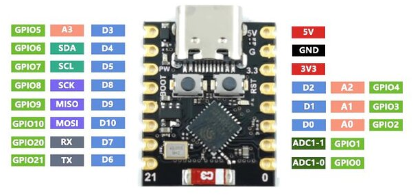

    I am also thinking about a similar project but on an ESP32 C3 with Supla ( https://gui-generic-builder.supla.io/ ) uploaded and sending measurements to the free Supla server. The ESP32 C3 has a more powerful antenna and higher sensitivity than the ESP8266 seen above in the pictures.
    ESP32 C3 module with pin layout
    only I don't think I can do without modifying the Supla software to make the ESP32 C3 wake up only every e.g. 1h and only send the result to the server every hour if it connects to a WiFi network (more often not needed). Alternatively, some external hardware watchdog that turns on the power for the ESP32 C3 every hour for say 1min just for a measurement. The ESP32 C3 also supposedly has a much better ADC (12bit) than the ESP8266 https://docs.espressif.com/projects/esp-idf/e....4/esp32c3/api-reference/peripherals/adc.html , and the price of this ESP32 C3 module visible in the photo on a well-known portal from majfrends is today about ~7zł/unit.
    The advantage is a ready-made Supla application and the possibility of setting up notifications, e.g. when the voltage on the battery drops below some sensible value....
