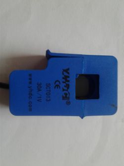

    Below is a description of the sensor for non-invasive current measurement up to 30A.
    The sensor can be purchased on Chinese auction portals together with the shipment at a price from about $ 4.5 or on Polish auction portals from about PLN 25 with the shipment.
    Sensor for measuring AC current SCT013 30A
    This sensor is called "Dietz clamp", i.e. it is easier to say that it is an ordinary transformer, but there is no primary winding in it, there is only a secondary winding, and the core of this transformer is divided, so you can fasten it with a cord non-invasively.
    The primary winding will be a wire on which the sensor core will be fastened.
    When using this sensor, a certain rule must be followed - the same as when using clamp meters - i.e. both this sensor and the clamp meter are fastened to only one of the power cables. In the case of fastening it with two wires supplying the device (phase and neutral wire), our sensor will usually show that no current flows through the wire, because as you know - the current in these wires flows in opposite directions and their sum will be zero.
    What is inside our sensor - not much.
    As I wrote above - we have a secondary winding with the number of turns 1800, a split core, a PCB, where the ends of the coil winding are connected and a resistor soldered between them. In this case it is a 62? resistor, on which we will measure our voltage from the sensor. For this one-meter cable terminated with a mini Jack plug.
    The "gear" of our sensor is 30/1, i.e. at 30A, the voltage of 1VAC will appear on the sensor plug.
    As the ratio of our sensor is 1: 1800, a current of 30 / (1/1800) = 0.01666A will flow through the secondary winding at 30A. The sensor has a built-in 62? resistor, so from Ohm's law we can calculate that at 30A, 0.01666 * 62 = 1.033V will appear on the sensor plug
    Now we know why the manufacturer gives the information 30A / 1V on the housing.

    This is not a sensor.
    This is an ordinary open-core current transformer with a load resistor on the secondary side. The resistor has two functions - measurement of voltage drop as a function of current and protection against damage to the transformer (the loaded current transformer cannot work with the open secondary side).
