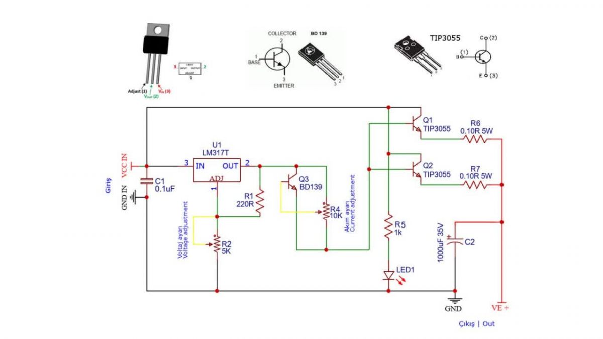

    Hi everyone
    I built a simple bench power supply according to the following circuit: 30V/10A
    Schematic diagram of a bench power supply with components like LM317T, TIP3055, and BD139.
    But I now want to add the CC and CV indicators LEDs and also add over current protection. What is the circuit?
    Thanks

    >>21404426 The LM317 cube has overcurrent protection as well as thermal protection. The LM317 requires a heatsink.
