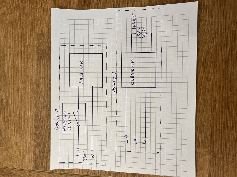

    Hi
    I would be grateful for help in designing a switch for a wall lamp that is on a different circuit from the switch. The switch is an ordinary wall mounted key switch - I cannot change it to another. I am attaching a diagram of the installation. I would like it to be a simple (cheap) solution without batteries in the controls (230 V supply), I don't need additional control from e.g. remote controls, phone.
    Regards
    Richard
    Hand-drawn electrical schematic showing connections of two circuits with a switch and a wall lamp. .

    The simplest, cheapest and safest way to do this is with an additional switch in the wall lamp, the so-called "dangle". Other methods are not so simple/expensive. Additional information is needed. Will there be another light source from this switch or just the wall lamp?

    Thank you for your reply, the dangle is out - my wife will not accept :-) , the switch will only be used for this wall lamp. As for the price, I am able to spend 100 max 200 zł.

    I did some research on the web and found a ZAMEL solution: transmitter: RNP-01 and receiver: ROP-01, only I will probably have to change the switch from a bistable switch to a monostable button - unless it will work on a bistable one? Does anyone have experience of such an arrangement, how will it resist interference?

    Just for myself - in the box of this sconce switch, the colleague has both L and N lines?
