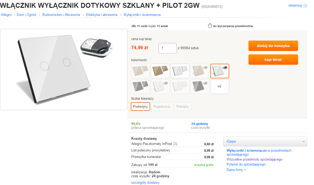

    Na,only is in the box,(as long as there are boxes). There are radio controls available for purchase, they can be combined with dedicated switches, unfortunately you need zero (N ) there. There used to be dimmers that reacted to the TV remote control, using only the same wires as a normal switch. It was possible to operate them with a remote control, even after switching on the light when the zero from the bulb disappeared. A matter of searching.
    I found one on an auction site with this name .
    VL-C702R-62 Touch switch. LIVOLO GLASS FOR REMOTE CONTROL . Here you only need to buy the remote control.

    Thanks a lot for your interest. I contacted the seller and as he said an additional neutral wire for the switch is not needed.
    As soon as I get the switch I will take some pictures including how to connect it to be for posterity.
    Please do not close the topic yet.

    In any case, the switch according to the seller's assurances does not require any additional wiring. Only the phase and wires to the chandelier. Where it will get the energy to keep the relays latched I don't know, maybe it has a supercapacitor or something inside.
    I purchased one (auction screen)
    A remote-controlled light switch that has to meet quite demanding requirements. .
    For now, I am waiting for the courier who should deliver the package tomorrow or Thursday.
