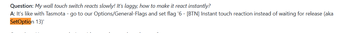

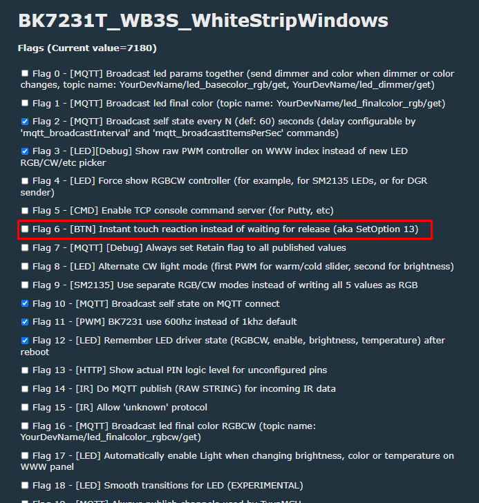

    Hello, I have successfully and without any problems managed to reflash two touch switches from Tuya to OpenBeken. Everything works as expected, except for one small detail, the response of the buttons is a bit slow. In tasmot I would have managed by disabling the multi-click control, i.e. SetOption 13, here I have no idea what to do as I am just starting to play.
    Can anyone suggest how to revive these buttons?
