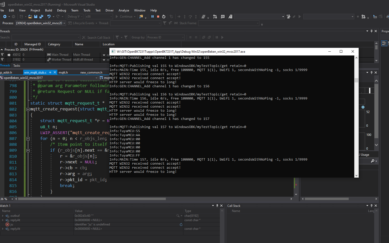

    Hello, we are still working on documentation, but the topic was covered in this video:
    https://www.youtube.com/watch?v=KU0tDwtjfjw&feature=emb_title
    Here is example script - autoexec.bat (create file in LittleFS tab in Web App):
    // P21 role is Btn, a power button that works without scripting
    // set button hold/repeat/etc times
    SetButtonTimes 10 3 3
    // alias to turn off LED after 4 secs (repeating event with 1 repeat)
    alias add_turnoff_event addRepeatingEvent 4 1 led_enableAll 0
    // button events - 23, 22, etc are pin numbers
    addEventHandler OnHold 23 add_dimmer 10
    addEventHandler OnHold 22 add_dimmer -10
    addEventHandler OnDblClick 22 led_dimmer 5
    addEventHandler OnDblClick 23 led_dimmer 100
    addEventHandler OnClick 20 add_turnoff_event
    // IR events
    addEventHandler2 IR_Samsung 0x707 0x62 add_dimmer 10
    addEventHandler2 IR_Samsung 0x707 0x65 add_dimmer -10
    addEventHandler2 IR_Samsung 0x707 0x61 led_enableAll 0
    addEventHandler2 IR_Samsung 0x707 0x60 led_enableAll 1
    23, etc is a pin index for button with Btn or Btn_ScriptOnly role.
    The only thing missing seems to be "OnTripleClick", but I think I can add it for you, if that's needed.
    Basically you set a button role to Btn_ScriptOnly and can assign event handlers for events like OnClick, OnDblClick, OnHoldStart, OnHold, OnRelease...
    We have different syntax because we support script threads from LittleFS, but more about that later.

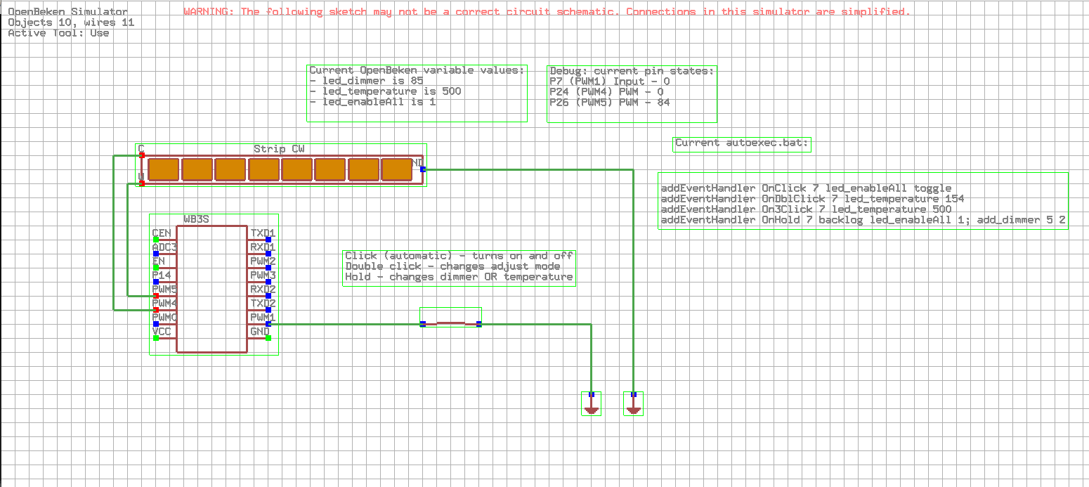

    We will be also releasing soon a Windows Simulator where you can write scripts and test them without IoT device:

    I think for the edge detection all we need is up and down events similar to JavaScript mouse events
    There are indeed OnHoldStart and OnRelease events, and you can set any arbitrary channel in OnHoldStart (command: "setChannel 10 0"), increase it in OnHold (command "addChannel 10 1") and publish in OnRelease (command "publishInt mySpecialVal123 $CH10"), but I am not sure why?

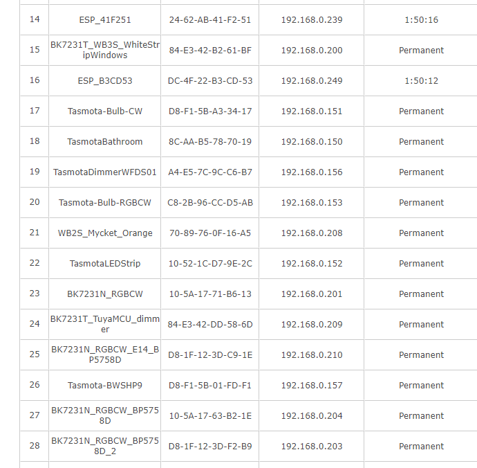

    I have now flashed a few of my devices and got them up and running. I did have a few issues with the flashing for both devices, your new flash tool would not work for either of them.
    Tuya CBU module BK7231N I had to use the python tool for both reading the flash and writing Tuya WB3L modules BK7231T I had to use the BKwritter and use that to read the flash and use the python tool to do the write
    Seems odd to me, but maybe you can shed some light on these issues.

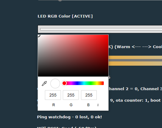

    Setting up the RGB CCT light took quite some time since one PWM channel had to be inverted and flag 8 had to be set
    Flag 8 - [LED] Alternate CW light mode (first PWM for warm/cold slider, second for brightness)

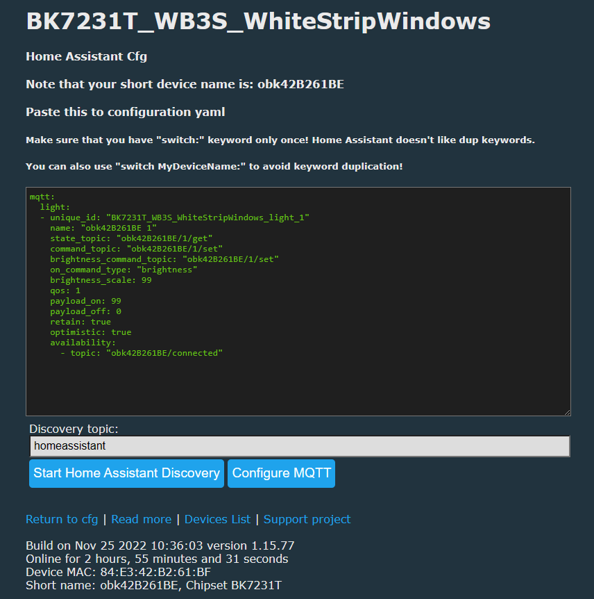

    I have noticed HA can take anywhere from 5 - 25 sec to pick up it is available again, is there any way to speed this up or keep it constant?
    I have got the basics of the switch module working, have not tried double/triple and hold yet. I have found a bug/issue I have setup on the start to be -1 to remember last state, this works fine. But if the switch is on and I disconnect power and reapply power the switch switches back on, but if I switch the switch off before it has connected back to wifi it switches itself back on and should stay off.
    I would like to do a tear down for these and post them but I can't find out where the option is to export the config or JSON so it can be added to the list

    What I thought was in the HA config section where it generates the YAML is to have an option to auto generate this format above with correct parameters, device settings can just be FW for sw_version, manufacture: OpenBeken etc It's just the unique ID that has to be different for multiple of the same device. This is upto to user configuring the device
    Here is some more info on HA scripting ( can be done inside of the YAML file also )
    https://www.home-assistant.io/integrations/script/

    Maybe just have it as an second option like addEventHandler OnHold 23 add_dimmer 10 2 ( Instead of 1 )
    Yes, I was thinking about the same, I implemented it quickly thanks to Windows Simulator I can develop REALLY FAST and now it's working:
    @iprak , what do you think? Add a checkbox to this page:
    [OpenBeken] Push button actions multi press and hold down etc
    [ ] Show HA Discovery format ?

    If you release an alpha I will give it ago. Can it simulate MQTT so it can be tested with HA like as if it was a physical device?
    I'm getting it done for you now.
    It's almost working. It's gonna be very nice and useful. I am testing with the following script:
    addRepeatingEvent 1 -1 backlog addChannel 1 1; publishInt myTestTopic $CH1

    Windows Simulator MQTT works, now even with HA Discovery! Development speed will increase again. We can test MQTT stuff without having IoT device (and with Home Assistant on VMWare), so I can develop OBK even while being on plane! Futhermore I can use MSVC debuger in that Windows build, which is also a great improvement over running stuff on BK.

    I did have a few other ideas. With tuyalocal on the RGBCW lights, if you were on the RGB colours/mode and then selected white it would automatically go back to the cw mode and preset setting. Can we have an option flag for the same behavior? At the moment you have to adjust the CW temp slider to go back and try to get it back to where you left it which you may be matched with all the lights in the house
    Do you mean that selecting 255 255 255 here enables Temperature mode?
    That's.... strange, I must admit. I can do that, but is it really used by people?

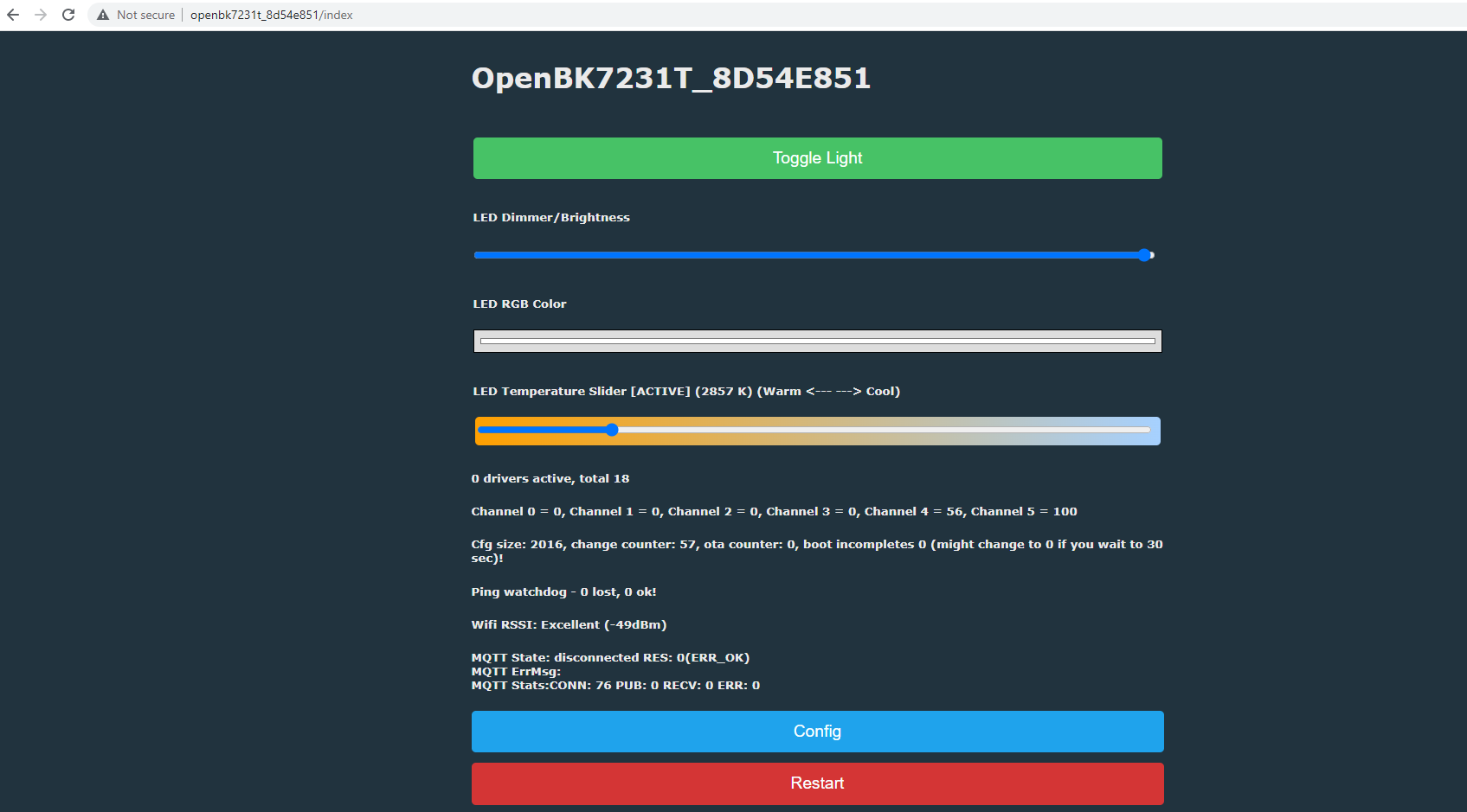

    matt303 wrote:
    Another idea, is using the short name as the devices wifi host name?
    It is using the Long Device name, but I can add a flag and make it using short name.
    You mean, that one?
    Please confirm and I will add that flag for you.

    It is using the Long Device name, but I can add a flag and make it using short name. You mean, that one?
    Short name would be useful as well since that's what I'm using to name each individual device. But that's interesting it's already using the long name and it's not displaying or showing up in Angry IP scanner, my other devices on my Network do, routers, PCs, Android, RPI etc I will see if I can access the device and ping it using the long name hostname, maybe it's just not broadcasting or something?
    I have just done some tests, I can't access webserver via http://LongName and if I try to ping the long name the host can't be found, may have to look into that one.

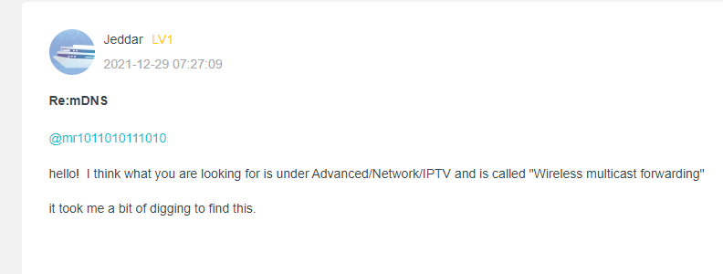

    Regarding the host name as device address issue.... I am not sure. I don't have experience in this specific field. I know that my Router sees the device host names well:
    so it must be a router issue? Maybe you must configure something on your router to access devices by their host names?
    Or maybe does the device needs to also transmit something else? I never used that host names for local Domain Name Server before...
    Can you elaborate on that? For me, it doesn't work for Tasmota either. I always access by IP. I assumed that kind of access must use some kind of DNS server on your router so it can resolve the "LongName" to IP.
    Yes that's the one, this is great because I may have an temperature set exactly how I like it and all I have todo to get back to it from using RGB is select white and we are back to normal lighting. I think a flag for this option would be fine. For example I may have 8x downlights in my lounge in a group, all I have todo it change the RGB to white and they go back to the CW mode

    matt303
    Posts: 15
    So I opened up a can of worms on this one... decided to update my router ( running OpenWRT ) this worked fine, went to load my backup nothing worked ( was a major update ) so I decided to roll back and it failed halfway through flashing and now bricked... time to pull apart.
    Yes the DNS server in your router handles this, most modern routers can do this fine. For example I use Raspberry PI host name to ssh into it and I have been in process of designing ESP32 MPPT charger with wifi web config and I can access it using host name no problem.

  • Router recovery and request for JSON MQTT discovery
    #21 20375796
    matt303
    Posts: 15
    Well, I hope you will resolve it. If you want, you can take that chance and submit a router teardown for our forum section.
    Luckily I was able to use the MikroTik boot loader recovery and reflash with their RouterOS and then I reflashed with OpenWRT. I have had to reconfigure the whole router manually though which has taken a day to get right with the latest version ( pleased to say the hostnames now show up! )
    As you can see in the picture I can access the device via the hostname! When you get the short name done I will test with devices' short name.

    If you are interested that much into simulator, maybe I could arrange something for you, maybe a beta, private, only for you build? What do you think?
    Last days were very busy and full of progress. New drivers has been added, including basic Alexa support, ioBroker support (the TELE message was missing but now we are really Tasmota-compatible), BL602 OTA was added (it was missing and it was problematic). Really great progress was made.
    Also a BK7231 datasheet topic was created:
    https://www.elektroda.com/rtvforum/topic3951016.html
    I also added some more automatic self tests, some of them demonstrate special scriptable use cases, here's an example of mapping 0-100 value to 3 relays selecting FAN speed:

    I have no other DNS services. My PC network card has DNS set to 192.168.0.1, which is main router. I am using Archer C6 v3.20 and I haven't found a setting for that yet. I've found this guide but it doesn't seem to be helpful, IPTV has nothing to do with what I am looking for:
    https://help.ptzoptics.com/support/solutions/...k-archer-c1200-v3-for-use-with-mdns-multicast
    Cmd says:
    ping TasmotaBathroom
    Ping request could not find host TasmotaBathroom. Please check the name and try again.
    ping TasmotaBathroom.local
    Ping request could not find host TasmotaBathroom.local. Please check the name and try again.
