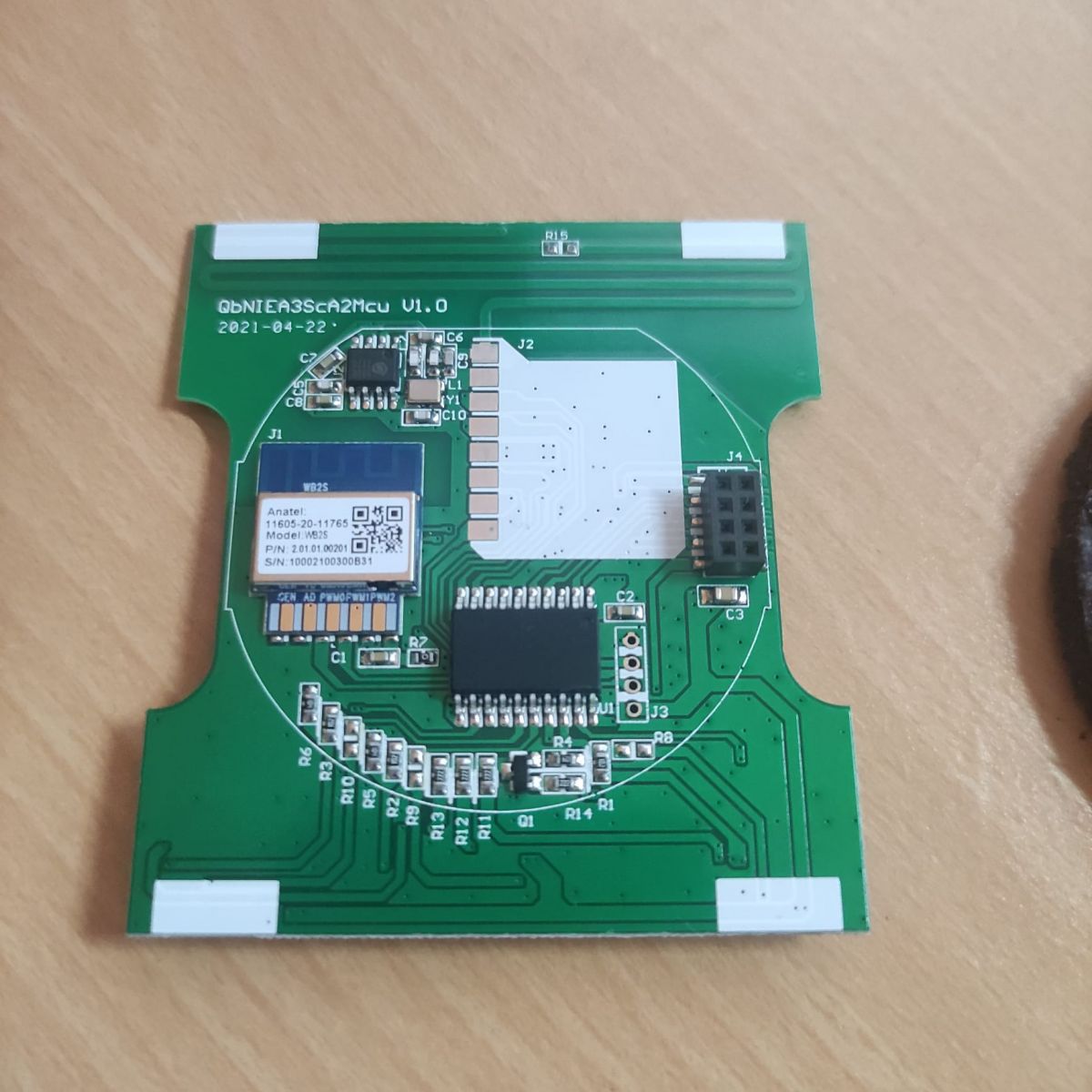

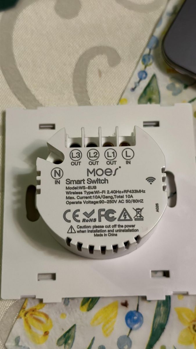

    I have a pair of MOES lighting switches, model WS-EUB, purchased from ali, I would like to get rid of the tuya, so thanks to the help of p.kaczmarek2, I uploaded soft BK7231T via UART.
    The soft uploaded wifi I put it on my WIFI but I got stuck at the stage of setting this BK :(
    the LED on the front panel of the switch is blinking all the time now :(
    On org software, I attach it below, it flashed until it was paired with the tuya app.
    Could you please advise what to do next?

    The pictures don't show how many buttons it has. Four touch buttons? Two?
  • #3 20536904
    PSlowik
    Posts: 80
    As for LittleFS, I don't know what it is, where it is etc :/
    The on/off switch is just a single button physical button

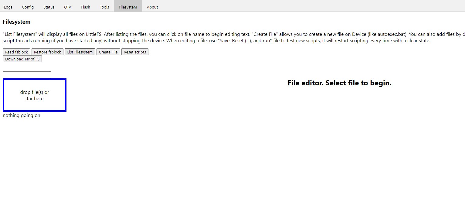

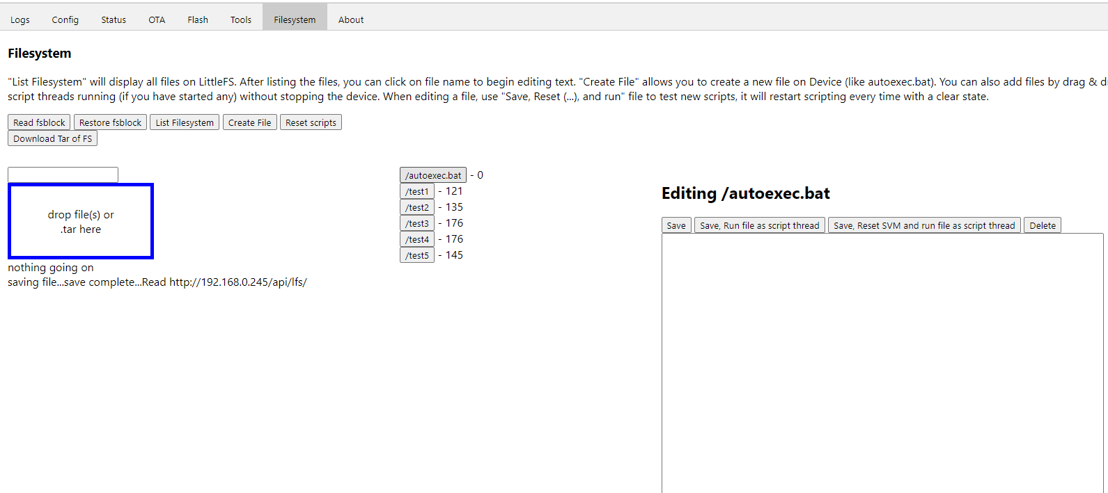

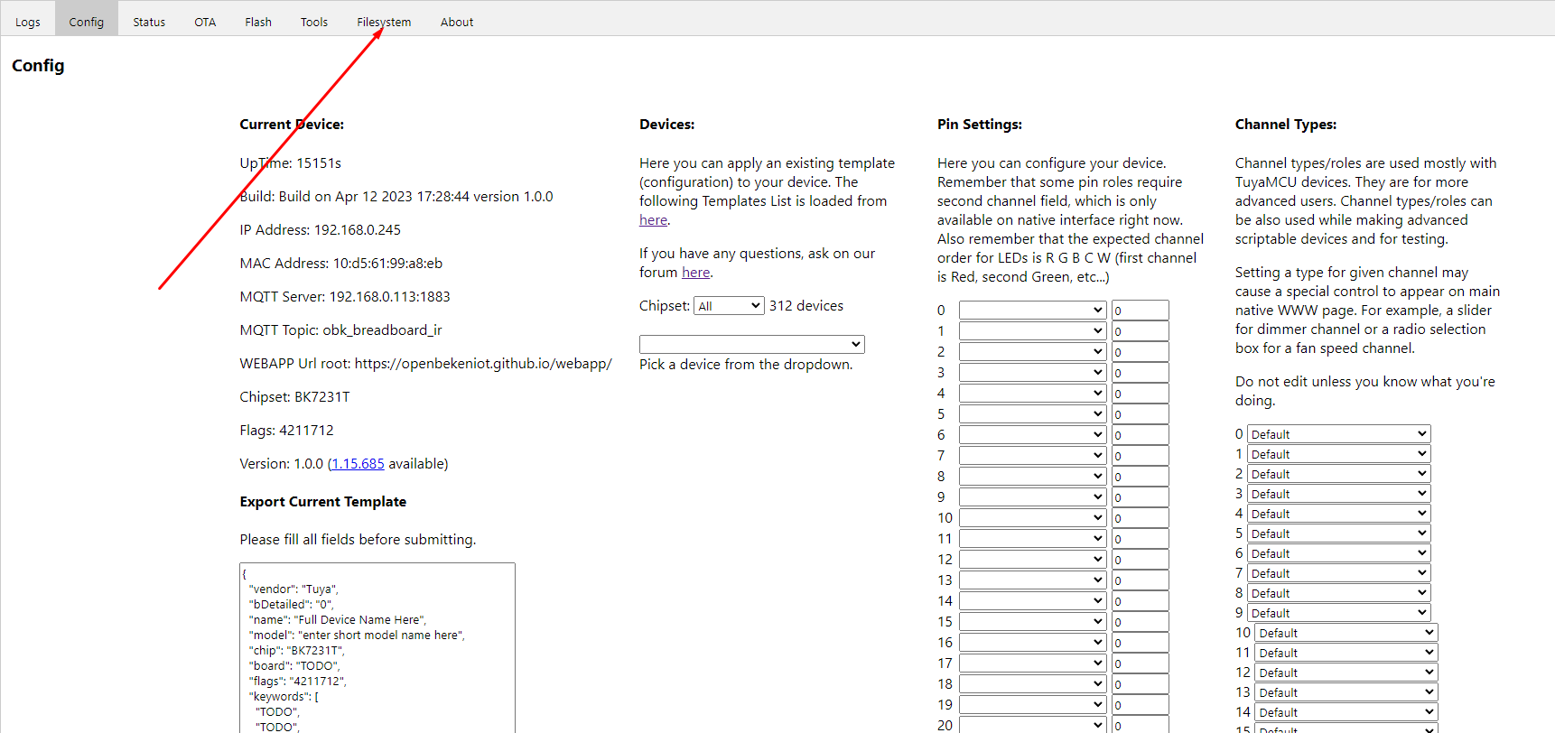

    Autoexec is created here:
    MOES 1-2 Light Switch: WB2S BK7231T TuyaMCU configuration for OpenBeken

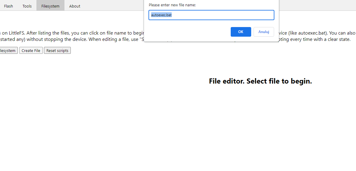

    here "Create file":
    MOES 1-2 Light Switch: WB2S BK7231T TuyaMCU configuration for OpenBeken MOES 1-2 Light Switch: WB2S BK7231T TuyaMCU configuration for OpenBeken
    since you say only one button, I think I already know how to configure it
    In autoexec.bat paste:
    startDriver TuyaMCU
    setChannelType 1 toggle
    save, reboot. You should get a button on the GUI that controls the relay. Check.

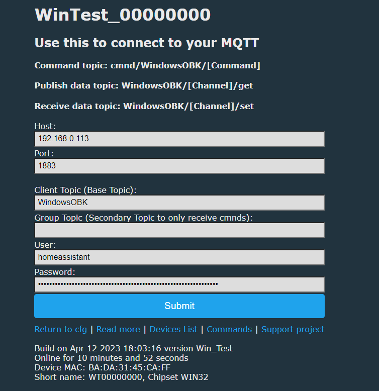

    For normal devices there is automatic HA discovery where everything happens by itself:
    https://www.youtube.com/watch?v=pkcspey25V4&ab_channel=Elektrodacom
    This way you can pair a lot and everything configures itself.
    Unfortunately, your device is weird by the manufacturer - I don't know why it needs TuyaMCU and UART control to control ONE relay and you have to write the Yaml code for it manually.
    Start by configuring MQTT in Configure MQTT. On the web panel, the MQTT status should be connected.
    Then in Home Assistant add the device via configuration.yaml:
    Code: YAML
    change the names of course, I'm testing on a simulator on windows. You will have a different name than me, you will probably enter something else as "Client Topic" (I have WindowsOBK there)

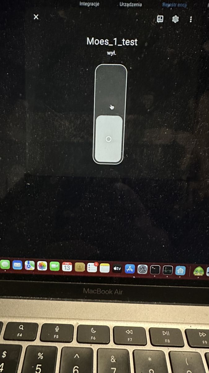

    It worked :) :) I'm really glad…
    It will still help if I put soft on the 2-button switch ;) if I can.
    Please tell me how is the overall stability of this software? Much better because it doesn't work in the cloud...

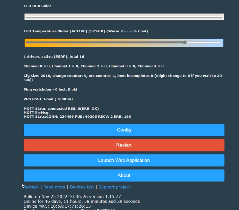

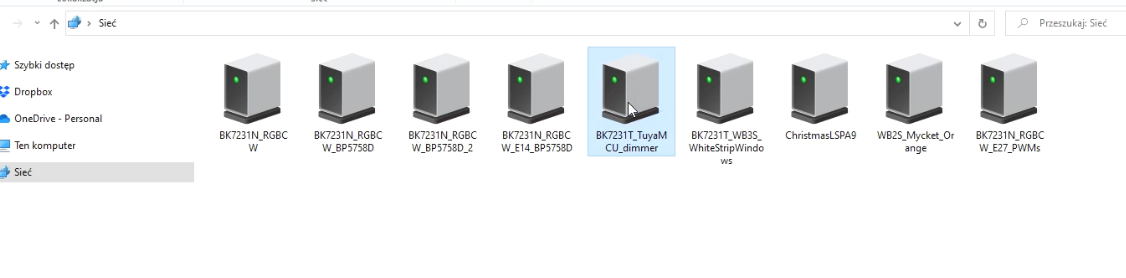

    Remember to enable autoexec too startDriver SSDP for Windows to see devices:

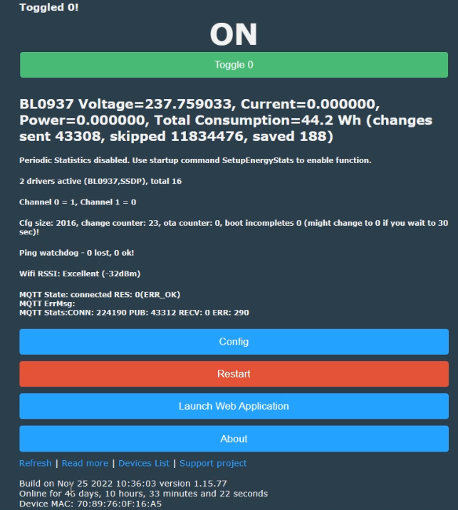

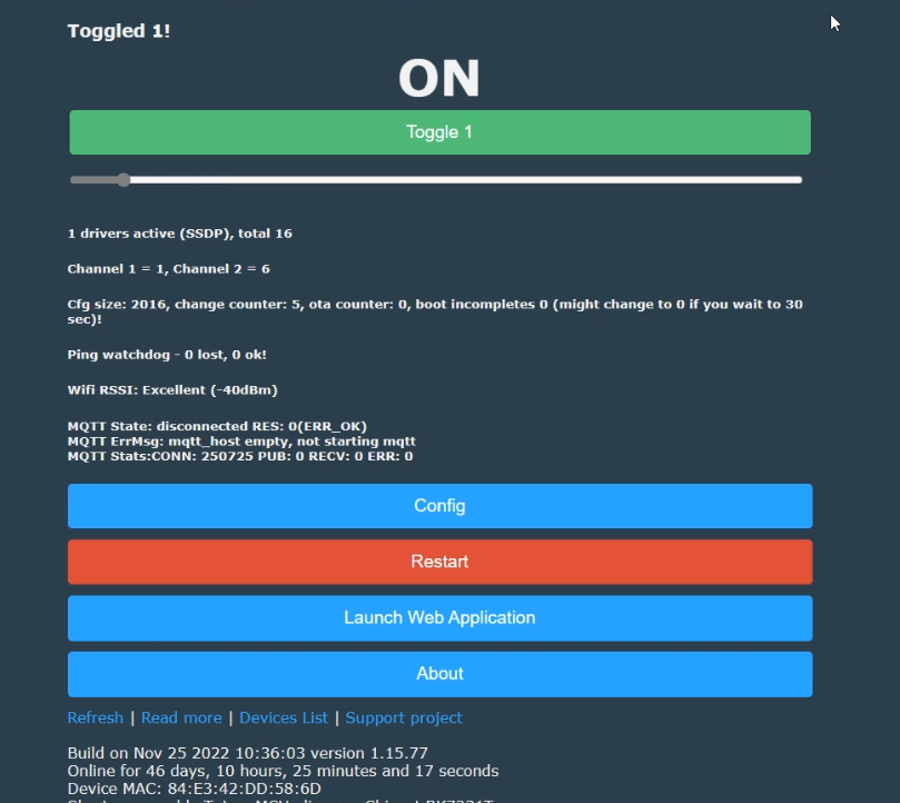

    Stability test showed it can run for months, here is a screenshot of the status as of January 11, 2023 :
    Uptime 46 days
    Recently, we have additionally enabled the watchdog to be able to automatically restart the software in the event of a possible suspension of the software

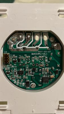

    styb113
    Level 4  

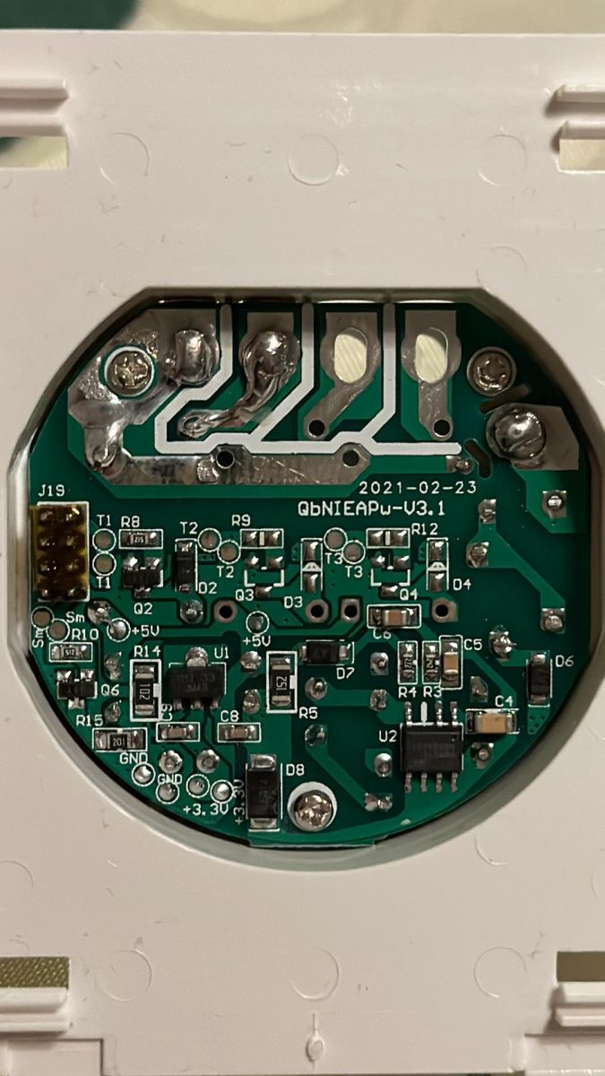

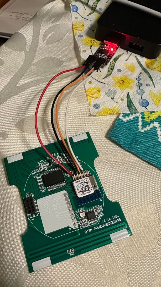

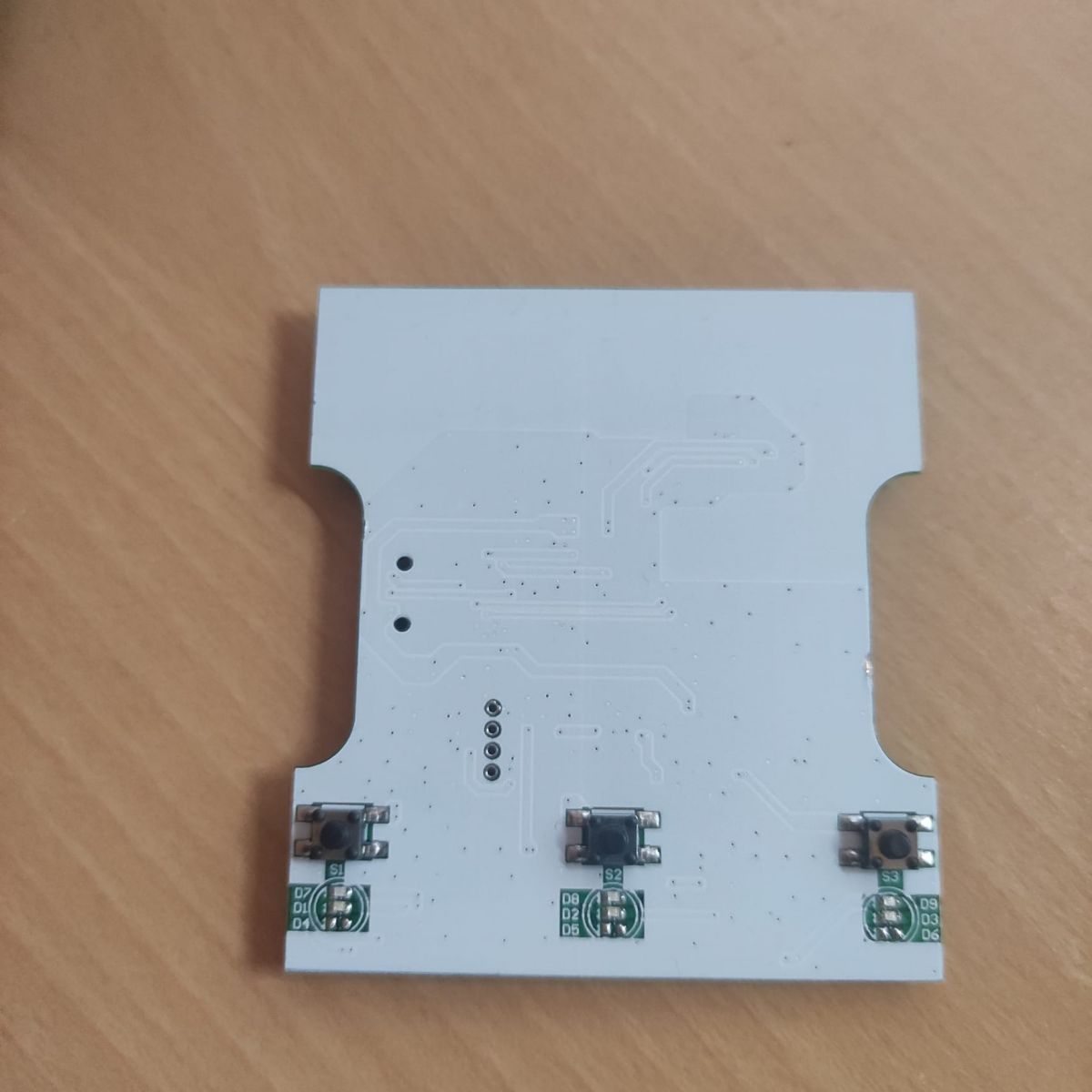

    I have a similar device to this one with 3 buttons and relays. It also has RF functionality. If I flash it with OpenBK how do I have to configure the settings for the TUYA MCU?
    Printed circuit board with a communication module and electronic components.
    Printed circuit board with three buttons and contacts on a white background.

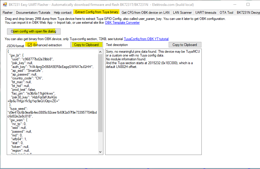

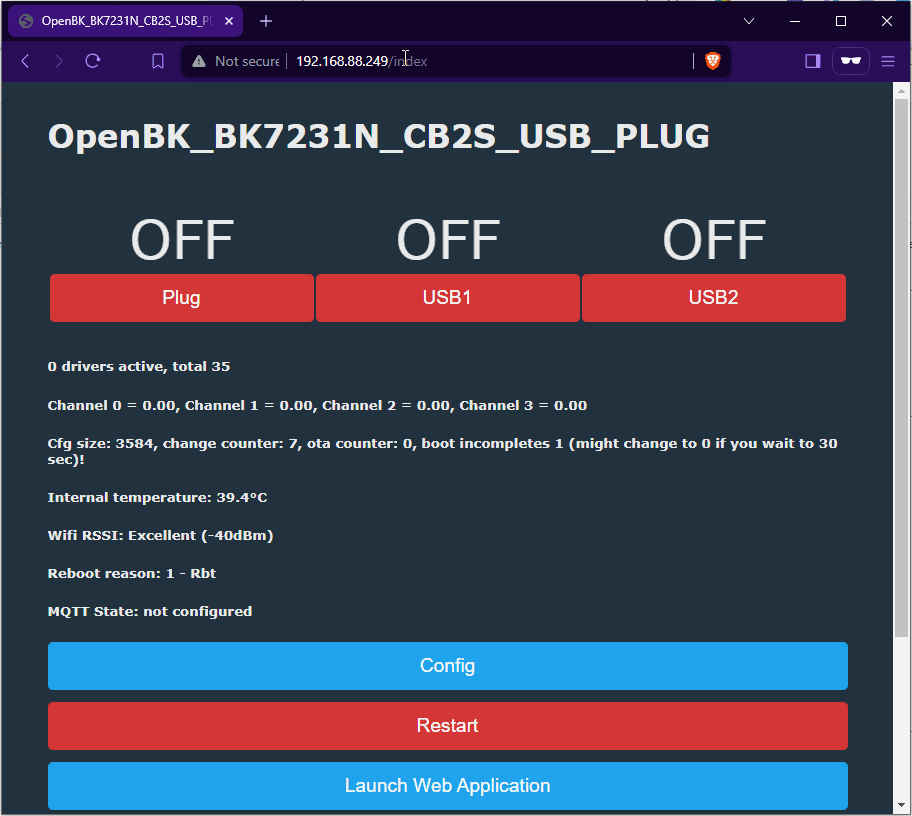

    OK, no worries. The Tuya config data may still be present and downloadable. We should be able to get any remaining dpIDs from the schema, assuming the product key is shown in the extraction.
    Screenshot of OpenBK dashboard with three OFF channels and buttons Plug, USB1, USB2
    open the saved file in Easy Flasher
    Screenshot of BK7231 Easy UART Flasher showing extracted JSON config and a text description panel.
    you may need to remove any saved wifi credentials from the json before posting the output, if you paired device with Tuya app ever. Credentials may be in base64
  • #17 21909603
    PullScanner1
    J'ai effectué la manipulation dans OBK, mais cela m'indique que tout est effacé. Par contre, il y a eu une évolution depuis hier : la LED du bouton clignote au démarrage, comme pour se connecter au Wi-Fi (donc normal), puis elle reste constamment éteinte lors de l'appui sur le bouton ON/OFF. (Je suis débutant.)
