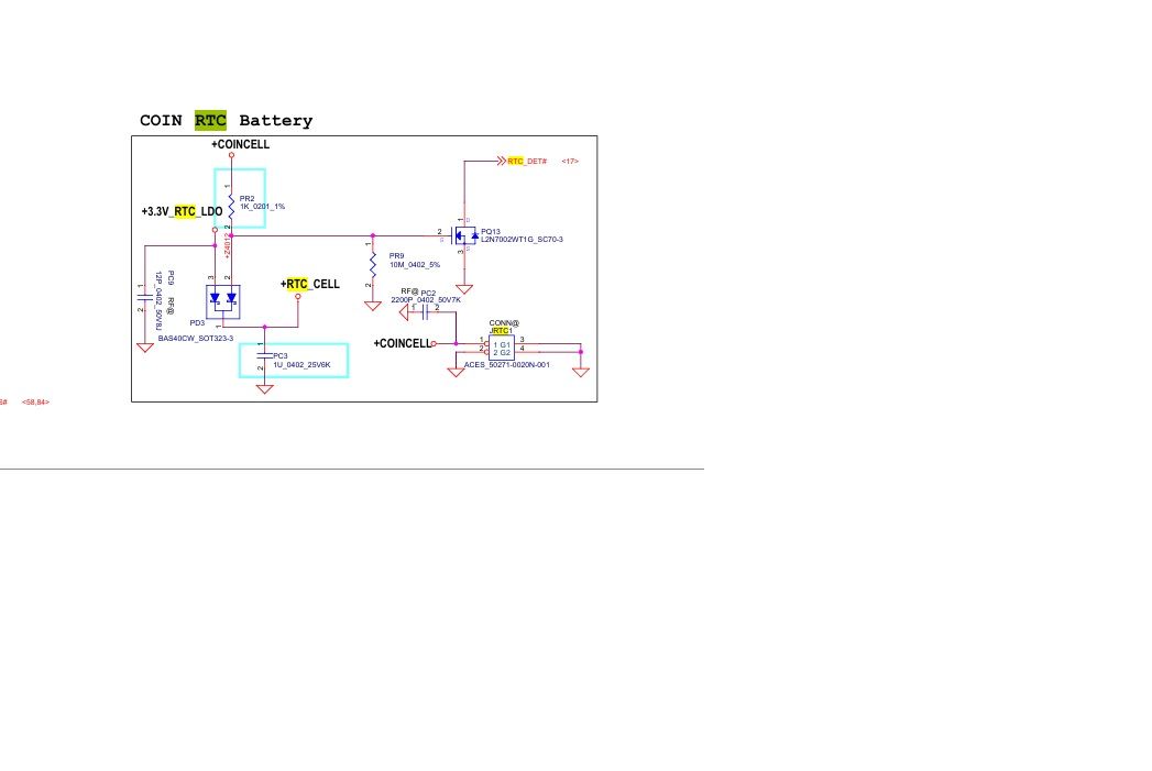

    Or an internal battery fault (as written)
    Or a fault in the RTC line (chipset or "combo" (i.e. cpu with integrated chipset,)
    E.g. d;a Dell Latitude 5501
    i5-9400H / MX150
    - is the LA-H182P board (p/nr. Dell:K5GPT )
    It is SM under (EDC42 LA-H171P)/ ( LA-H181P)
    RTC battery circuit connections diagram on a motherboard. .

    >>21455920 Gentlemen, I did a final test today:
    I charged the battery to 100%.
    I disconnected the battery from the laptop, and left it overnight.
    The next day, after 15 hours, I plugged it back in.
    I booted the laptop, loaded Windows 10 and logged in. The battery is now at 30%.
    That's how much of it is left after 5 years.
    The conclusion is simple: the motherboard, UEFI and other components are not draining it. It's just old.
