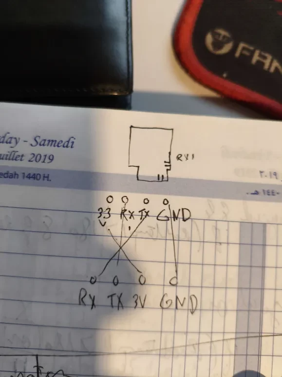

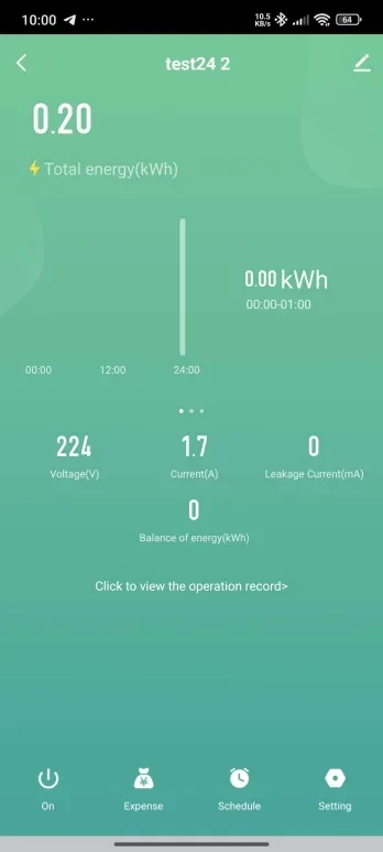

    need to make autoexec.Bat for this smart control v/a limite andd all other channel
    ai: what is the exact model and specifications of the smart control v/a limite device you are using?
    bk7231n cbu
    ai: can you provide details about your current setup or configuration for the bk7231n cbu?
    this info in tuya os befor flash openbeken andd need to set correct channel an make autoexec.Bat
    smart relay control and energy monitor
