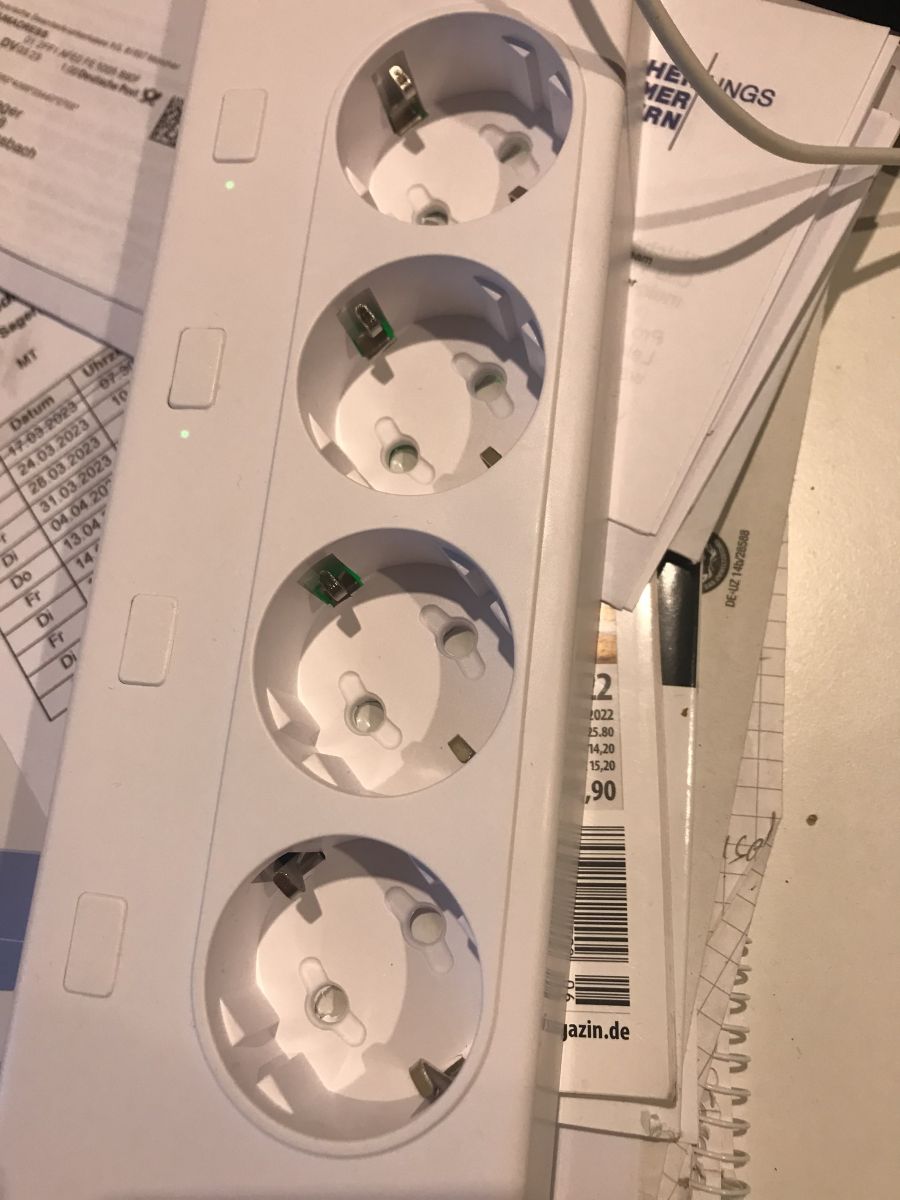

    I bought two of these Powerstrips and want to modify them. I see this OpenBK7231N for the included chip and I flashed it. But I must desolder it for flashing.
    [CB2S/BK7231N] TuyaMCU AOFO Smart Power Strip C733: Configuring & Modifying with OpenBK7231N [CB2S/BK7231N] TuyaMCU AOFO Smart Power Strip C733: Configuring & Modifying with OpenBK7231N
    [CB2S/BK7231N] TuyaMCU AOFO Smart Power Strip C733: Configuring & Modifying with OpenBK7231N [CB2S/BK7231N] TuyaMCU AOFO Smart Power Strip C733: Configuring & Modifying with OpenBK7231N [CB2S/BK7231N] TuyaMCU AOFO Smart Power Strip C733: Configuring & Modifying with OpenBK7231N [CB2S/BK7231N] TuyaMCU AOFO Smart Power Strip C733: Configuring & Modifying with OpenBK7231N
    AmazonLink
    But now my problem, I don't know how to configure it right. I tried the template for the AOFO smart power strip - WB2S but it won't work.
    I have some knowledge about Tasmota and Fhem. But your software is absolutely new for me and too much input in this short time.
    At this blakadder-Homepage someone desoldered the CB2S and changed it to one ESP-02s.
    Can someone please translate the config from blakadder for my Strip with Beken chip?

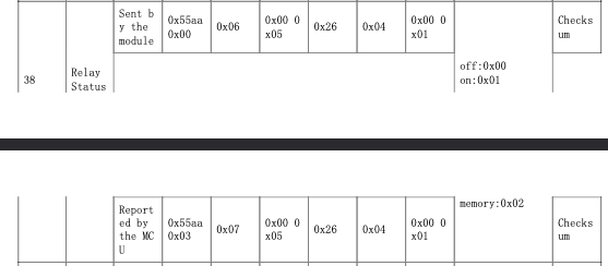

    Hello, it looks like it's a TuyaMCU device.
    dpID 38 Controls all switches and USB
    dpID 1dpID 2dpID 3dpID 4 Control AC
    dpID 7 Controls USB
    So something similar to this:
    https://www.elektroda.com/rtvforum/topic3906443.html

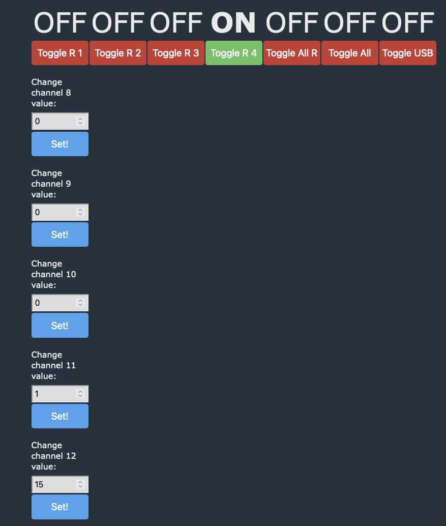

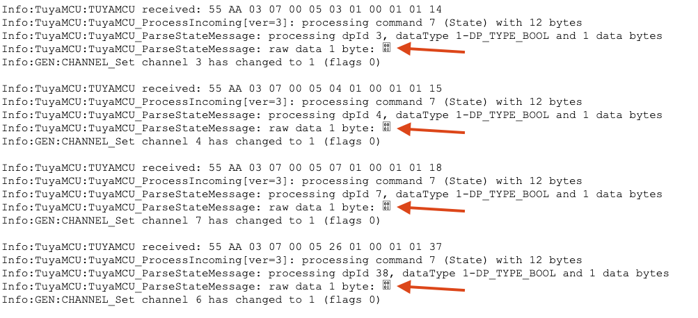

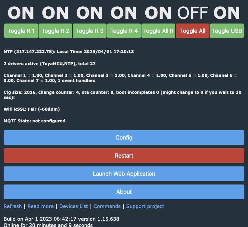

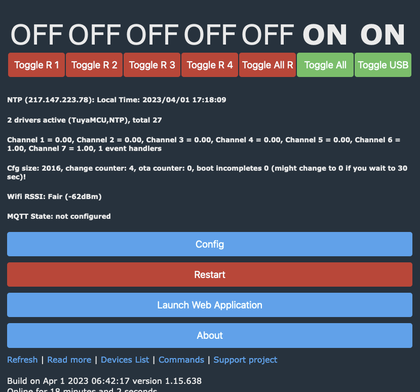

    it looks like i foolishly overwrote the post before. I'll write that again for a moment.it works with the autoexec.bat, however, with restrictions
    so first of all thanks for your help. a basic function is now given.
    However, the buttons in the App_webif are not correct responding properly. they bounce or don't react. in the previous post I had a log of the behavior of pushing the buttons on the power strip. If you still want it, I can create one again. I didn't know that the character limit in the forum was playing tricks on me.
    i almost forgot, i.e. usb can’t be switched individually yet and the button for everything on and everything off doesn’t do anything either.
    then I still use the template from the C700 socket. should I delete this?
    Thanks

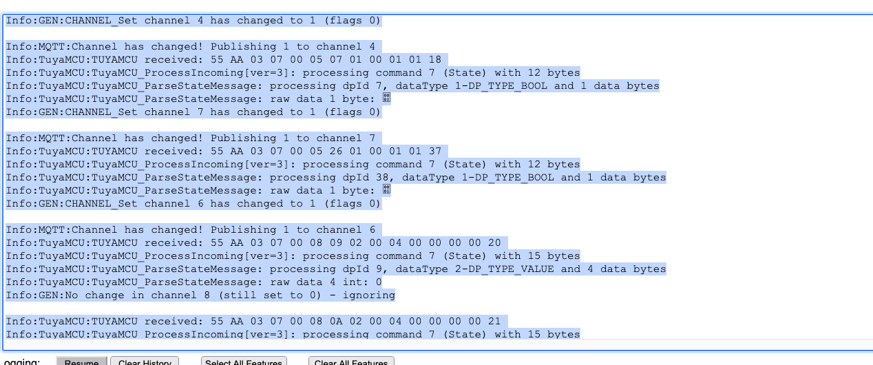

    and a log from pushing the buttons from AppWebIf
    I
    Info:GEN:11 Button_OnLongPressHold

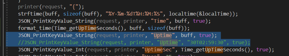

    Error:CMD:cmd RESULT NOT found (args {"Time":"1970-01-01T00:00:00","Uptime":"30T02:59:30","UptimeSec":1228,"Heap":25,"SleepMode":"Dynamic","Sleep":10,"LoadAvg":99,"MqttCount":23,"POWER1":"ON","POWER2":"OFF","POWER3":"OFF","POWER4":"OFF","POWER5":"OFF","POWER7":"ON","Wifi":{"AP":1,"SSId":"1","BSSId":"30:B5:C2:5D:70:72","Channel":11,"Mode":"11n","RSSI":78,"Signal":-61,"LinkCount":21,"Downtime":"0T06:13:34"}})
    Info:TuyaMCU:TUYAMCU received: 55 AA 03 07 00 05 02 01 00 01 01 13
    Info:TuyaMCU:TuyaMCU_ProcessIncoming[ver=3]: processing command 7 (State) with 12 bytes
    Info:TuyaMCU:TuyaMCU_ParseStateMessage: processing dpId 2, dataType 1-DP_TYPE_BOOL and 1 data bytes
    Info:TuyaMCU:TuyaMCU_ParseStateMessage: raw data 1 byte:
    Info:GEN:No change in channel 2 (still set to 1) - ignoring
    Info:TuyaMCU:TUYAMCU received: 55 AA 03 07 00 08 0A 02 00 04 00 00 00 00 21
    Info:TuyaMCU:TuyaMCU_ProcessIncoming[ver=3]: processing command 7 (State) with 15 bytes
    Info:TuyaMCU:TuyaMCU_ParseStateMessage: processing dpId 10, dataType 2-DP_TYPE_VALUE and 4 data bytes
    Info:TuyaMCU:TuyaMCU_ParseStateMessage: raw data 4 int: 0
    Info:MAIN:Time 1231, idle 175505/s, free 73480, MQTT 1(3), bWifi 1, secondsWithNoPing -1, socks 3/38
    Info:GEN:No change in channel 0 (still set to 0) - ignoring
    Info:GEN:No change in channel 1 (still set to 1) - ignoring
    Info:GEN:CHANNEL_Set channel 3 has changed to 1 (flags 0)
    Info:GEN:No change in channel 4 (still set to 0) - ignoring
    Info:GEN:No change in channel 5 (still set to 0) - ignoring
    Error:CMD:cmd RESULT NOT found (args {"Time":"1970-01-01T00:00:00","Uptime":"30T02:59:30","UptimeSec":1231,"Heap":25,"SleepMode":"Dynamic","Sleep":10,"LoadAvg":99,"MqttCount":23,"POWER1":"ON","POWER2":"ON","POWER3":"ON","POWER4":"OFF","POWER5":"OFF","POWER7":"ON","Wifi":{"AP":1,"SSId":"1","BSSId":"30:B5:C2:5D:70:72","Channel":11,"Mode":"11n","RSSI":78,"Signal":-61,"LinkCount":21,"Downtime":"0T06:13:34"}})
    Info:TuyaMCU:TUYAMCU received: 55 AA 03 07 00 05 03 01 00 01 01 14
    Info:TuyaMCU:TuyaMCU_ParseStateMessage: processing dpId 3, dataType 1-DP_TYPE_BOOL and 1 data bytes
    Info:GEN:No change in channel 3 (still set to 1) - ignoring
    Info:TuyaMCU:TUYAMCU received: 55 AA 03 07 00 08 0B 02 00 04 00 00 00 00 22
    Info:TuyaMCU:TuyaMCU_ParseStateMessage: processing dpId 11, dataType 2-DP_TYPE_VALUE and 4 data bytes
    Info:MAIN:Time 1232, idle 161089/s, free 73696, MQTT 1(3), bWifi 1, secondsWithNoPing -1, socks 2/38
    Info:GEN:CHANNEL_Set channel 3 has changed to 0 (flags 0)
    Error:CMD:cmd RESULT NOT found (args {"Time":"1970-01-01T00:00:00","Uptime":"30T02:59:30","UptimeSec":1232,"Heap":25,"SleepMode":"Dynamic","Sleep":10,"LoadAvg":99,"MqttCount":23,"POWER1":"ON","POWER2":"ON","POWER3":"OFF","POWER4":"OFF","POWER5":"OFF","POWER7":"ON","Wifi":{"AP":1,"SSId":"1","BSSId":"30:B5:C2:5D:70:72","Channel":11,"Mode":"11n","RSSI":78,"Signal":-61,"LinkCount":21,"Downtime":"0T06:13:34"}})
    Info:TuyaMCU:TUYAMCU received: 55 AA 03 07 00 05 03 01 00 01 00 13
    Info:GEN:No change in channel 3 (still set to 0) - ignoring
    Info:TuyaMCU:TUYAMCU received: 55 AA 03 07 00 08 0B 02 00 00 00 00 00 00 22
    Info:TuyaMCU:TuyaMCU_ProcessIncoming: discarding packet bad expected checksum, expected 34 and got checksum 30
    Info:MAIN:Time 1233, idle 165954/s, free 73696, MQTT 1(3), bWifi 1, secondsWithNoPing -1, socks 2/38
    Error:CMD:cmd RESULT NOT found (args {"Time":"1970-01-01T00:00:00","Uptime":"30T02:59:30","UptimeSec":1233,"Heap":25,"SleepMode":"Dynamic","Sleep":10,"LoadAvg":99,"MqttCount":23,"POWER1":"ON","POWER2":"ON","POWER3":"ON","POWER4":"OFF","POWER5":"OFF","POWER7":"ON","Wifi":{"AP":1,"SSId":"1","BSSId":"30:B5:C2:5D:70:72","Channel":11,"Mode":"11n","RSSI":78,"Signal":-61,"LinkCount":21,"Downtime":"0T06:13:34"}})
    Info:TuyaMCU:TUYAMCU received: 55 AA 03 07 00 05 04 01 00 01 01 15
    Info:TuyaMCU:TuyaMCU_ParseStateMessage: processing dpId 4, dataType 1-DP_TYPE_BOOL and 1 data bytes
    Info:GEN:No change in channel 4 (still set to 1) - ignoring
    Info:TuyaMCU:TUYAMCU received: 55 AA 03 07 00 08 0C 02 00 04 00 00 00 00 23
    Info:TuyaMCU:TuyaMCU_ParseStateMessage: processing dpId 12, dataType 2-DP_TYPE_VALUE and 4 data bytes
    Info:MAIN:Time 1235, idle 162062/s, free 73480, MQTT 1(3), bWifi 1, secondsWithNoPing -1, socks 3/38
    Info:TuyaMCU:TUYAMCU received: 55 AA 03 07 00 05 04 01 00 01 00 14
    Info:GEN:CHANNEL_Set channel 4 has changed to 0 (flags 0)
    Info:MAIN:Time 1236, idle 152439/s, free 73696, MQTT 1(3), bWifi 1, secondsWithNoPing -1, socks 2/38
    Info:GEN:CHANNEL_Set channel 4 has changed to 1 (flags 0)
    Info:GEN:CHANNEL_Set channel 5 has changed to 1 (flags 0)
    Error:CMD:cmd RESULT NOT found (args {"Time":"1970-01-01T00:00:00","Uptime":"30T02:59:30","UptimeSec":1236,"Heap":25,"SleepMode":"Dynamic","Sleep":10,"LoadAvg":99,"MqttCount":23,"POWER1":"ON","POWER2":"ON","POWER3":"ON","POWER4":"ON","POWER5":"ON","POWER7":"ON","Wifi":{"AP":1,"SSId":"1","BSSId":"30:B5:C2:5D:70:72","Channel":11,"Mode":"11n","RSSI":78,"Signal":-61,"LinkCount":21,"Downtime":"0T06:13:34"}})
    Info:MAIN:Time 1237, idle 147346/s, free 62000, MQTT 1(3), bWifi 1, secondsWithNoPing -1, socks 3/38
    Info:GEN:CHANNEL_Set channel 5 has changed to 0 (flags 0)
    Error:CMD:cmd RESULT NOT found (args {"Time":"1970-01-01T00:00:00","Uptime":"30T02:59:30","UptimeSec":1237,"Heap":25,"SleepMode":"Dynamic","Sleep":10,"LoadAvg":99,"MqttCount":23,"POWER1":"ON","POWER2":"ON","POWER3":"ON","POWER4":"ON","POWER5":"OFF","POWER7":"ON","Wifi":{"AP":1,"SSId":"1","BSSId":"30:B5:C2:5D:70:72","Channel":11,"Mode":"11n","RSSI":78,"Signal":-61,"LinkCount":21,"Downtime":"0T06:13:34"}})
    Info:TuyaMCU:TUYAMCU received: 55 AA 03 00 00 01 01 04
    Info:TuyaMCU:TuyaMCU_ProcessIncoming[ver=3]: processing command 0 (Hearbeat) with 8 bytes
    Info:MAIN:Time 1238, idle 154165/s, free 73480, MQTT 1(3), bWifi 1, secondsWithNoPing -1, socks 3/38
    Error:CMD:cmd RESULT NOT found (args {"Time":"1970-01-01T00:00:00","Uptime":"30T02:59:30","UptimeSec":1238,"Heap":25,"SleepMode":"Dynamic","Sleep":10,"LoadAvg":99,"MqttCount":23,"POWER1":"ON","POWER2":"ON","POWER3":"ON","POWER4":"ON","POWER5":"ON","POWER7":"ON","Wifi":{"AP":1,"SSId":"1","BSSId":"30:B5:C2:5D:70:72","Channel":11,"Mode":"11n","RSSI":78,"Signal":-61,"LinkCount":21,"Downtime":"0T06:13:34"}})

    Error:CMD:cmd RESULT NOT found (args {"Time":"1970-01-01T00:00:00","Uptime":"30T02:59:30","UptimeSec":1239,"Heap":25,"SleepMode":"Dynamic","Sleep":10,"LoadAvg":99,"MqttCount":23,"POWER1":"ON","POWER2":"ON","POWER3":"ON","POWER4":"ON","POWER5":"OFF","POWER7":"ON","Wifi":{"AP":1,"SSId":"1","BSSId":"30:B5:C2:5D:70:72","Channel":11,"Mode":"11n","RSSI":78,"Signal":-61,"LinkCount":21,"Downtime":"0T06:13:34"}})

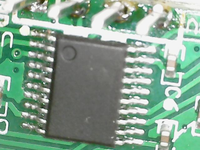

    I'm starting to understand. I didn't realize that the IC (U3) is from Tuya the MCU. I made an amateur sketch of how the TuyaMCU is wired.
    There are 3 main functions
    -functions switches 1-4 for one relay each, and includes a LED each.
    -USB on off (only via Handy App switchable)
    -All on and off switch.
    In the log I see that a response is coming from the individual 5 buttons. But I can't interpret that correctly though. Can you translate this PINOUT to OpenBeken config for me.
    1. pic false template I use 2. is because the "Rule" 3. my pinout sketch
    Reset channel types or use clearConfig
    #6 20475801
    Posts: 14755
    Rate: 12880
    Hello, you have indeed too many Toggle channels. You can fix it in two ways.
    First way is to go to Web Application and there set channel types back to default:
    Second way, just like our doc says:
    is to use clearConfig command, but it will return device to AP mode, so backup the autoexec.bat first, because it will be lost.
    Then we can try to figure step by step how to fully support this device. One problem at time. I am here to help.

    here is a log from pushing the Main button
    Info:MAIN:Time 23, idle 189502/s, free 72912, MQTT 0(1), bWifi 1, secondsWithNoPing -1, socks 2/38
    Info:TuyaMCU:TuyaMCU_ParseStateMessage: processing dpId 1, dataType 1-DP_TYPE_BOOL and 1 data bytes
    Info:GEN:CHANNEL_Set channel 1 has changed to 1 (flags 0)
    Info:MQTT:Channel has changed! Publishing 1 to channel 1
    Info:MQTT:Channel has changed! Publishing 1 to channel 3
    Info:MQTT:Channel has changed! Publishing 1 to channel 4
    Info:TuyaMCU:TUYAMCU received: 55 AA 03 07 00 05 07 01 00 01 01 18
    Info:TuyaMCU:TuyaMCU_ParseStateMessage: processing dpId 7, dataType 1-DP_TYPE_BOOL and 1 data bytes
    Info:GEN:CHANNEL_Set channel 7 has changed to 1 (flags 0)
    Info:MQTT:Channel has changed! Publishing 1 to channel 7
    Info:TuyaMCU:TUYAMCU received: 55 AA 03 07 00 05 26 01 00 01 01 37
    Info:TuyaMCU:TuyaMCU_ParseStateMessage: processing dpId 38, dataType 1-DP_TYPE_BOOL and 1 data bytes
    Info:TuyaMCU:TUYAMCU received: 55 AA 03 07 00 08 09 02 00 04 00 00 00 00 20
    Info:TuyaMCU:TuyaMCU_ParseStateMessage: processing dpId 9, dataType 2-DP_TYPE_VALUE and 4 data bytes
    Info:TuyaMCU:TUYAMCU received: 55 AA 03 07 00 00 0B
    Info:TuyaMCU:TuyaMCU_ProcessIncoming: discarding packet bad expected checksum, expected 11 and got checksum 9
    Info:TuyaMCU:Consumed 8 unwanted non-header byte in Tuya MCU buffer
    Info:TuyaMCU:Skipped data (part) 02 00 04 00 00 00 00 22
    Info:TuyaMCU:TUYAMCU received: 55 AA 03 07 00 08 0F 02 00 04 00 00 00 00 26
    Info:TuyaMCU:TuyaMCU_ParseStateMessage: processing dpId 15, dataType 2-DP_TYPE_VALUE and 4 data bytes
    Info:MAIN:Time 24, idle 188935/s, free 72912, MQTT 0(1), bWifi 1, secondsWithNoPing -1, socks 2/38
    es
    Info:GEN:CHANNEL_Set channel 1 has changed to 0 (flags 0)
    Info:MQTT:Channel has changed! Publishing 0 to channel 1
    Info:TuyaMCU:TUYAMCU received: 55 AA 03 07 00 05 02 01 00 01 00 12
    Info:GEN:CHANNEL_Set channel 2 has changed to 0 (flags 0)
    Info:MQTT:Channel has changed! Publishing 0 to channel 2
    Info:MQTT:Channel has changed! Publishing 0 to channel 3
    Info:MQTT:Channel has changed! Publishing 0 to channel 4
    Info:TuyaMCU:TUYAMCU received: 55 AA 03 07 00 05 07 01 00 01 00 17
    Info:GEN:CHANNEL_Set channel 7 has changed to 0 (flags 0)

  • #12 20476997
    Posts: 14755
    Rate: 12880
    Please provide more information what is exactly wrong with the "Toggle All" button. I need more details.
    a) does it appear on the screen? If no... well, you always must reboot device so autoexec.bat reruns on startup
    b) does it toggle anything at all? if not.... we will think about it.
    c) does it toggle sockets correctly, but doesn't update the buttons on our HTML page? Hmm..
  • Hardware button sends TuyaMCU state updates
    #13 20477026
    DasQ
    Level 4  
    Posts: 19
    hi, and thanks
    i reboot every time twice ;-)
    The button is there, but without a function.
    the log is not very meaningful, should I change the log level?
    log "extradebug" press the hardwarebutton on the device
    ExtraDebug:TuyaMCU:TuyaMCU heartbeat_valid = 1, product_information_valid=1, self_processing_mode = 1, wifi_state_valid = 1, wifi_state_timer=2
    Info:MAIN:Time 13930, idle 186388/s, free 73600, MQTT 1(1), bWifi 1, secondsWithNoPing -1, socks 2/38
    Info:GEN:dhcp=0 ip=192.168.1.41 gate=192.168.1.102 mask=255.255.255.0 mac=1c:90:ff:68:20:6c
    Info:GEN:sta:rssi=-67,ssid=1,bssid=3c:37:12:de:9e:62 ,channel=11,cipher_type:CCMP
    ExtraDebug:TuyaMCU:TuyaMCU heartbeat_valid = 1, product_information_valid=1, self_processing_mode = 1, wifi_state_valid = 1, wifi_state_timer=3
    Info:MAIN:Time 13931, idle 177809/s, free 73600, MQTT 1(1), bWifi 1, secondsWithNoPing -1, socks 2/38
    AA 03 07 00 05 01 01 00 01 00 11
    Info:TuyaMCU:Consumed 12 unwanted non-header byte in Tuya MCU buffer
    Info:TuyaMCU:Skipped data (part) 55 00 03 07 00 05 03 01 00 01 00 13
    Info:TuyaMCU:TUYAMCU received: 55 AA 03 07 00 05 26 01 00 01 00 36
    Debug:TuyaMCU:TuyaMCU_ApplyMapping: id 9 with value 0 is not mapped
    Debug:TuyaMCU:TuyaMCU_ApplyMapping: id 10 with value 0 is not mapped
    Debug:TuyaMCU:TuyaMCU_ApplyMapping: id 11 with value 0 is not mapped
    Debug:TuyaMCU:TuyaMCU_ApplyMapping: id 12 with value 0 is not mapped
    Debug:TuyaMCU:TuyaMCU_ApplyMapping: id 15 with value 0 is not mapped
    Info:MAIN:Time 13932, idle 188093/s, free 73600, MQTT 1(1), bWifi 1, secondsWithNoPing -1, socks 2/38
    Info:MAIN:Time 13934, idle 118499/s, free 73304, MQTT 1(1), bWifi 1, secondsWithNoPing -1, socks 2/38
    and extralog from pressing the button from webif
    ExtraDebug:TuyaMCU:TuyaMCU heartbeat_valid = 1, product_information_valid=1, self_processing_mode = 1, wifi_state_valid = 1, wifi_state_timer=44
    Info:MAIN:Time 14064, idle 185810/s, free 73600, MQTT 1(1), bWifi 1, secondsWithNoPing -1, socks 2/38
    ExtraDebug:TuyaMCU:TuyaMCU heartbeat_valid = 1, product_information_valid=1, self_processing_mode = 1, wifi_state_valid = 1, wifi_state_timer=45
    Info:MAIN:Time 14065, idle 190230/s, free 73600, MQTT 1(1), bWifi 1, secondsWithNoPing -1, socks 2/38
    Info:MAIN:Time 14066, idle 378745/s, free 64992, MQTT 1(1), bWifi 1, secondsWithNoPing -1, socks 3/38
    ExtraDebug:TuyaMCU:TuyaMCU heartbeat_valid = 1, product_information_valid=1, self_processing_mode = 1, wifi_state_valid = 1, wifi_state_timer=46
    Info:MAIN:Time 14067, idle 176547/s, free 73600, MQTT 1(1), bWifi 1, secondsWithNoPing -1, socks 2/38
    ExtraDebug:TuyaMCU:TuyaMCU heartbeat_valid = 1, product_information_valid=1, self_processing_mode = 1, wifi_state_valid = 1, wifi_state_timer=47
    Info:MAIN:Time 14068, idle 187814/s, free 73600, MQTT 1(1), bWifi 1, secondsWithNoPing -1, socks 2/38
    ExtraDebug:TuyaMCU:TuyaMCU heartbeat_valid = 1, product_information_valid=1, self_processing_mode = 1, wifi_state_valid = 1, wifi_state_timer=48
    Info:MAIN:Time 14069, idle 180037/s, free 73600, MQTT 1(1), bWifi 1, secondsWithNoPing -1, socks 2/38
    Info:MAIN:Time 14070, idle 179132/s, free 73600, MQTT 1(1), bWifi 1, secondsWithNoPing -1, socks 2/38
    Info:GEN:sta:rssi=-63,ssid=1,bssid=3c:37:12:de:9e:62 ,channel=11,cipher_type:CCMP
    ExtraDebug:TuyaMCU:TuyaMCU heartbeat_valid = 1, product_information_valid=1, self_processing_mode = 1, wifi_state_valid = 1, wifi_state_timer=51
    Info:MAIN:Time 14074, idle 190939/s, free 73600, MQTT 1(1), bWifi 1, secondsWithNoPing -1, socks 2/38
    ExtraDebug:TuyaMCU:TuyaMCU heartbeat_valid = 1, product_information_valid=1, self_processing_mode = 1, wifi_state_valid = 1, wifi_state_timer=52
    Info:MAIN:Time 14075, idle 188559/s, free 73600, MQTT 1(1), bWifi 1, secondsWithNoPing -1, socks 2/38
    Hinzugefügt nach 14 [Minuten]:
    and here a log include reboot + switching at webif + switching on hardwarebutton. i hope it helps you
    Info:MAIN:Time 6, idle 117868/s, free 74008, MQTT 0(0), bWifi 0, secondsWithNoPing -1, socks 2/38
    Info:TuyaMCU:TUYAMCU received: 55 AA 03 03 00 00 05
    Info:TuyaMCU:TuyaMCU_ProcessIncoming[ver=3]: processing command 3 (WiFiState) with 7 bytes
    Info:MAIN:Time 7, idle 180514/s, free 73312, MQTT 0(0), bWifi 0, secondsWithNoPing -1, socks 2/38
    Info:MAIN:Time 8, idle 163377/s, free 71312, MQTT 0(0), bWifi 0, secondsWithNoPing -1, socks 2/38
    Info:MAIN:Time 9, idle 0/s, free 71312, MQTT 0(0), bWifi 0, secondsWithNoPing -1, socks 2/38
    Info:MAIN:Time 10, idle 0/s, free 71312, MQTT 0(0), bWifi 0, secondsWithNoPing -1, socks 2/38
    Info:GEN:dhcp=0 ip=0.0.0.0 gate=0.0.0.0 mask=0.0.0.0 mac=1c:90:ff:68:20:6c
    Info:GEN:sta: 0, softap: 0, b/g/n
    Info:MAIN:Time 11, idle 33440/s, free 70112, MQTT 0(0), bWifi 0, secondsWithNoPing -1, socks 2/38
    Info:MAIN:Time 12, idle 172371/s, free 60912, MQTT 0(0), bWifi 1, secondsWithNoPing -1, socks 3/38
    Info:MAIN:Time 13, idle 188644/s, free 72656, MQTT 0(0), bWifi 1, secondsWithNoPing -1, socks 2/38
    Info:MQTT:Publishing val 2 to obkFF68206C/sockets retain=0
    Info:TuyaMCU:TUYAMCU received: 55 AA 03 00 00 01 01 00
    Info:TuyaMCU:TuyaMCU_ProcessIncoming: discarding packet bad expected checksum, expected 0 and got checksum 4
    Info:MAIN:Time 18, idle 195813/s, free 72560, MQTT 1(1), bWifi 1, secondsWithNoPing -1, socks 2/38
    Info:MQTT:Publishing val -69 to obkFF68206C/rssi retain=0
    Info:MAIN:Time 19, idle 381829/s, free 72560, MQTT 1(1), bWifi 1, secondsWithNoPing -1, socks 2/38
    Info:MQTT:Publishing val 19 to obkFF68206C/uptime retain=0
    Info:MAIN:Time 20, idle 190097/s, free 72560, MQTT 1(1), bWifi 1, secondsWithNoPing -1, socks 2/38
    Info:GEN:sta:rssi=-69,ssid=1,bssid=3c:37:12:a1:65:f4 ,channel=11,cipher_type:CCMP
    Info:MQTT:Publishing val 72560 to obkFF68206C/freeheap retain=0
    Info:MAIN:Time 21, idle 182759/s, free 72560, MQTT 1(1), bWifi 1, secondsWithNoPing -1, socks 2/38
    Info:MQTT:Publishing val 192.168.1.41 to obkFF68206C/ip retain=0
    Info:MAIN:Time 22, idle 188151/s, free 72560, MQTT 1(1), bWifi 1, secondsWithNoPing -1, socks 2/38
    Info:MAIN:Time 23, idle 185847/s, free 72560, MQTT 1(1), bWifi 1, secondsWithNoPing -1, socks 2/38
    Info:MQTT:Channel has changed! Publishing 1 to channel 5
    Info:MQTT:Publishing val 1 to obkFF68206C/5/get retain=0
    Info:MQTT:MQTT client in mqtt_incoming_publish_cb topic obkFF68206C/5/get
    Info:MQTT:MQTT in topic obkFF68206C/5/get
    Info:MQTT:MQTT topic not handled: obkFF68206C/5/get
    Info:MQTT:channelSet NOT 'set'
    Info:MAIN:Time 24, idle 183633/s, free 72560, MQTT 1(1), bWifi 1, secondsWithNoPing -1, socks 2/38
    Info:MQTT:Channel has changed! Publishing 0 to channel 5
    Info:MQTT:Publishing val 0 to obkFF68206C/5/get retain=0
    Info:MAIN:Time 26, idle 182589/s, free 60864, MQTT 1(1), bWifi 1, secondsWithNoPing -1, socks 3/38
    Info:MAIN:Time 30, idle 192454/s, free 63952, MQTT 1(1), bWifi 1, secondsWithNoPing -1, socks 3/38
    Info:GEN:sta:rssi=-68,ssid=1,bssid=3c:37:12:a1:65:f4 ,channel=11,cipher_type:CCMP
    Info:MAIN:Time 31, idle 192691/s, free 72560, MQTT 1(1), bWifi 1, secondsWithNoPing -1, socks 2/38
    Info:MAIN:Time 32, idle 177753/s, free 72560, MQTT 1(1), bWifi 1, secondsWithNoPing -1, socks 2/38
    Info:MAIN:Time 33, idle 192081/s, free 72560, MQTT 1(1), bWifi 1, secondsWithNoPing -1, socks 2/38
    Info:MAIN:Time 34, idle 183580/s, free 72344, MQTT 1(1), bWifi 1, secondsWithNoPing -1, socks 3/38
    Info:MAIN:Time 37, idle 191816/s, free 72560, MQTT 1(1), bWifi 1, secondsWithNoPing -1, socks 2/38
    Info:MAIN:Time 41, idle 71256/s, free 72560, MQTT 1(1), bWifi 1, secondsWithNoPing -1, socks 2/38
    Info:MAIN:Time 42, idle 189519/s, free 72560, MQTT 1(1), bWifi 1, secondsWithNoPing -1, socks 2/38
    Info:MAIN:Time 43, idle 187022/s, free 72560, MQTT 1(1), bWifi 1, secondsWithNoPing -1, socks 2/38
    Info:MQTT:Publishing val 0 to obkFF68206C/3/get retain=0
    Info:MQTT:Publishing val 0 to obkFF68206C/4/get retain=0
    Info:MQTT:Channel has changed! Publishing 0 to channel 7
    Info:MQTT:MQTT client in mqtt_incoming_publish_cb topic obkFF68206C/1/get
    Info:MQTT:MQTT in topic obkFF68206C/1/get
    Info:MQTT:MQTT topic not handled: obkFF68206C/1/get
    Info:MQTT:Publishing val 0 to obkFF68206C/7/get retain=0
    Info:TuyaMCU:Skipped data (part) 00 AA 03 07 00 05 26 01 00 01 00 36
    Info:MAIN:Time 44, idle 220474/s, free 72560, MQTT 1(1), bWifi 1, secondsWithNoPing -1, socks 2/38
    Info:MQTT:MQTT client in mqtt_incoming_publish_cb topic obkFF68206C/2/get
    Info:MQTT:MQTT in topic obkFF68206C/2/get
    Info:MQTT:MQTT topic not handled: obkFF68206C/2/get
    Info:MQTT:MQTT client in mqtt_incoming_publish_cb topic obkFF68206C/3/get
    Info:MQTT:MQTT in topic obkFF68206C/3/get
    Info:MQTT:MQTT topic not handled: obkFF68206C/3/get
    Info:MQTT:MQTT client in mqtt_incoming_publish_cb topic obkFF68206C/4/get
    Info:MQTT:MQTT in topic obkFF68206C/4/get
    Info:MQTT:MQTT topic not handled: obkFF68206C/4/get
    Info:MQTT:MQTT client in mqtt_incoming_publish_cb topic obkFF68206C/7/get
    Info:MQTT:MQTT in topic obkFF68206C/7/get
    Info:MQTT:MQTT topic not handled: obkFF68206C/7/get
    Info:MQTT:Publishing val 1 to obkFF68206C/4/get retain=0
    Info:MQTT:Publishing val 1 to obkFF68206C/7/get retain=0
    Info:GEN:No change in channel 5 (still set to 1) - ignoring
    Info:MAIN:Time 45, idle 95251/s, free 72560, MQTT 1(1), bWifi 1, secondsWithNoPing -1, socks 2/38

  • Channel 5 only reports 0; test toggle-all button
    #14 20477283
    Posts: 14755
    Rate: 12880
    The logs you have posted indicates that dpID 38 is indeed being sent from TuyaMCU to OpenBeken. Futhermorer, it indicates that Channel 5 is being also changed.
    However, I can see only:
    all the time. Is there any situation, when after repeated press, it wants to set channel 5 to 1 instead of 0?
    Can you please do one more test?
    Does your device has a "Toggle all" button on a case? If so, then does pressing it toggles the "Toggle All" state on GUI?
  • Hardware toggle button maps to channels 4, 7, and 38

    yes there is a "toggle all" button on the case. I've posted the log several times, but would like to post it again
    5-6 pushings at the case(toggle)button

    Considering your last log, I would say that dpID 38 indeed changes from 0 to 1 and but does not toggle all.
    Well, you didn't answer my question:
    but it seems that yes, the Toggle All changes its status on GUI, but it doesn't toggle remaining channels.
    If so, if my assumption is correct, then you can script remaining channels to toggle when that toggle all channel changes.
    alias set_all_on backlog setChannel 1 1; setChannel 2 1; setChannel 3 1; setChannel 4 1;
    alias set_all_off backlog setChannel 1 0; setChannel 2 0; setChannel 3 0; setChannel 4 0;
    alias myToggle if $CH1||$CH2||$CH3||$CH4 then set_all_off else set_all_on
    addEventHandler OnChannelChange 5 myToggle
    Following code (add it to autoexec.bat) will make Relays 1, 2, 3 and 4 react to toggling channel 5 (marked as toggle all).
    Can you check if it works for you as expected?
    This is not a final solution, but at least check if it works from both HTTP GUI and from physical toggle all button....
  • Custom OpenBK7231N relay and USB channel mapping
    #17 20478897
    DasQ
    Level 4  
    Posts: 19
    Nice!
    it looks like it woks as well :-)
    but i did some small changes
    startDriver TuyaMCU
    setChannelType 1 toggle
    setChannelLabel 1 "Relay 1"
    setChannelType 2 toggle
    setChannelLabel 2 "Relay 2"
    setChannelType 3 toggle
    setChannelLabel 3 "Relay 3"
    setChannelType 4 toggle
    setChannelLabel 4 "Relay 4"
    setChannelType 5 toggle
    setChannelLabel 5 "All Relays"
    setChannelType 6 toggle
    setChannelLabel 6 "All"
    setChannelType 7 toggle
    setChannelLabel 7 "USB"
    linkTuyaMCUOutputToChannel 1 1 1
    linkTuyaMCUOutputToChannel 2 1 2
    linkTuyaMCUOutputToChannel 3 1 3
    linkTuyaMCUOutputToChannel 4 1 4
    linkTuyaMCUOutputToChannel 7 1 7
    alias set_all_relays_on backlog setChannel 1 1; setChannel 2 1; setChannel 3 1; setChannel 4 1;
    alias set_all_relays_off backlog setChannel 1 0; setChannel 2 0; setChannel 3 0; setChannel 4 0;
    alias myRelaysToggle if $CH1||$CH2||$CH3||$CH4 then set_all_relays_off else set_all_relays_on
    alias set_all_on backlog setChannel 1 1; setChannel 2 1; setChannel 3 1; setChannel 4 1; setChannel 7 1;
    alias set_all_off backlog setChannel 1 0; setChannel 2 0; setChannel 3 0; setChannel 4 0; setChannel 7 0;
    addEventHandler OnChannelChange 5 myRelaysToggle
    addEventHandler OnChannelChange 6 myToggle
    tuyaMcu_defWiFiState 3
    and a log from toggle from WebIf. first "toggle all relays" then "toggle all"

    Your code seems okay, but you have the toggle all fully done in OpenBeken, without dpID 38 link. Is that a desired approach?
    That way the dpID 38 physical button connected to MCU won't work
  • #19 20479003
    DasQ
    Level 4  
    Posts: 19
    Hi, this is not desired, but it works. I thought, since the first approach via dpID38 didn't work as expected, to comment out this part. and later I just deleted it to save memory. didn't know that I should leave the physical assignment in there.
  • Question about linking dpID 38 to channel 5
    #20 20479013
    Posts: 14755
    Rate: 12880
    I am not sure if it's a communication error or intended behaviour, but I think that this line:
    linkTuyaMCUOutputToChannel 38 1 5
    will make physical toggle all button toggle channel 5, and then this line:
    would make relays follow the toggle.
    Can you check?
    I am thinking this because I saw in your logs that dpID 38 is indeed sent by the device and OpenBeken can receive it, both 0 and 1 values.
    Info:MAIN:Time 47, idle 180043/s, free 70656, MQTT 1(1), bWifi 1, secondsWithNoPing -1, socks 2/38
    Info:MQTT:Publishing val 0 to obkFF68249E/4/get retain=0
    Info:MQTT:MQTT client in mqtt_incoming_publish_cb topic obkFF68249E/4/get
    Info:MQTT:MQTT in topic obkFF68249E/4/get
    Info:MQTT:MQTT topic not handled: obkFF68249E/4/get

  • #22 20479040
    Posts: 14755
    Rate: 12880
    I am unable to find any mentions of dpID 38 in the log from your last post. It was in logs before, but not know.

    #23 20479054
    DasQ
    Level 4  
    Posts: 19
    no i pressed the button in the webif
    The original firmware turns everything off or on when you press the physical button (ch1-ch4 including USB).
    but I also like the new function to switch only all relays (1ch-ch4)
    sorry here is a log from pressing the device button
    Debug:CMD:cmd [if $CH1||$CH2||$CH3||$CH4 then set_all_off else set_all_on]
    Debug:CMD:cmd [set_all_on]
    Debug:CMD:cmd [backlog setChannel 1 1; setChannel 2 1; setChannel 3 1; setChannel 4 1; setChannel 7 1;]
    Debug:CMD:backlog [setChannel 1 1; setChannel 2 1; setChannel 3 1; setChannel 4 1; setChannel 7 1;]
    Debug:CMD:cmd [setChannel 1 1]
    Info:MQTT:Publishing val 1 to obkFF68249E/1/get retain=0
    Debug:CMD:cmd [setChannel 2 1]
    Info:GEN:CHANNEL_Set channel 2 has changed to 1 (flags 0)
    Info:MQTT:Channel has changed! Publishing 1 to channel 2
    Info:MQTT:Publishing val 1 to obkFF68249E/2/get retain=0
    Debug:CMD:cmd [setChannel 3 1]
    Info:MQTT:Publishing val 1 to obkFF68249E/3/get retain=0
    Debug:CMD:cmd [setChannel 4 1]
    Info:MQTT:MQTT client in mqtt_incoming_publish_cb topic obkFF68249E/6/get
    Info:MQTT:MQTT in topic obkFF68249E/6/get
    Info:MQTT:MQTT topic not handled: obkFF68249E/6/get
    Info:MQTT:Publishing val 1 to obkFF68249E/4/get retain=0
    Debug:CMD:cmd [setChannel 7 1]
    Info:MQTT:Publishing val 1 to obkFF68249E/7/get retain=0
    Debug:CMD:backlog executed 5
    Info:MQTT:Publishing val 0 to obkFF68249E/3/get retain=0
    Info:MQTT:MQTT client in mqtt_incoming_publish_cb topic obkFF68249E/1/get
    Info:MQTT:MQTT in topic obkFF68249E/1/get
    Info:MQTT:MQTT topic not handled: obkFF68249E/1/get
    Info:MQTT:Publishing val 0 to obkFF68249E/7/get retain=0
    Info:GEN:No change in channel 6 (still set to 0) - ignoring

    fo:MQTT:Publishing val 1 to obkFF68249E/6/get retain=0
    Info:EVENT:EventHandlers_FireEvent: executing command myToggle
    Debug:CMD:cmd [myToggle]
    Debug:CMD:cmd [set_all_off]
    Debug:CMD:cmd [backlog setChannel 1 0; setChannel 2 0; setChannel 3 0; setChannel 4 0; setChannel 7 0;]
    Debug:CMD:backlog [setChannel 1 0; setChannel 2 0; setChannel 3 0; setChannel 4 0; setChannel 7 0;]
    Debug:CMD:cmd [setChannel 1 0]
    Info:MQTT:Publishing val 0 to obkFF68249E/1/get retain=0
    Debug:CMD:cmd [setChannel 2 0]
    Info:MQTT:Publishing val 0 to obkFF68249E/2/get retain=0
    Debug:CMD:cmd [setChannel 3 0]
    Debug:CMD:cmd [setChannel 4 0]
    Debug:CMD:cmd [setChannel 7 0]

    Hinzugefügt nach 2 [Stunden] 54 [Minuten]:
    after some trys i made a big crashing one of my strips.
    befor i flashed the new version 1.15.573. so i thinked this was the problem, but no, i discovered that the line
    linkTuyaMCUOutputToChannel 38 1 6
    made this problem. always i press the hardware (or webif) button, randomly switches ch1 + ch2 on and ch3 + ch4 off or other shapes absolutly random. So i coment it back out and every thing is ok.
    Info:GEN:No change in channel 1 (still set to 0) - ignoring
    Info:MAIN:Time 43, idle 68964/s, free 59216, MQTT 1(1), bWifi 1, secondsWithNoPing -1, socks 3/38
    Info:MAIN:Time 44, idle 177278/s, free 70912, MQTT 1(1), bWifi 1, secondsWithNoPing -1, socks 2/38
    Info:MAIN:Time 45, idle 192707/s, free 70912, MQTT 1(1), bWifi 1, secondsWithNoPing -1, socks 2/38
    Info:MAIN:Time 46, idle 197655/s, free 70912, MQTT 1(1), bWifi 1, secondsWithNoPing -1, socks 2/38
    Info:MAIN:Time 47, idle 183901/s, free 70912, MQTT 1(1), bWifi 1, secondsWithNoPing -1, socks 2/38
    Info:MAIN:Time 48, idle 189577/s, free 70912, MQTT 1(1), bWifi 1, secondsWithNoPing -1, socks 2/38
    Info:MQTT:MQTT client in mqtt_incoming_publish_cb topic obkFF68249E/7/get
    Info:MQTT:MQTT in topic obkFF68249E/7/get
    Info:MQTT:MQTT topic not handled: obkFF68249E/7/get
    Info:MQTT:MQTT client in mqtt_incoming_publish_cb topic obkFF68249E/2/get
    Info:MQTT:MQTT in topic obkFF68249E/2/get
    Info:MQTT:MQTT topic not handled: obkFF68249E/2/get
    Info:MQTT:MQTT client in mqtt_incoming_publish_cb topic obkFF68249E/3/get
    Info:MQTT:MQTT in topic obkFF68249E/3/get
    Info:MQTT:MQTT topic not handled: obkFF68249E/3/get
    Info:TuyaMCU:TUYAMCU received: 55 AA 03 07 00 05 01 01 00 01 00 11
    Info:GEN:No change in channel 2 (still set to 0) - ignoring
    Info:GEN:No change in channel 7 (still set to 0) - ignoring
    Info:MAIN:Time 50, idle 50040/s, free 59216, MQTT 1(1), bWifi 1, secondsWithNoPing -1, socks 3/38
    Info:GEN:dhcp=0 ip=192.168.1.43 gate=192.168.1.102 mask=255.255.255.0 mac=1c:90:ff:68:24:9e
    Info:GEN:sta:rssi=-66,ssid=1,bssid=3c:37:12:de:9e:62 ,channel=11,cipher_type:CCMP
    Info:MAIN:Time 51, idle 147788/s, free 70912, MQTT 1(1), bWifi 1, secondsWithNoPing -1, socks 2/38
    Info:MAIN:Time 52, idle 192120/s, free 70912, MQTT 1(1), bWifi 1, secondsWithNoPing -1, socks 2/38
    Info:MAIN:Time 53, idle 191796/s, free 70696, MQTT 1(1), bWifi 1, secondsWithNoPing -1, socks 3/38
    01 00 14
    Info:GEN:CHANNEL_Set channel 6 has changed to 0 (flags 0)
    Info:MQTT:Channel has changed! Publishing 0 to channel 6
    Info:MQTT:Publishing val 0 to obkFF68249E/6/get retain=0
    Info:MAIN:Time 54, idle 194217/s, free 70912, MQTT 1(1), bWifi 1, secondsWithNoPing -1, socks 2/38
    Info:TuyaMCU:TUYAMCU received: 55 AA 03 07 00 05 01 01 00 01 01 12
    Info:GEN:No change in channel 7 (still set to 1) - ignoring
    Info:MAIN:Time 55, idle 98856/s, free 62288, MQTT 1(1), bWifi 1, secondsWithNoPing -1, socks 3/38
    Info:MAIN:Time 56, idle 153430/s, free 70912, MQTT 1(1), bWifi 1, secondsWithNoPing -1, socks 2/38
    Info:MAIN:Time 57, idle 188570/s, free 70912, MQTT 1(1), bWifi 1, secondsWithNoPing -1, socks 2/38
