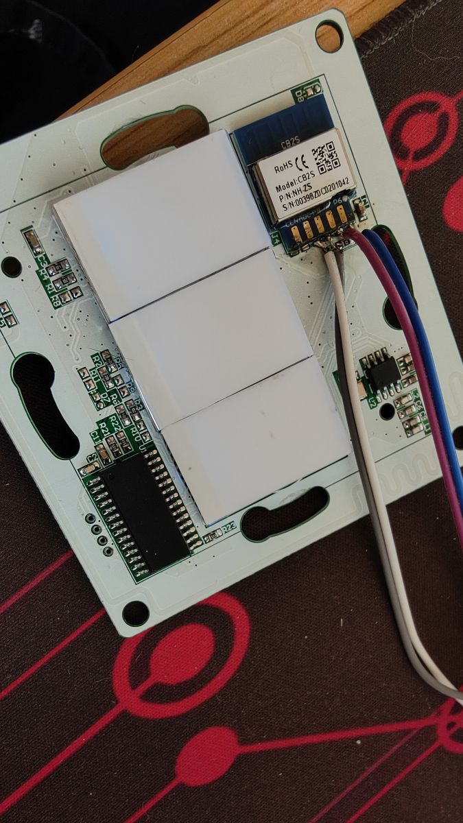

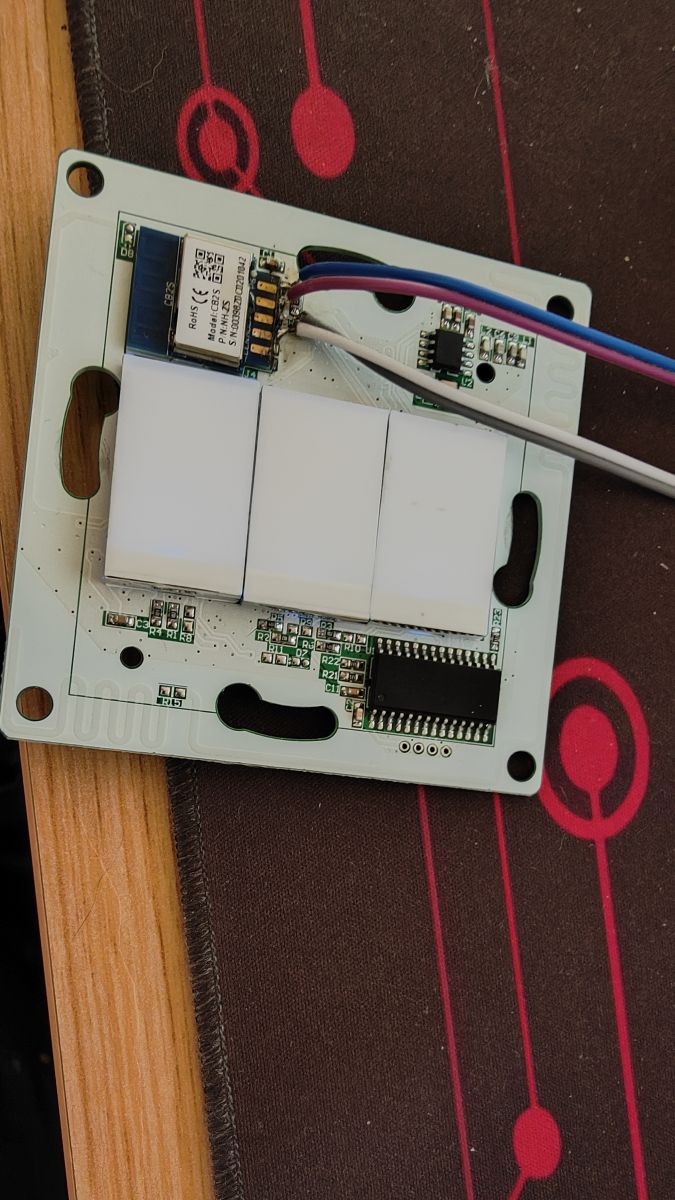

    I bought this on Aliexpress ]Link
    Shutter control panel with three touch buttons
    Electronic module with three white buttons and wiring on a circuit board. Close-up of an electronic module featuring a CB2S module with connected wires.
    I managed to flash the CB2S everything works well the device uses TuyaMCU.
    Unfortunately I can't find the bind of the buttons

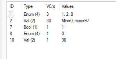

    I found this
    Table with columns ID, Type, VCnt, and Values containing numerical data.
    If I understood correctly My id1 I am at 0 when I stop I am at 2 when I go down and I am at 1 when I go up
    startDriver TuyaMCU
    tuyaMcu_defWiFiState 4
    setChannelType 1 toggle
    The problem with the linkTuyaMCUOutputToChannel 1, I can't find how to change the value from 1 to 0 or 2

    The capture indicates that dpID 1 is an enum and not a bool. That's why I would suggest to try a TextField channel type instead. See the modified autoexec.bat:
    startDriver TuyaMCU
    setChannelType 1 TextField
    // linkTuyaMCUOutputToChannel [dpId][varType][channelID]
    linkTuyaMCUOutputToChannel 1 enum 1
    Added after 36 [seconds]:
    With this, you can try entering any numerical value, so you can try all captured options - 0, 1 and 2.
