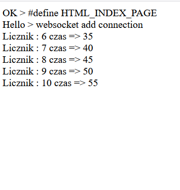

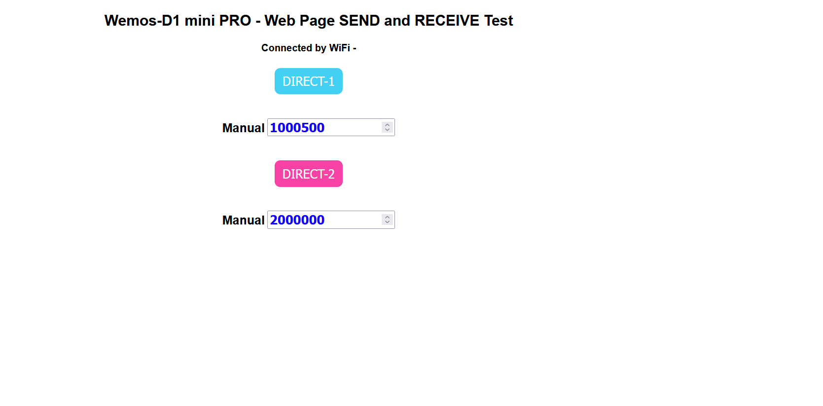

    I am programming in gcc on Eclipses.
    I have set up a web server on ESP01, I think complete.
    I am able to send data to the websocket, to the browser, via the function
    websocket_write_all(buf, strlen(buf), WEBSOCKET_TEXT);
    as the HTML code of the page is defined
    #define HTML_INDEX_PAGE sent by function
    http_send_string(con, HTML_INDEX_PAGE, "text/html");
    The problem arises when I want to define HTML_INDEX_PAGE as the code of a more extended page, there are a lot of inverted commas in the code which effectively prevents me from defining the HTML code as a string.
    Please give me a hint on how I should send the extended HTML code to the browser.
    I am attaching screenshots and details/body of the function in the attachment.
    Regards
    edit - there are tons of examples for the Arduino IDE on the web.
    edit2 - code for ESP in NOTA and NONOS, important !
    Screenshot of a browser displaying a simple HTML page from ESP01, with Polish messages about websocket connection and a list of counters and times. .
    Screenshot of a web page for testing data send and receive with Wemos-D1 mini PRO, featuring DIRECT-1 and DIRECT-2 buttons and selection fields. .

    2. in the example page, ESP sends an ASCII string
    "<!DOCTYPE HTML><html><head>OK > is HERE: #define HTML_INDEX_PAGE</head><body><div style='width: 400px; height: 800px; overflow:auto;' id='wdata'></div><script src='websocket_test.js'></script></body></html>"
    so the theme is simple,
    3. I want to send the HTML code of the page (attached) to the browser and it seems to me that this way is not possible

    Use makefsdata, which will generate arrays for you from your file package to the server.
    This is more or less what it looks like
    https://github.com/plawnik/stm32f407_live_chart/tree/main/socket_test/LWIP/App
    The www contains the files you want to put on the server, the fsdata_custom.c file is an array file system.
    If you are working on windows look for the makefsdata.exe utility, it should be available somewhere with examples from ST. You'll also need some dll which you need to put in the same folder as the tool, I can't remember which one it was exactly anymore, but I think it was something from netframeworks - you'll get a message about a missing dll file when you try to use the tool. You'll get the resulting file when you drag a bunch of server files onto the exe file.
    If you're running Linux, there's a perl script available from makefsdata.co.uk that you should be able to run without any problems.

    #12 21544559
    zbynio_k
    Posts: 169
    thanks, I'm using eclipse with 03.25 and the options you showed are not there
    1. project->properties->C/C++ Build->Settings->Build Steps->PreBuild steps->Command
    I also cannot find the makefsdata.exe file on the internet
    but your hint led me to a clue > it is possible to convert e.g. online HTML text to HEX array
    I have displayed this array and ... works
    not as I would like because I send it as plain text
    I try sending as
    Greetings
