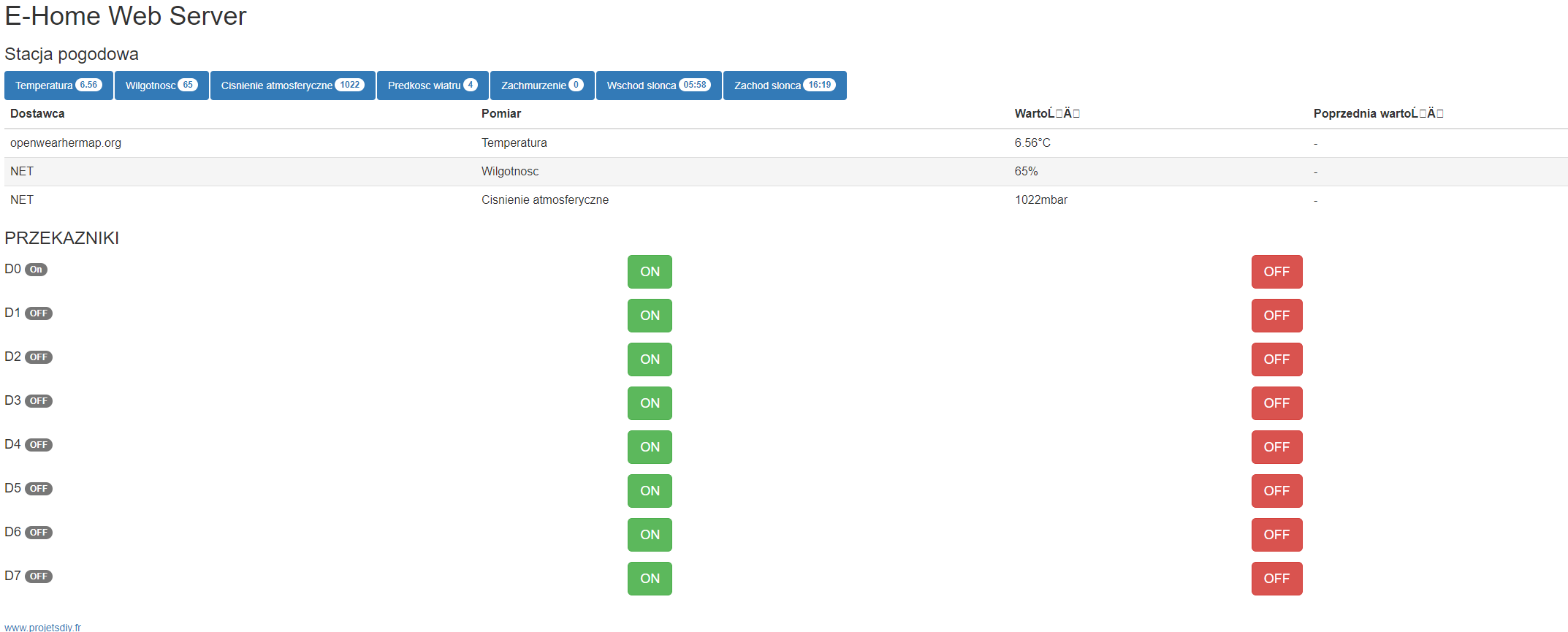

    I'm not going to paste all the sources of the project because there is too much, I'm just looking for a solution : how to set to display Polish tails ?

    #2 19270518
    sylweksylwina
    Posts: 13216
    Help: 1882
    Rate: 2355
    And why make life so complicated for yourself?
    Put the page code as files in LittleFS memory and not in program code.

    Polish tails already done, just needed to add <meta charset='utf-8'>
