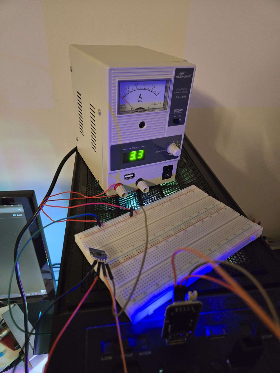

    This is my first time flashing a BK7321N.
    everything seems fine until the tool starts writing.
    Doesn't matter how often i try or which baud rate. The exact same error every time.
    Laboratory power supply connected to a breadboard with wires and electronic components.
    Starting flash new (no backup)!

    AI: Can you share details about your flashing setup—what USB-to-serial adapter are you using, how is it wired to the BK7321N, and how are you powering the device during flashing?
    C340G, all pins correctly connected. 3V3 from external power supply. See image
    AI: Which operating system and flashing tool (including version) are you using for this process?
    Windows
    BK7231GUIFlashTool V19

    How long is your cabling? Seems quite long perhaps. I tend to keep 15cm or shorter for this kind of reason.
  • #3 21550752
    spheresox
    Posts: 10
    I shortened the cables as suggested but nothing changed. Still exact same error as in my original message

    what if you up to voltage to 3.4v?
  • #7 21555055
    spheresox
    Posts: 10
    I was able to successfully flash 6 chips from the same device, with the exact same setup without problems. Therefore I just declared the 2 chips that didn't flash as faulty and move on.
    I'm not an expert and there might be a fix but now that I got a pleasing result I do not want to sink more time into this issue.
  • #8 21555057
    spheresox
    Posts: 10
    See message above. Probably a faulty chip
