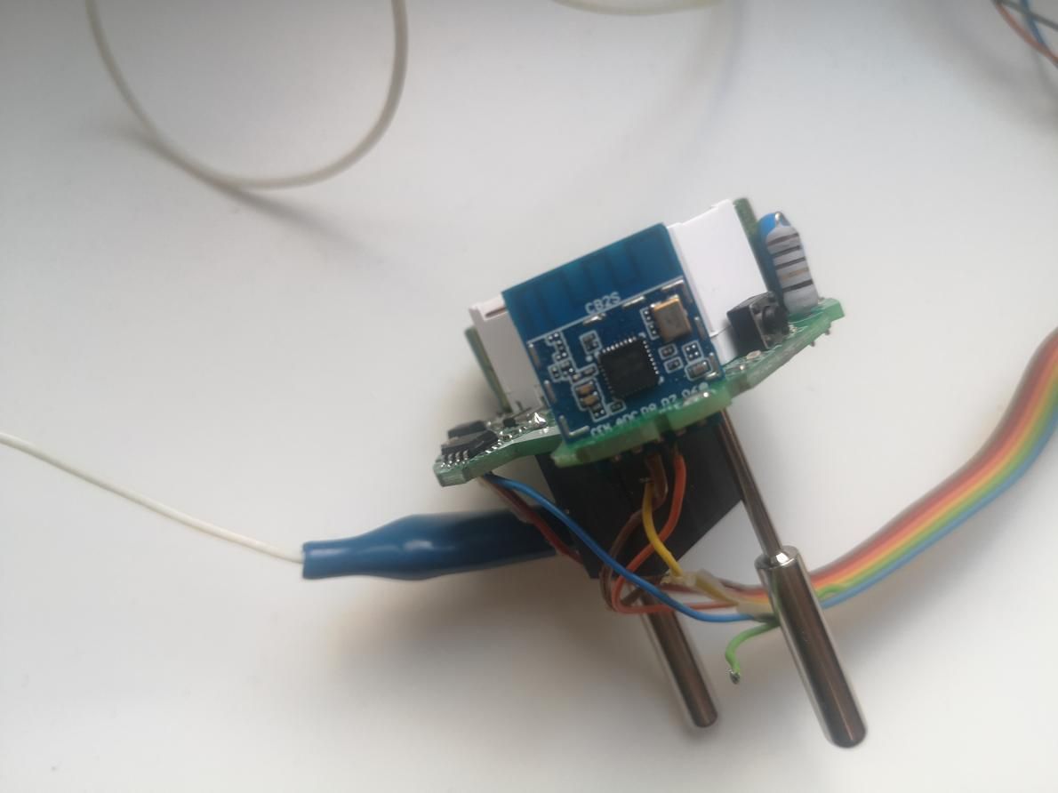

    HI, I've just tried to flash OpenBK firmware on CB2S module with BK7231N chip by Easy Uart Flasher, but unfortunately it failed.
    I used Easy Uart Flasher v50 and OpenBK7231N_QIO_1.18.156 firmware.
    Spoiler:
    CB2S module with BK7231N chip connected via UART cables and sensors.
    I managed to do backup flash, and I think it was read properly as program managed to extract OBK. But when I clicked write, program start to flash firmware and failed at address0xE3000:

    After that I tried to rollback, python tool, change speeds or skip key check, but no lack. It simply fails writing at some but specific to selected file address.
    Is there any way to fix this, or unit can be considered as dead?

    probably a combination of wires being too long and or powering from 3.3v on USB-TTL. Try powering from 3.3v external power source. common grounds

    I've switched it lab PSU.
    And also checked RX, TX lines with oscilloscope, they are clean and crisp.
    I mean I assume that if there's an issue with UART, it wouldn't be able to communicate with chip.
    But as you can see from log it reads some protection, erases memory, and only fails in the middle of the memory write.
    And what is most odd, it always fails at the same address for particular firmware (probably depends on bin file length, because in case of back up file it fails at another address).

    So, a small update on this issue.
    I've tried to make wires as short as possible, but no luck, it still fails at address 0x11000.
    Then I tried to write OBK only and surprisingly system said write success. More of that, psu showed up to 0.08A consumption and one of leds starts to blink.
    I've opened wifi connection on my phone and found openbeken device.
    Next step I've tried to modify OBK file by program (basically added SSID of my home network), but once again program reported that write failed.

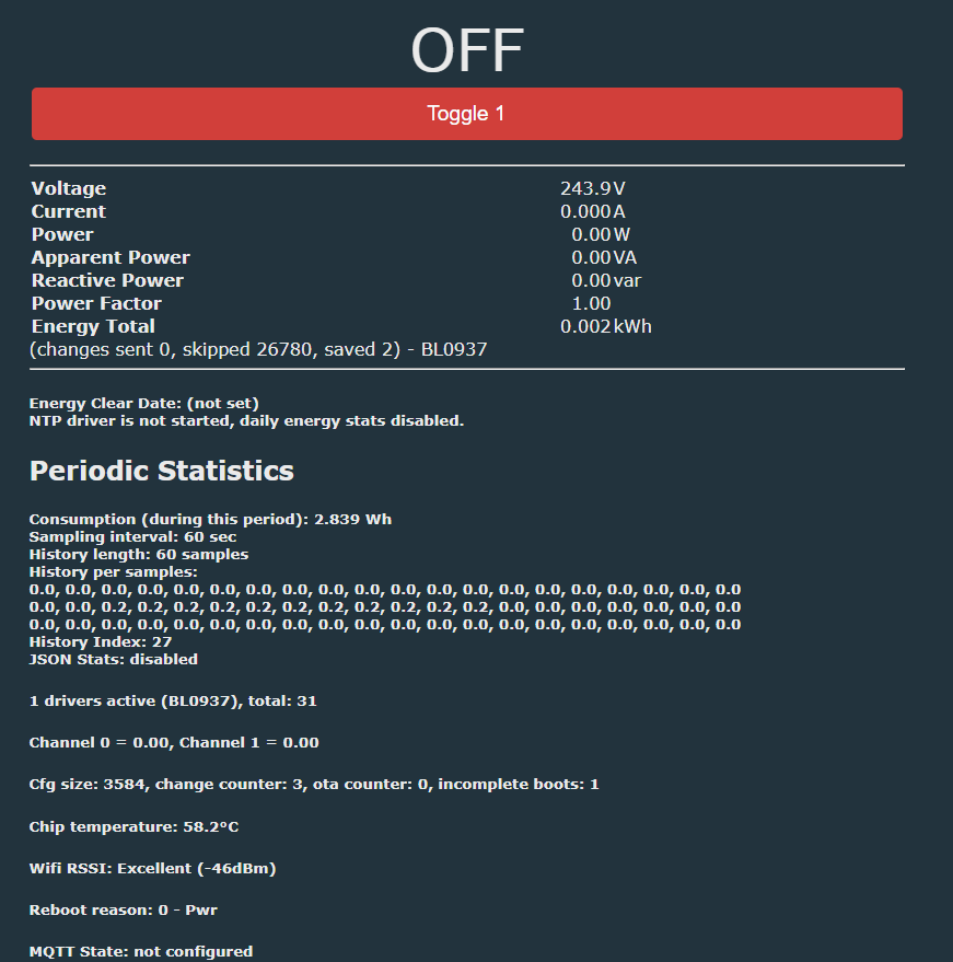

    Despite on that, I've rebooted device and ... it connected to my home wifi.
    I've managed to open configuration server, set pin parameters, open app server and everything is working...
    OpenBK panel showing 243.9V voltage and energy consumption statistics
    I have no idea what is happening here.
    My wild guess would be that there is some mismatch between chip memory size and/or program memory size which makes program to think that write wasn't successful, while in fact everything was written.
    I'll monitor plug behavior next couple of days and report if something goes wrong.
